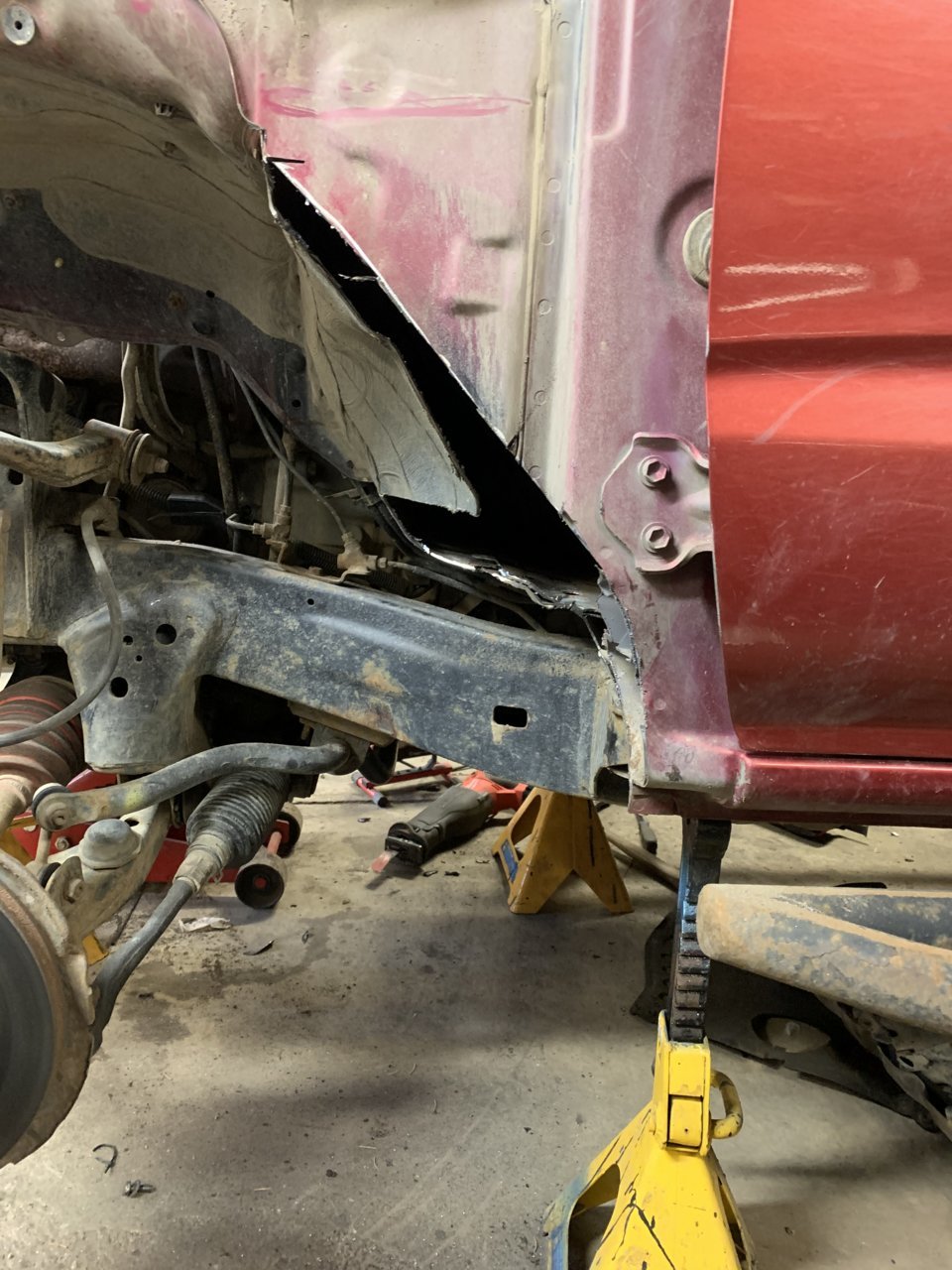

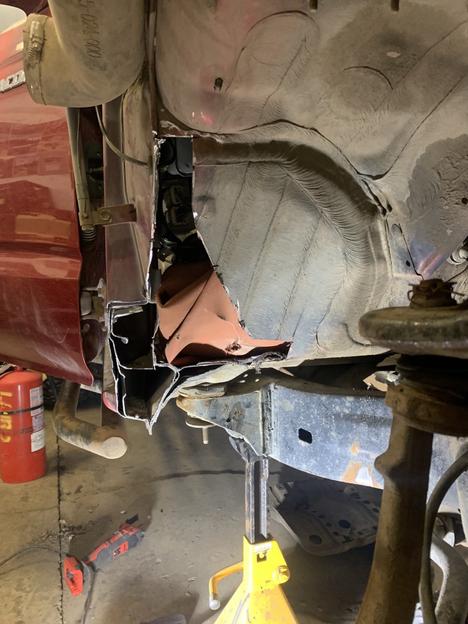

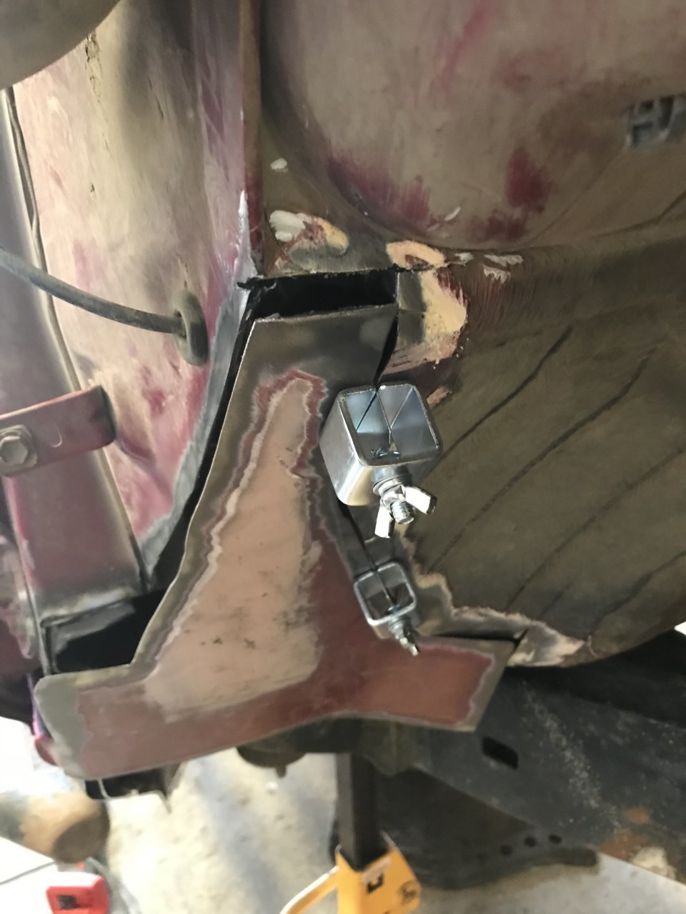

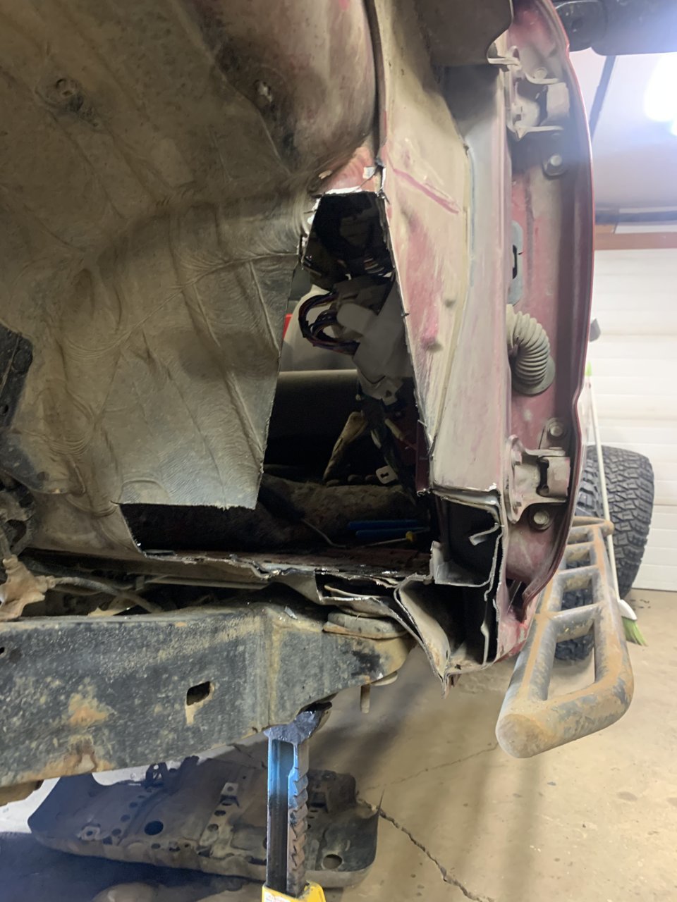

    This is how far I went into the cab under the door hinge. I need to work on the arc a bit. I also need to nip the bit of the floor there, and fold it up and stitch it together.

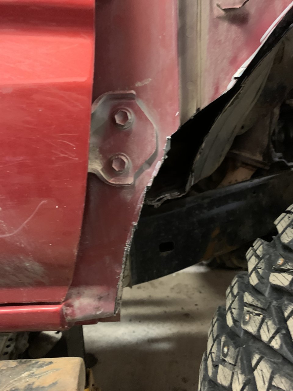

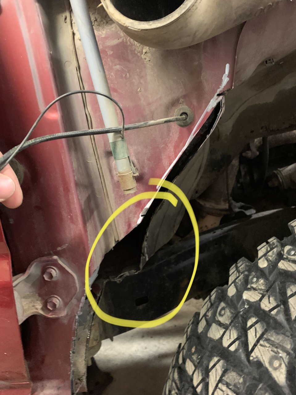

    This spot here. Give it a pie cut, and fold it up and weld it.

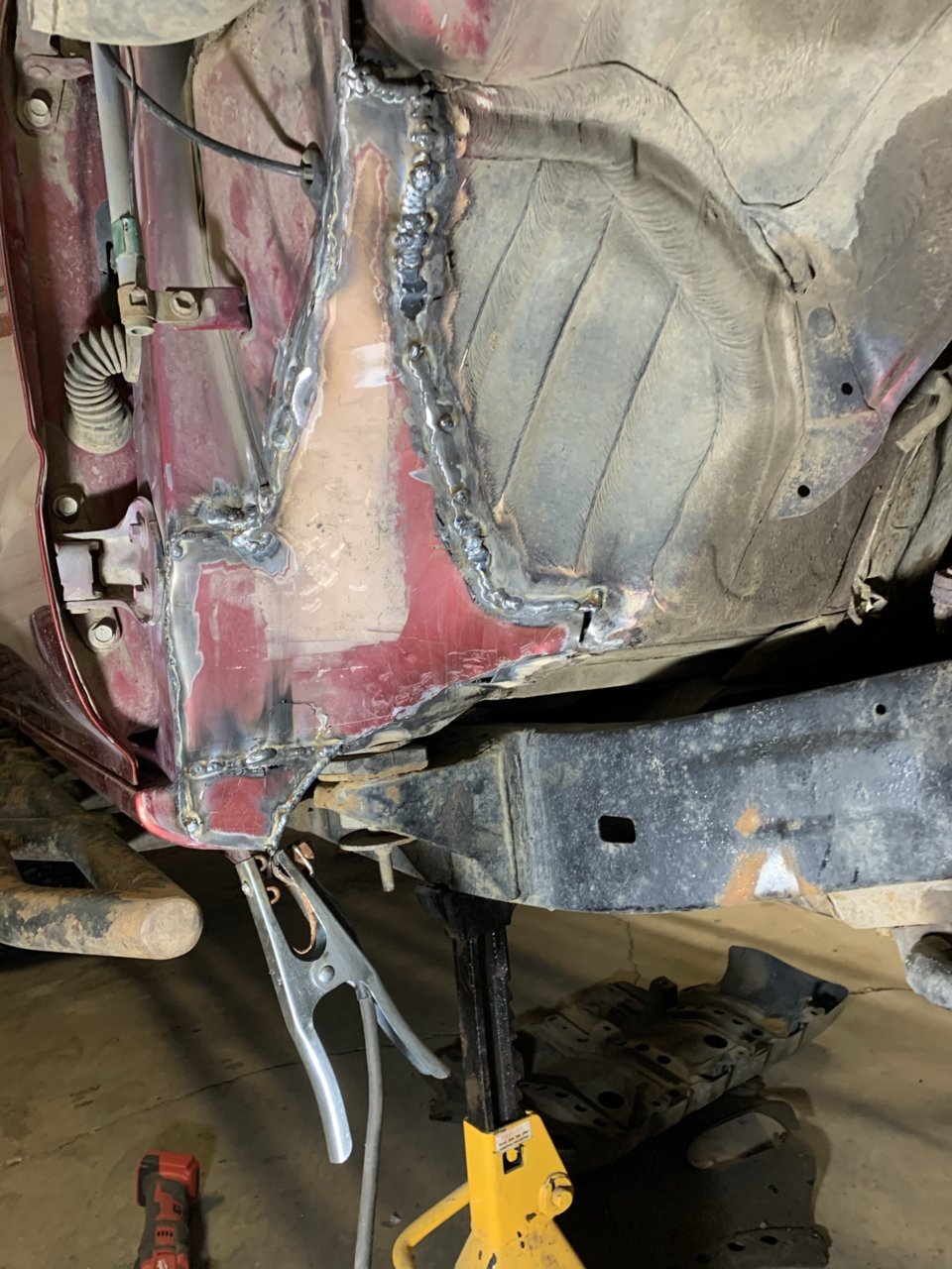

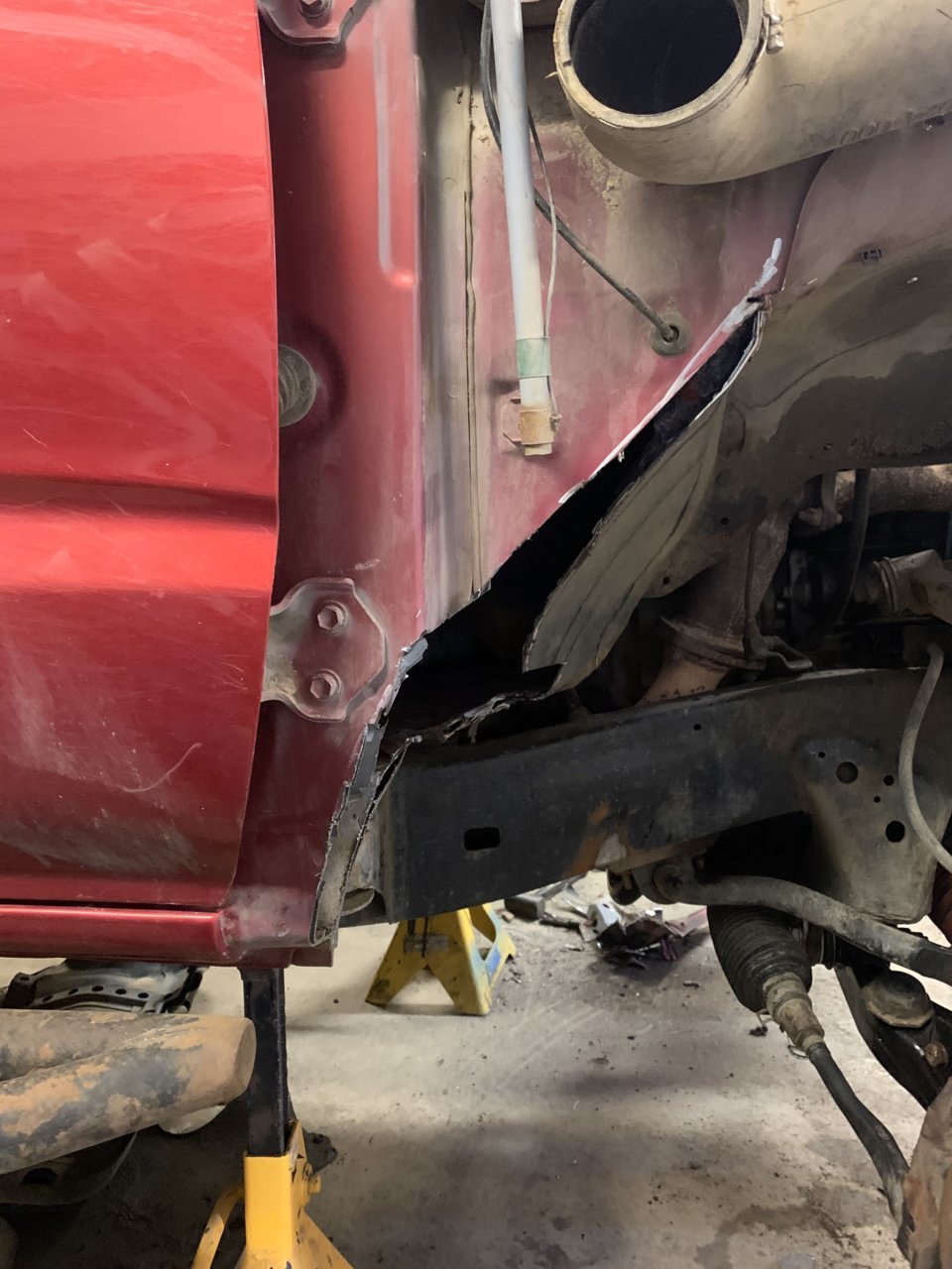

    Went a little larger with the cuts

    Now for some templates, and get to welding.

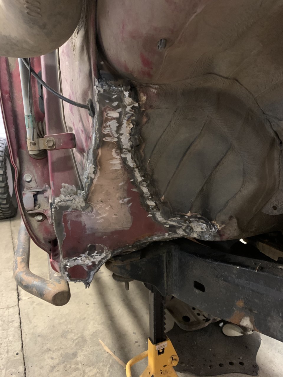

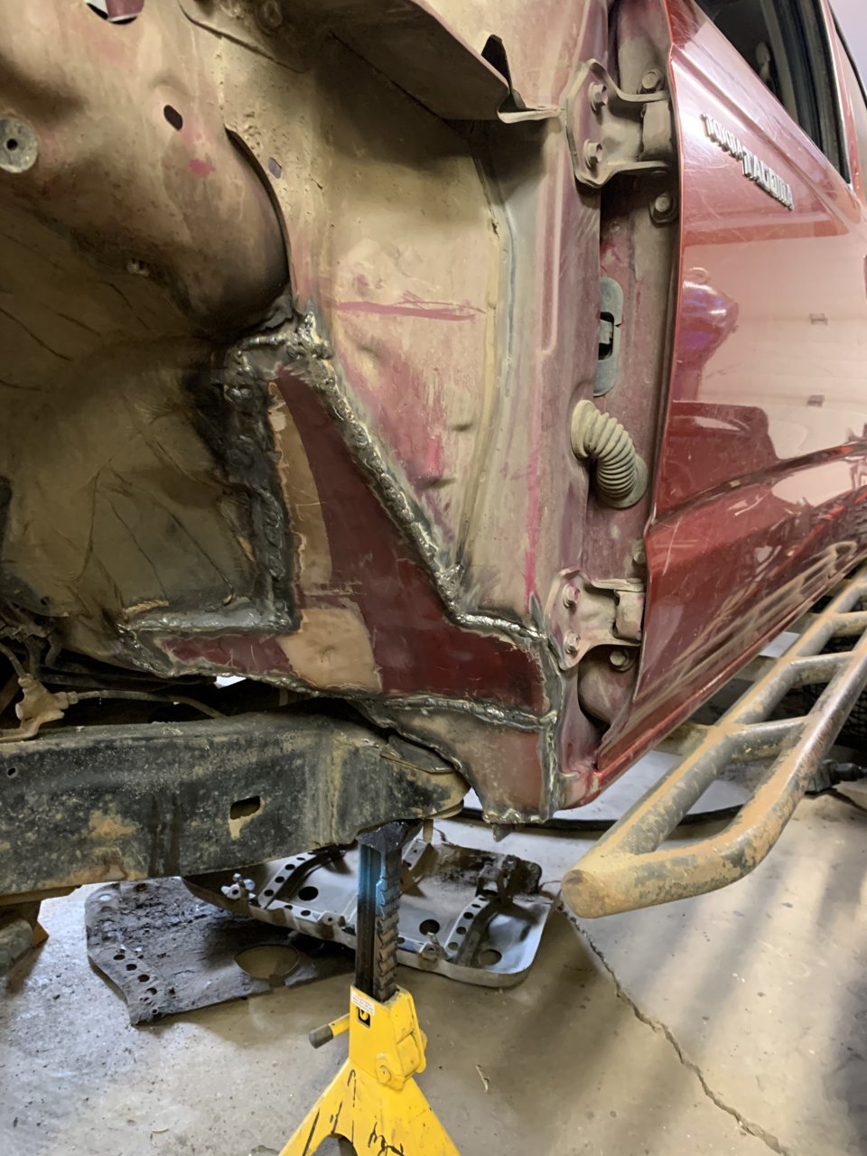

    Passenger side done

    Drivers side done as well

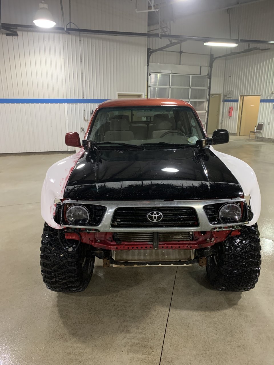

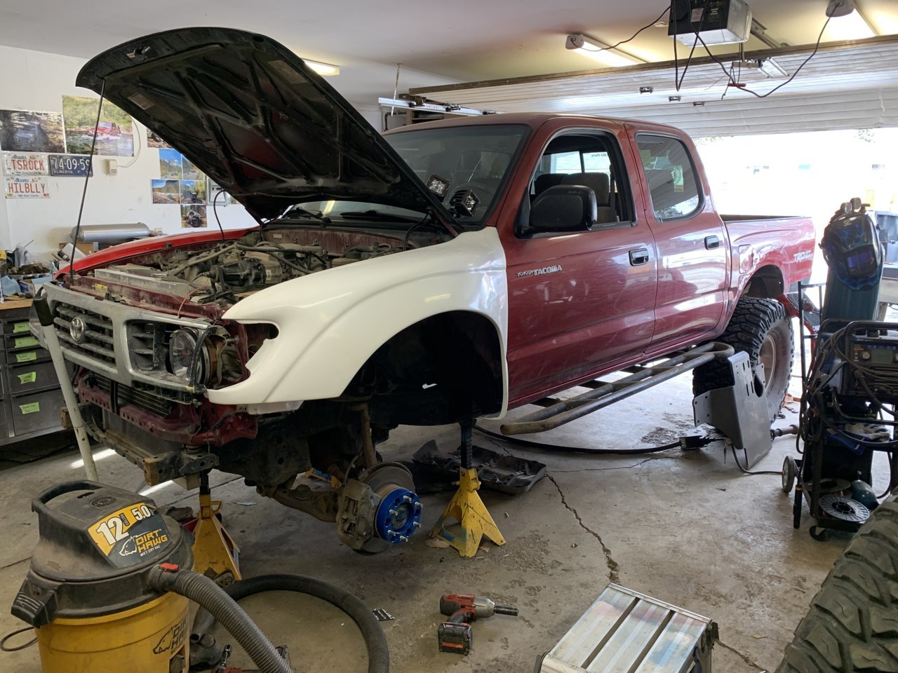

    Passenger fender on, and clearanced for the big boots.

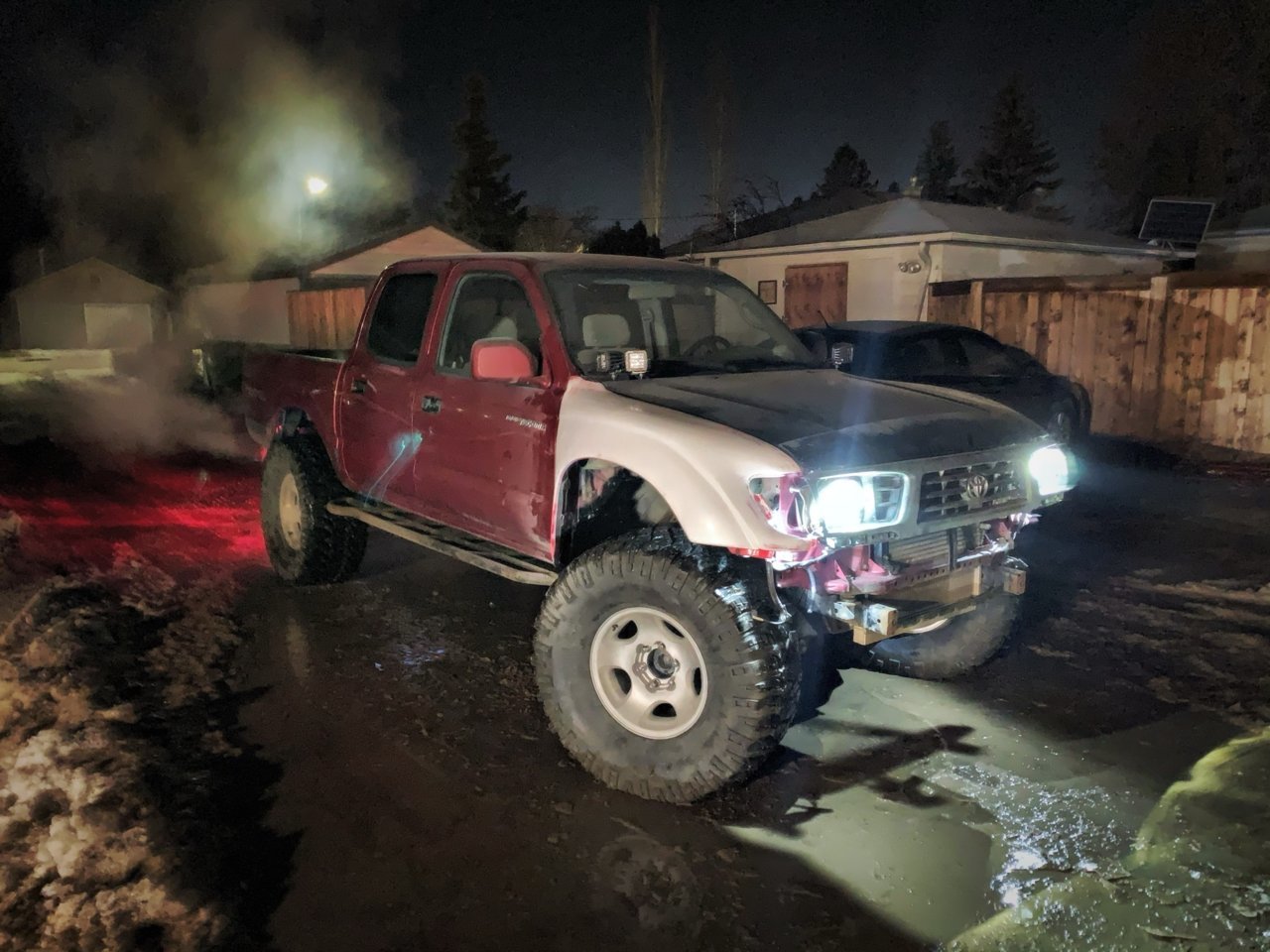

    She’s coming together.

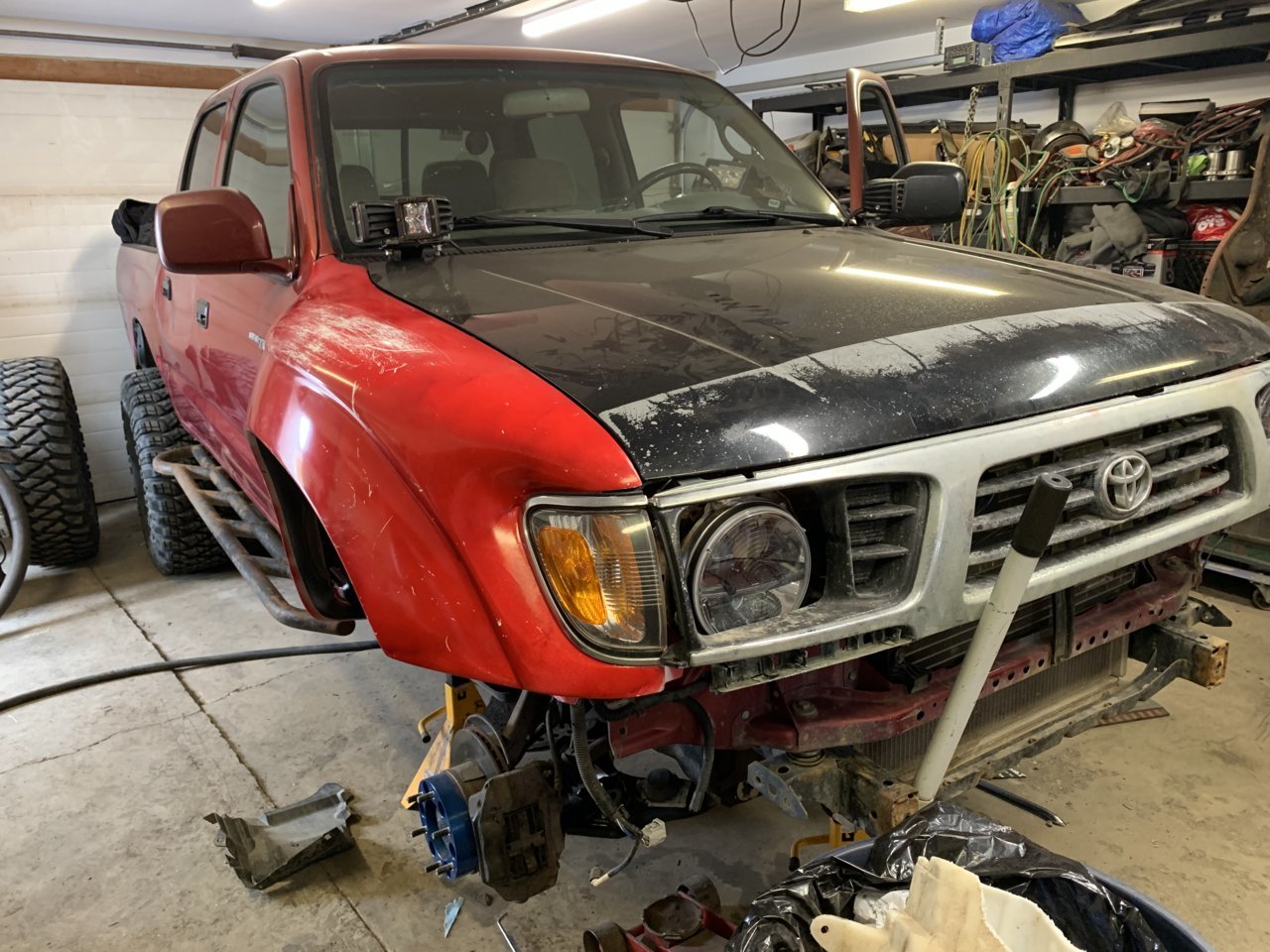

    Got a start on fit up on the drivers side.

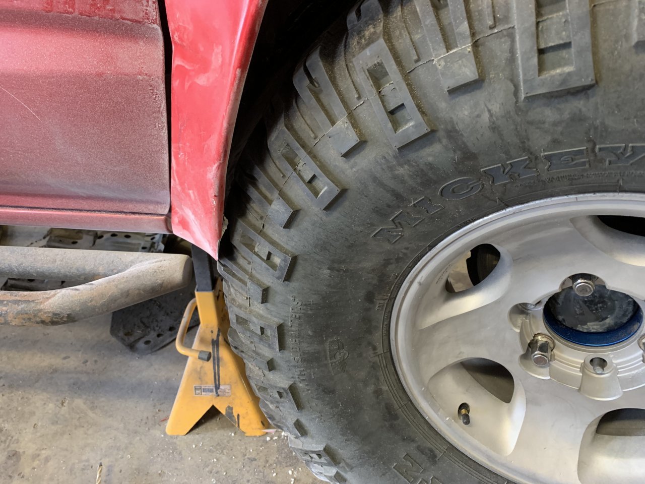

    Fenders are on. Tires clear

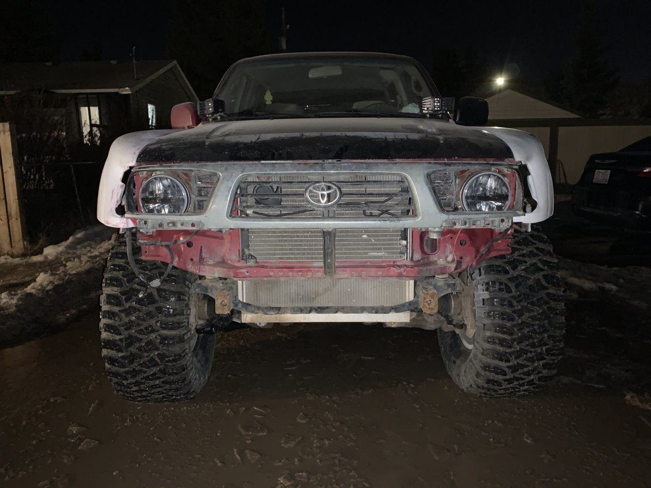

    Going to take her for a wash tonight, then start fitting up the grille, and work at the transfer cases. Box side should be here Thursday-ish. I’ll have to pull the box this weekend, and re-wire the original harness up to get factory lights again.

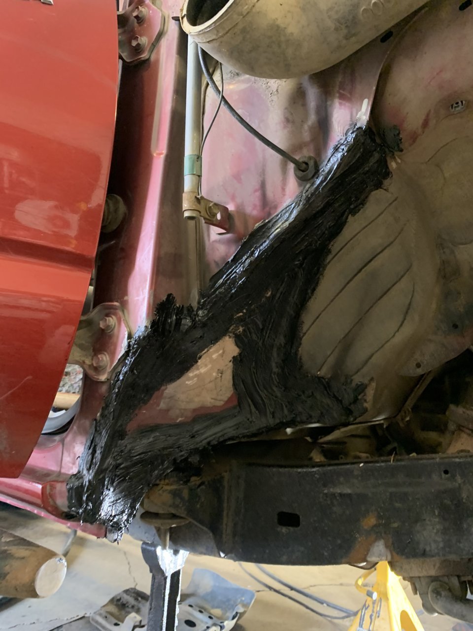

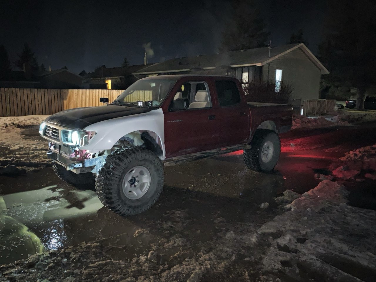

    Now for paint.
