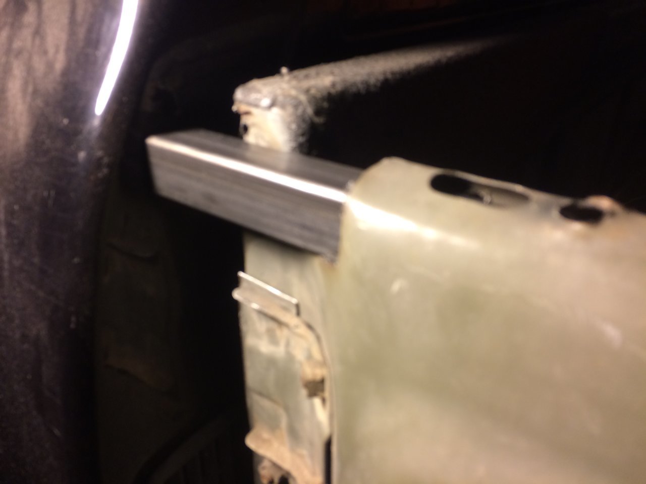

    Some 1x1 square tube or angle iron fits in the channel at the top of the bed rails to stiffen things up - I would use angle iron to make access to fasteners easier. I ended up welding nuts inside, but think angle iron is the way to go.

    Man, that's wicked. Mine's the short short box, so I didn't throw anything in to stiffen it up. I'll see how it feels when I open the tailgate. Thanks!

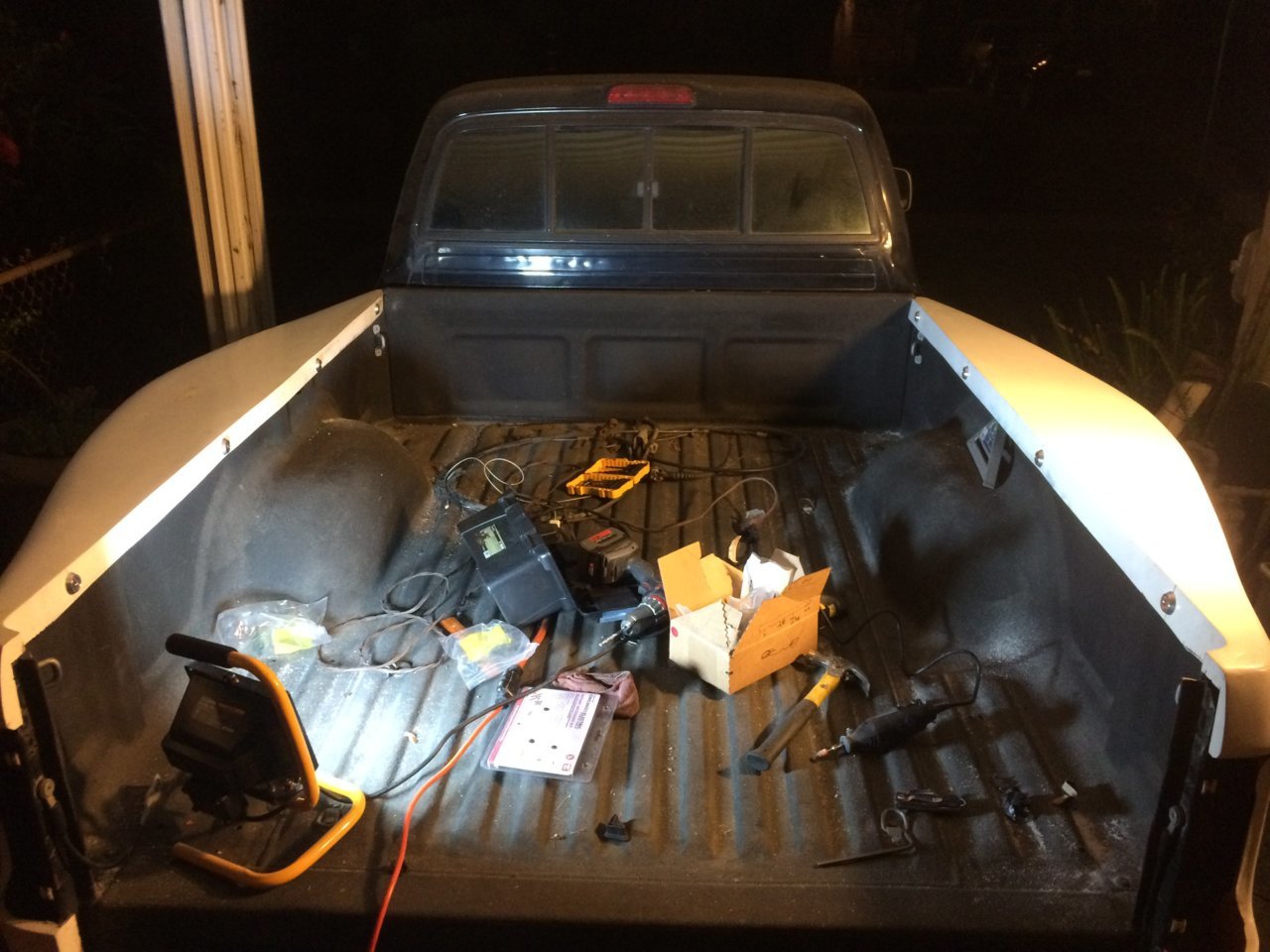

  10. Apr 20, 2021 at 9:37 PM
    #450
    POSTacoMike
    POSTacoMike [OP] On the rocks, please
    Nov 4, 2019
    #309824
    1,114
    Red Deer AB
    2001 Tacoma DC XPreRunner
    OME Suspension, ARB Bumper, frame swap, Rebco logger box.

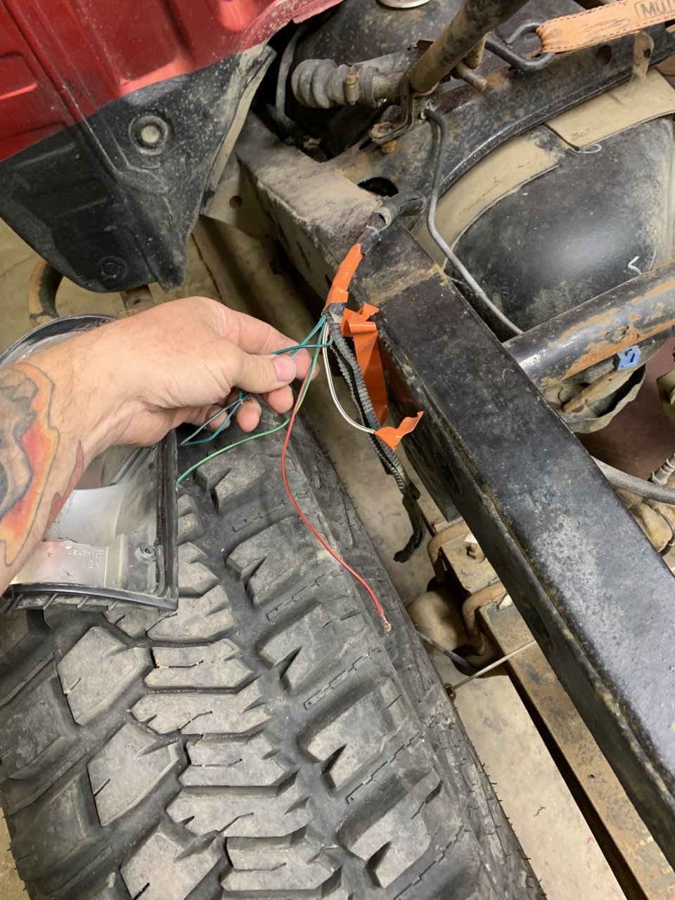

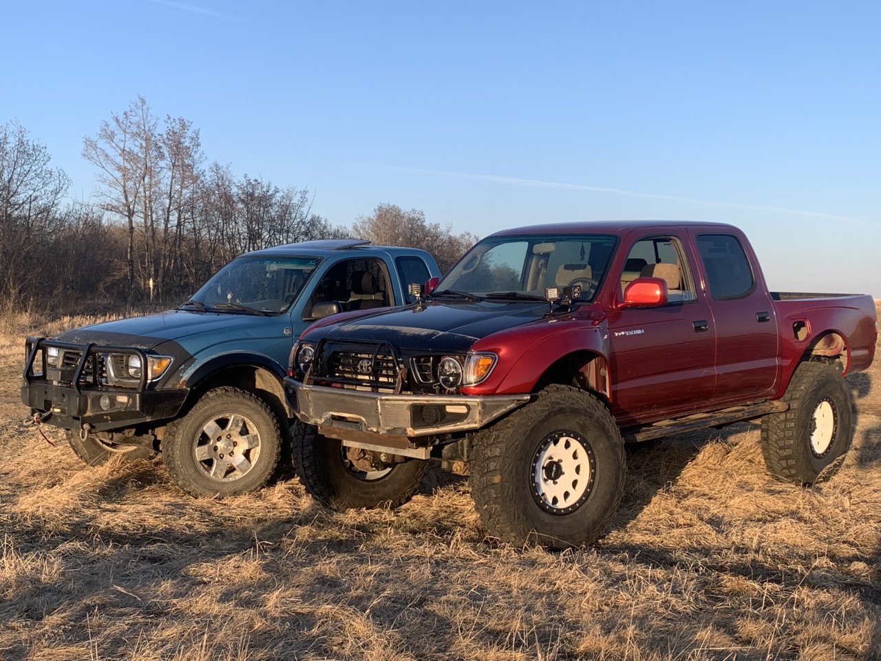

    Had to cut in the rear harness I got with the box. And had nothing but issues with shorts and ghost light ups on the tail lights. So I ordered a new set of bubble lights and threw my LED’s in them. Hooked up. No issues. Thank Christ. Took them all apart again, and soldered and sealed the harness. Glad that’s done.
  11. Apr 20, 2021 at 9:38 PM
    #451
    POSTacoMike
    Nov 4, 2019
    #309824
    1,114
    Red Deer AB
    And there she is. Next to my buddy’s 1995.5 on 32” tires. :D

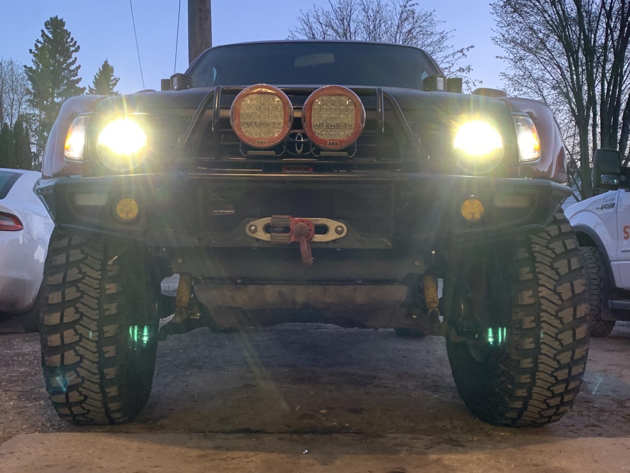

    Gotta burn in the front most box mounts tonight, get my winches on, and lights on the front bumper. Almost ready for some trails.

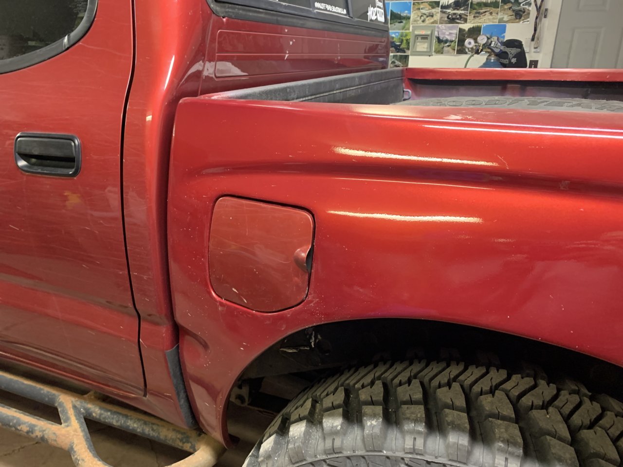

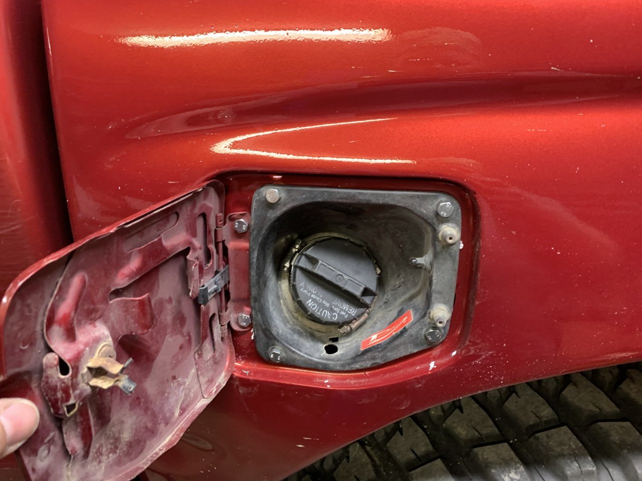

  13. Apr 22, 2021 at 7:09 AM
    #453
    POSTacoMike
    Nov 4, 2019
    #309824
    1,114
    Red Deer AB

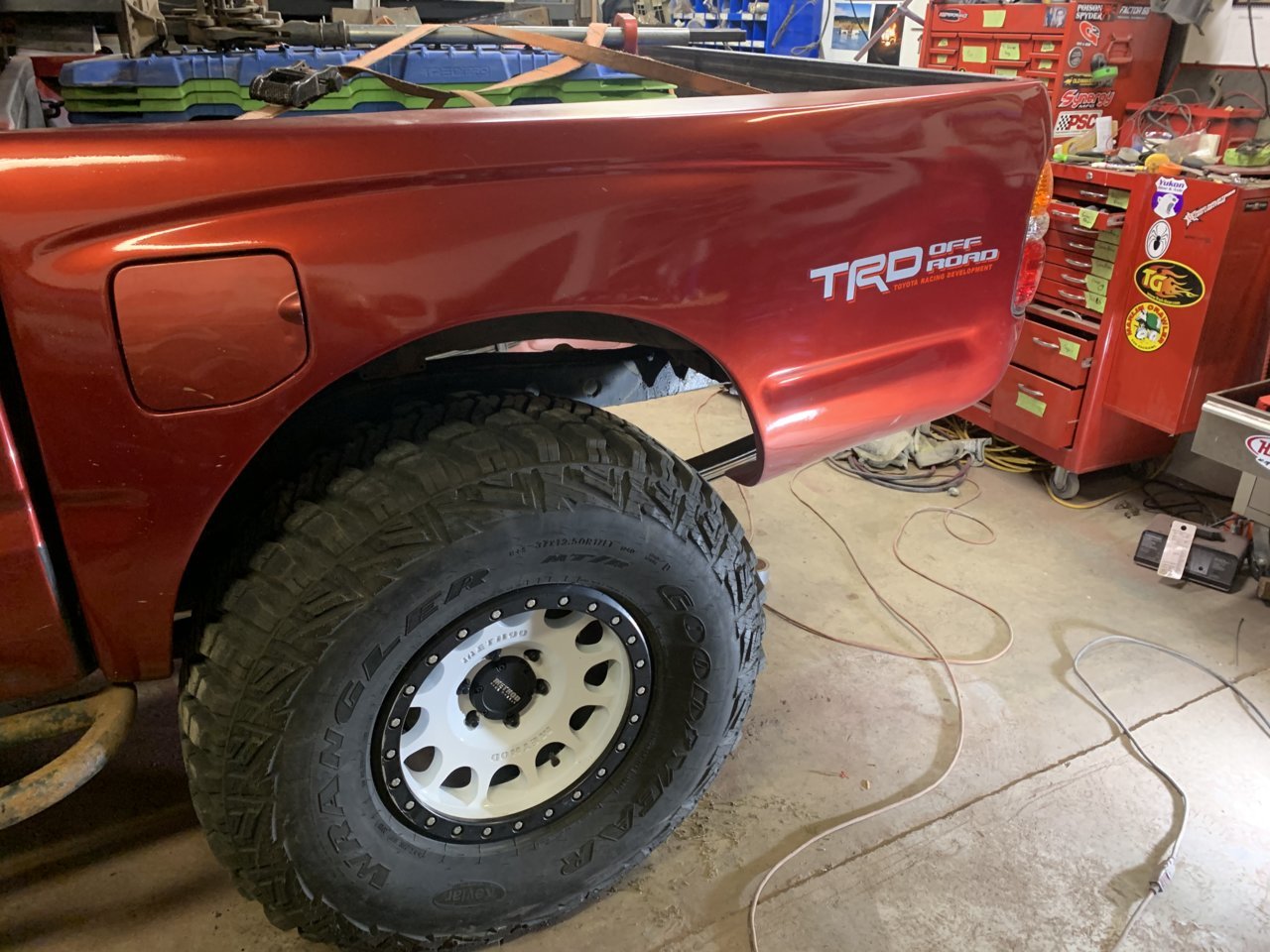

    Gas door and nozzle complete. I also reworked the brace against the frame and the box mount to take some of the stretch. With the flare, it’s definitely put a bit of strain on the flex hose. I’ll keep an eye on it, may have to extend it at some point.

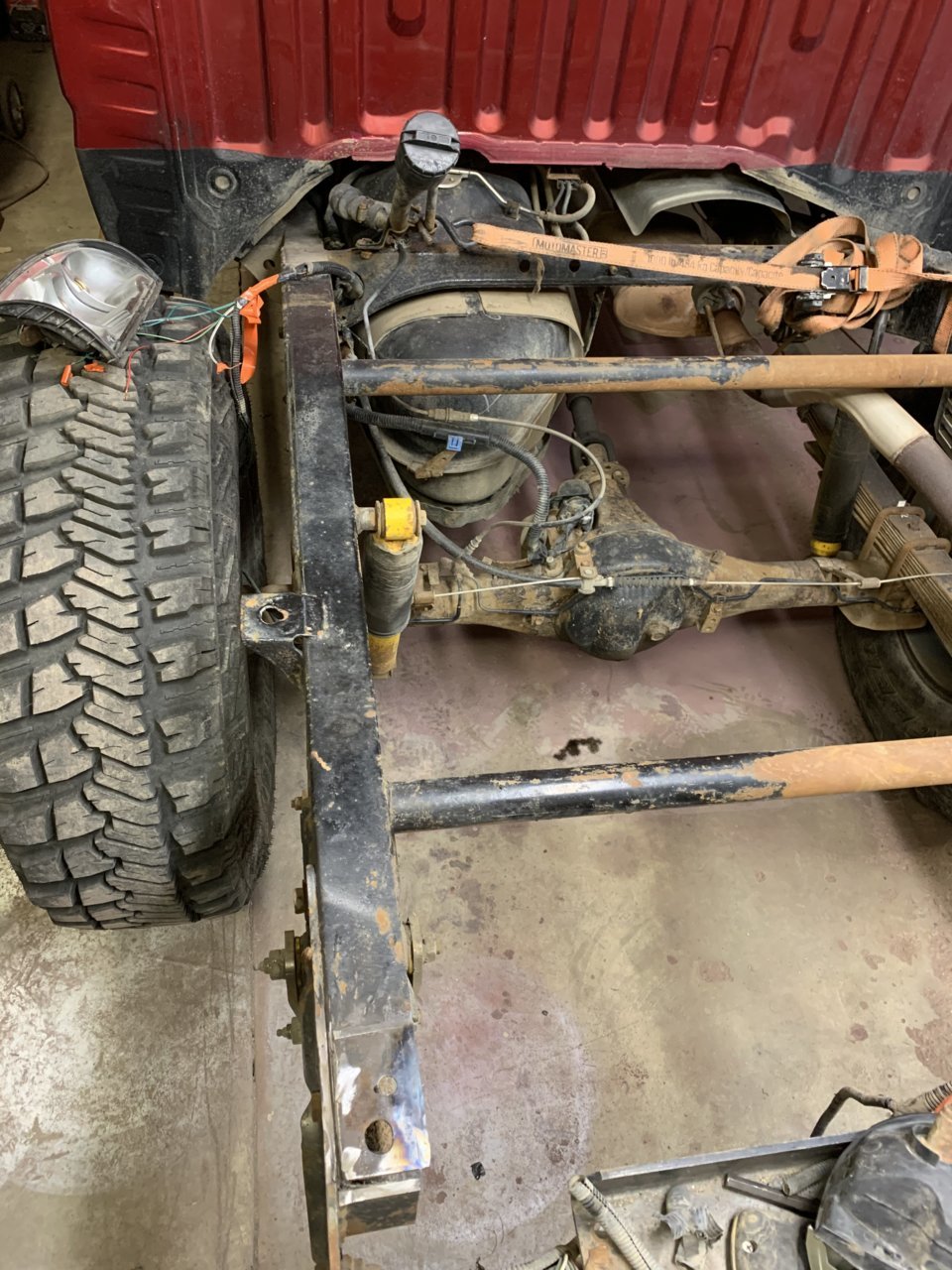

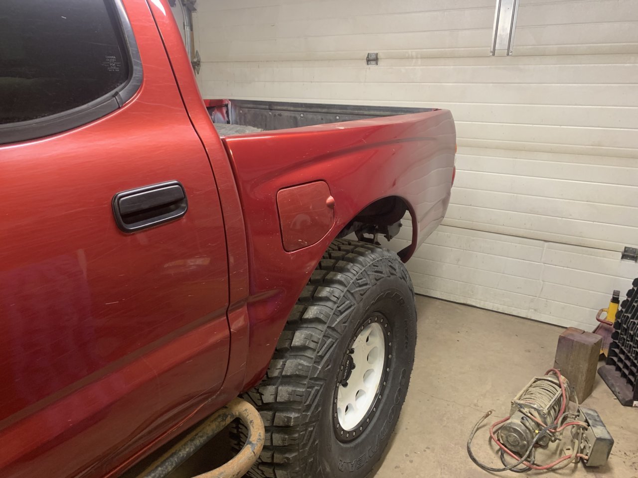

  14. Apr 22, 2021 at 7:10 AM
    #454
    POSTacoMike
    Nov 4, 2019
    #309824
    1,114
    Red Deer AB
    And the box is mounted solidly. Front box mounts are welded to the frame, and she’s bolted down.

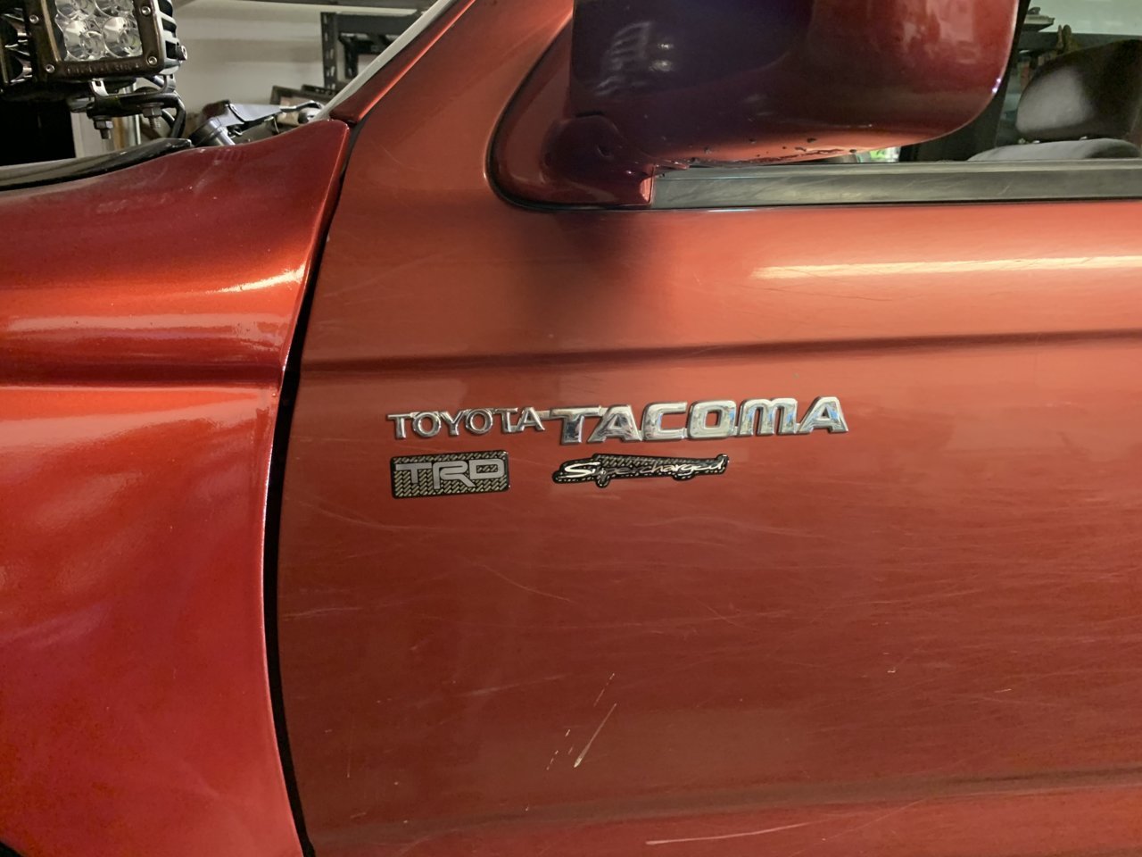

    I also sprung for the carbon fibre look “TRD” and “Supercharged” factory badges, cause I wanted these damn things on my 95.5 so bad back in the day!! :D
