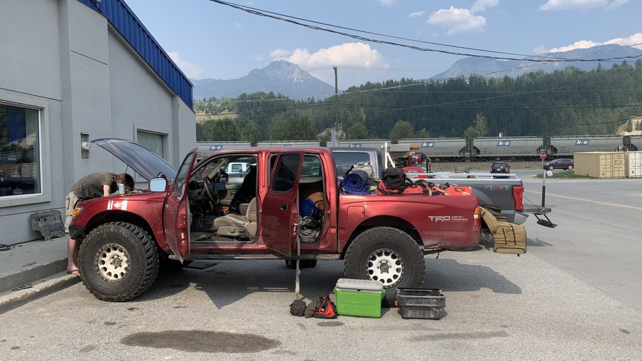

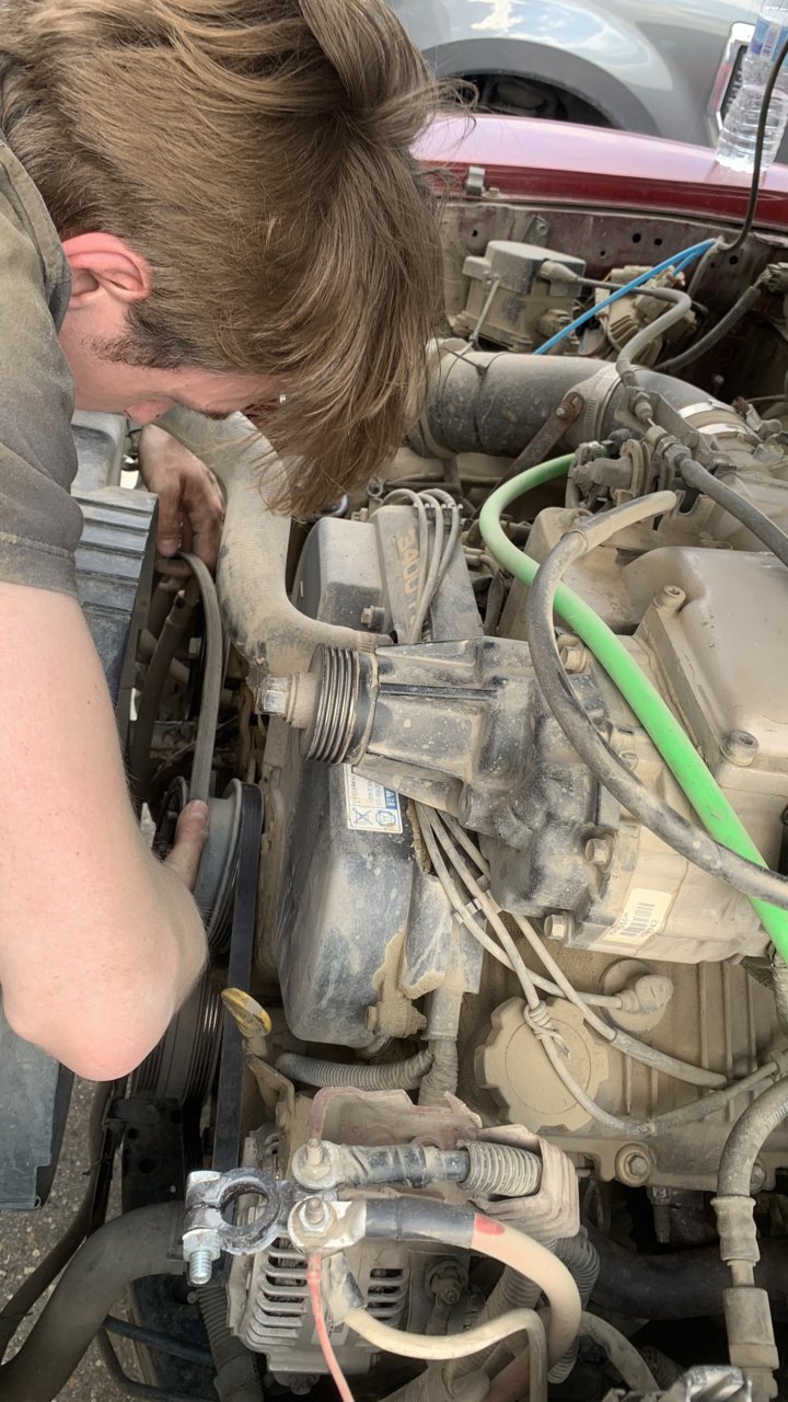

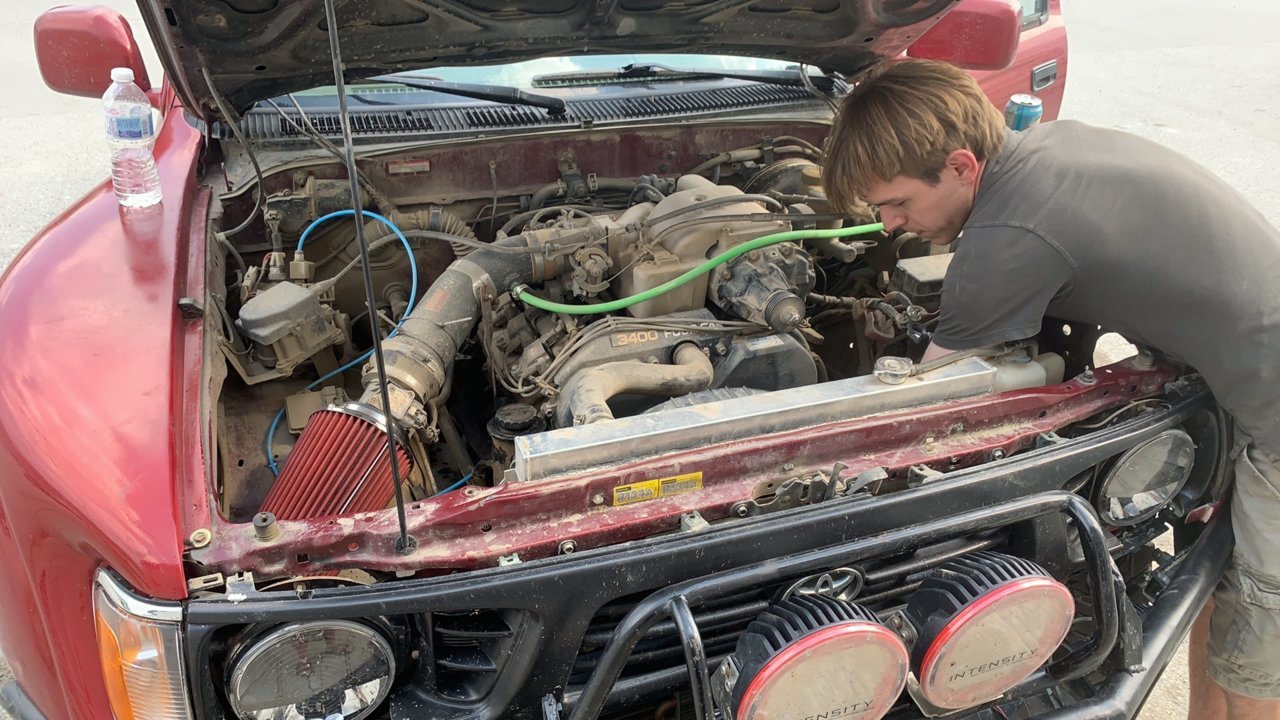

    So, picked up my buddy Peter, in Calgary, as we headed towards the west koots for the weekend. 1-1/2 hours later, the supercharger was squealing like a stuck pig. Turns out the last trip and all the dust had done a number on the needle bearings, and we were in trouble! Golden BC had a Napa, and I bought a regular alternator belt. We had it ripped down, and back together in just over an hour! Now to rebuild (again) the supercharger:angrygirl:

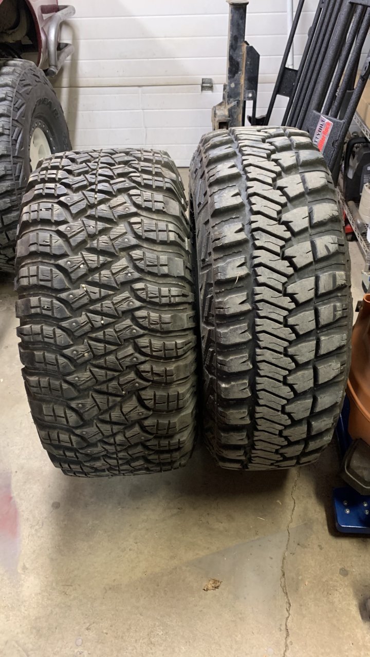

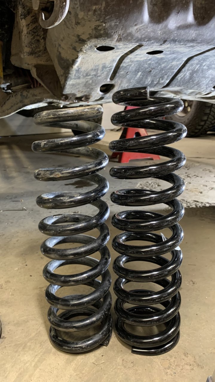

    Something else to catch up quick. I had OME 883’s under the nose with the ARB. I swapped a buddy for what we thought were 882’s to get some ride back. Turned out they were 881’s. And man, did they suck. So, bought some 882’s, Cody paid half, I paid half, he kept the 883’s, and the truck rides and sits great again.

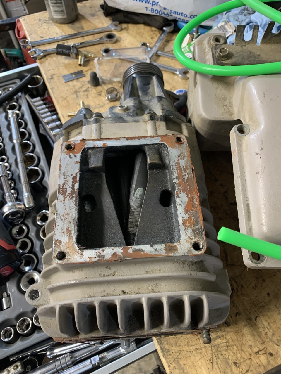

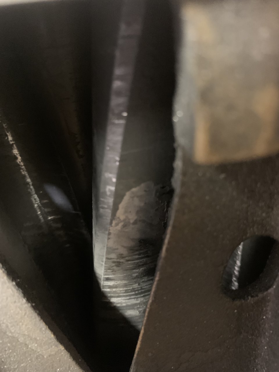

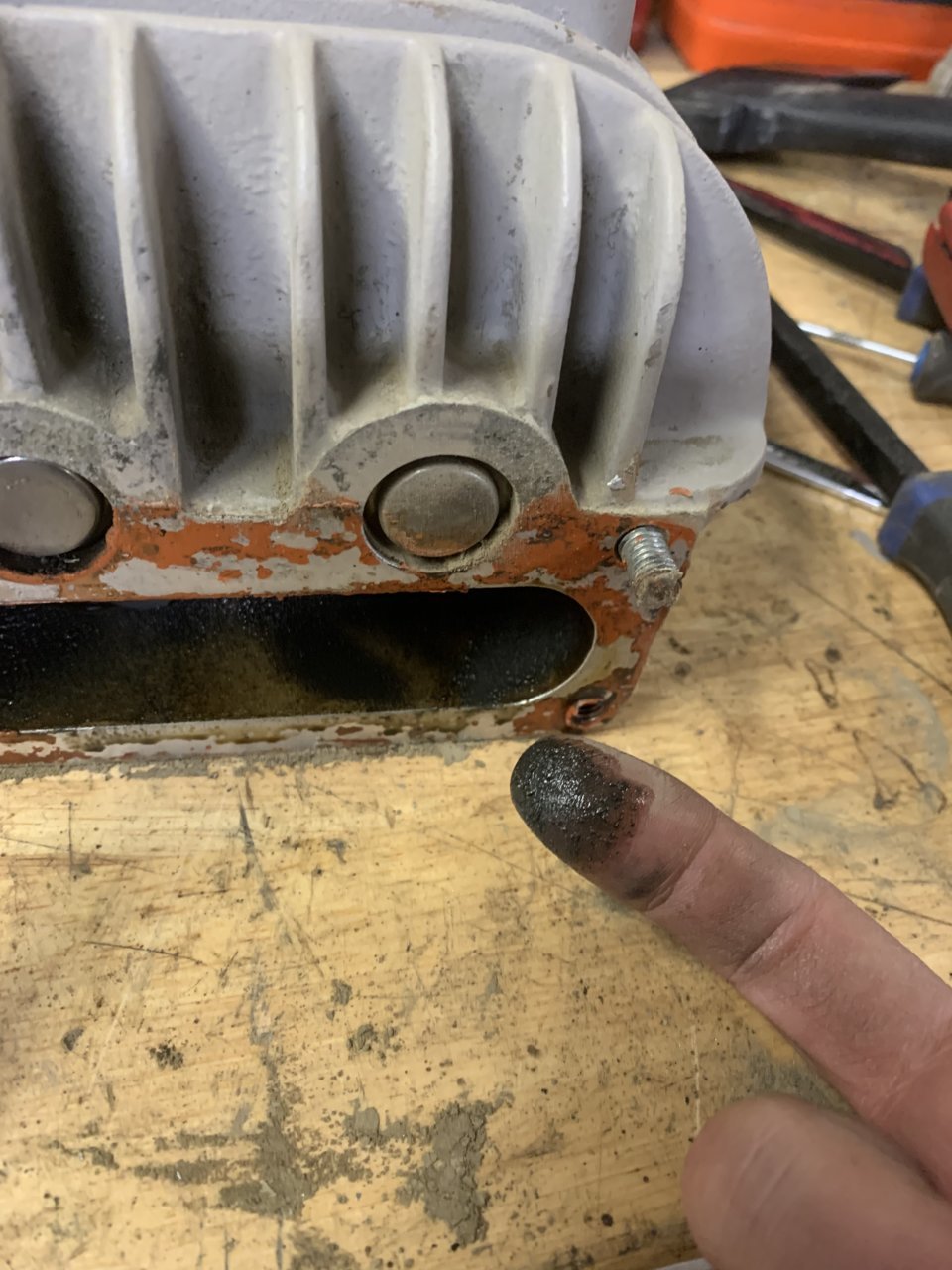

    Welp. That’s ugly. The supercharger is in need of some love. I’m going to take it to a machine shop, see what the can figure out, and if they think they can deal with the housing, I’ll order new vanes.

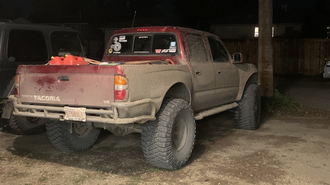

    And the winter tires went on.

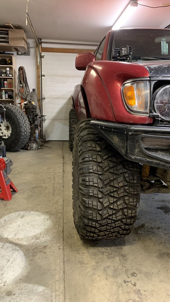

  20. Oct 22, 2021 at 9:58 AM
    #540
    POSTacoMike
    POSTacoMike [OP] On the rocks, please
    Nov 4, 2019
    #309824
    1,114
    Red Deer AB
    2001 Tacoma DC XPreRunner
    OME Suspension, ARB Bumper, frame swap, Rebco logger box.
    But damn. Do I need to figure out some flaps and some flares. I hate having this much mud on her.
