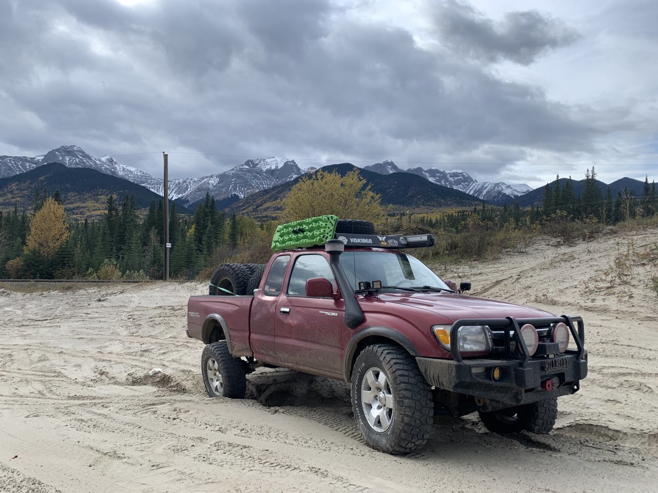

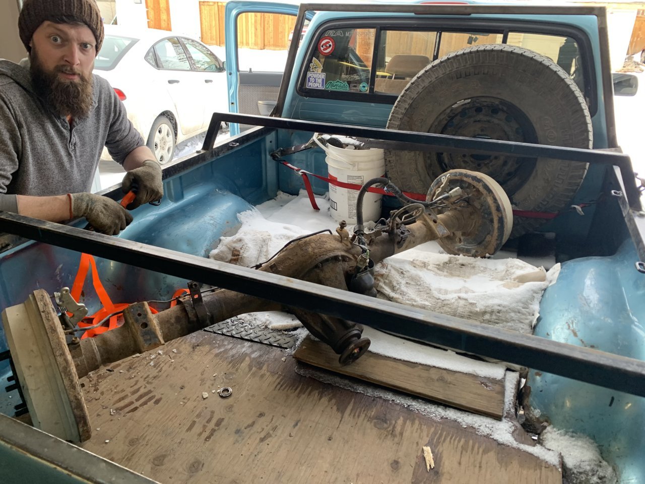

    They just plain work!! The size is perfect, and it’ll go everywhere my buddies do with their jeeps.

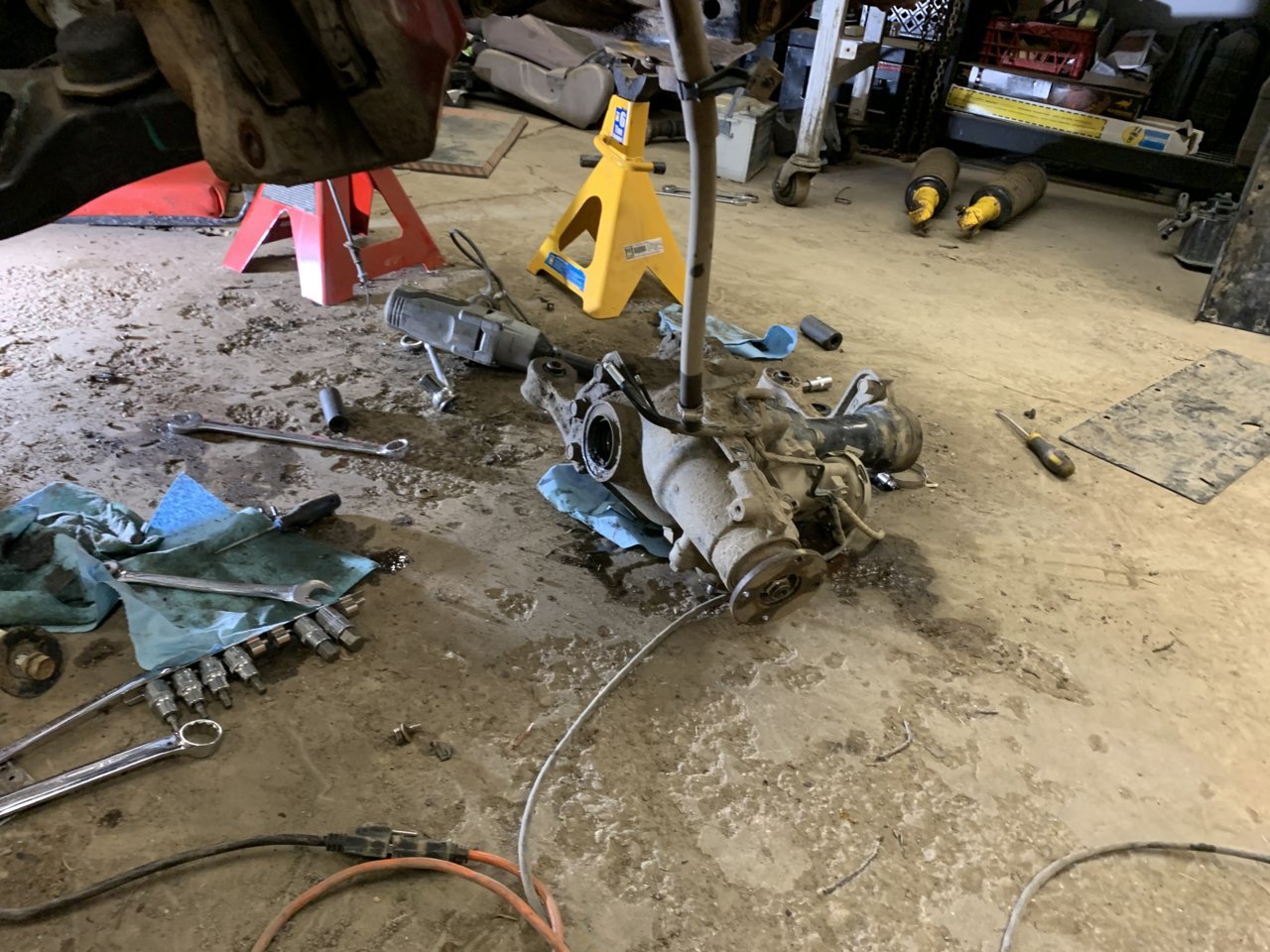

    Got the front diff pulled. Found that pulling the driver side bolts on the steering rack, and loosening the passenger side to give the rack a bit of movement definitely helps get the diff out. I won’t be reusing this one, I have one with 4.88’s and an ARB waiting to go into the double cab.

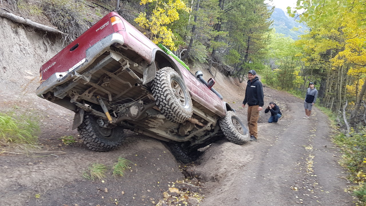

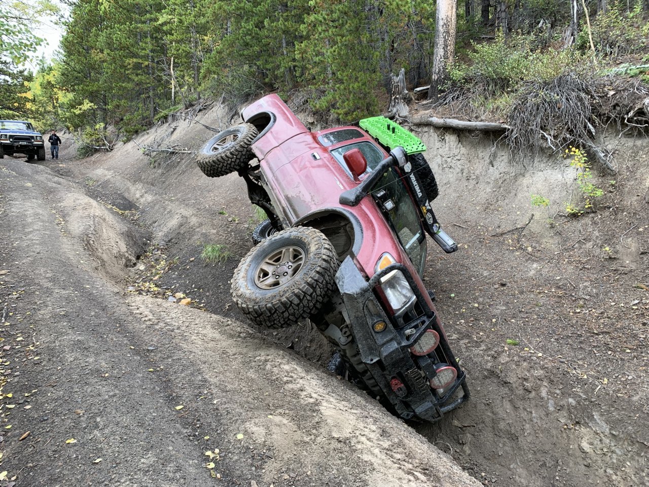

    Next trip out was to Grande Cache. And I didn’t listen to my spotter :thumbsup:

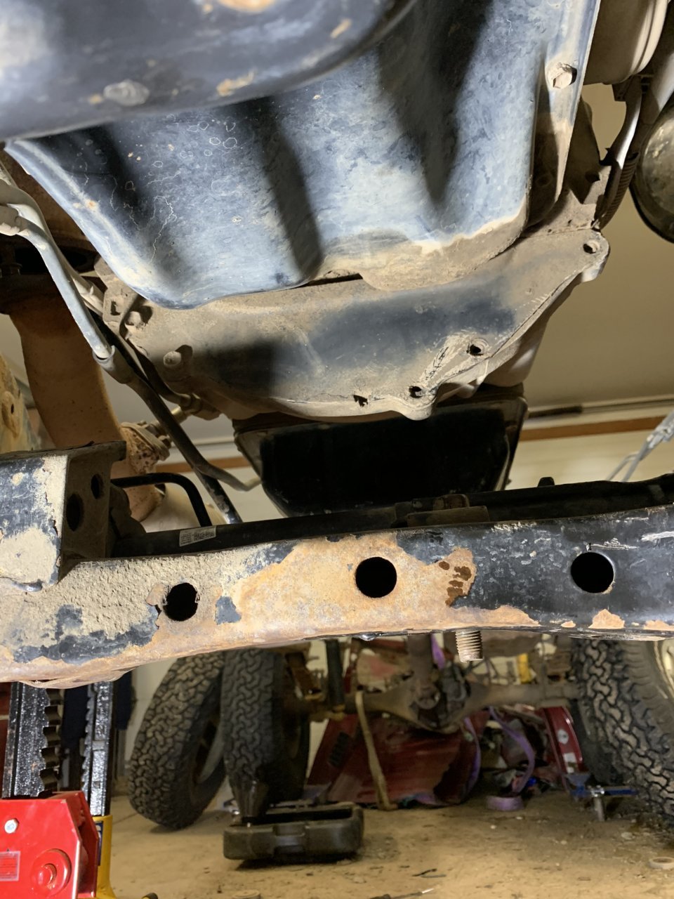

    Frame checks out clean!

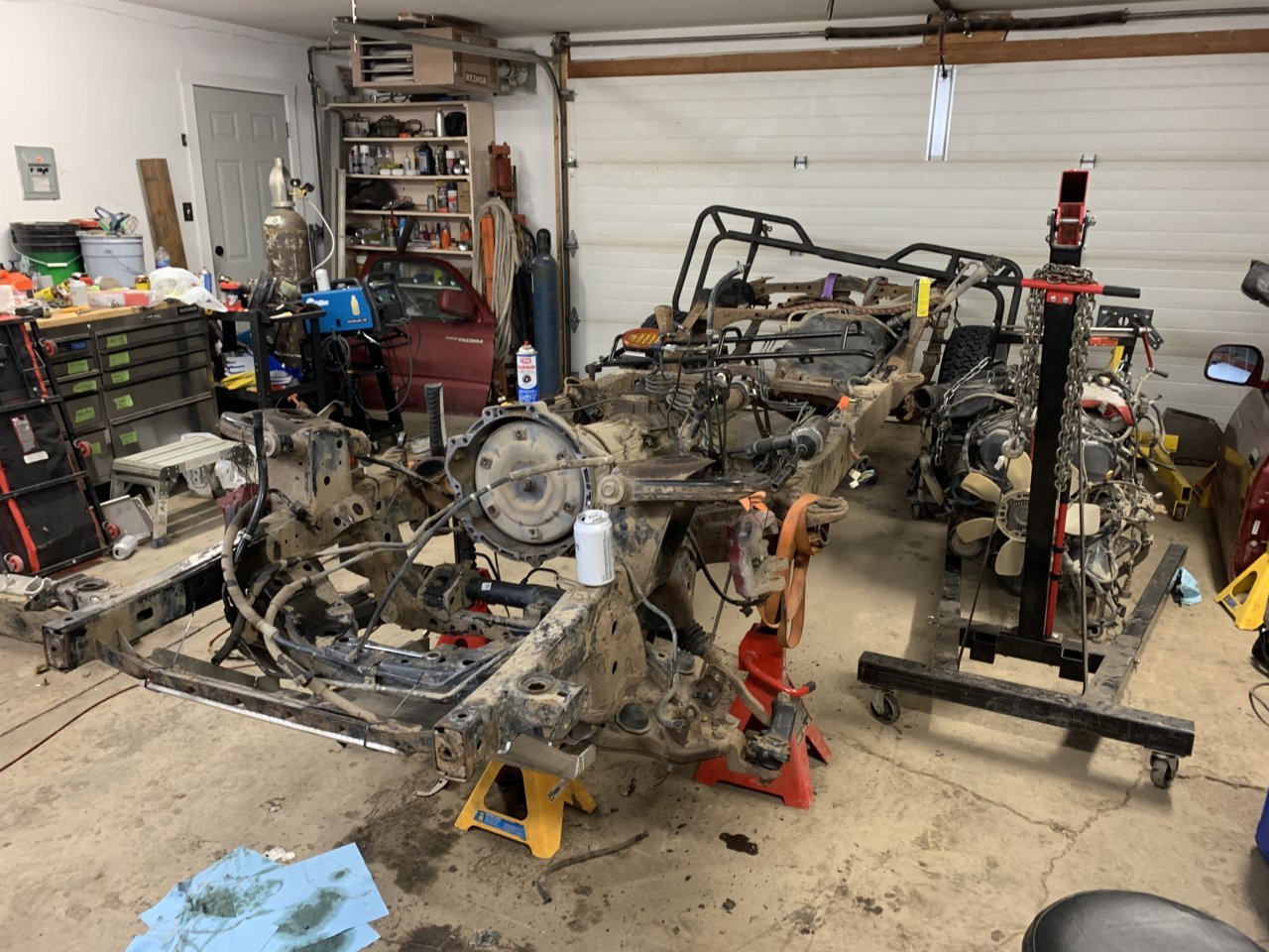

    Motor’s out. Man, I can’t believe how easy this really is. And it’s blizzarding like a MF’er today, so driving a 2wd prerunner sucks balls. Locked, full throttle, stuck like a chump everywhere!

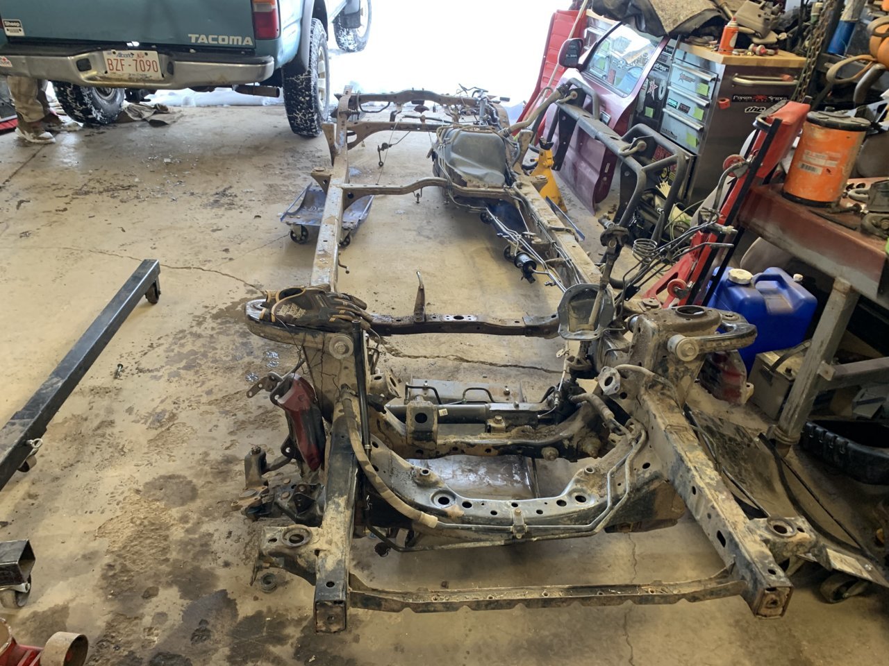

    And she’s stripped and will be headed to the back yard to wait for fall. Now the double cab comes in, and the work begins!

    My buddy grabbed the spare rear end, he’s going to throw it under his 95.5, so he’s got a rear locker.

    Took a run to grande cache to get my 4.88’s from a fella that hydro-locked his 4runner. $600 Canadian got me a matched pair with an ARB front locker, and a Toyota rear elocker. 11 hours round trip, but worth it to me.

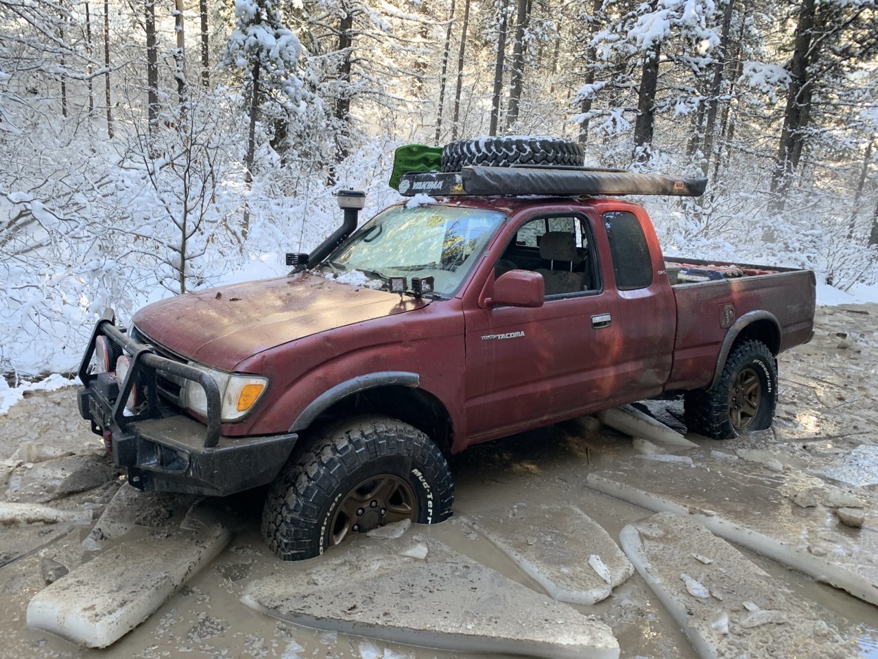

    Hung up on ice. The indignity of it!! :rofl:

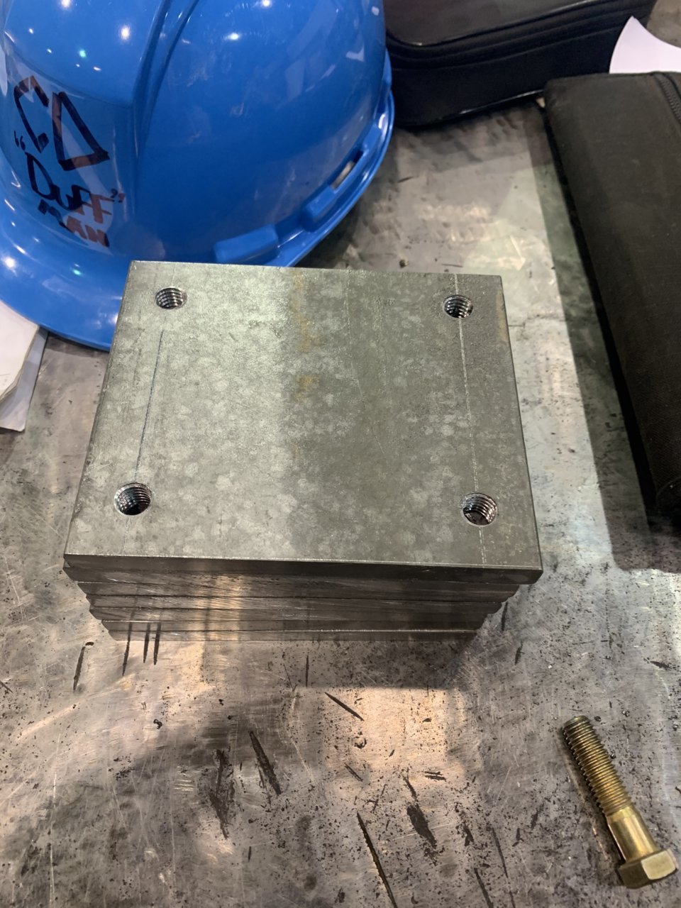

    Fabbed up 8 6”x5” plates with 4 tapped 1/2” NC thread holes for sliders. 4 mounts, 4 1/2” bolts per plate, 16 per side. I’ll weld these to the frame and coat them. Should be sufficient to hold the weight of the truck. This way the sliders are removable, should I want to pull them.
