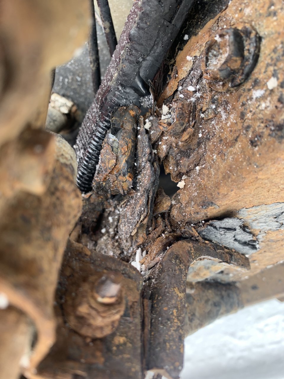

    Definitely got my work cut out for me, she’s got some rust. But at least once done, it’ll be good

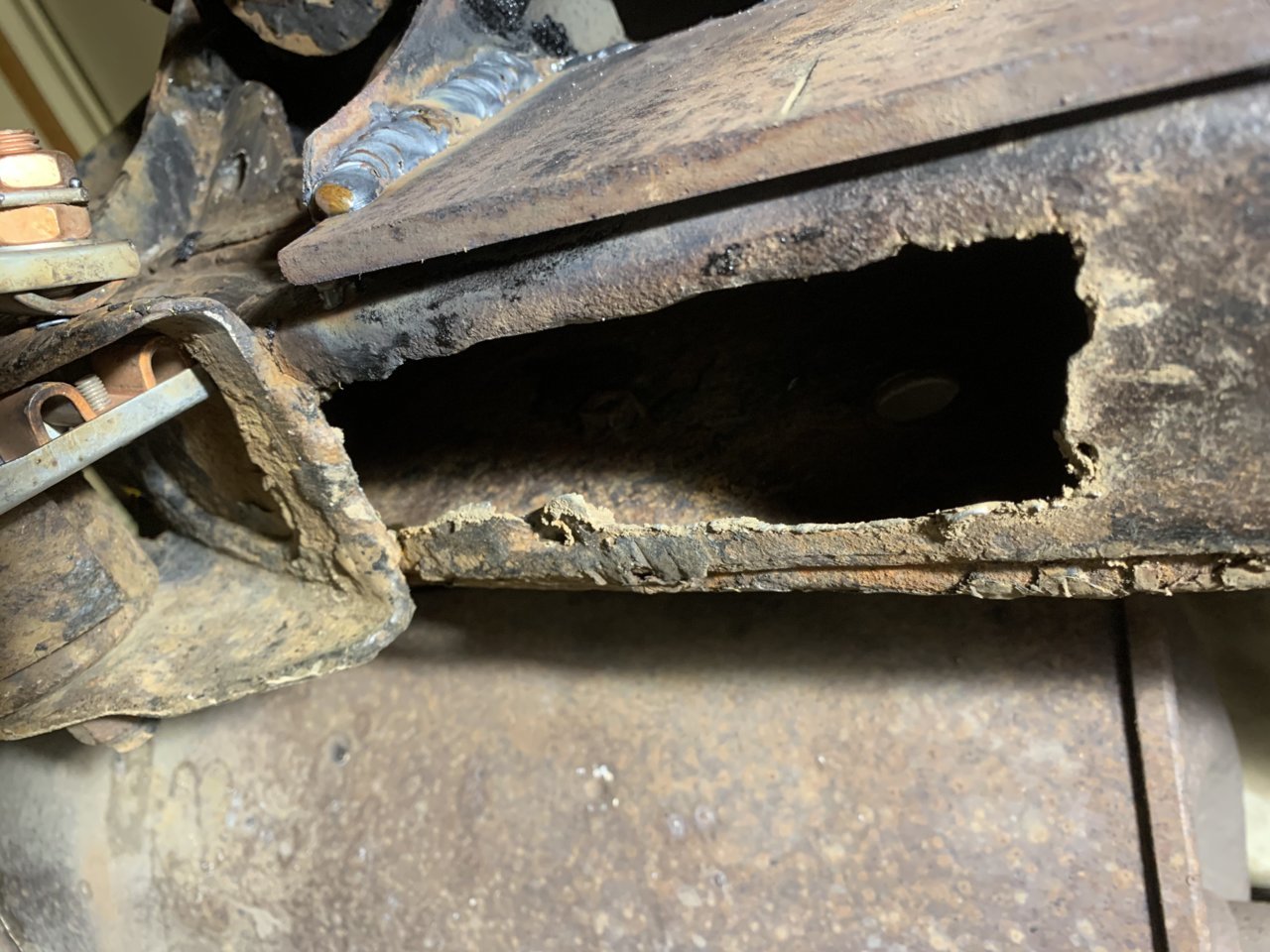

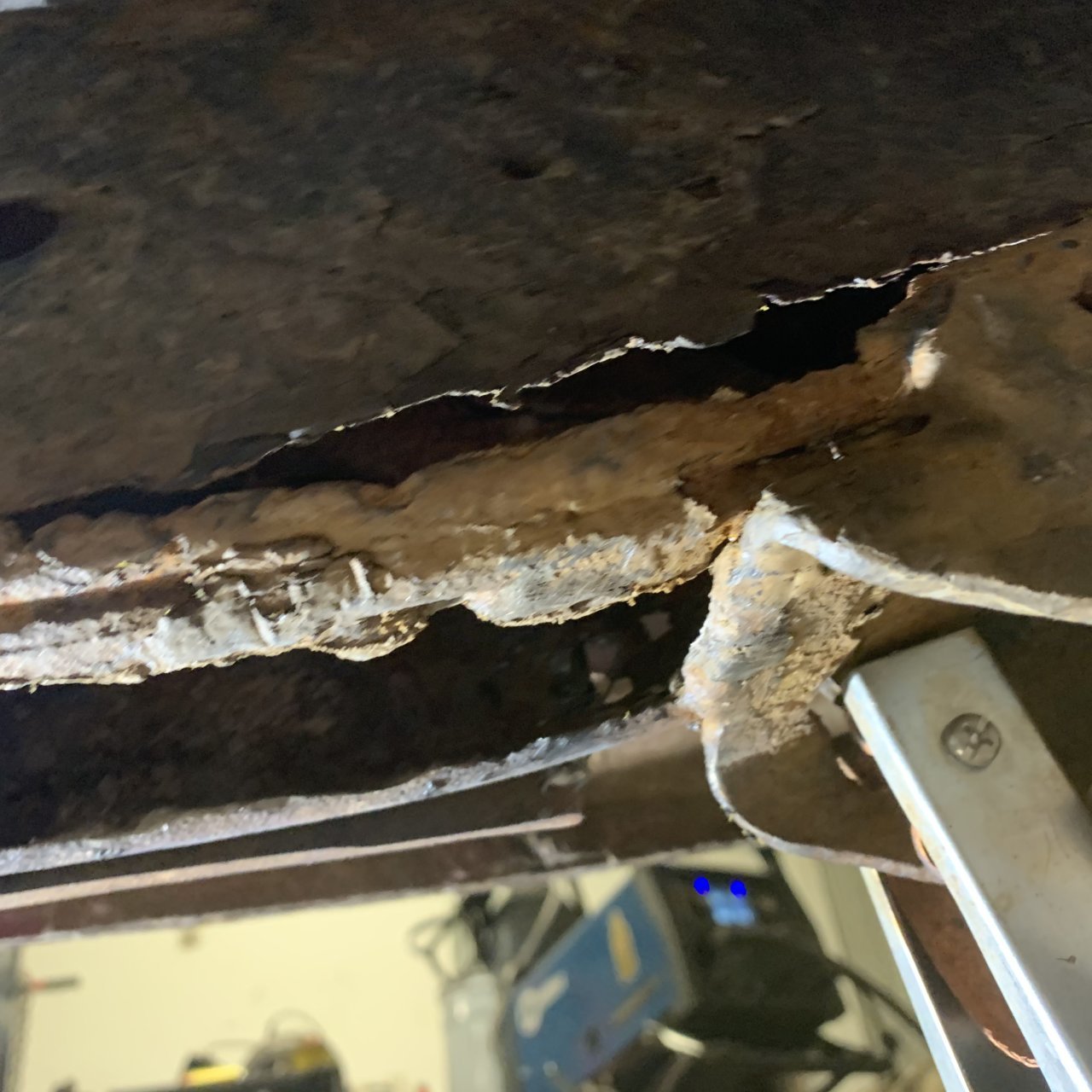

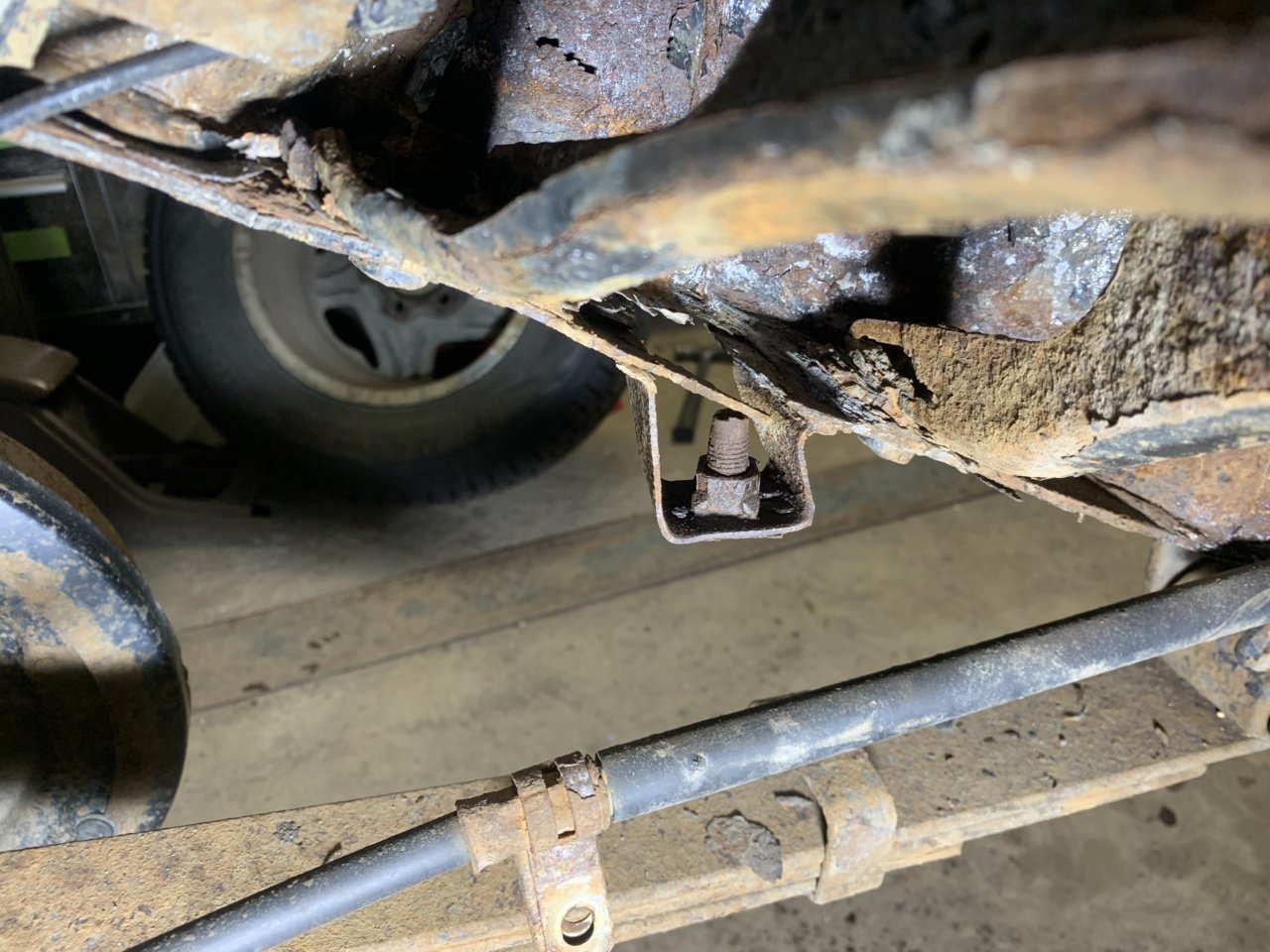

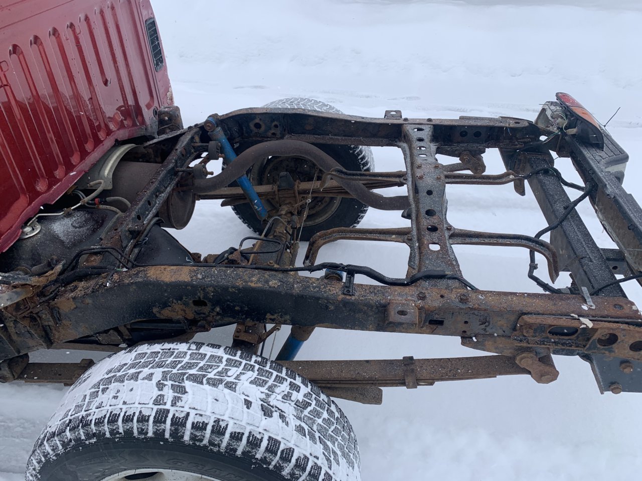

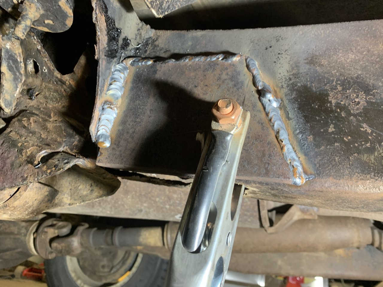

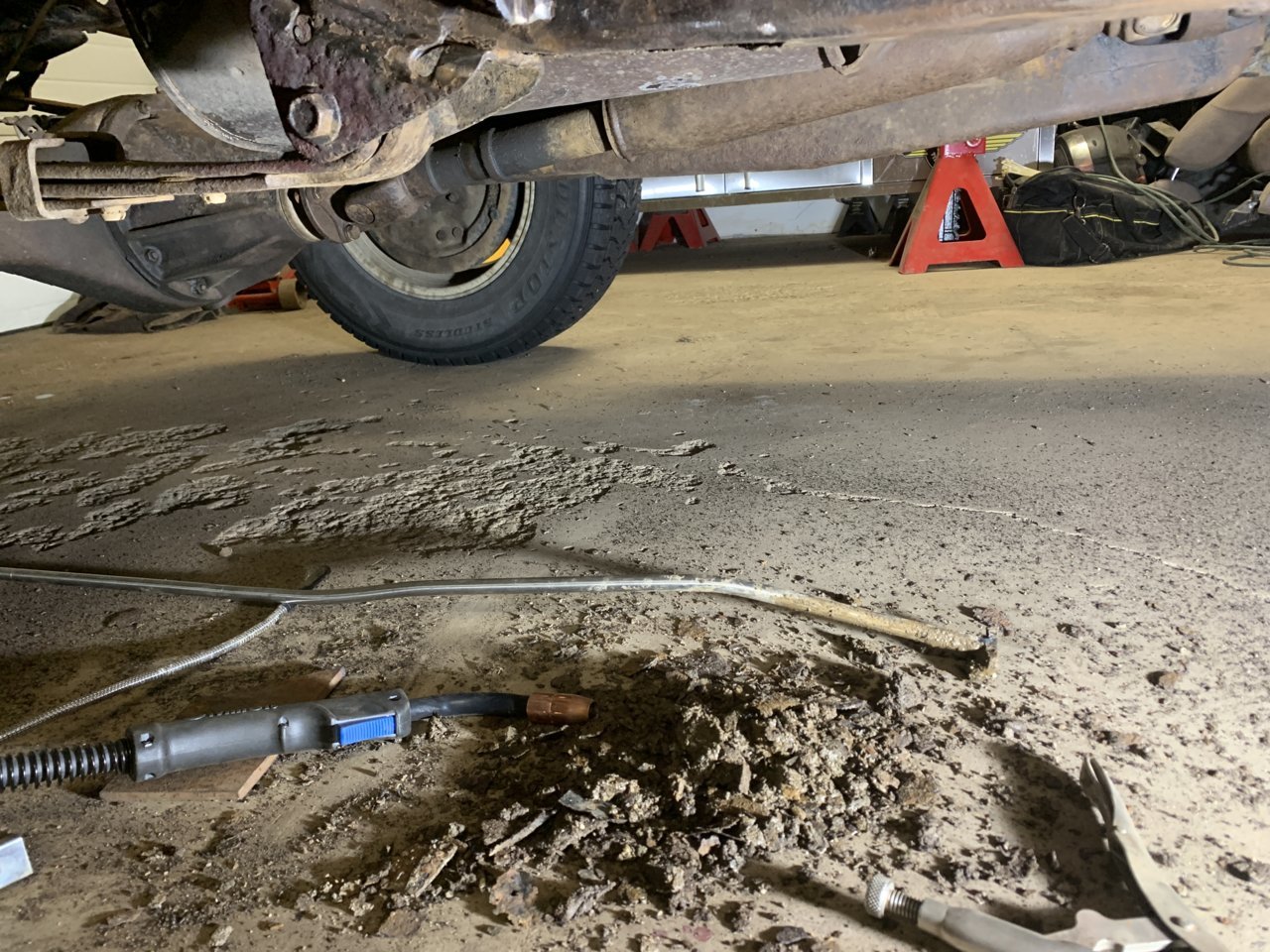

    Got into the passenger side of the frame. Most of the frame rail along the spring mount is gone. I started with a piece of 1/4” on the outside, I’ll get to the same on the inside, then cap the bottom with the same, so that once it’s done, it’ll be good and solid. I also built a “rake” to get into the frame and remove the debris. I’m thinking that what this frame needs is 2 or 3 3/4” holes along the bottom, then hit it with a carven hose for a couple hours, and just let it run. Find some rubber caps that will fit the hole, then a couple times a year, pull them and clean it good.

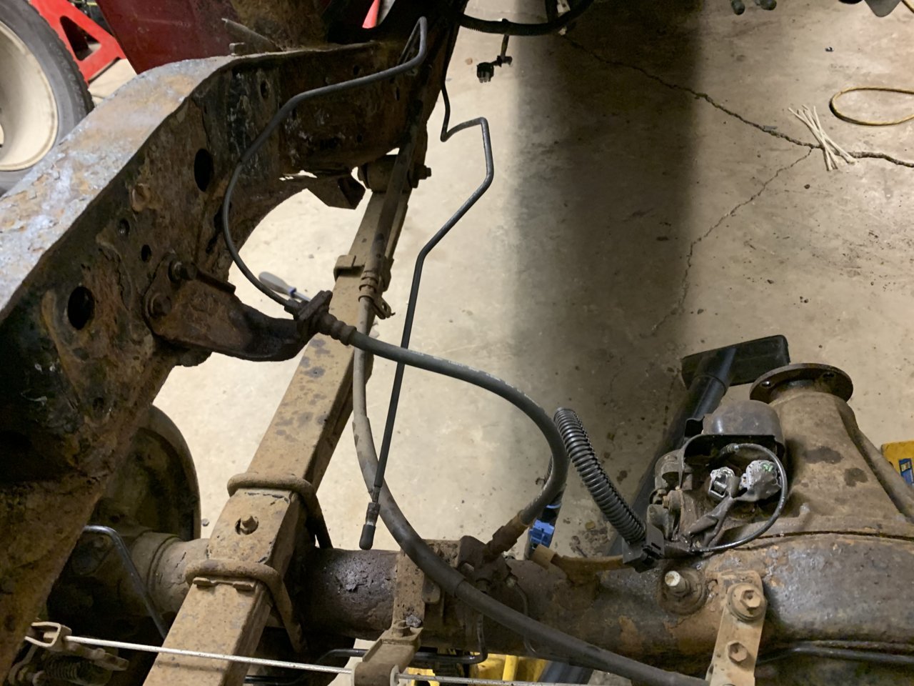

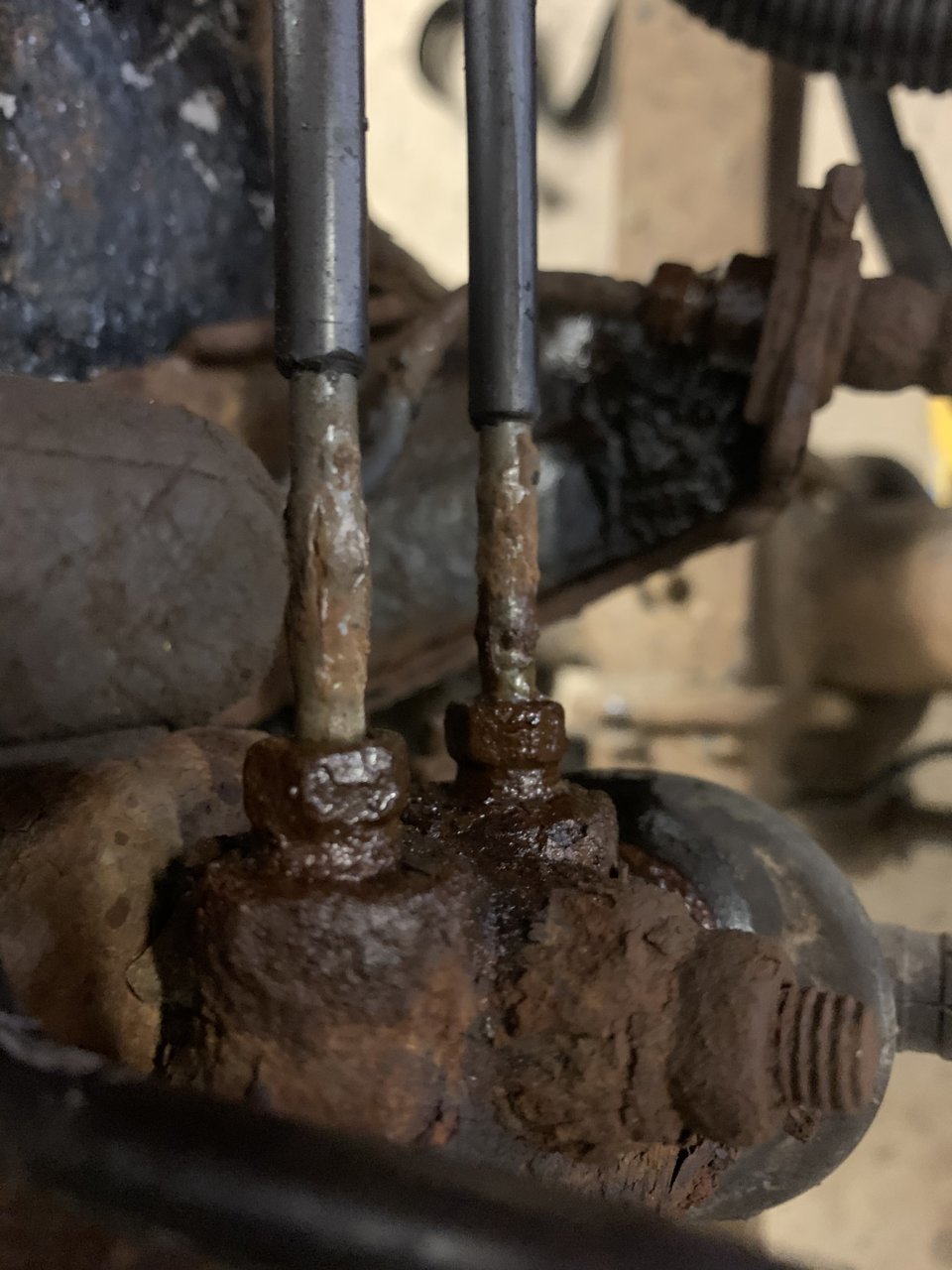

    Eliminated the rear proportioning valve. Rusted out, unable to be bled garbage.

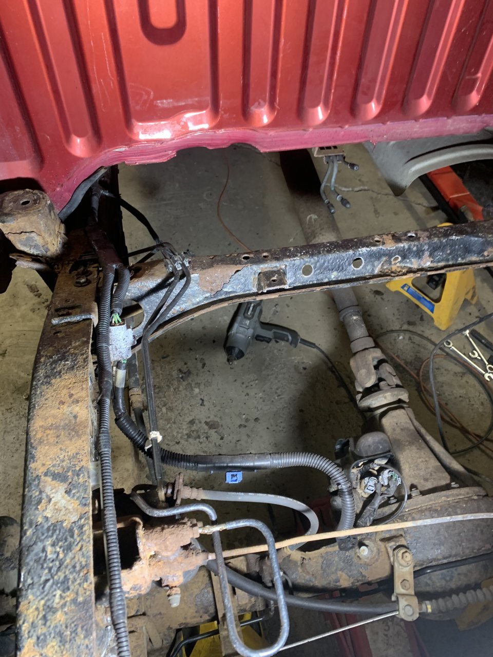

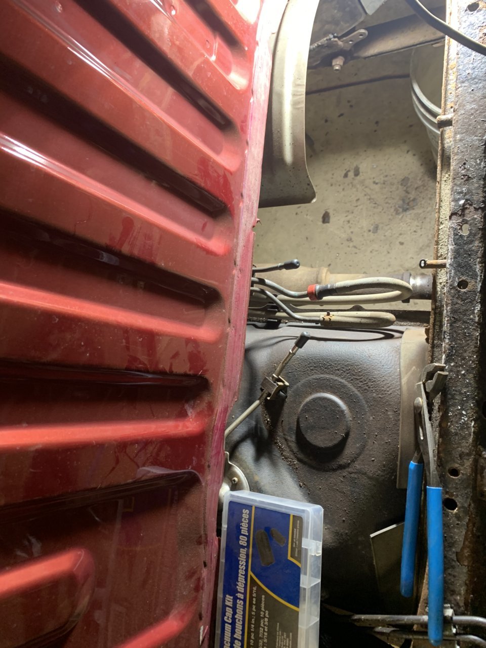

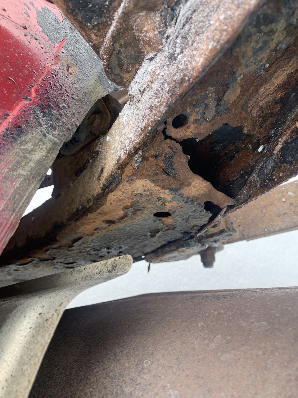

    Dropped the gas tank, so I can get at all of this frame. I’m going to wind up boxing the whole thing, so may as well have as much access as possible. The rust. Damn.

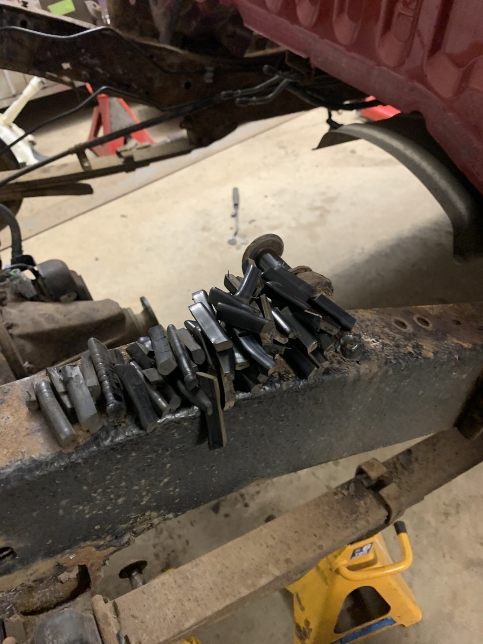

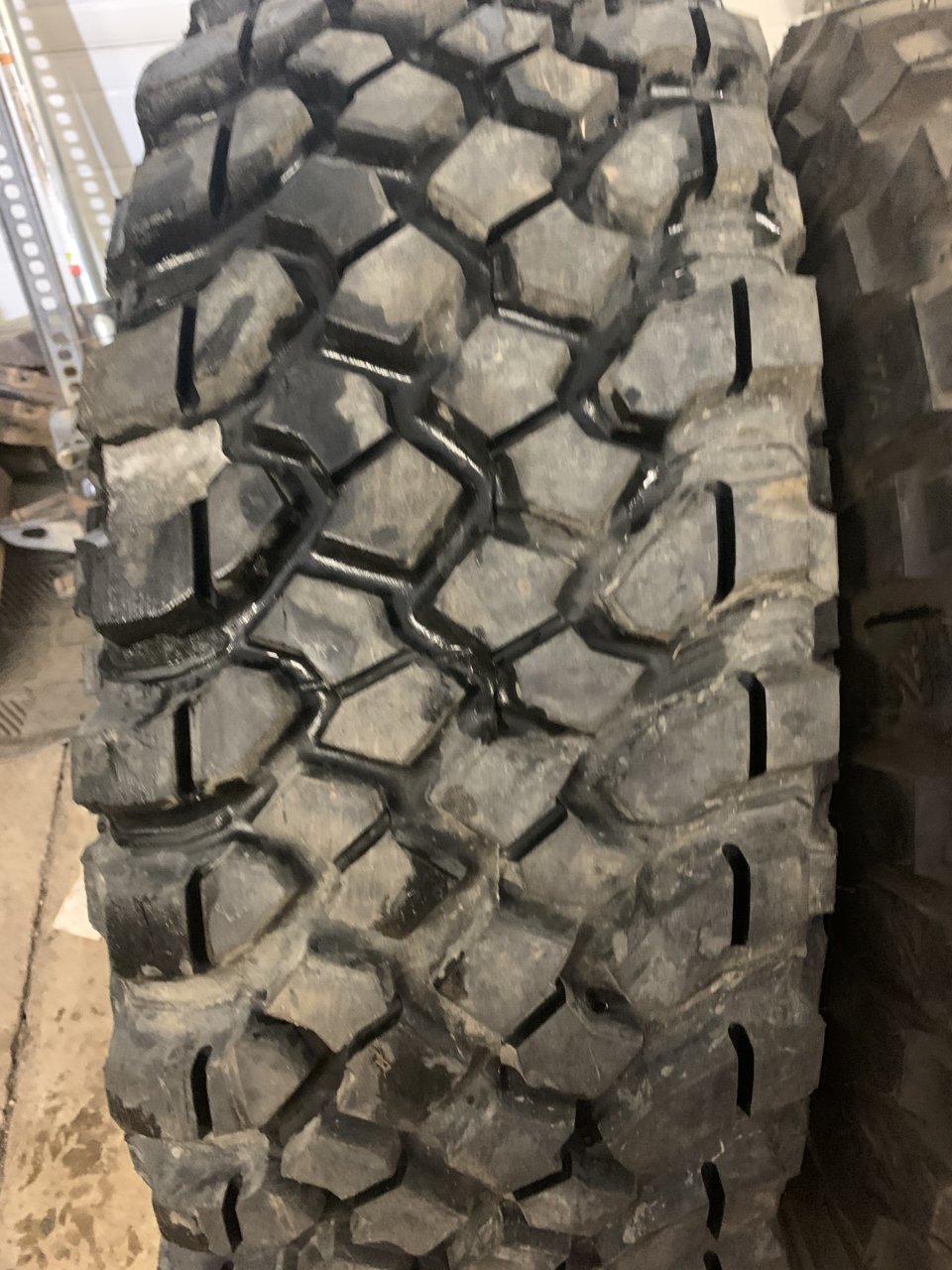

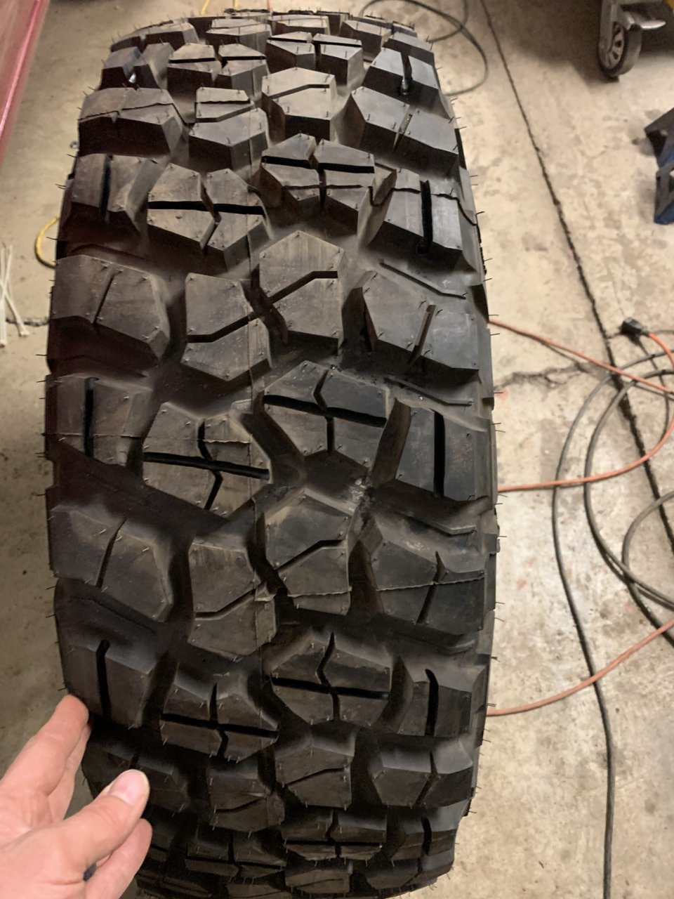

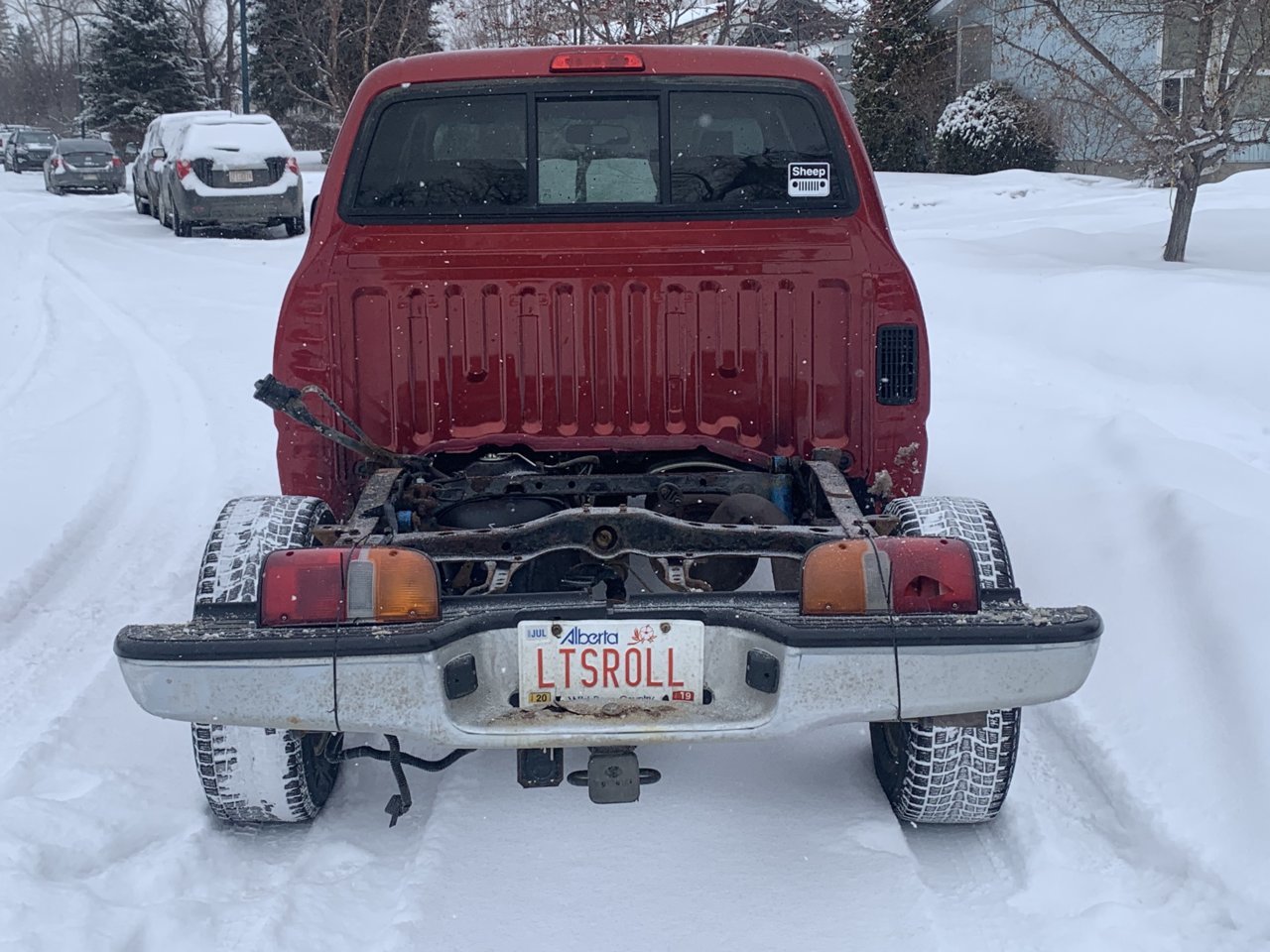

    And since I ran out of steel, I grooved one of my spares for snow wheeling. I need to get a siping tool as well, this groover is the best I’ve seen, but doesn’t sipe tires.

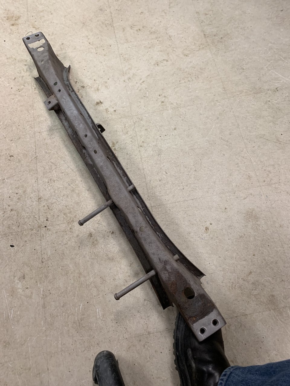

    Sand blasted the front box area crossmember. Steel is still pretty good, I’m going to clean this, cut it to fit once the frame is all boxed, and then take it and powder coat it. Leave edges clean, so I can weld it in. At least the majority of it will be coated, and the edges I weld in can be painted then rust coated.

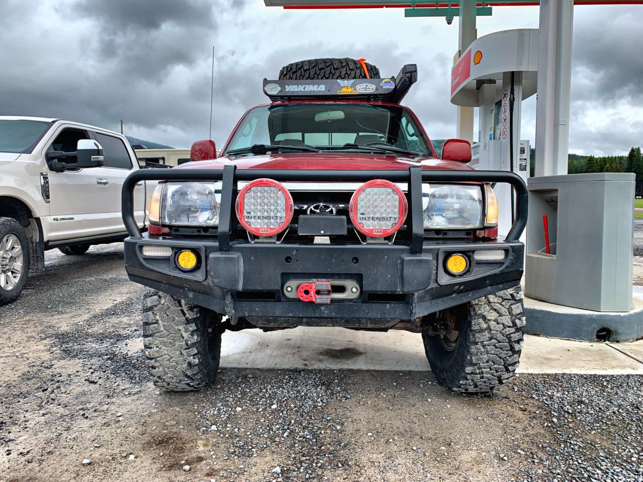

    Say do you have a source for the bezels(?) that you used to install in the cutouts on the ARB, for the fog lights and turn signals? That’s a sweet mod on the bumper. I’ve been trying to figure out a way to mount some fog lights in the bumper.

    Thank you! For sure let me know if you do get this way. I'd be happy to tale you for a run. The bezels and signal/marker lights I used are ARB, from an ARB FJ Cruiser bumper.
    Part numbers;
    3163015 is the ARB # for the surrounds
    6821287 is the ARB # for the signal/marker lights.
    6821201 is the ARB # for their fogs. I used a set of revolvers from Inspired Engineering. Had to build my own support for those tho.

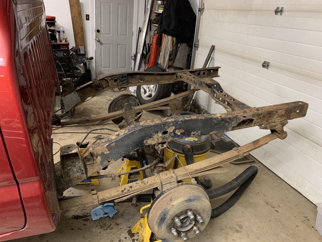

    So, I decided to part ways with my not yet scheduled 98 that needed the frame. I kept the frame, and sold the truck for a good price, to a fella looking to do a 3.4 swap into his 90 pick up. Now to move the frame back to the garage, and box it. It’s in excellent shape, and I may as well use it, rather than pitch, patch, and patch some more on the dc frame.

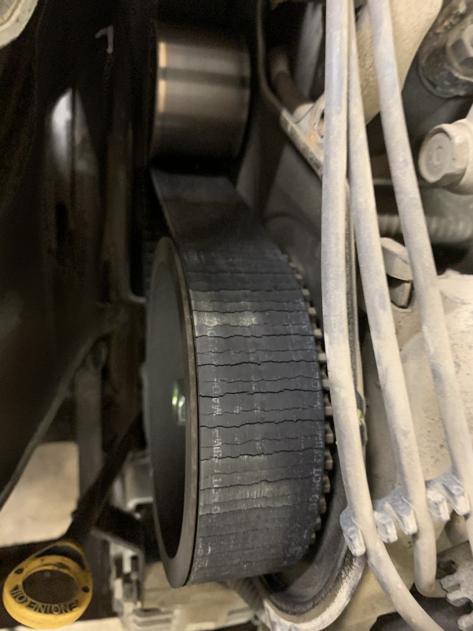

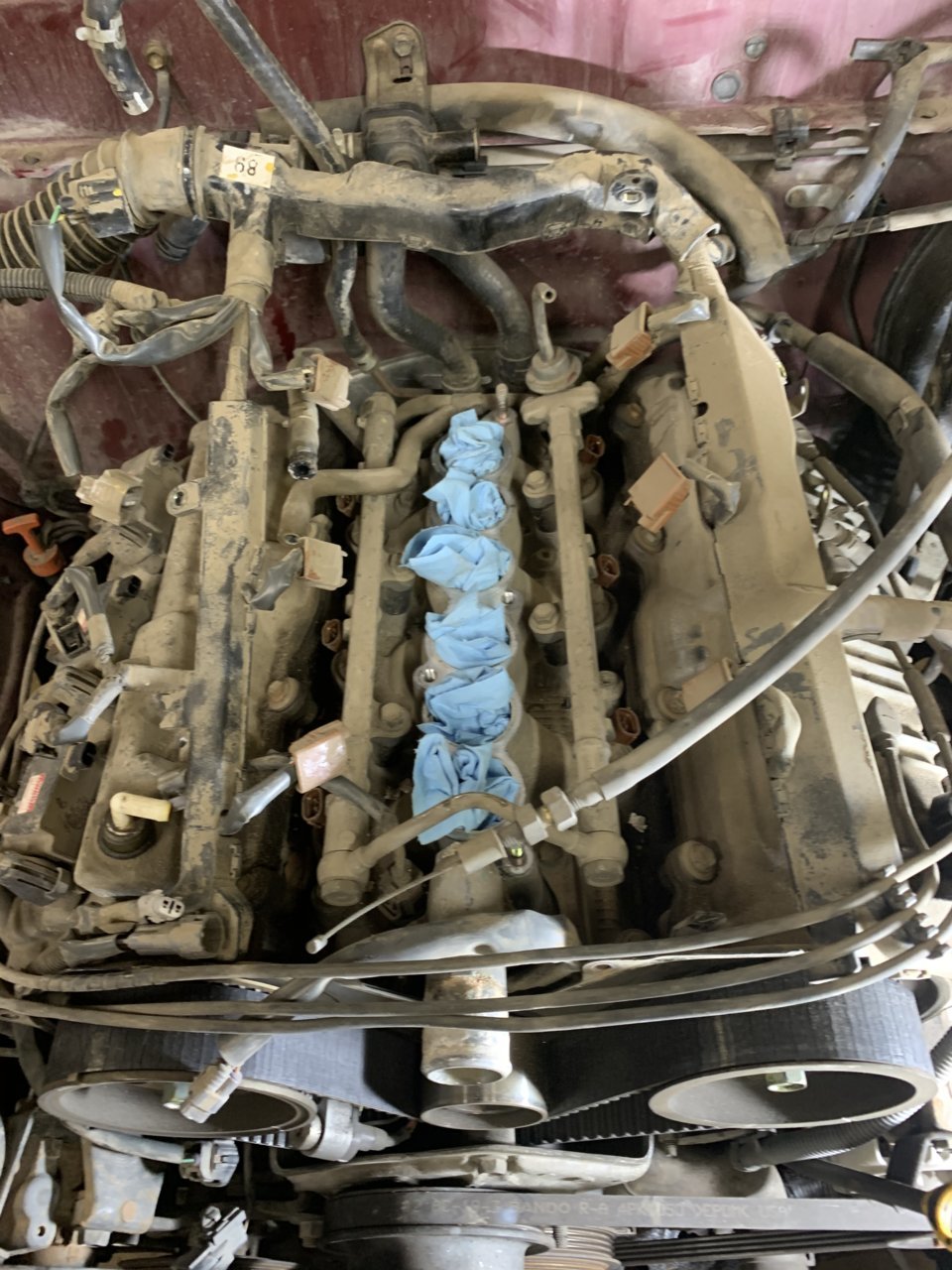

    The more I do, the more I need to do. Pulled the timing belt cover, as I needed to get at a nut on the intake. The belt was changed 54k KM ago. From the looks of it, they used a used one! May as well do the water pump too, and I’ll be doing the valve cover gaskets as well.

    Figured since I’m pulling the motor, to make the frame swap a little easier, may as well break it down so the harness can stay with the cab, and I can do some clean up. When this goes back in, I’ll be dropping the supercharger into it.
