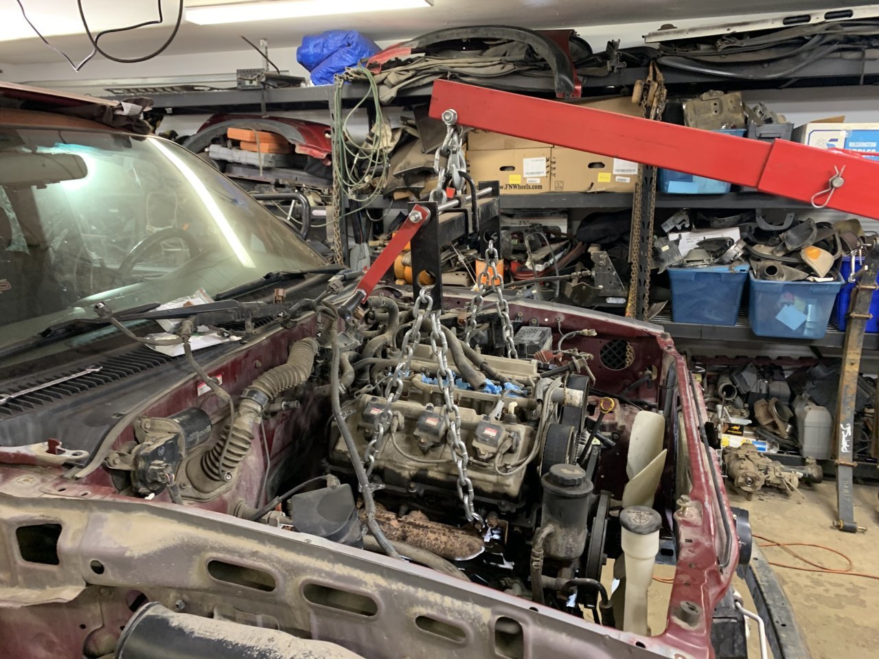

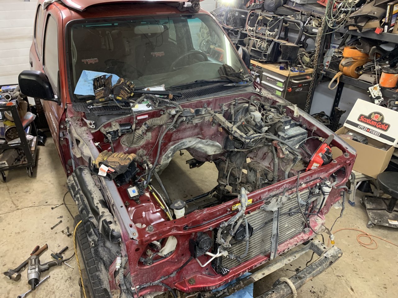

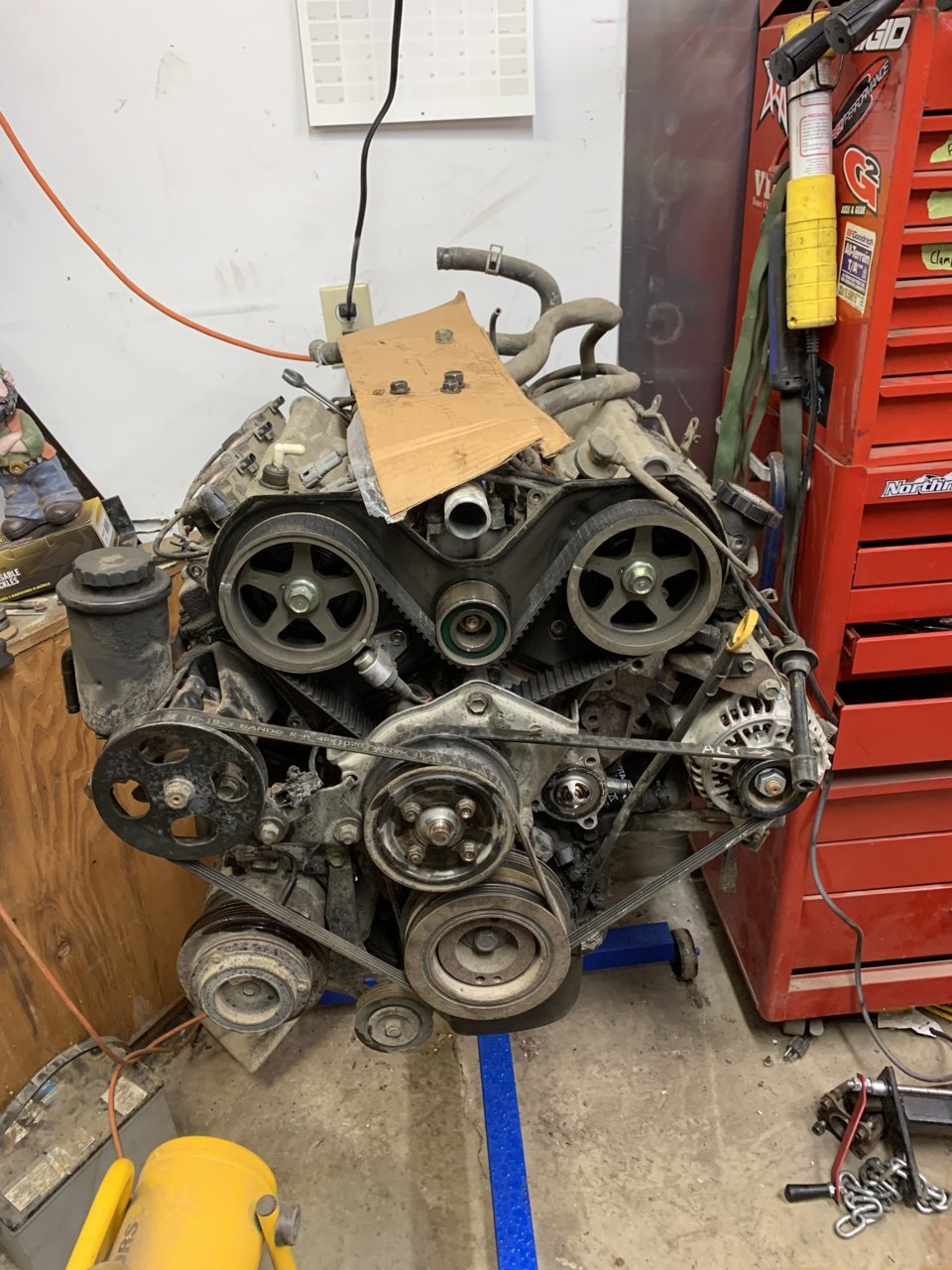

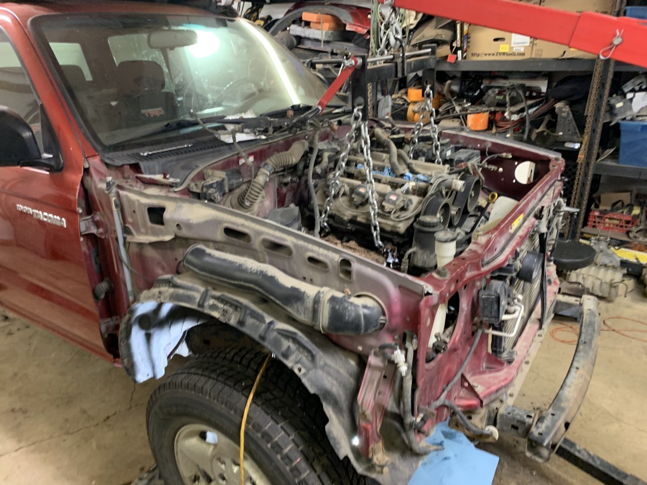

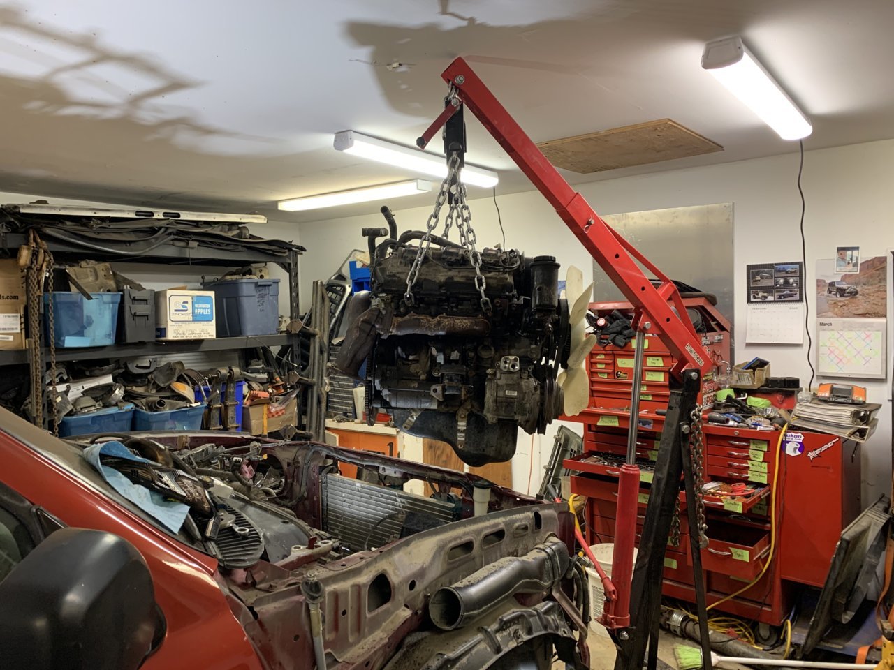

    Motor and trans are out!! Now to get the cab blocked up, and slide the prerunner frame out. I’ll move the pos frame back to the garage, and weld, clean and paint it, before moving it under the truck. Man, the more I’m looking at this frame, the more I’m happy I kept the pos’s frame. I’m truly shocked this frame has not broken yet!!

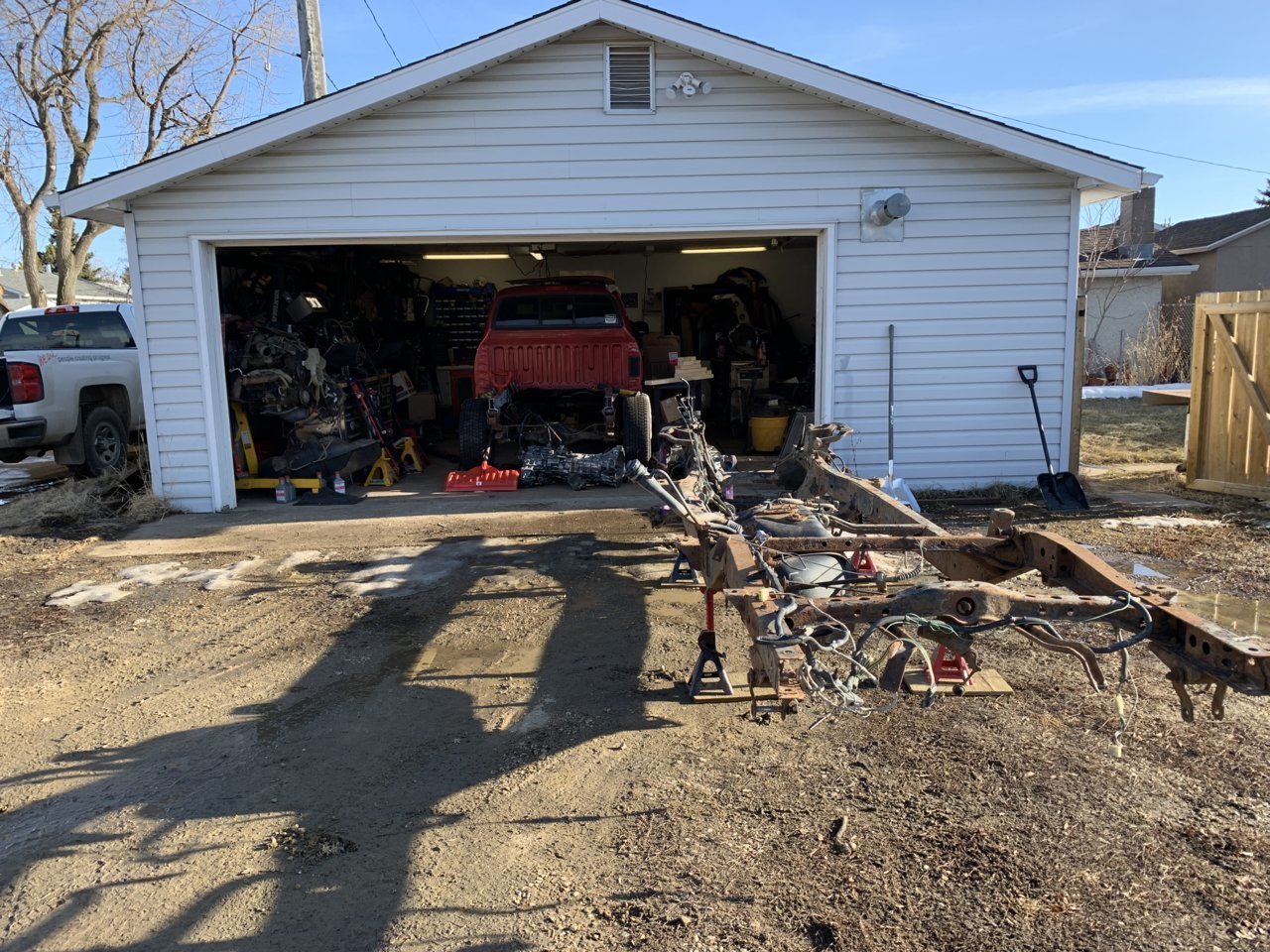

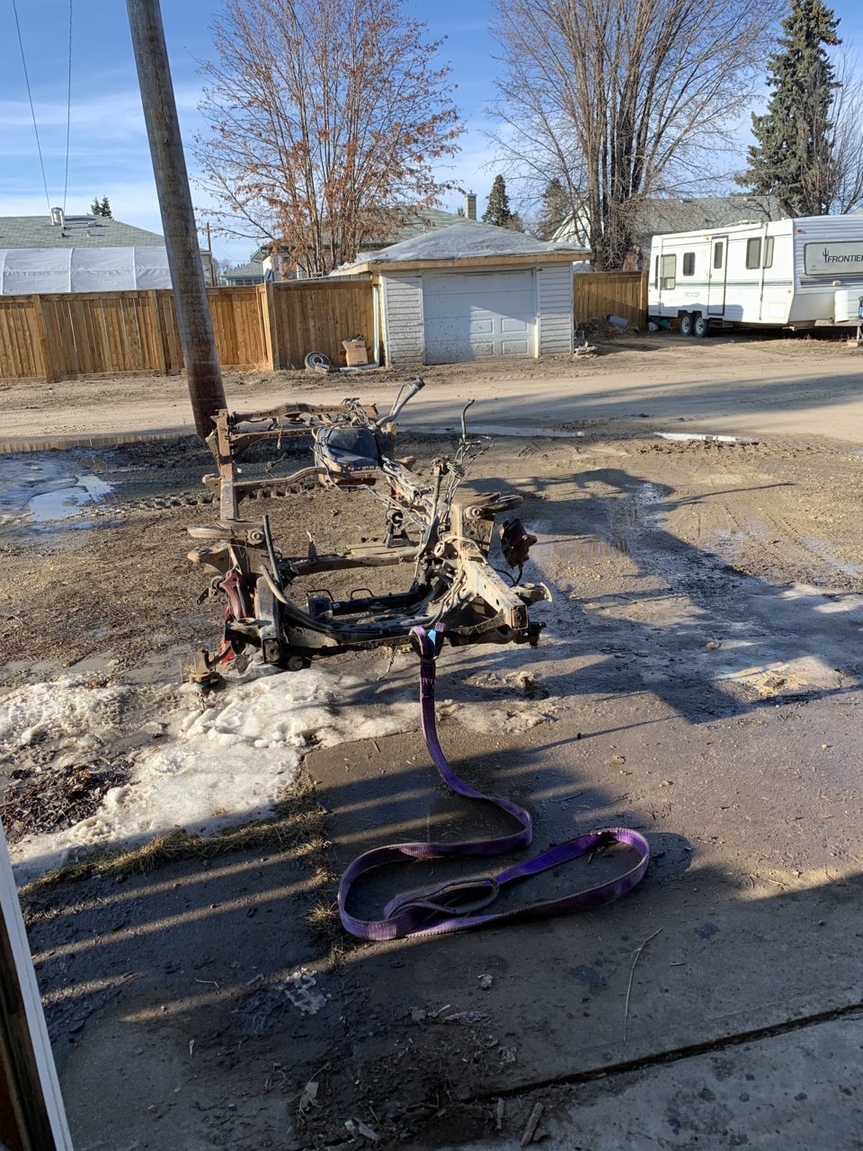

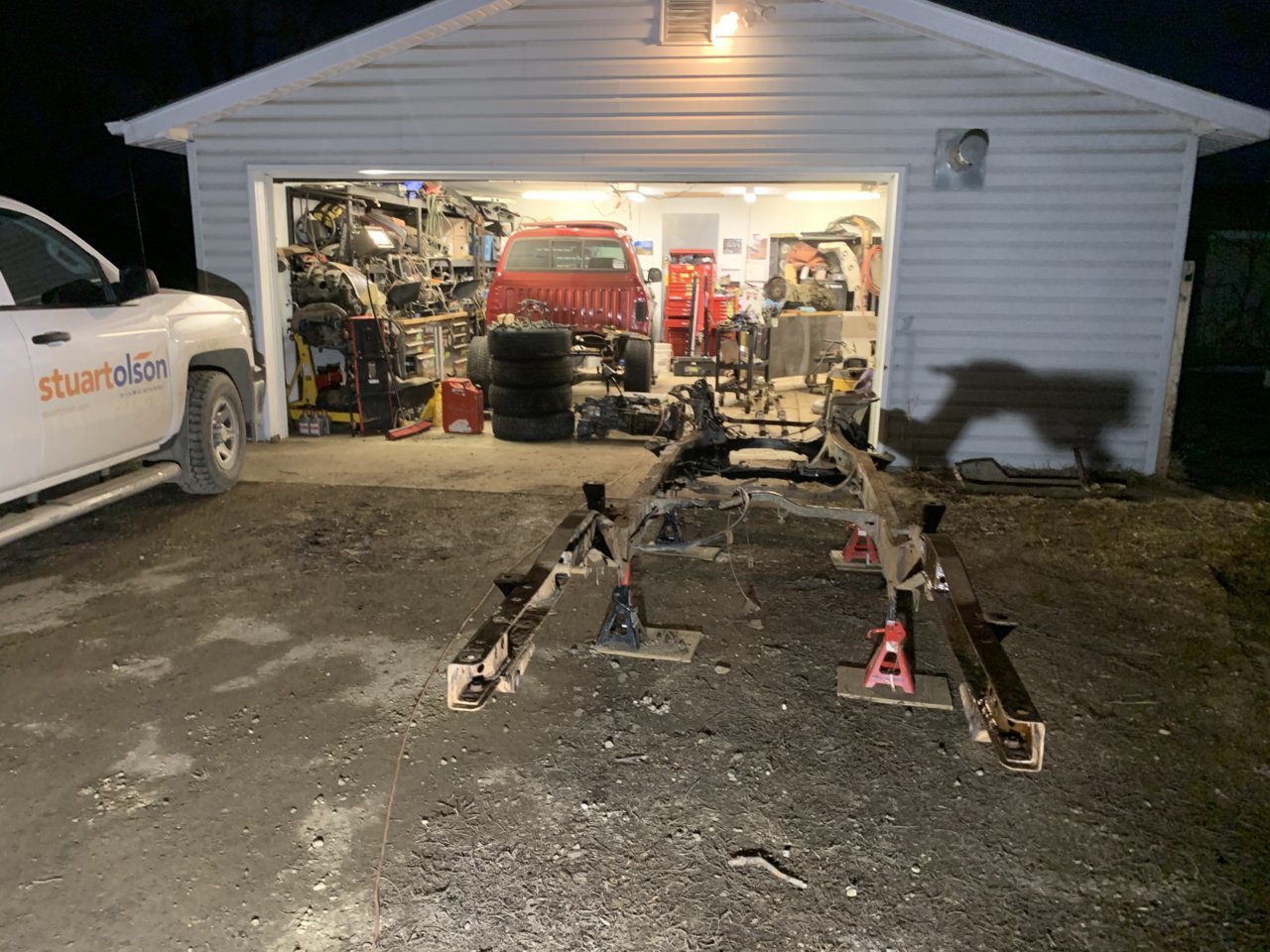

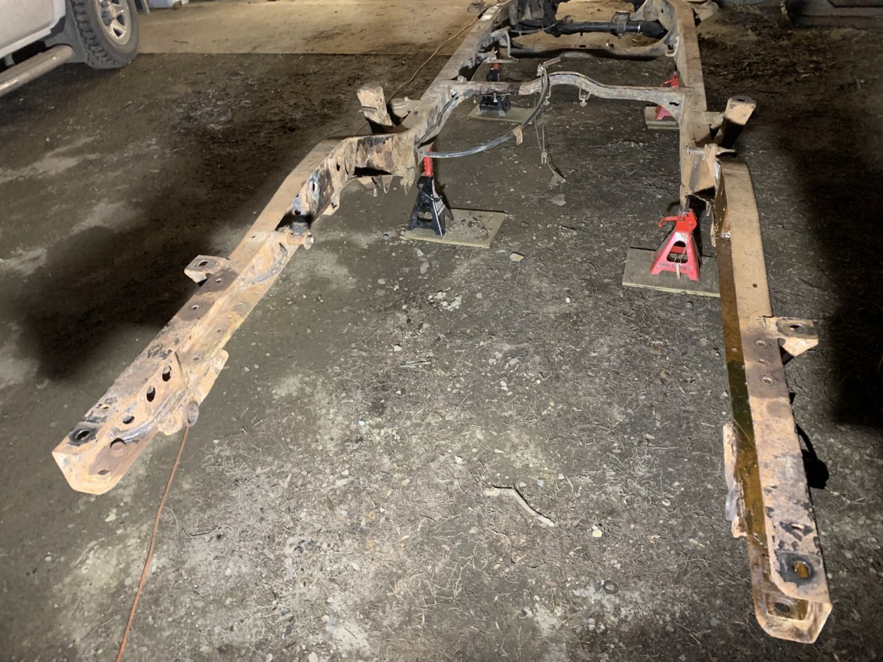

    Monday night, got the pos’s frame back to the garage, and started cleaning it up. Tuesday night, continued to clean it, removed brake lines, gas tank, all gas lines, and rear harness. I have the trail gear frame box kit, and with a couple other pieces, she’ll get a fully boxed frame. The factory gas support cross member is getting sandblasted, then I’ll weld it in.

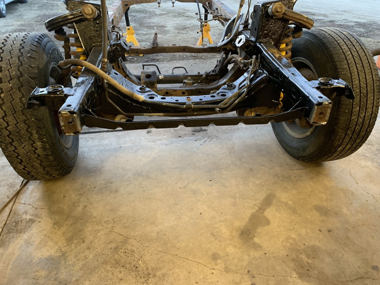

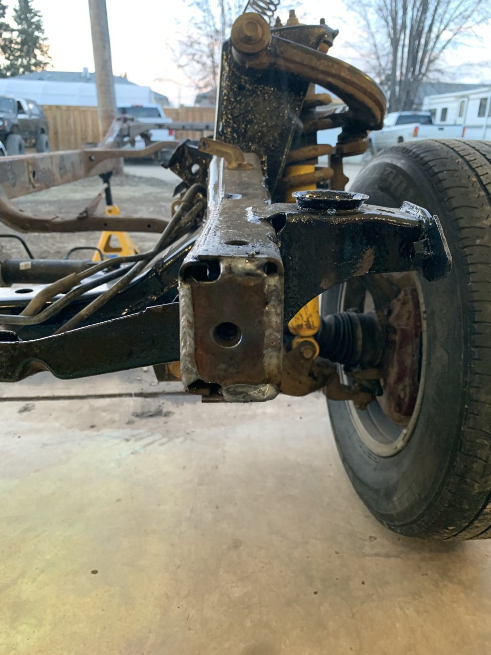

    Got the front third of the frame prepped and POR15’d

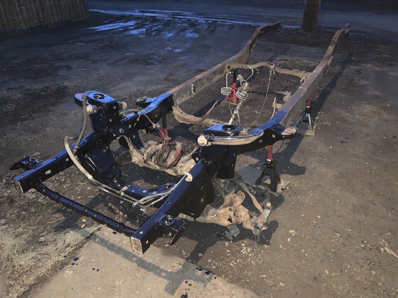

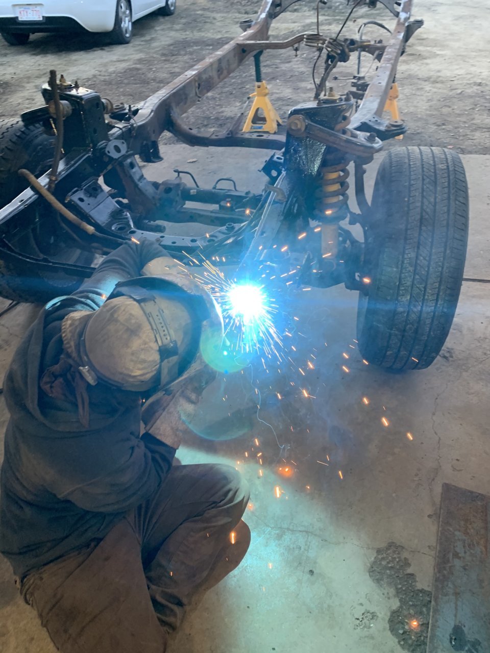

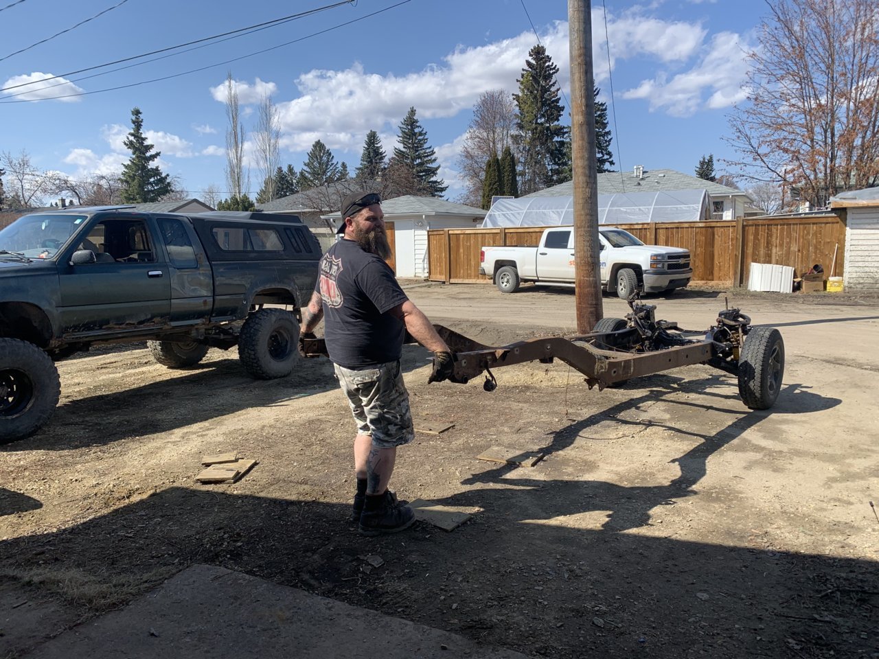

    Swung the frame around on Friday, so we could get to welding. Toyota Tacoma TRD wheelbarrow anyone?:militarypress:

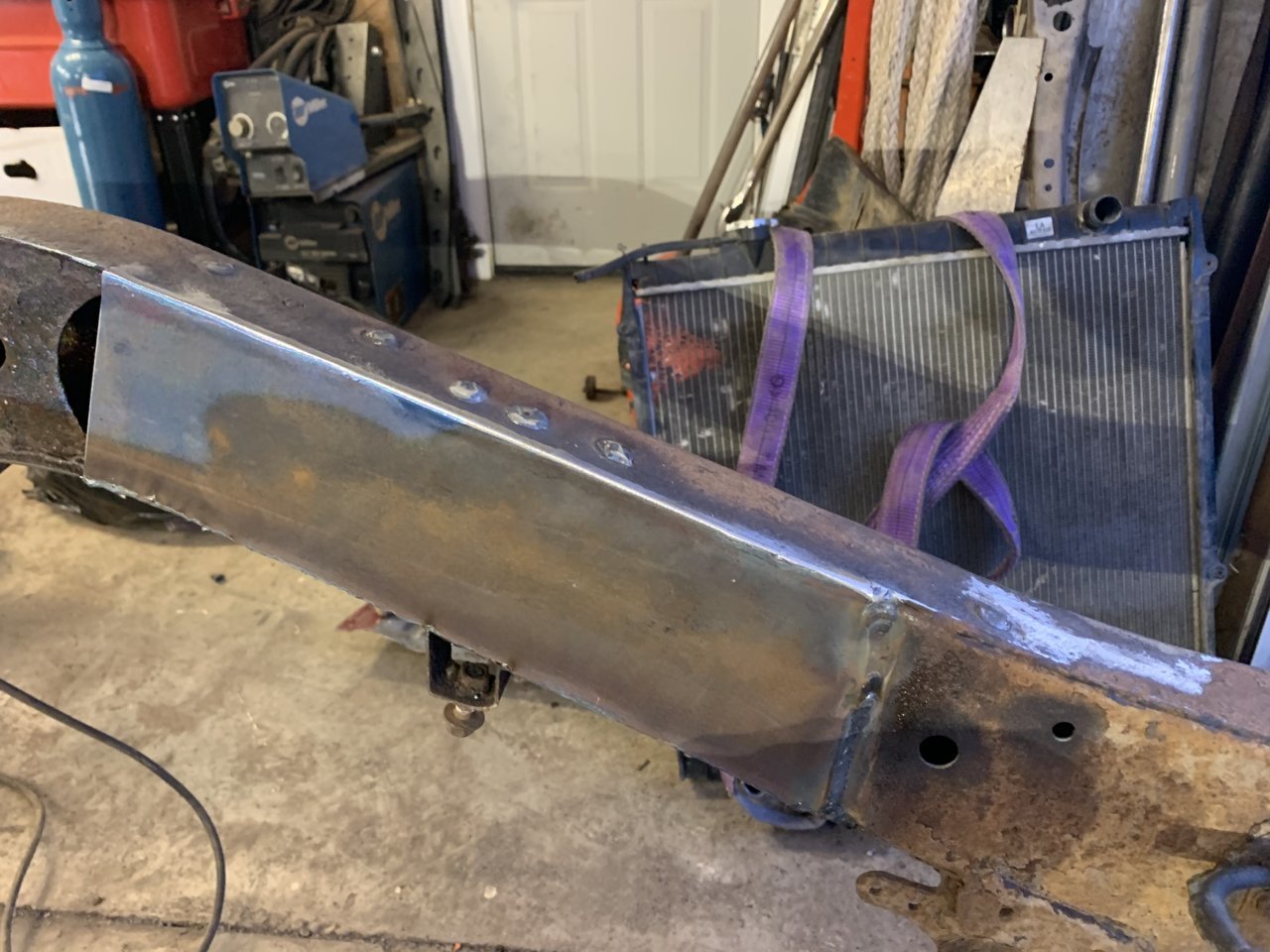

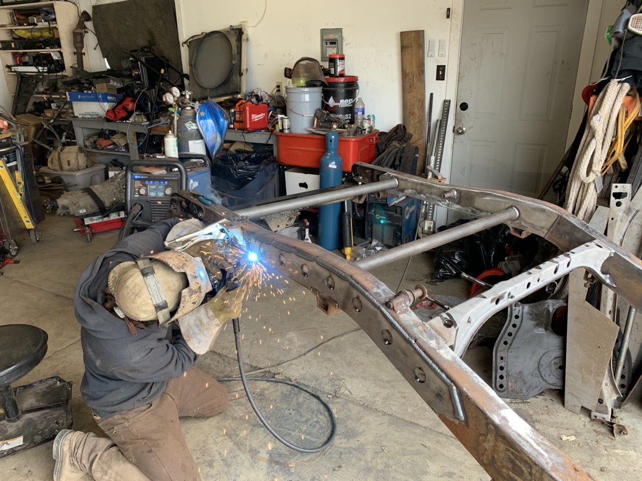

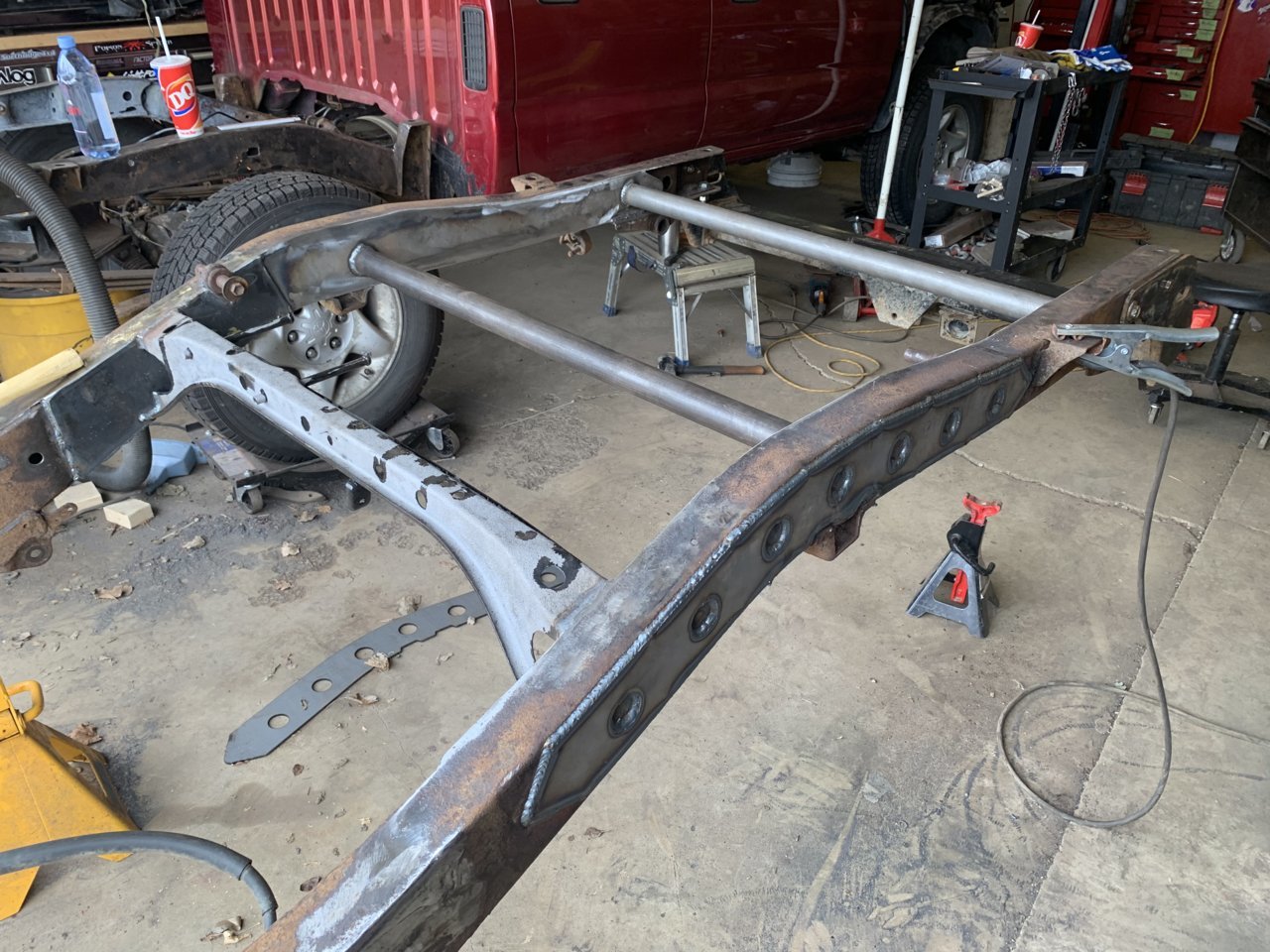

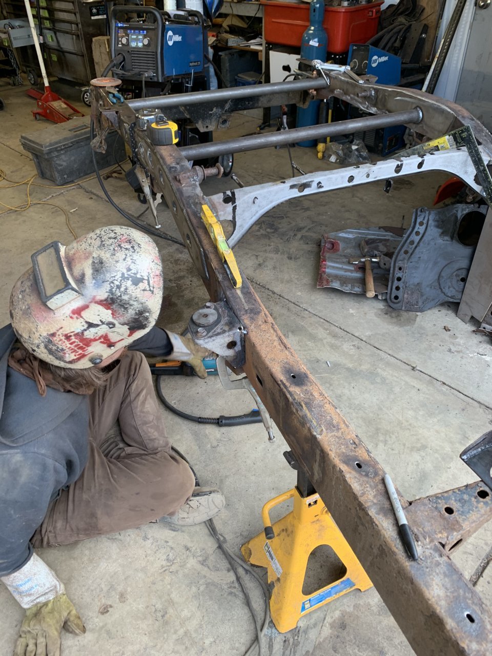

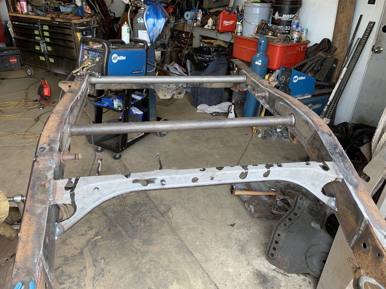

    I bought the trailgear frame box kit, and the frame reinforcement plates for the outside of the frame. I don’t like how trailgears kit leaves the section of the frame at the gas tab I crossmember an open “C” channel frame, so we cut the crossmember out, plated that section, blasted the crossmember, and welded it back into place. I also chose to not relocate my rear shocks, instead, coping around the shock mounts. I did use their supplied tube crossmembers, and threw away my rear one. I will be mounting a winch back here, under the bed of the truck.

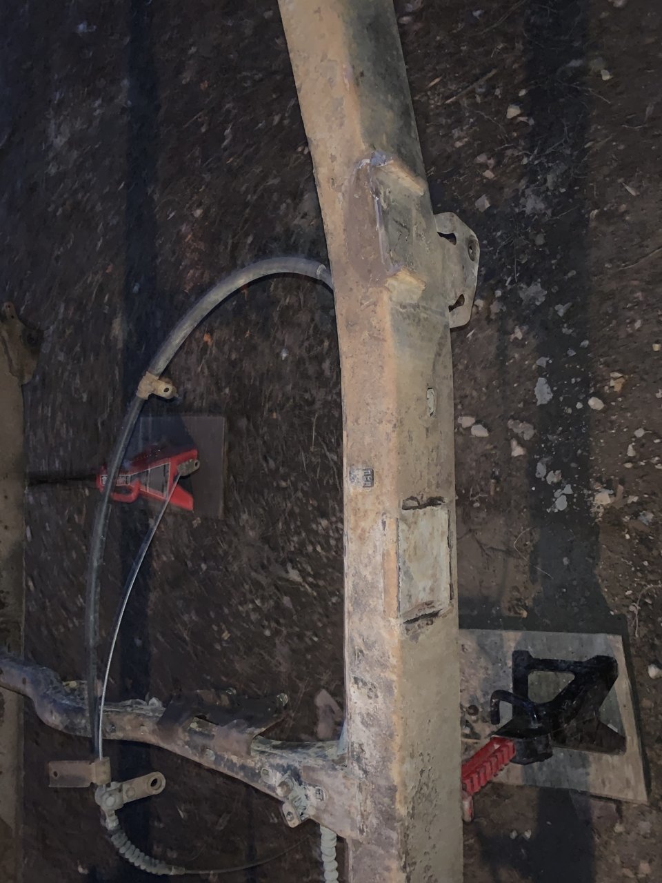

    We located, mounted and welded out the rear body mounts for the double cab location.

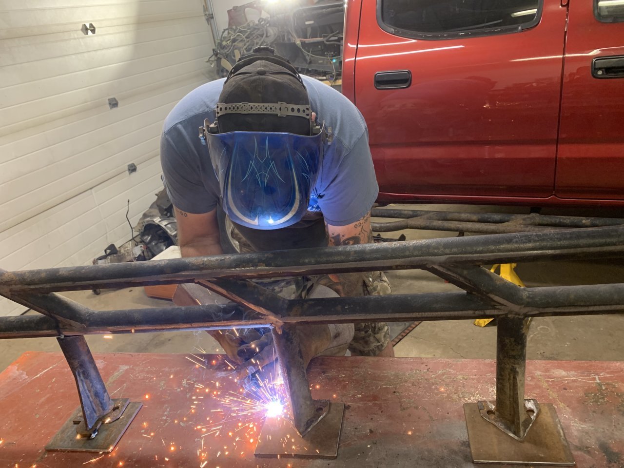

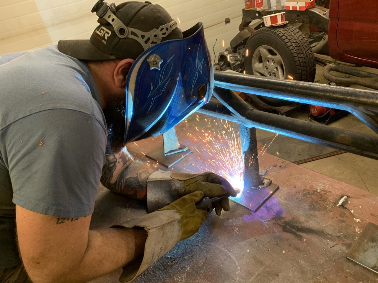

    Working on the sliders. I’ll be getting these ready to mount this week.

    Thanks! I’m a welder, so is my buddy, so between the 2 of us, we were fighting to use the new miller I just bought. Man, what a slick machine!

    I cannot remember who mentioned it, but on one of the 1st gen Tacoma FB pages a guy mentioned welding out the front bumper mounts. So while the thing is apart, they got welded.

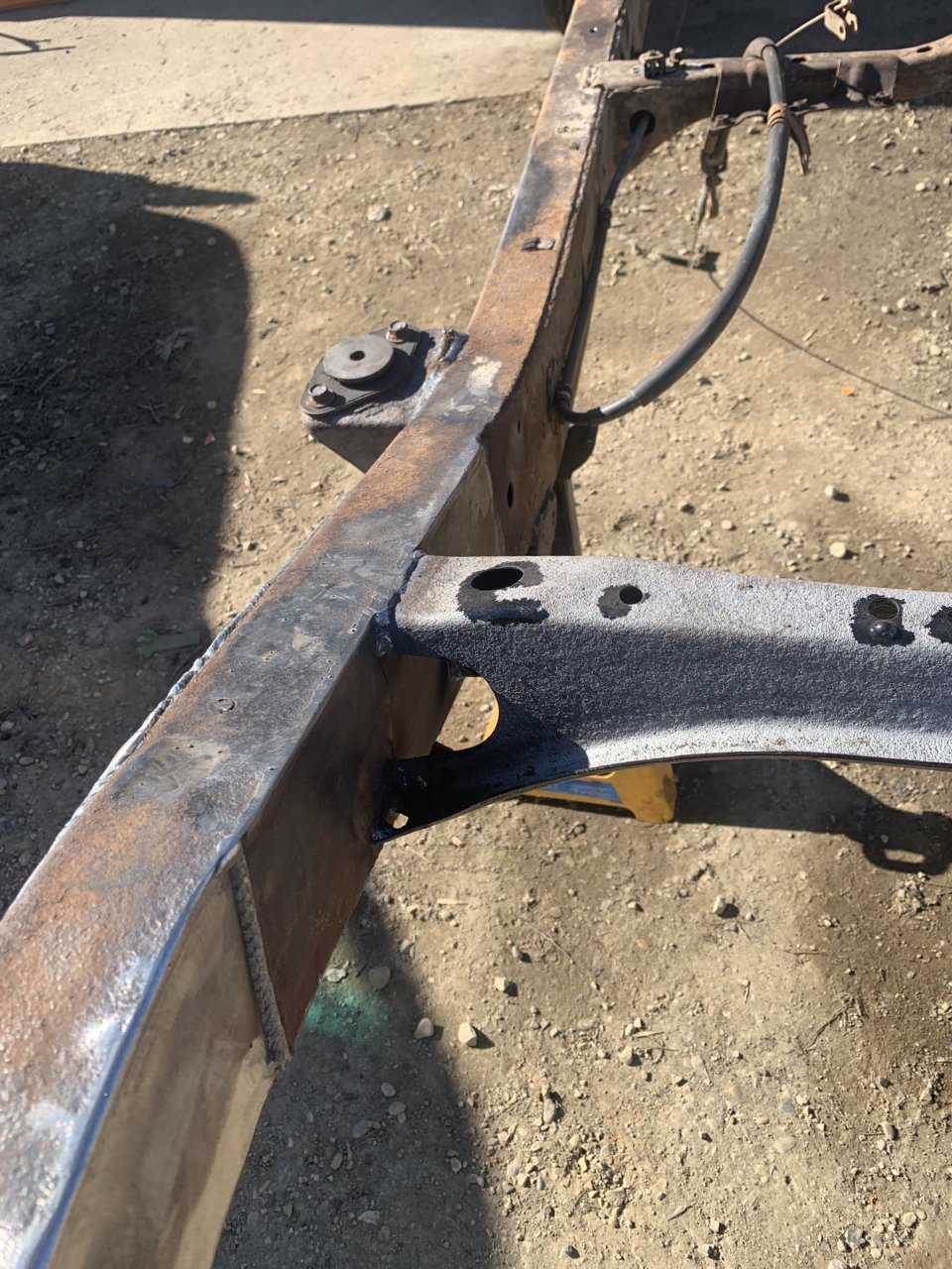

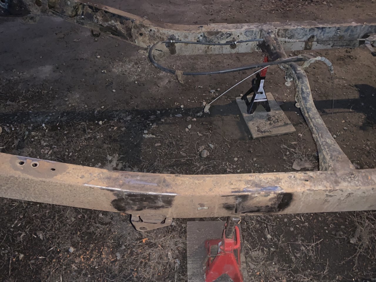

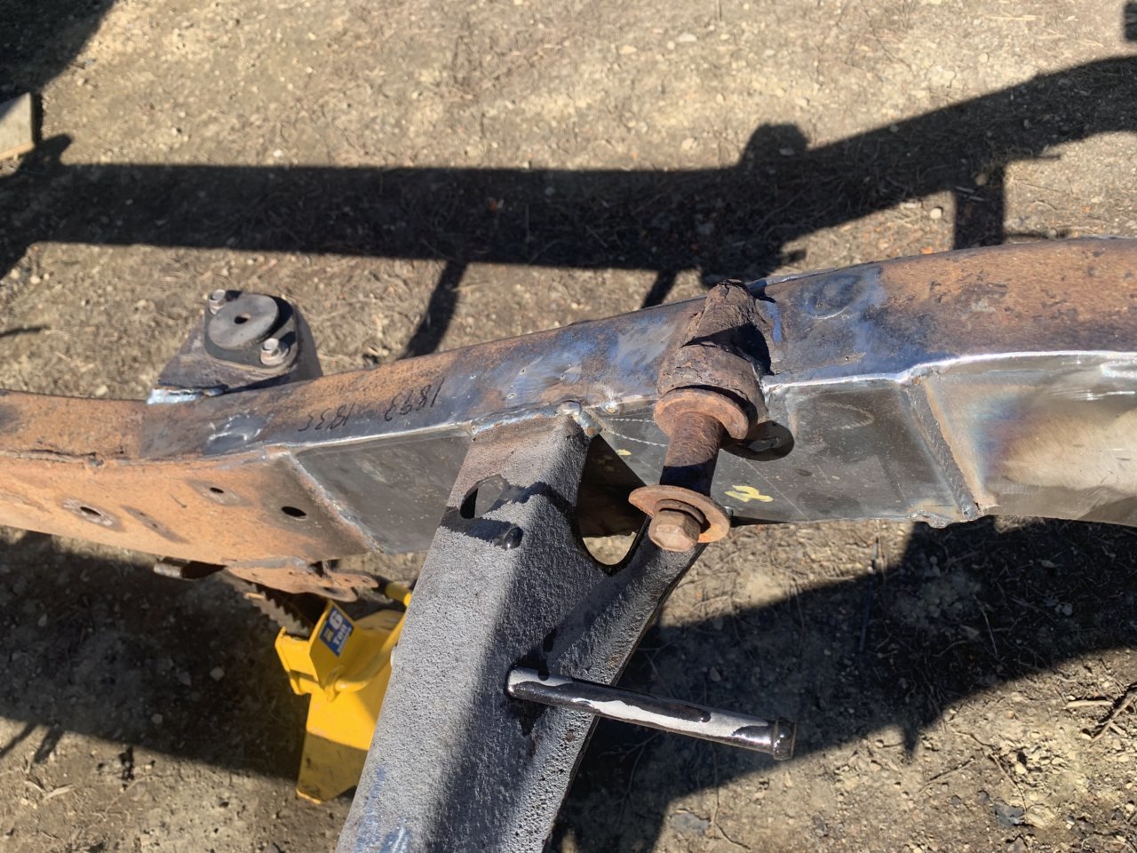

    A couple daylight shots of the extra plate we cut and fit up, and of the gas tank crossmember blasted, and burned in.
