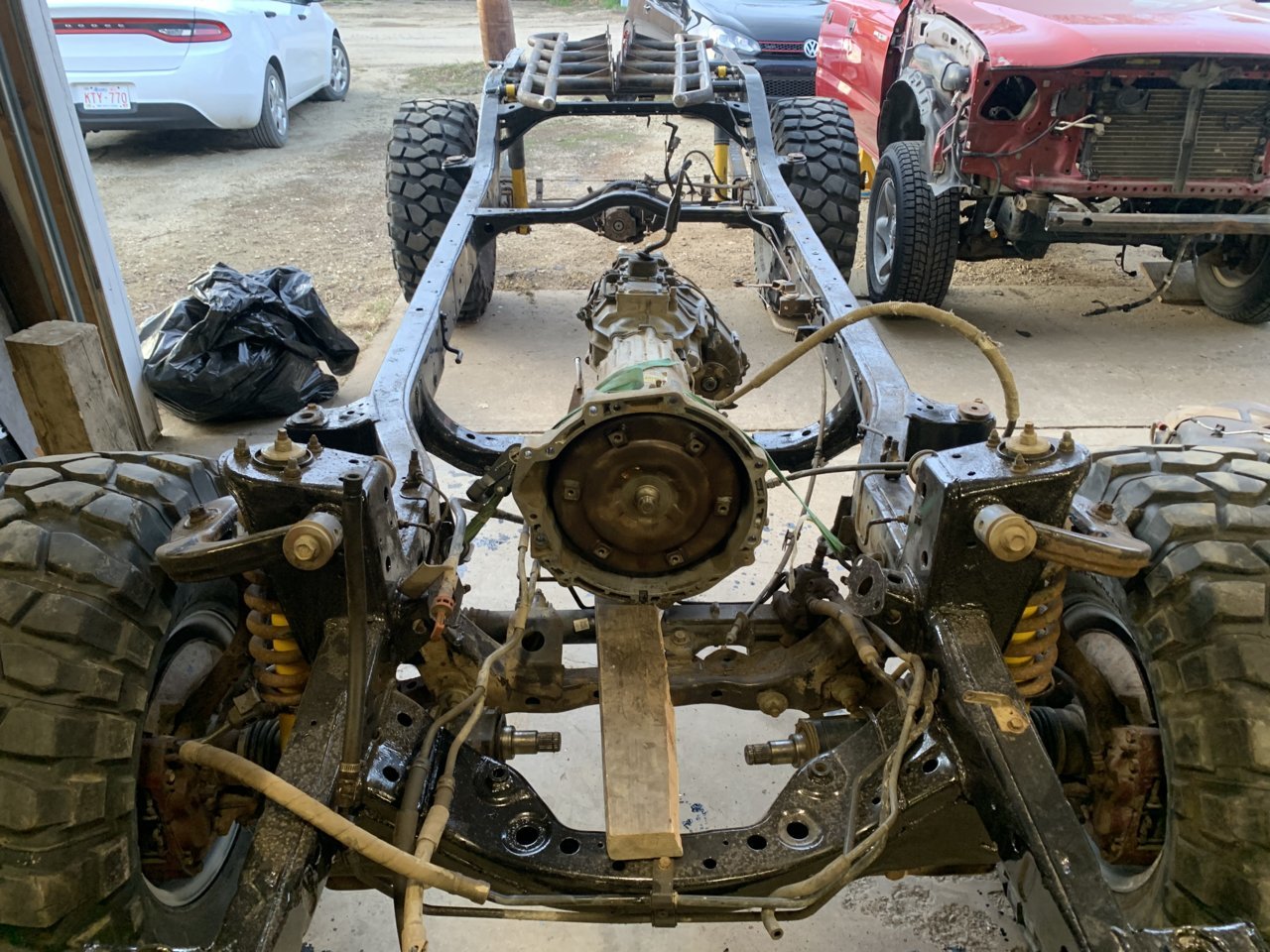

    Got my transmission and transfer case in last night.
