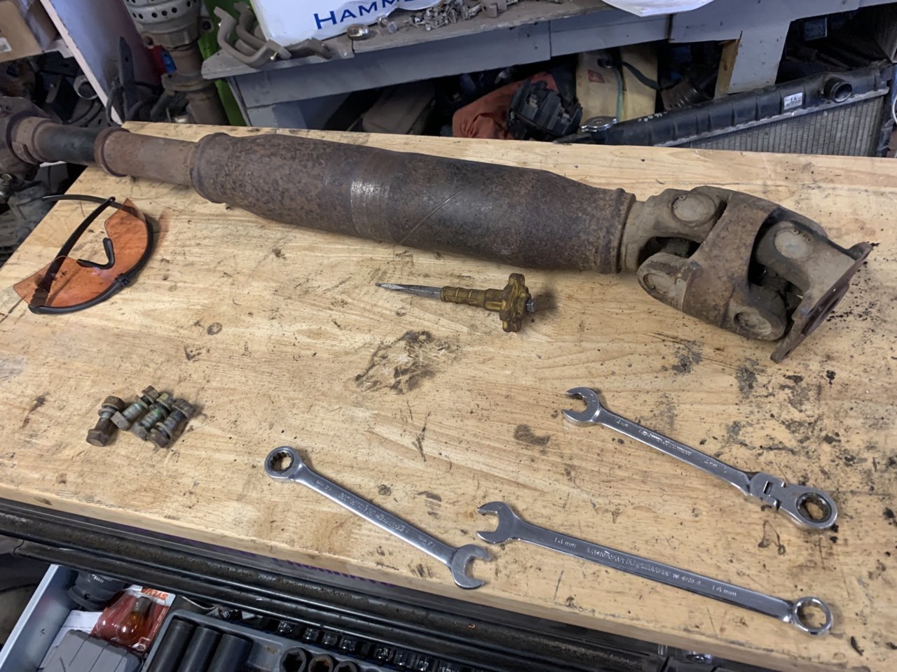

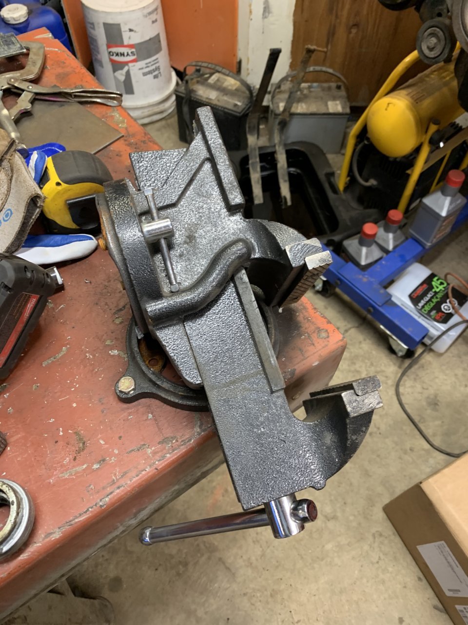

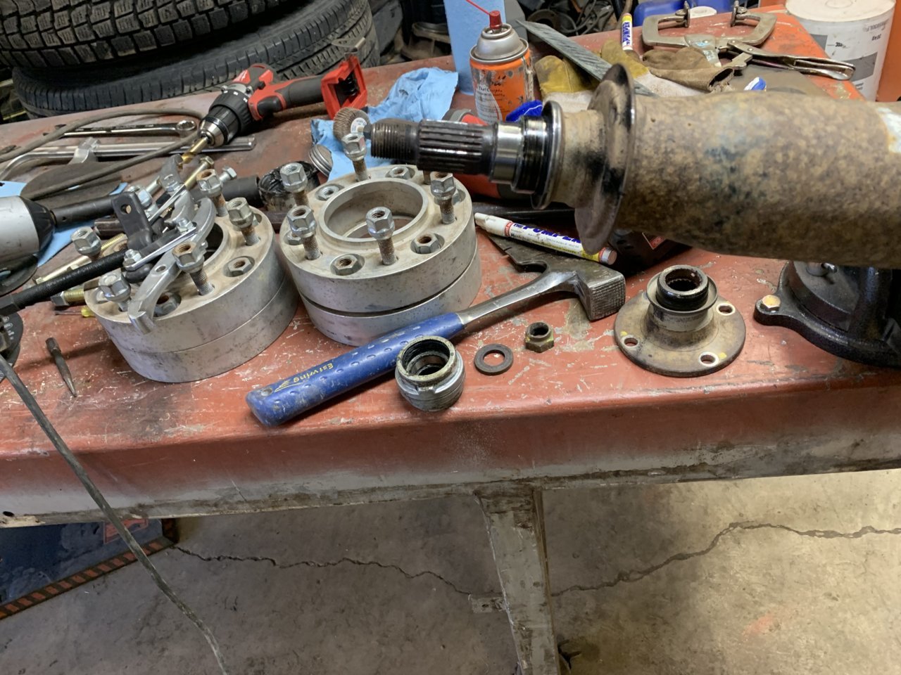

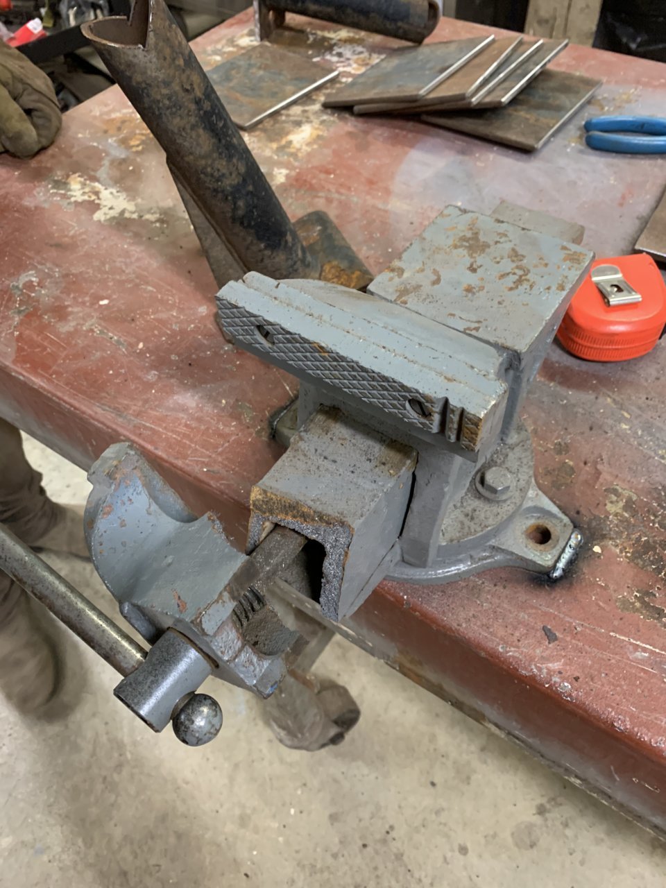

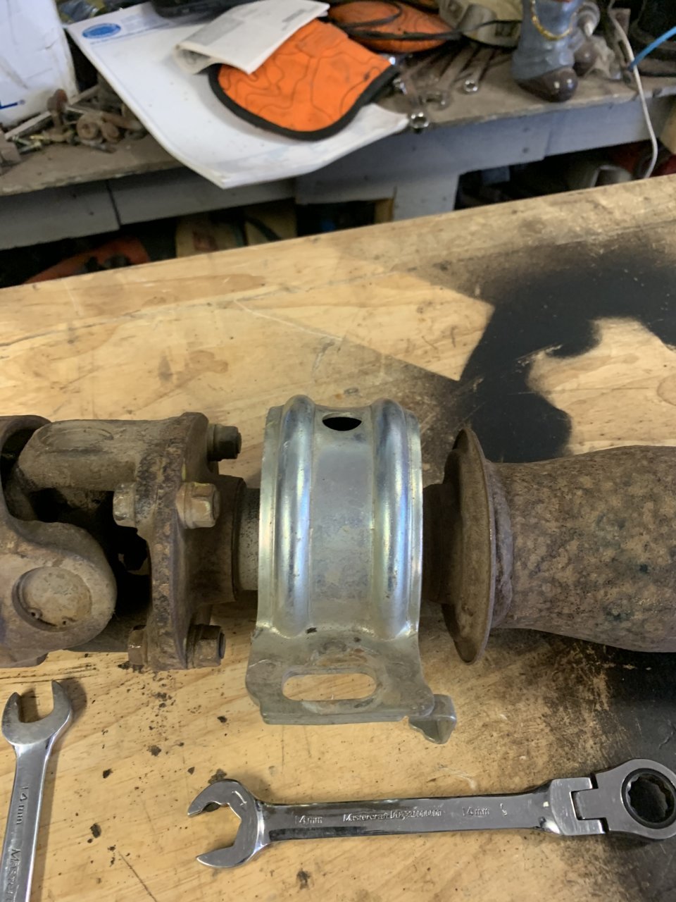

    Then I pulled apart my rear driveshaft to change out the rear centre/steady bearing assembly I ruined last fall, by punching a log into it and the gas tank. Got it all apart, and removed, then went to assemble the new one. And I broke my bench vise. And my trail vise broke a couple days ago. So I sat down, had a beer, cusses the damn thing, and went to bed. :rofl::rofl::rofl::rofl:

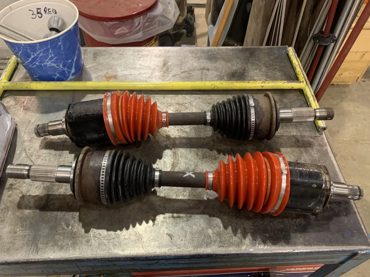

    Did you just do a re-boot on them?

    I did. Cleaned them out, checked them, to see how they look, new Toyota grease, and back in service for another 250k miles

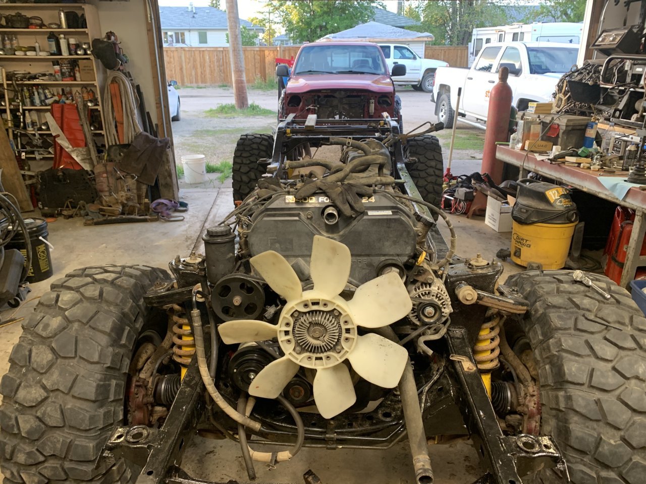

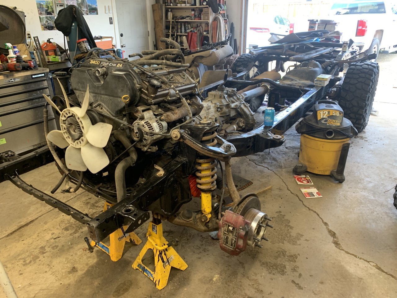

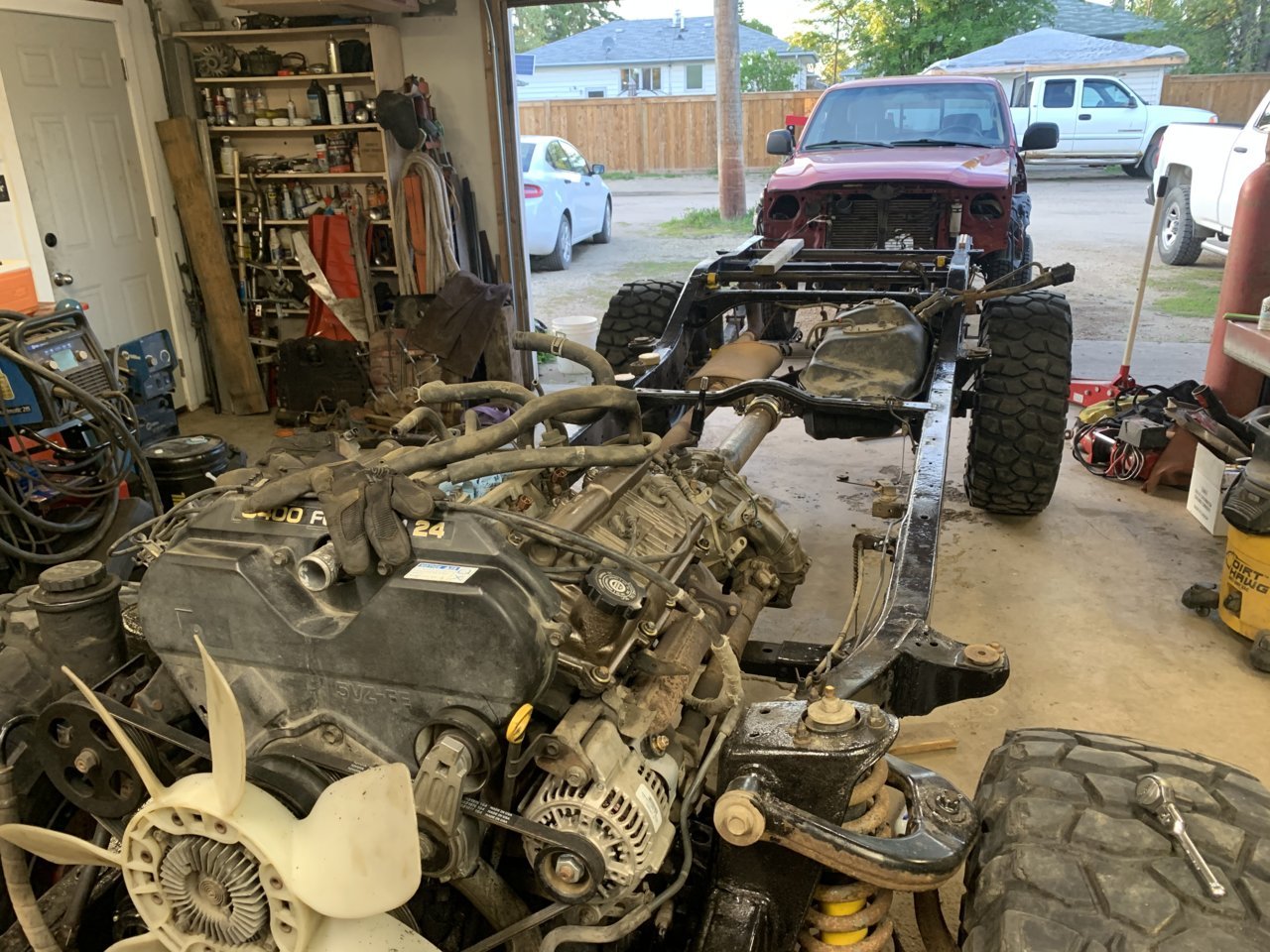

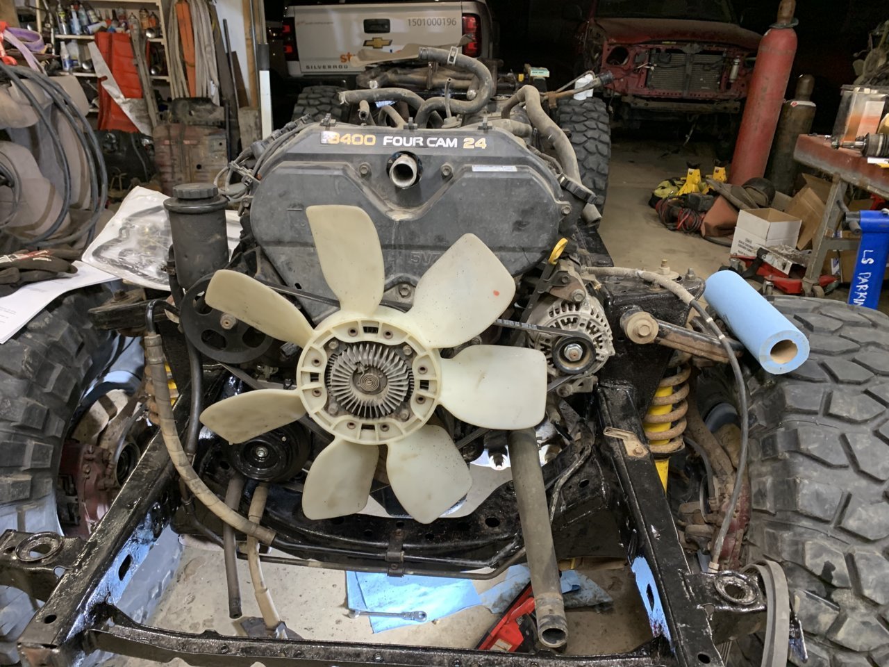

    Front end is back together

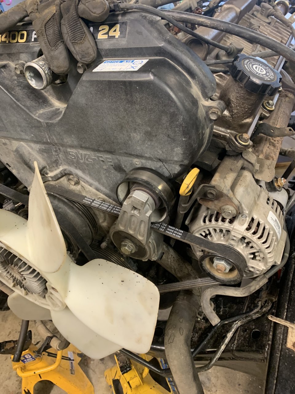

    And I got piece one of the supercharger in place! Had to thread chase both holes, but the threads are good, and the tensioner is firmly bolted in!

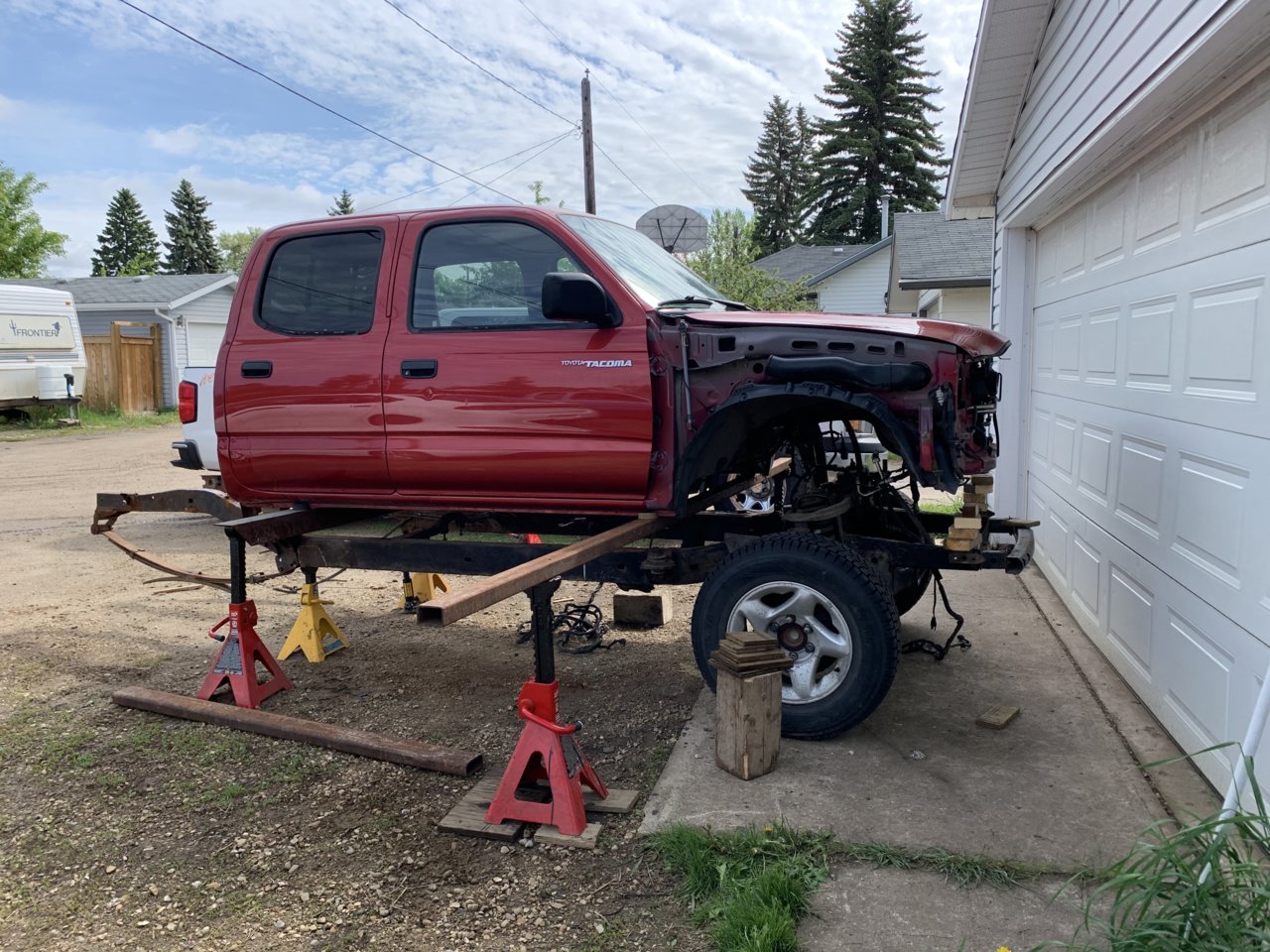

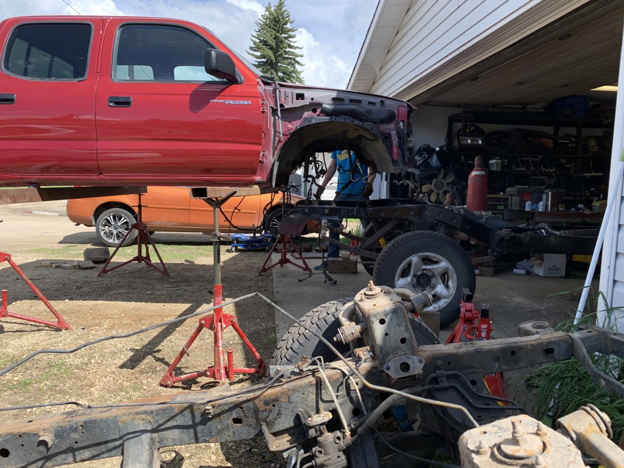

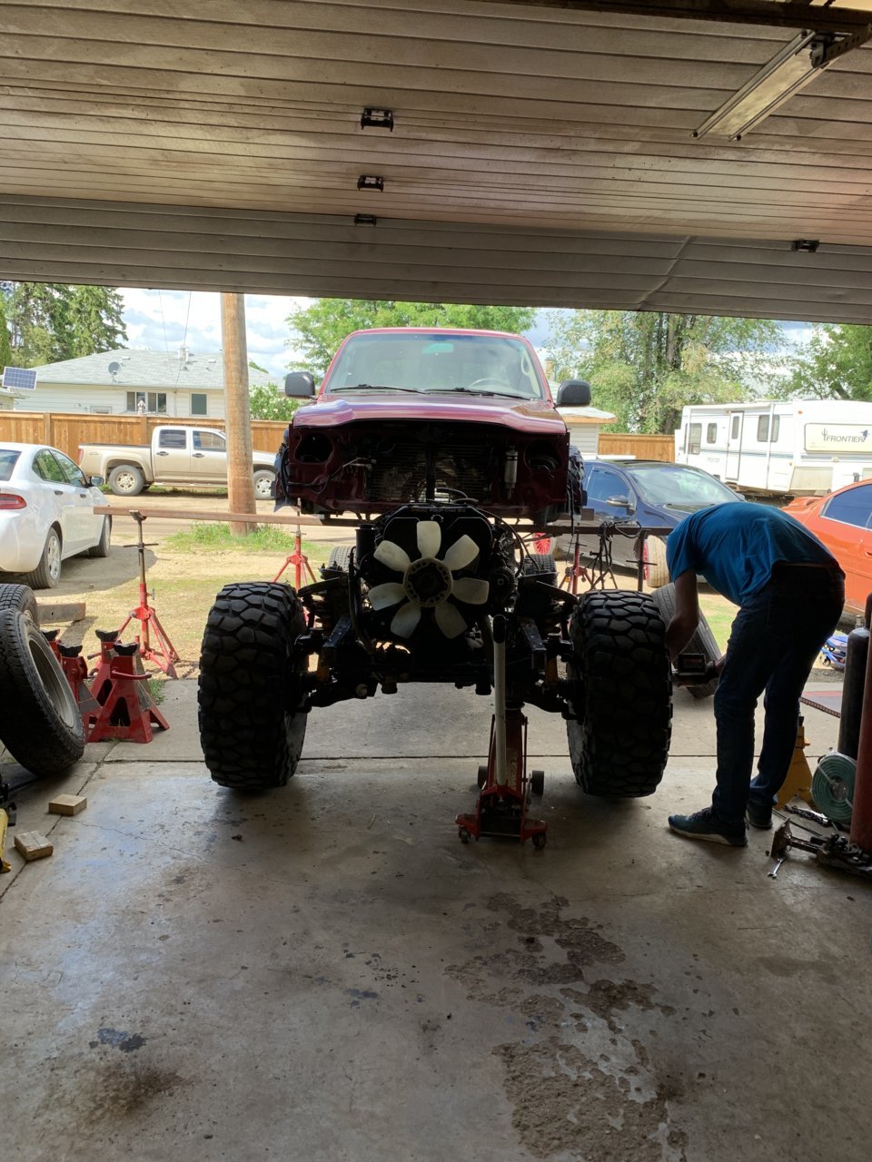

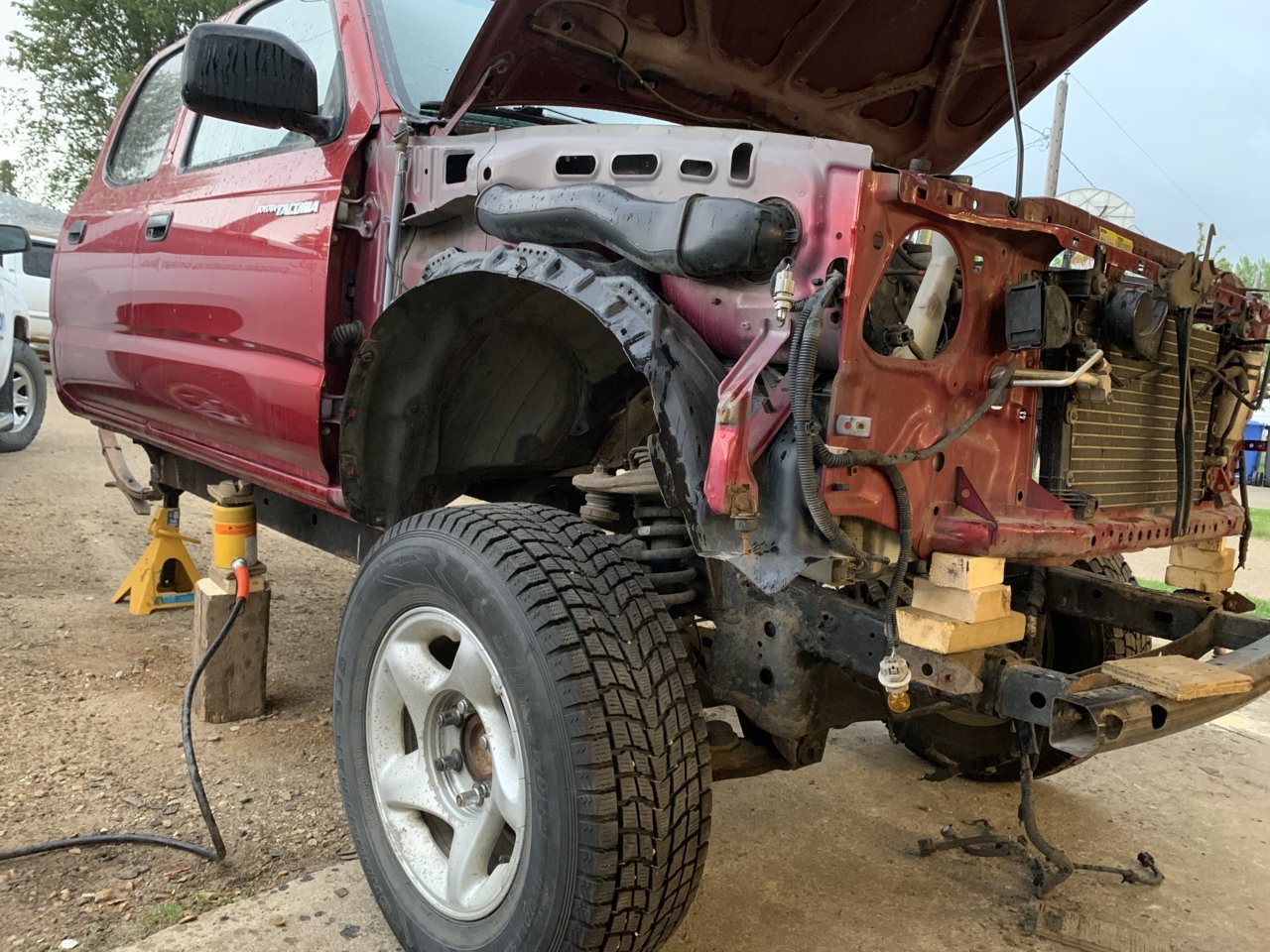

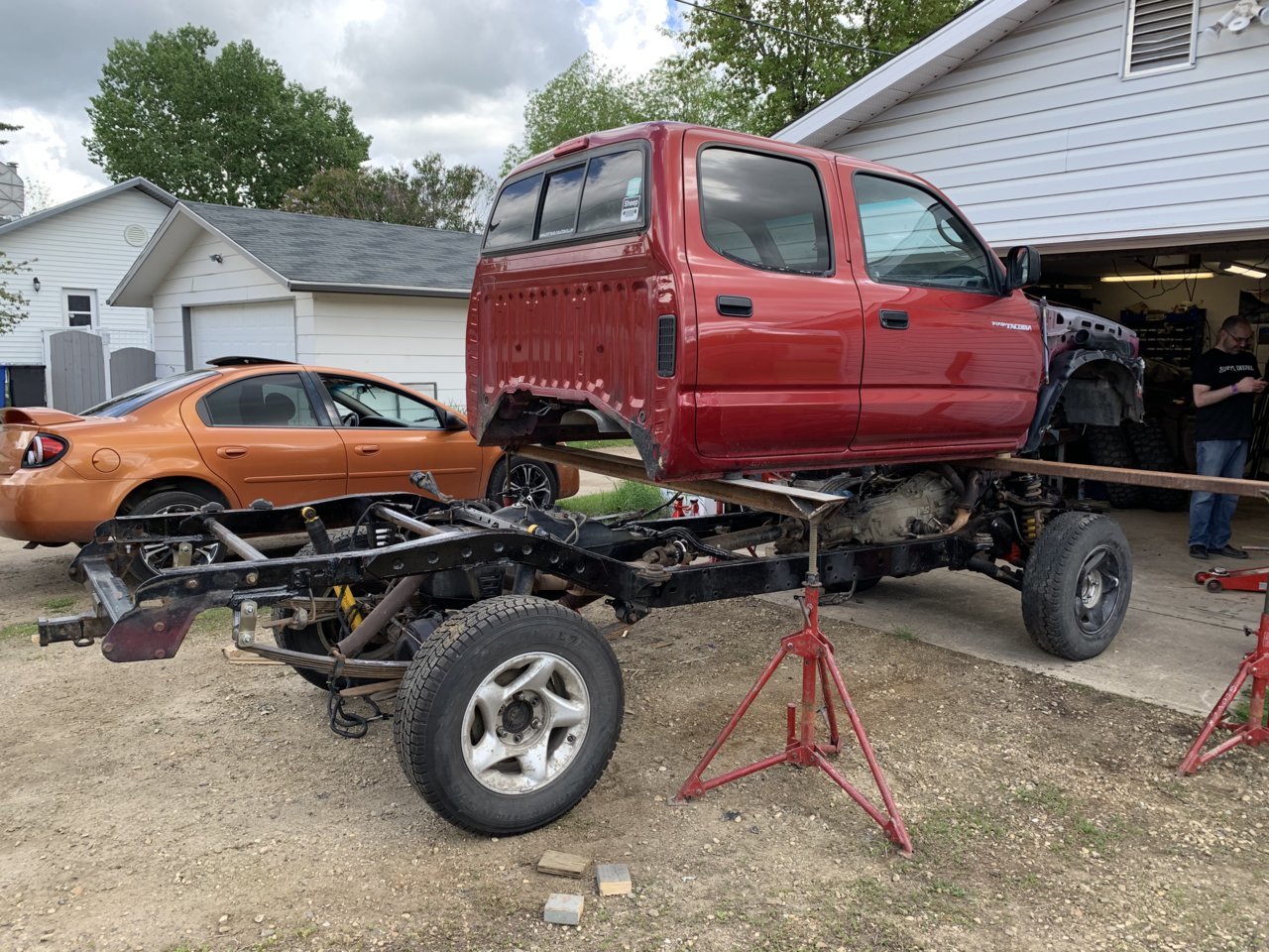

    Got started with lifting the cab on Friday.

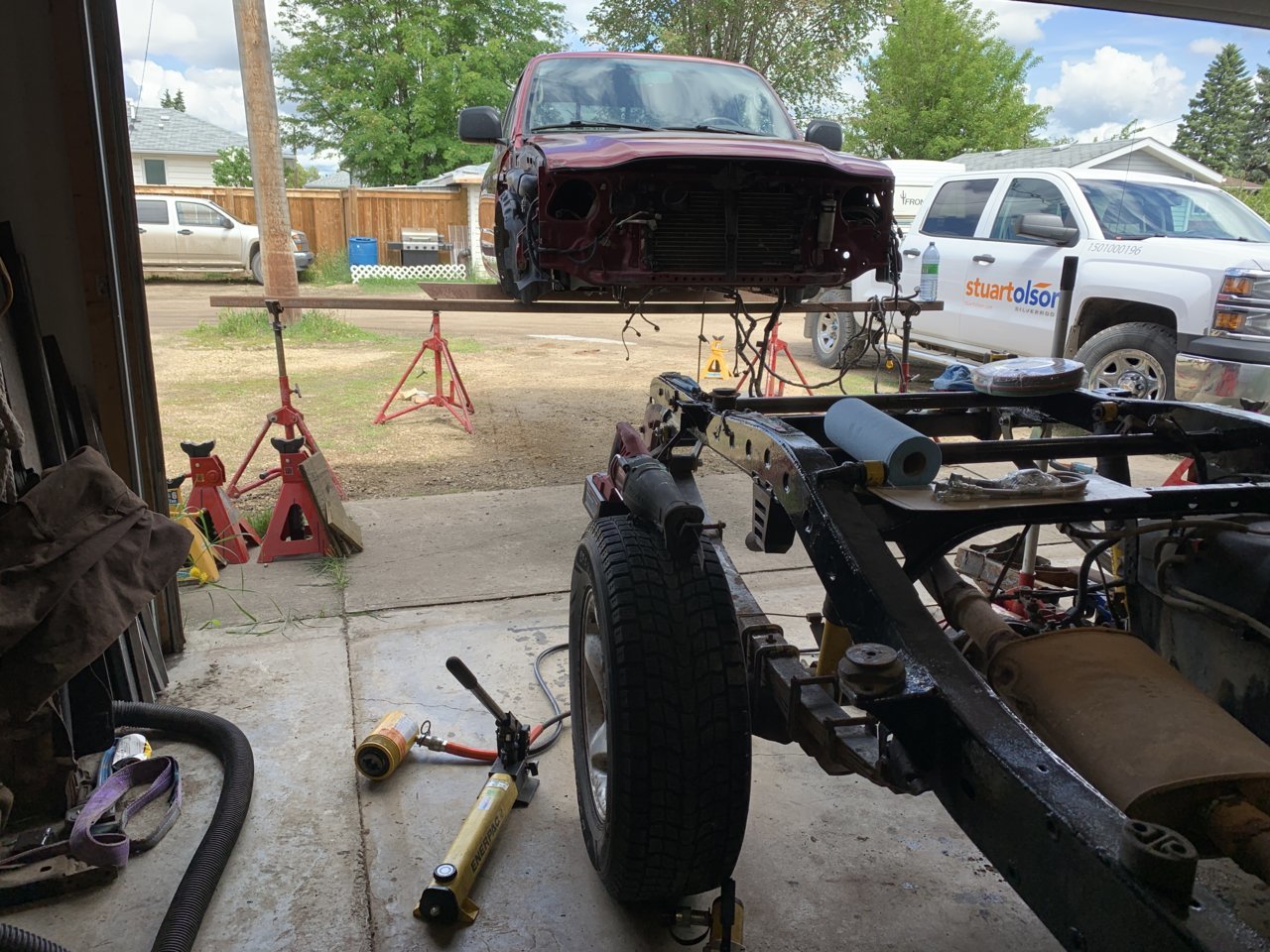

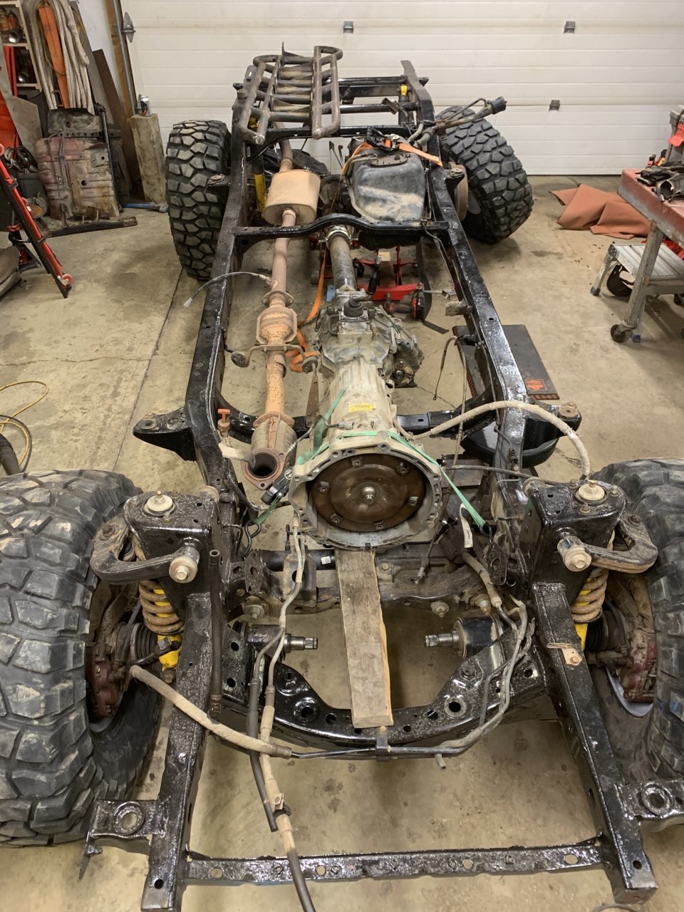

    Sunday morning start

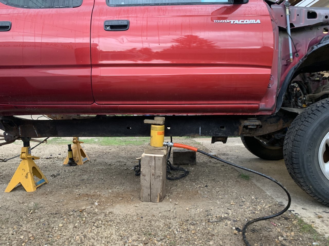

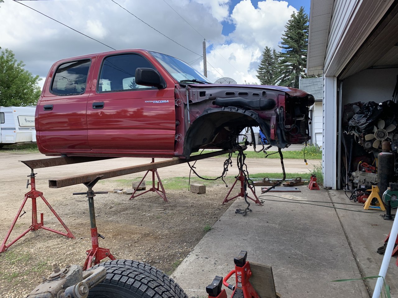

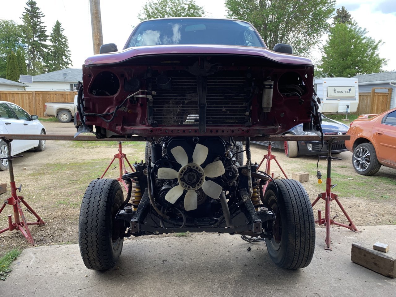

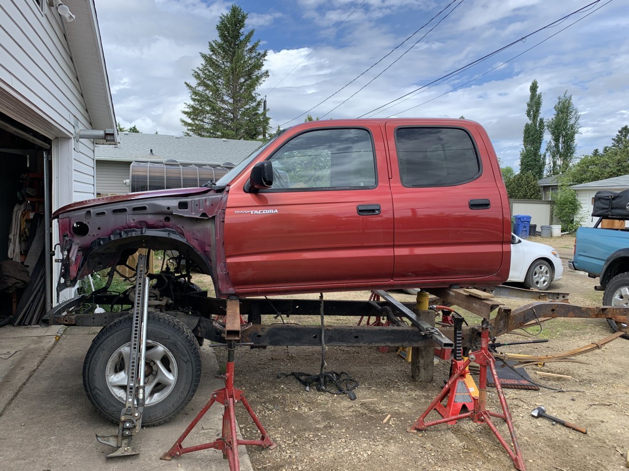

    Note the switch from 12 ton jackstands to 2.5 ton pipestands. Way more stable.

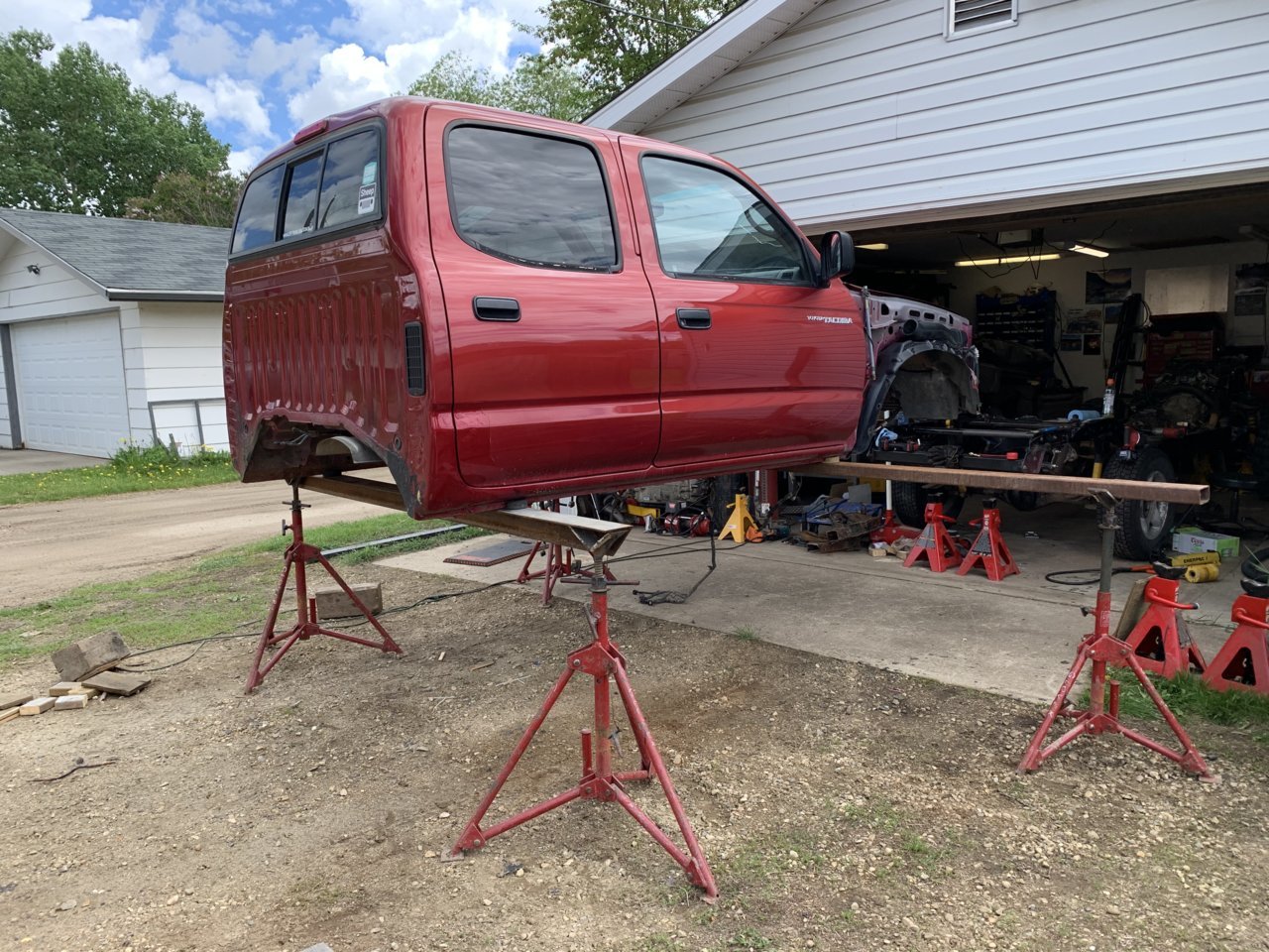

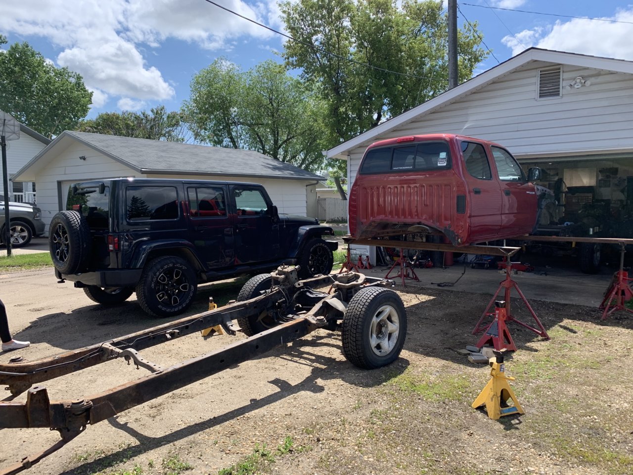

    Old frame rolled out.

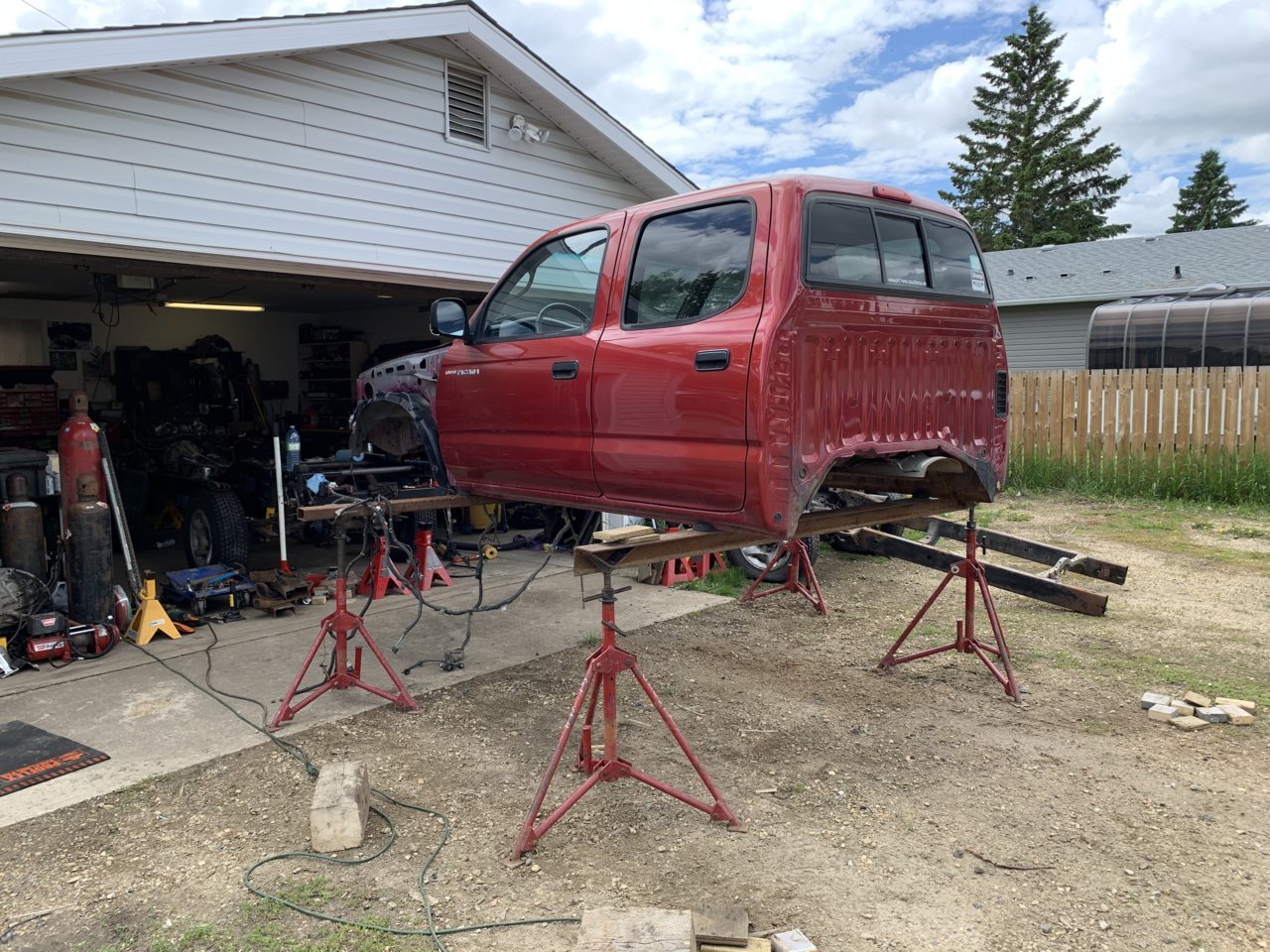

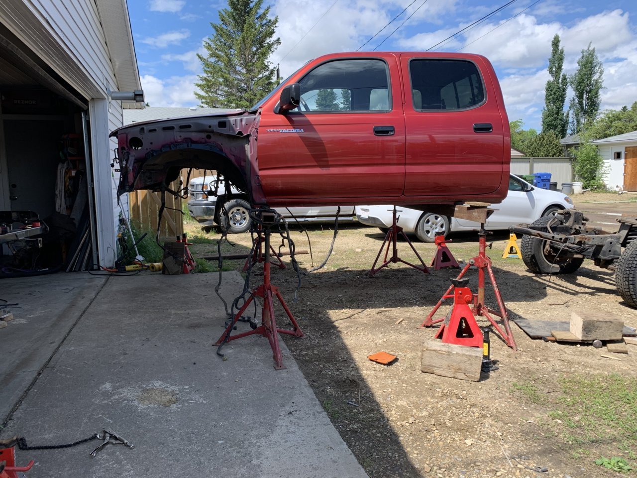

    And while I had the body on hover mode, I swapped body mounts from the old frame to the old new frame.

    2001 Tacoma DC XPreRunner
    OME Suspension, ARB Bumper, frame swap, Rebco logger box.

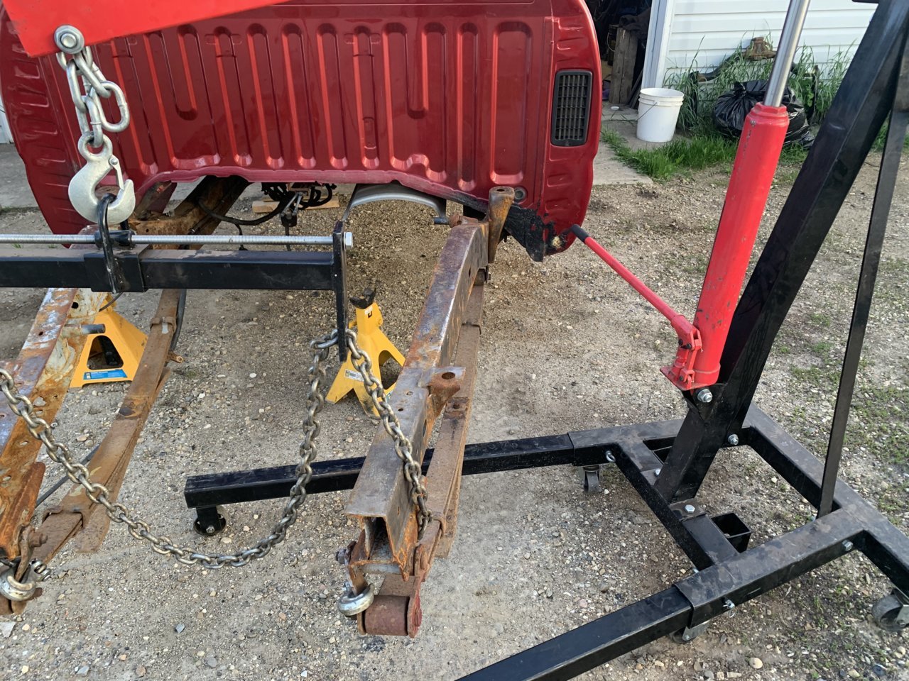

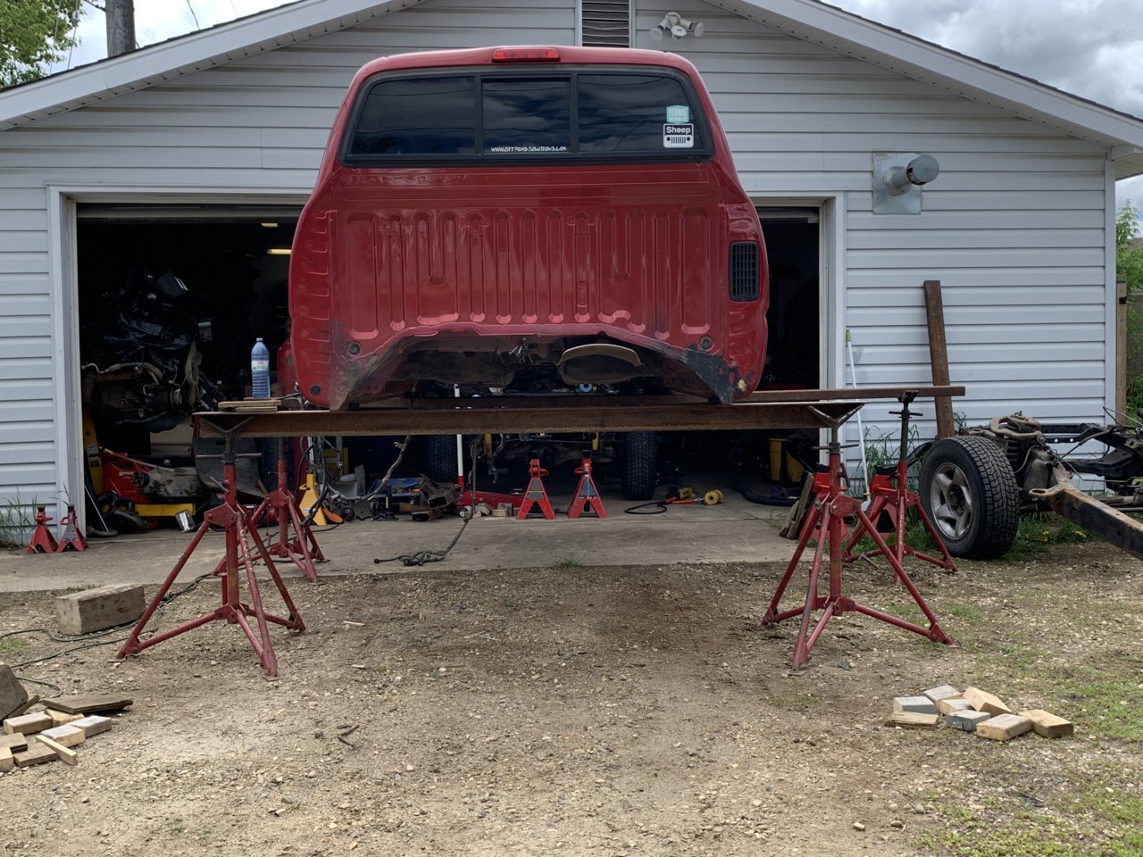

    I used a chunk of 4x4x3/8” angle, and a length of 2x4x3/8” hss With 4 grooved hockey pucks to support and lift the cab.

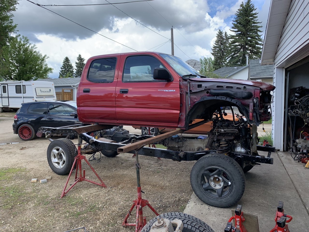

    I had the krawlers on the front, to give a bit of an angle to aid in sliding the back end of the frame under the cab. Tried to keep it as low as possible, but be as high as necessary.

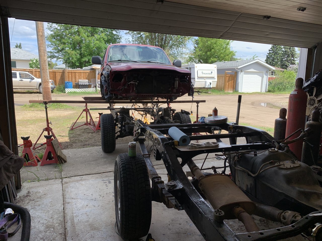

    We swapped out the krawlers for the minis to roll the frame the rest of the way under.

    And the new (old) frame was under!
