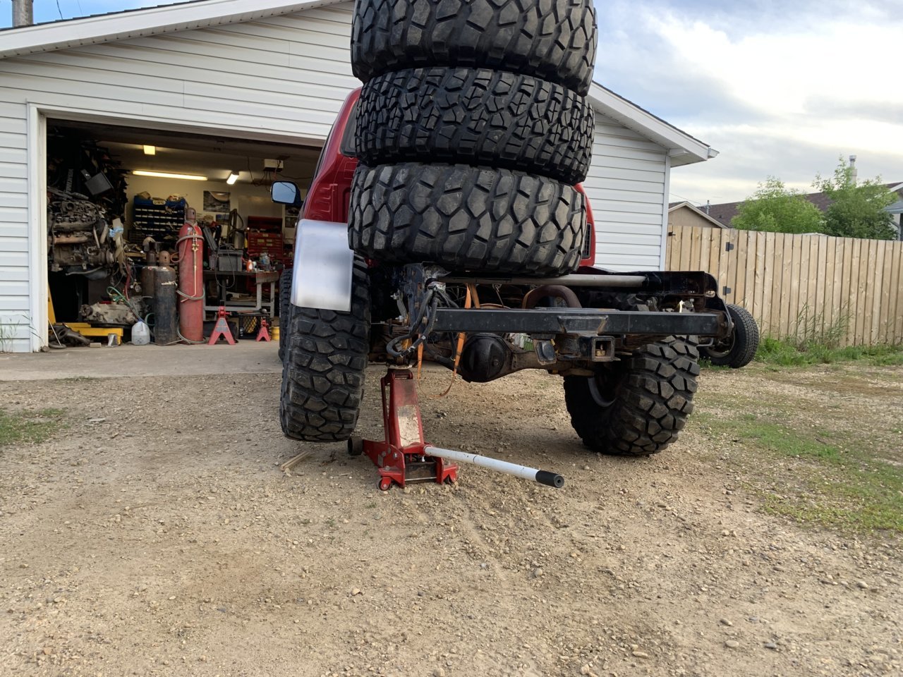

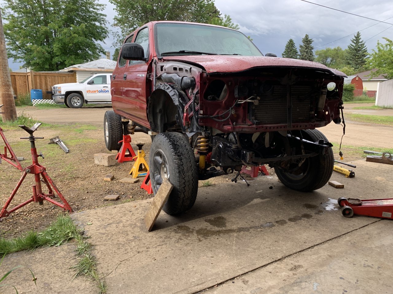

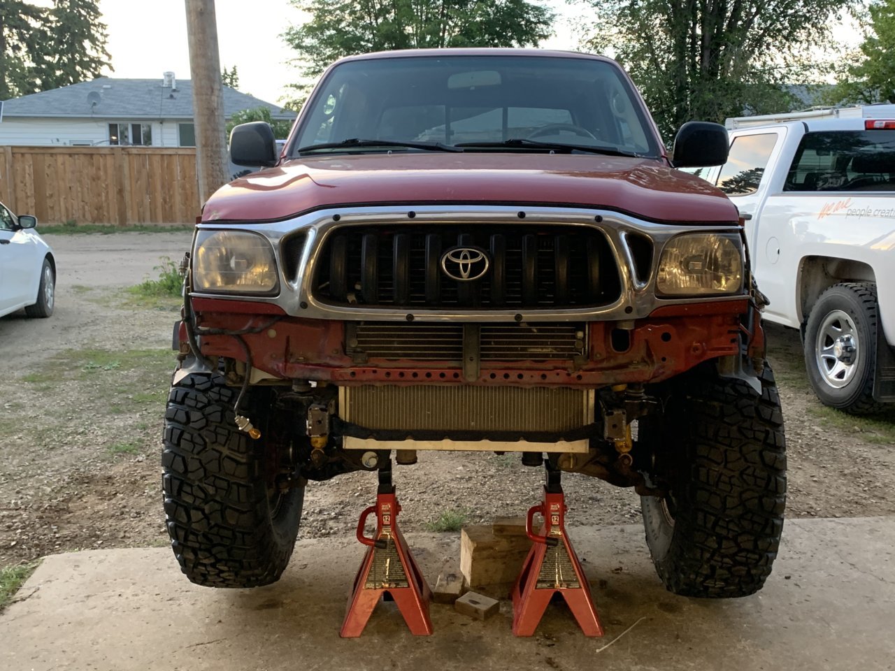

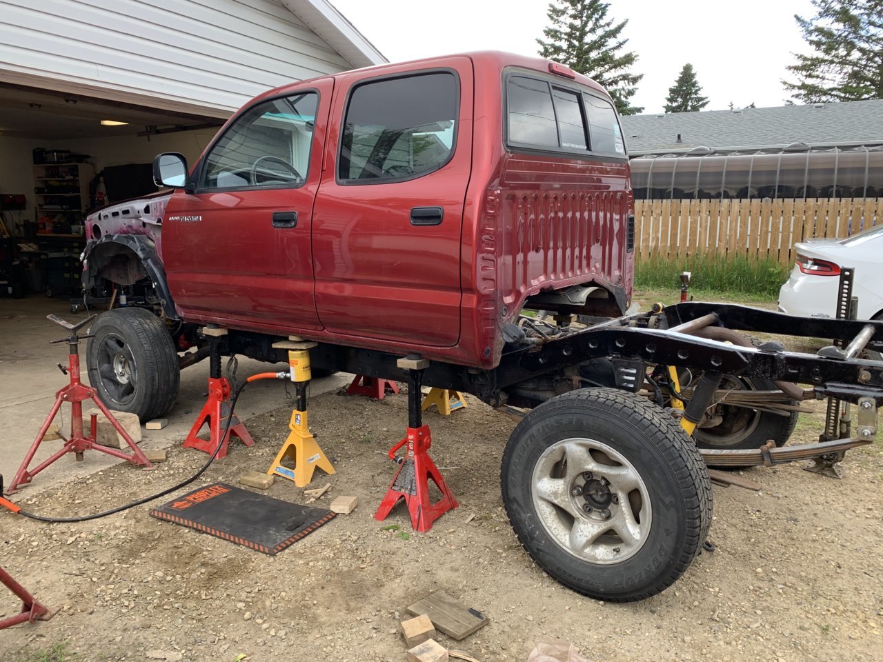

    And down she went! Low enough to swap out pipestands for jackstands.

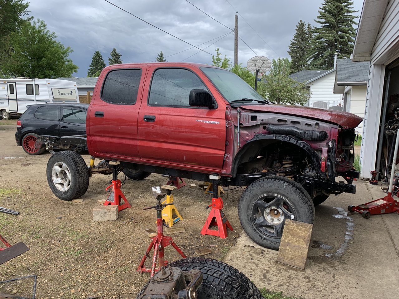

  3. Jun 16, 2020 at 1:31 PM
    #163
    POSTacoMike
    POSTacoMike [OP] On the rocks, please
    Nov 4, 2019
    #309824
    1,114
    Red Deer AB
    2001 Tacoma DC XPreRunner
    OME Suspension, ARB Bumper, frame swap, Rebco logger box.

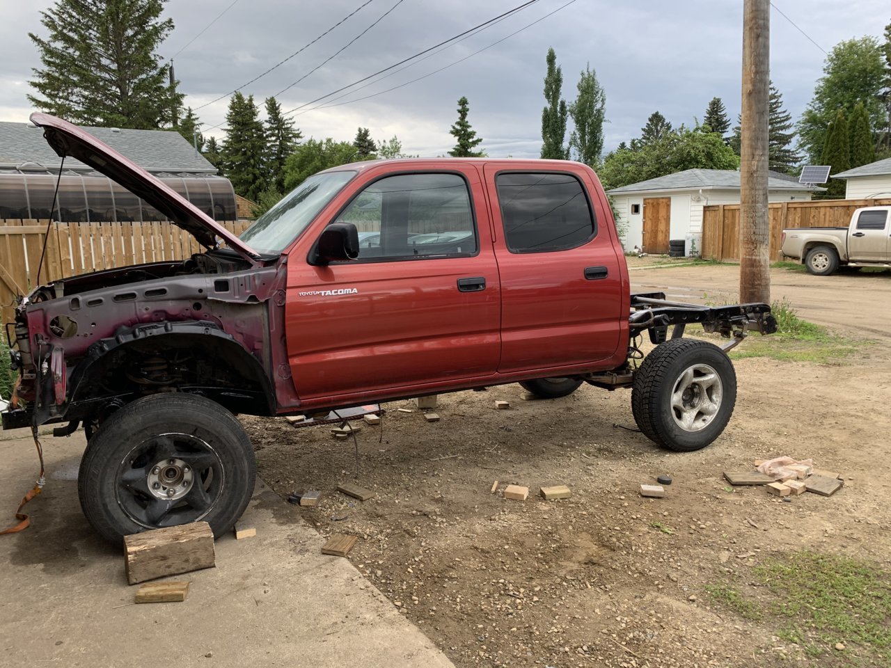

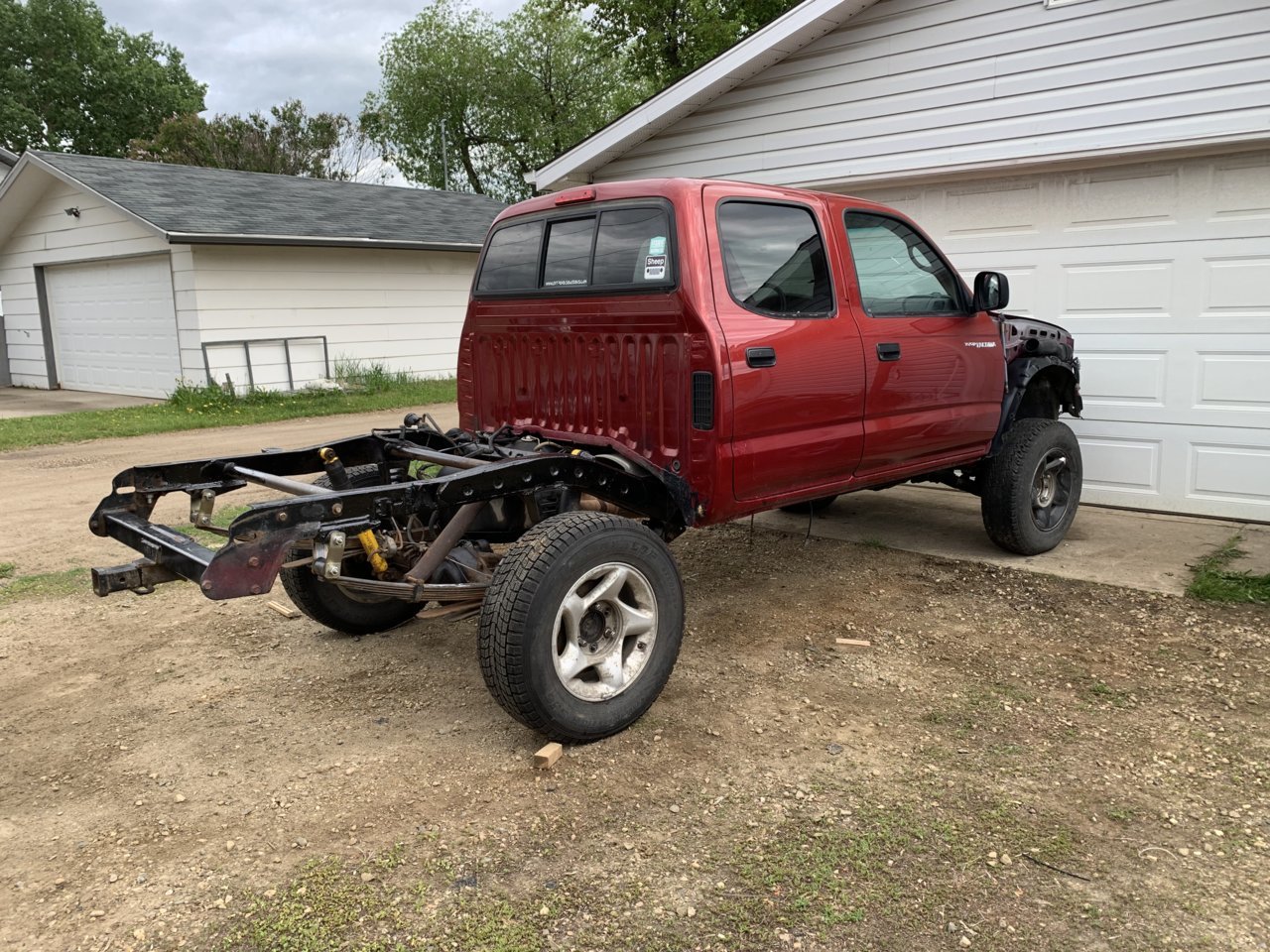

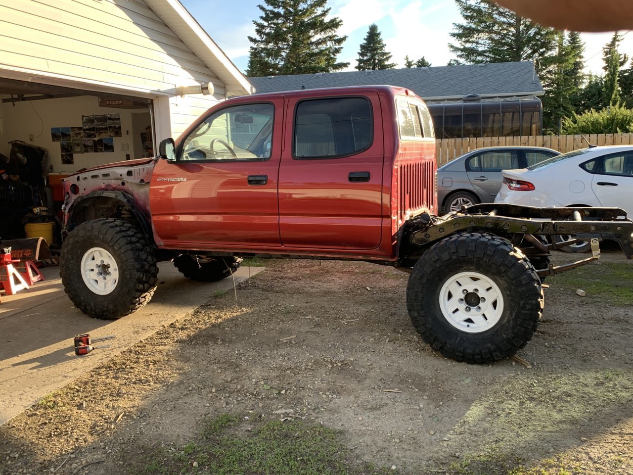

    And she’s on the frame! Pretty stoked! By 6:30pm Sunday night, the cab was set and bolted down.

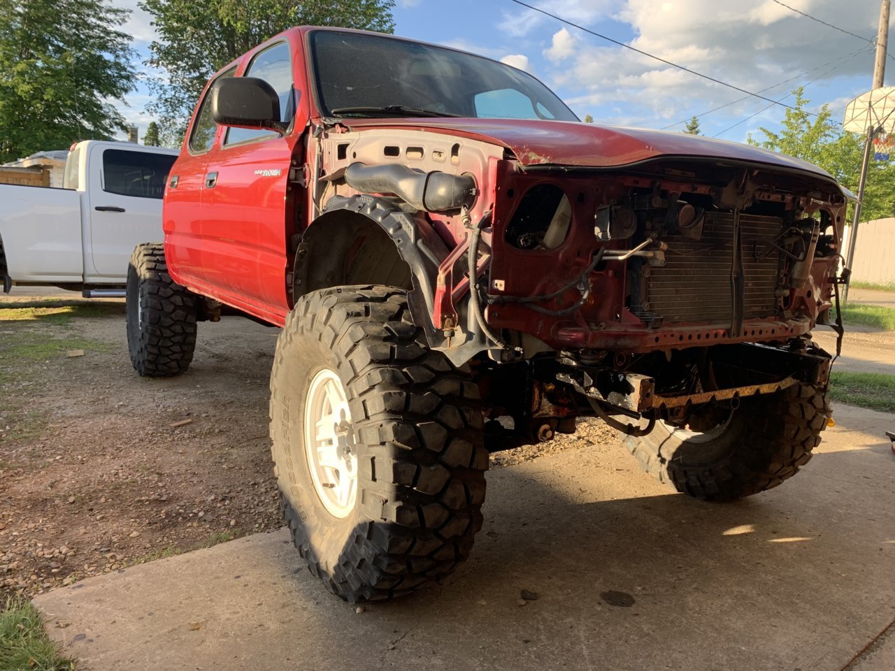

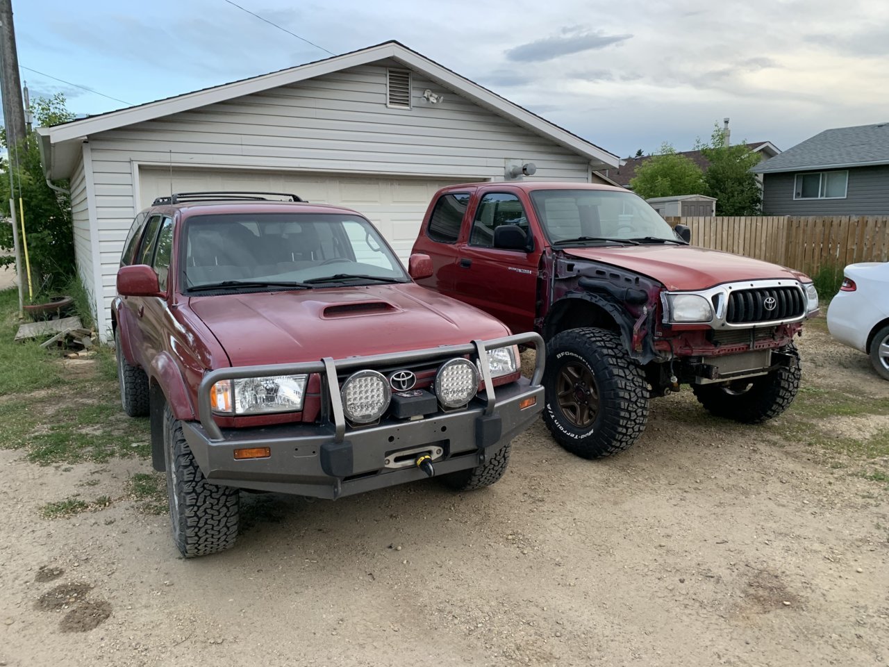

    And got after hooking up fuel lines, electrical, etc. Should be running by the weekend. And had to throw the krawlers back. Just cause. :D

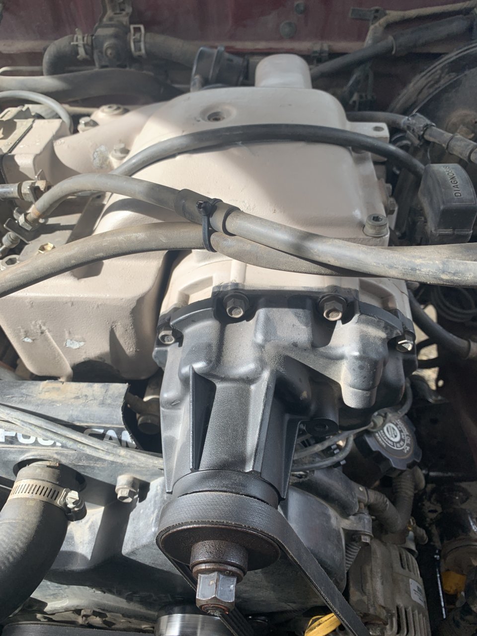

    So, supercharger is coming off. Bearing issues. I’ll get a rebuild kit coming, but for now, it’s going back to n/a. This will really give me a good seat of the pants check on the difference that 4.88’s make!

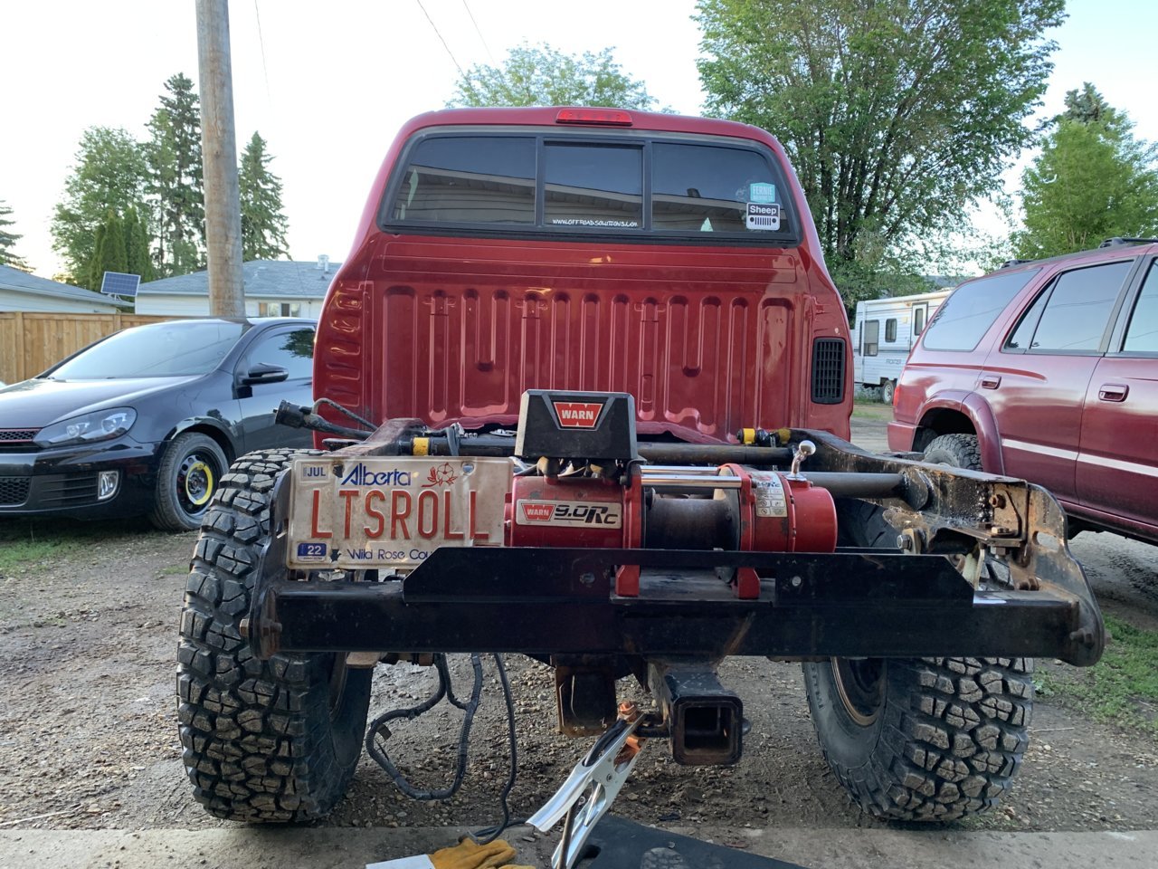

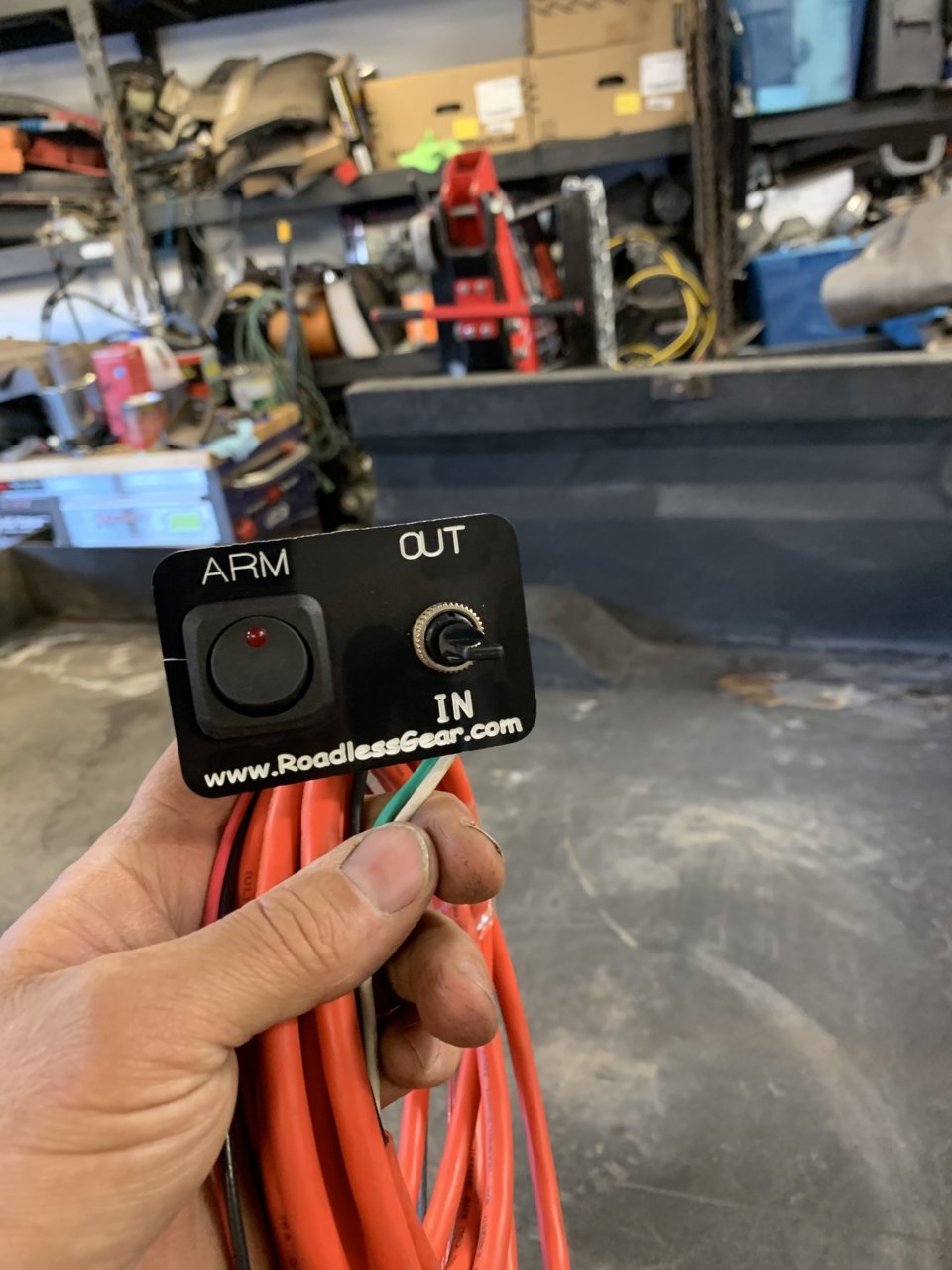

    Got the rear winch set up started last night. I’m going to build a battery box in the floor of the box, and mount my second battery in there. I also have a mean green alternator on the way, to ensure I have enough of da joose to power it all.

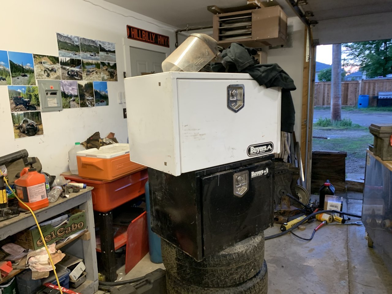

  15. Jun 25, 2020 at 12:59 PM
    #175
    POSTacoMike
    Nov 4, 2019
    #309824
    1,114
    Red Deer AB

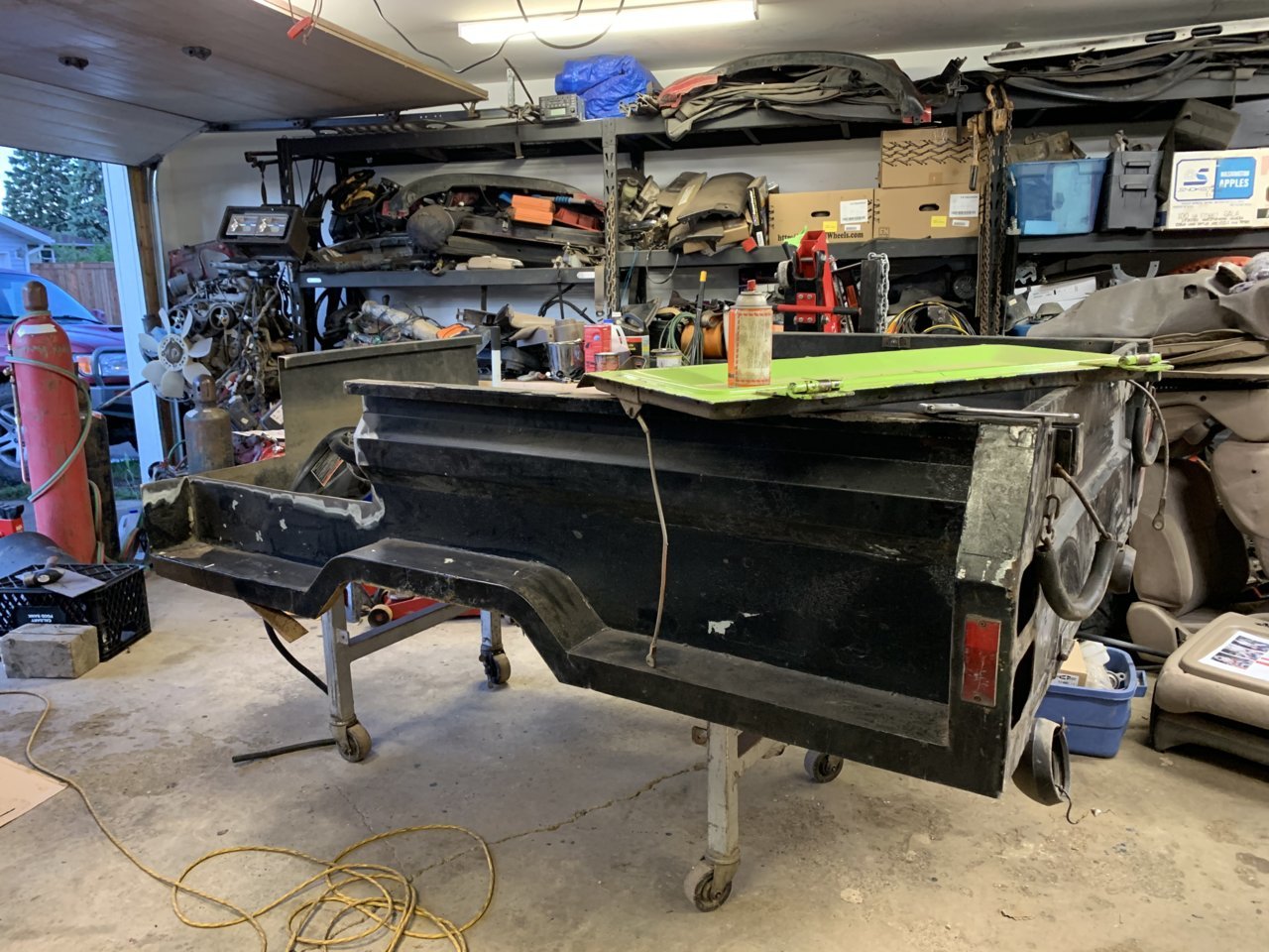

    Rear loggers box. I’m going to sink a box into the bottom, just behind the axle, and set my second battery in there. The Viair set up will go in the passenger side tool box.
    Slashaar, Taco critter and Hawco636 like this.

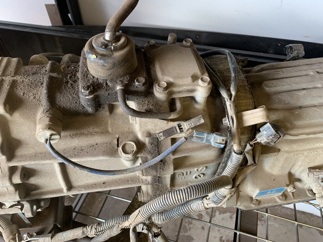

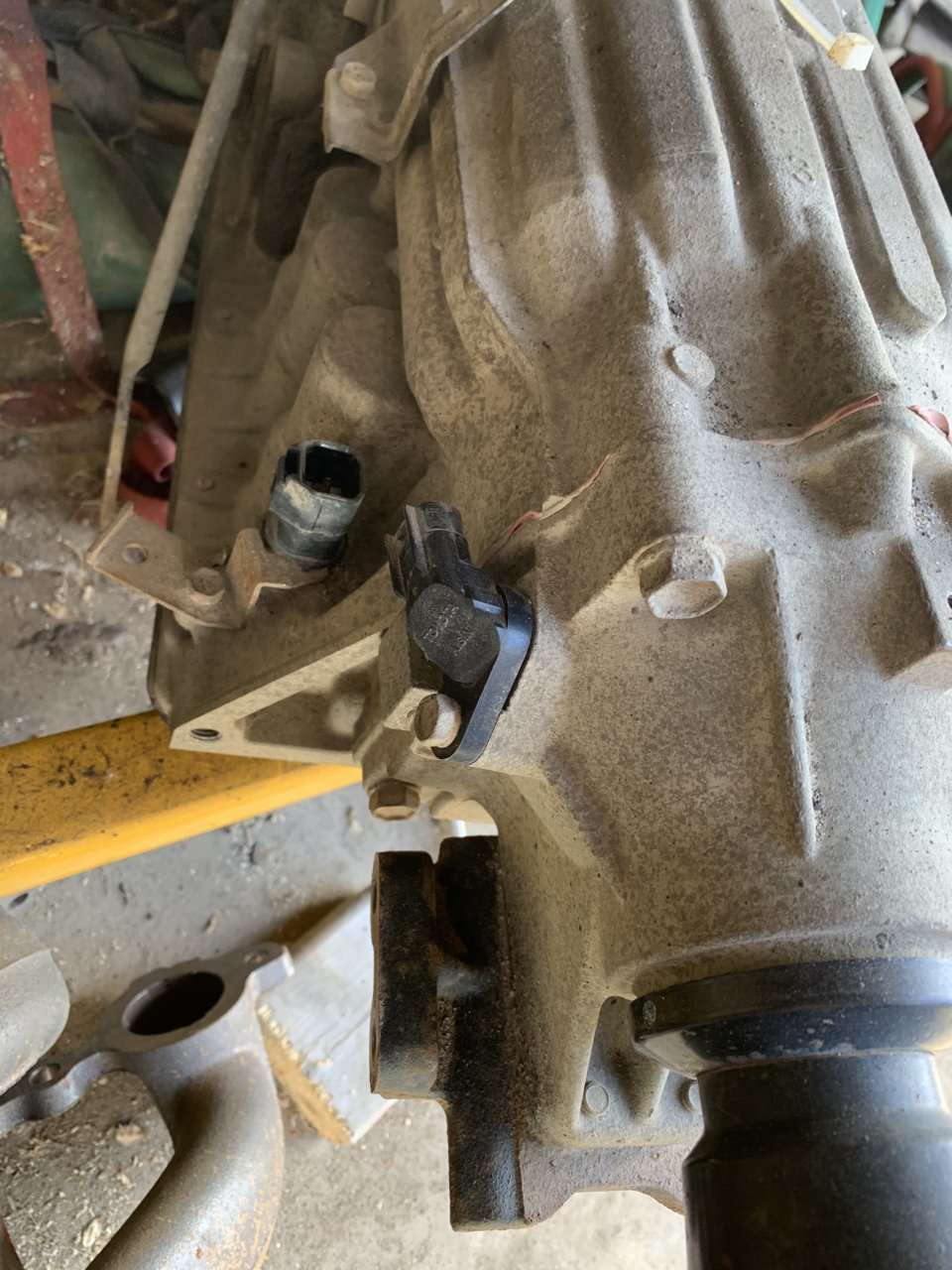

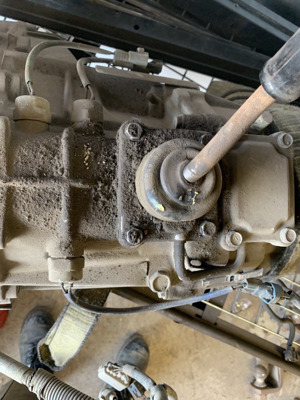

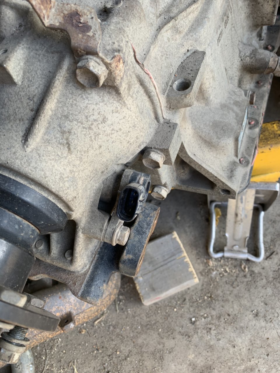

    4wd trans/tcase
    Slashaar likes this.
  17. Jun 25, 2020 at 5:46 PM

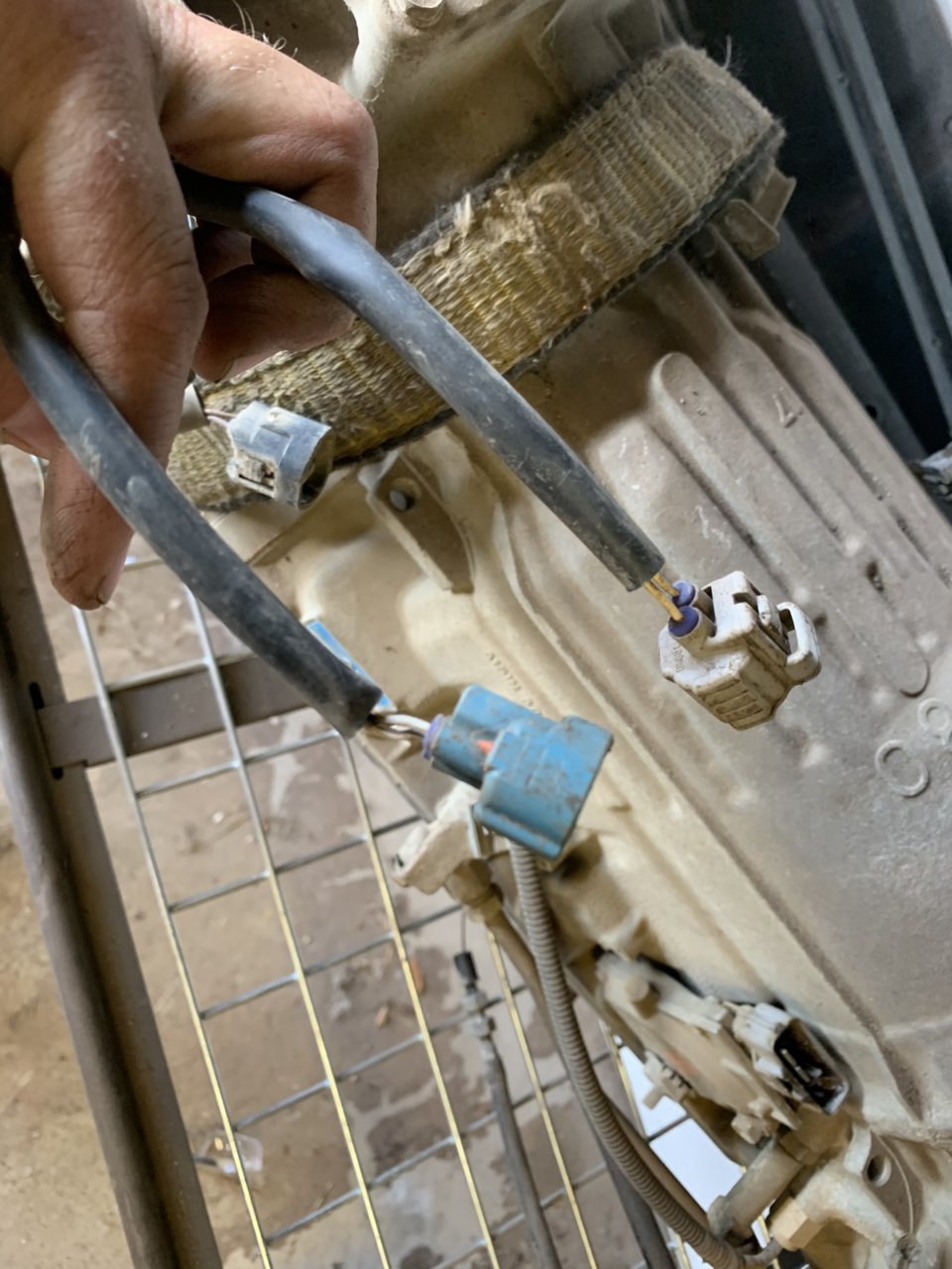

    2wd trans connections.

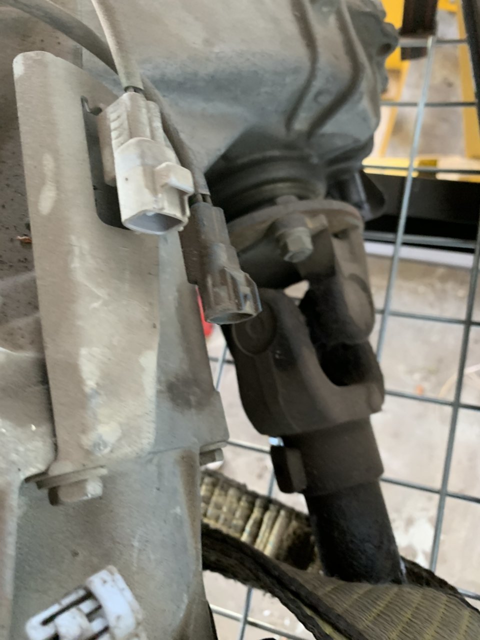

  19. Jun 25, 2020 at 5:48 PM
    #179
    POSTacoMike
    Nov 4, 2019
    #309824
    1,114
    Red Deer AB
    Transfer case plugs.
  20. Jun 25, 2020 at 5:52 PM
    #180
    BartMaster1234
    Aug 21, 2016
    #195197
    45,895
    Tyler
    Pittsburgh, Pennsylvania
    Flux Capacitor
    90% of those plugs are useless. They’re 4WD position sensors that tell the 4WD computer if you’re in 4HI, 4LO, or Neutral. Their only purpose is to prevent you from activating the RR DIFF LOCK in any mode except 4LO, and also to light up the light on the cluster.
    The 3 pin connector is your VSS, and the 45 degree angle one is a redundant temperature sensor.
