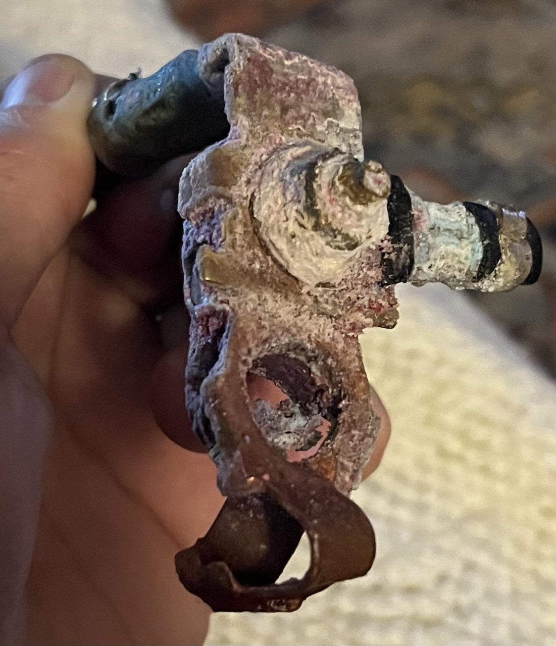

    Here’s the terminal…I did have to cut it off from the battery cable because the corrosion was so bad.

    Yikes. Might have to whack the cable off farther down the line. Then you're stuck trying to pull the cable up close to the battery and use a shitty universal clamp terminal like washeem mentioned. There's universal positive cable assemblies available at OReilly that come with 6-8 inches of cable.. but the terminal clamps that come with those are always pretty dinky
    If you can separate the cable from the terminal where the bolt is and clean it up good, a proper toyota style clamp might work
    If you like the truck and want to take care of it, consider putting some money into an entire OEM cable assembly. It'll fit perfectly and last as long as the original one

    Time for a cable upgrade. Cables will have corrosion inside them that you can't clean off.

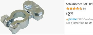

    The cheap way is a $3 universal terminal. A better way is using a butt connector, but you need a crimper and heat shrink tubing. If you are in San Diego area, I can do this for you. When I added my second battery, I went overboard and ended up with lots of extra wiring, butt plugs, cable ends, shrink tubing, and terminals. Bring craft beer, and we’ll call it even.

    While I like the concept of a quick release, I don't like how the starter wire connects to the terminal - same as the cheap universal terminal above. And no terminal cover?
