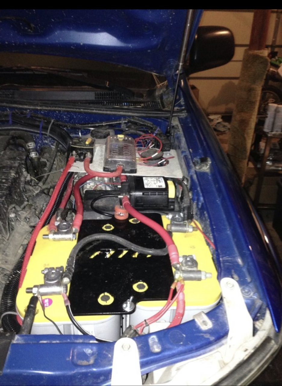

    I had to double take that pic too. First I was thinking I’ve never seen a single battery with 4 posts. Then you can see it’s 2 yellow tops. It’s gotta be for something other than cranking.

    No doubt it's very professional looking. Maybe part 12V & part 24V. The black motor looking thing looks like it has a pos. from each individual batt. connected to separate lugs.... For me very interesting, and looks like a really nice job, congrats.

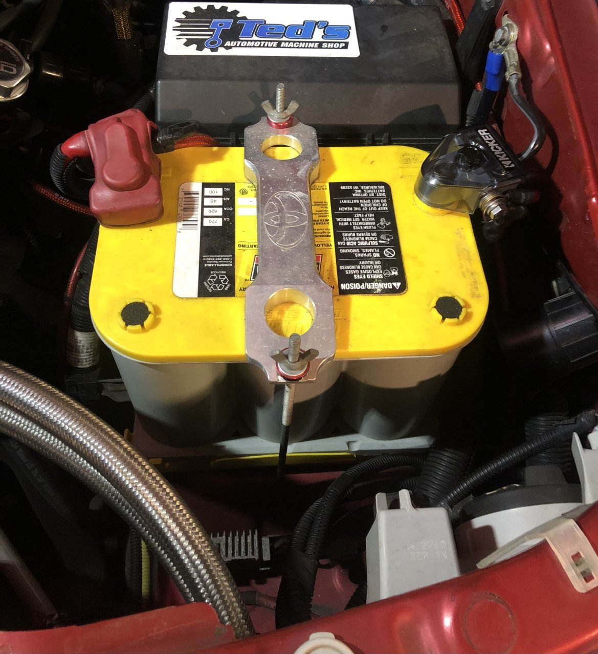

    892AC8CC-F733-4A4D-8DC3-EF83B6169491.jpg 1692ED3B-7346-4E0C-8C0E-69A6B0D4225C.jpgI have these kicker battery terminals on the negative side it works well. The factory positive is easy to add more wires. If I ever need to replace it I would replace it with another kicker terminal.
