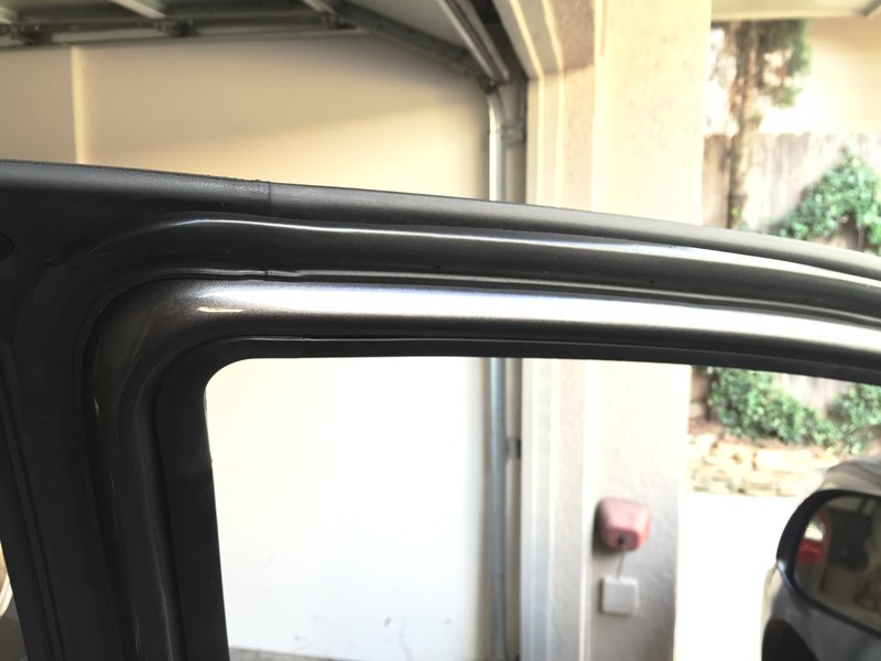

    Ok guys, here's some photos of where I put my tape. So far on one drive yesterday, it worked fantastic! First one shows where I put it on the door. I just a single piece on the weatherstripping where it would meet the body. It's very difficult to see but it runs right on the weatherstripping.

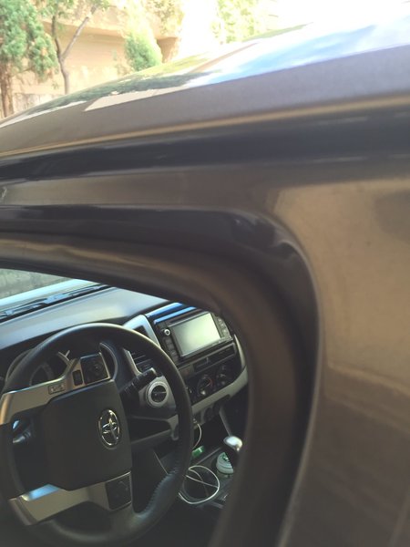

    Here's the second, where I put it on the body. It blend in very well but this one you can see where the end of the tape doesn't lay flat, I hadn't completely fixed that when I took this picture. That helps gives you an idea of where I put it.
    This is the most important one I think, I ran an errand with it earlier yesterday and the noise was reduced by at least 90%! However, I took this one off on the way home and it came back, this seems like it's the more important one to worry about, at least for me.
    Hope this helps. I'll updated later this week on how it holds up. Supposed to get some rain too so we'll see if it leaks.

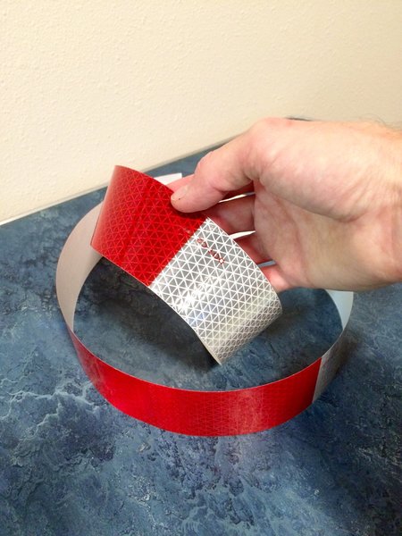

    I'm going to replace the magic tape with this. The tape will have a secondary purpose. If I'm parked on the side of the road and the door is open, reflective tape! The noise on mine is coming from the top of the door only, not the corner or the vertical side portion. I'll cut a 6" x .5" strip and put it across the top of the door. I'll probably do both front doors for symmetry. Ha Because I'm sort of a perfectionist like that.
