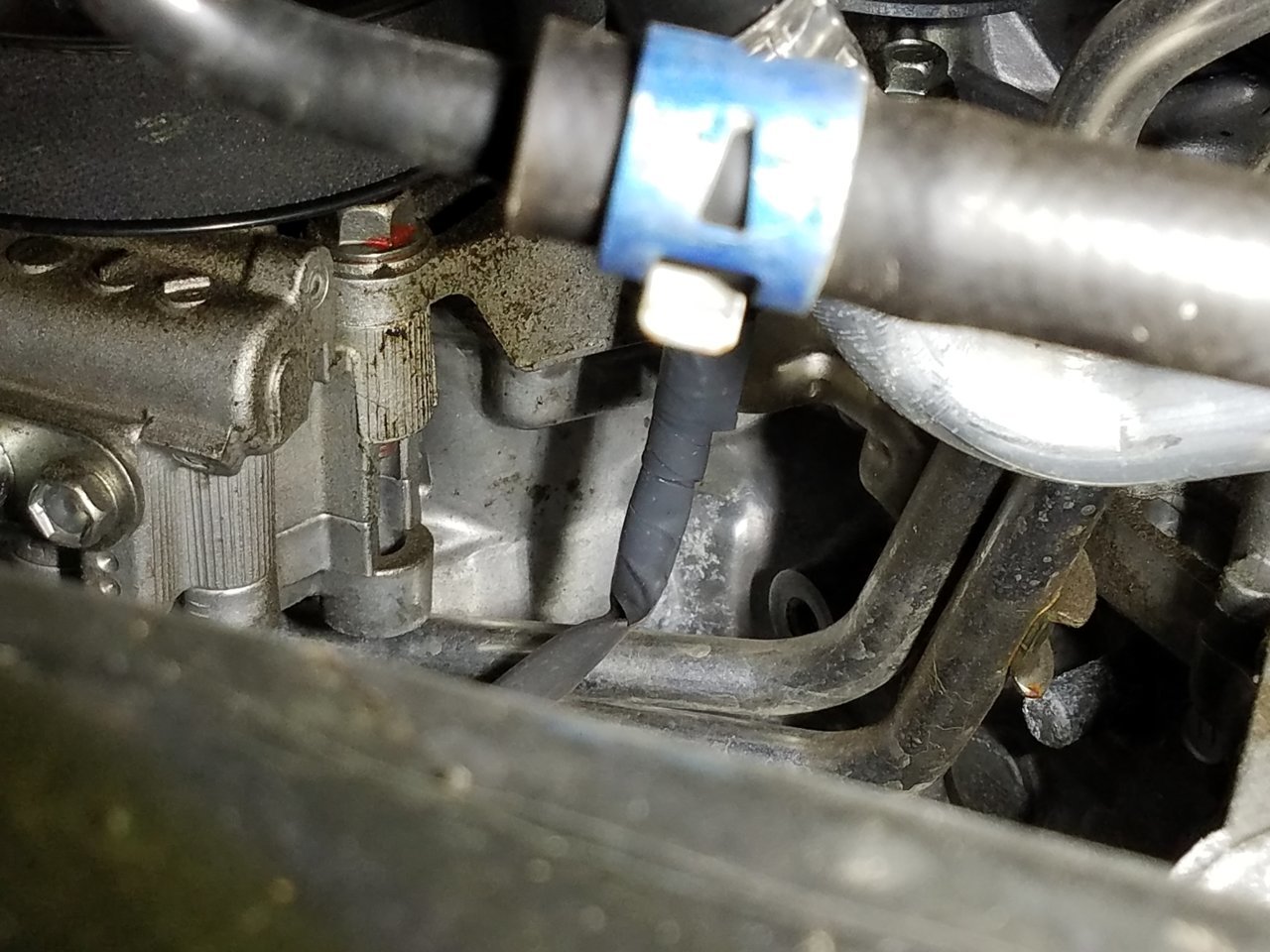

    20180805_153428.jpgThis was a pic I snapped when I was under there.

    Not bad enough to worry about. You don't even have a drip forming.

    I wiped the drip off before I snapped the pic. Actually cleaned it really good after that pic to see how fast it returns.

    If your still under warranty get it repair. It's only going to get worse.

    So can only be seen from the bottom not the top?

    Remove the skid pan and look to the passenger side by the PS pump.

    They identified the leak at the 1 year service, 9497 miles on the truck at the time. It was fixed at 11835 miles.

    Most of the leaks on these engines are from poor fipg placement. The nozzles on the robots get out of adjustment and it's up to the people assembling to catch it. They are leak tested on line and hot tested, but some small leaks take a bit to show up.

    Add my truck to the timing cover leak. Just can’t catch a break. This truck has been the most unreliable vehicle I have ever owned. That’s pretty sad as I’ve owned a bunch of Bmw’s. Think after this repair i May think really hard on getting rid of it.
