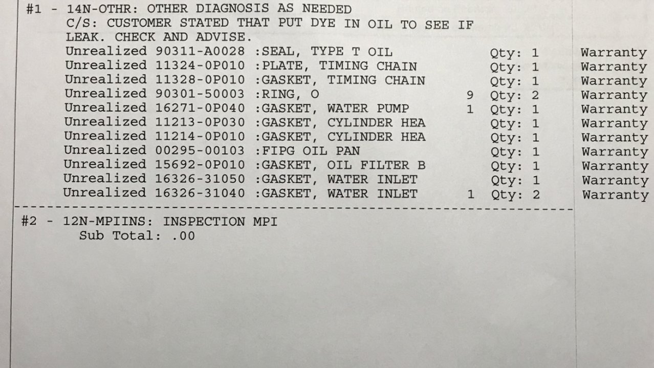

    On the parts list they gave me, there are 7 different gaskets, including these two:
    11213-0P030 :GASKET, CYLINDER HEA
    11214-0P010 :GASKET, CYLINDER HEA
    Presumably, this means that nothing got lost in translation when they told me ‘head gasket,’ but I haven’t checked the parts list yet.
    You bring up an excellent point: Should I have them look into the coolant system, as well?
    Modesto Tacoma and shakerhood like this.

    Those are valve cover gaskets. You can probably match up the rest of the parts list on this diagram.
    https://toyotaparts.toyotaofclermon...4__6786933/MANIFOLD-ENGINE-PARTS/8519175.html

    I am sure they have looked it over thoroughly. They would desperately try to avoid pulling the head, so if they've committed to that, then they must be convinced beyond doubt that that is what is required. If a Dealership could simply replace a valve cover gasket rather than a head gasket, they would certainly do that. Don't let me undermine your confidence in the Dealership's assessment, I'm just sharing my experience, and certainly my experience is going to be less than that of a professional mechanic like they tend to employ.
    Well, it does seem they are replacing BOTH head gaskets while they are in there. Goodness. There is a literal metric fukton of gaskets involved in this, and in the aftermarket world companies like Felpro sell head gasket sets for this type of thing, it's cheaper to buy them this way, and there are many more gaskets involved in this than simply a head gasket. The entire top end of the engine has to come off, as well as the front end, down to the short block. This is a real big job they're doing, and I don't envy them in this with all the timing chain complexity involved in dual overhead cams on 2 heads. Let alone all the other stuff involved. Wow.
    But.......when I google the images of the part numbers you provided, those look like valve cover gaskets rather than head gaskets, even though the nomenclature is "head gasket." Make sure you send us all the part numbers of what they replace, it will be on the repair ticket.
    Editing--I see crazy beat me to that conclusion, he types/googles faster I suppose.

    Thank you both for clearing up the issue with parts, and especially @Opihi59 for providing such a detailed explanation of the process. Here is the complete parts list:
    Based on that, does it look like the valve cover issue that many others have had?

    Head gasket PN is 11116 0P020 best as I can tell. Really does look like they're replacing valve cover gasket, as well as timing cover, waterpump etc, so front end of engine, and valve covers. Not as big a job as a head gasket replacement. I'm not sure I understand their choice of nomenclature on this. Valve cover gasket completely different job from a head gasket job for certain.
  15. Feb 20, 2018 at 9:05 PM
    crazysccrmd
    crazysccrmd Well-Known Member
    Mar 17, 2016
    #181592
    9,239
    Alaska
    Aprilia Tuareg 660
    Maybe the full title is gasket, cylinder head, valve cover? Similar to your typical military names for stuff - “truck, utility, cargo/troop....”.

    I am unable to find it that way. But I do find head gasket proper as "engine cylinder head gasket" Who knows?

    I haven't seen a 3.5 leaking from the head gasket. If it is that would be a very rare occurance. Most of the 3.5 leaks have been from the front timing cover. There wasn't enough sealant put on the timing cover during assembly. The leak occurs close to the head and will look like a head gasket failure. I would have them check it very carefully before they begin.
