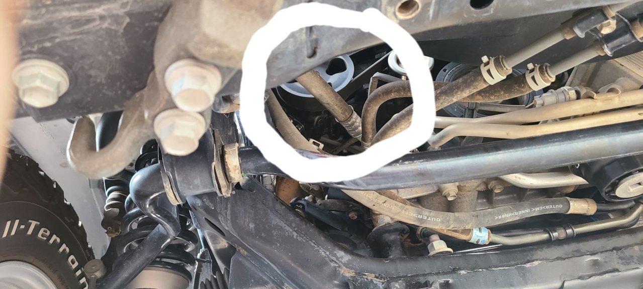

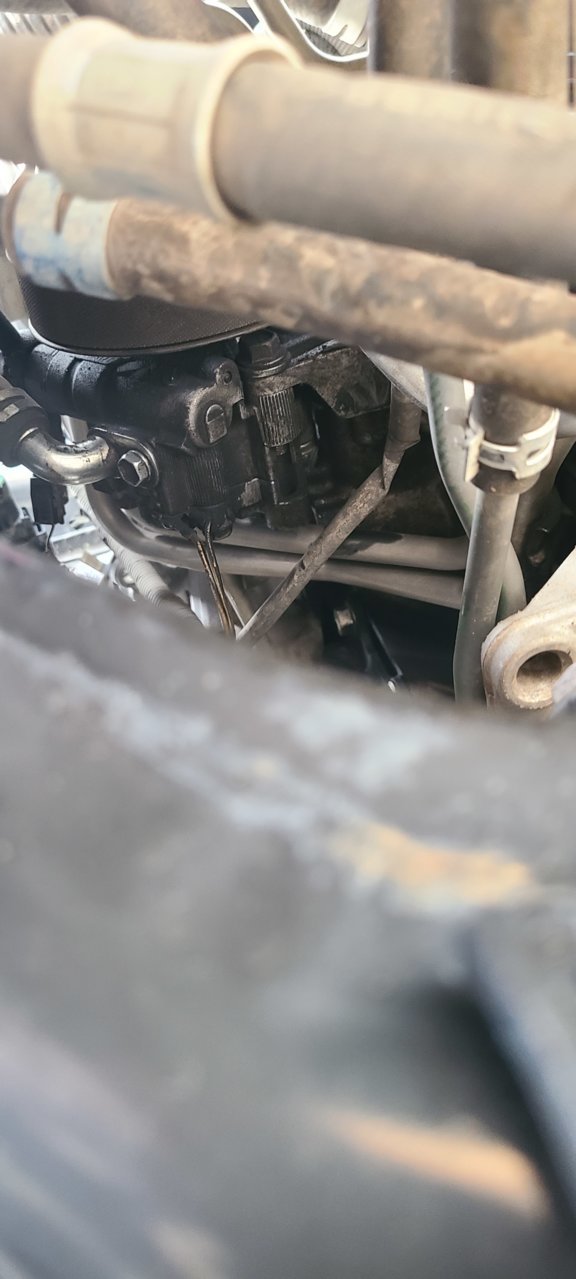

    Can this be left, or should it be fixed?

    Fix it, especially if it's under warranty.

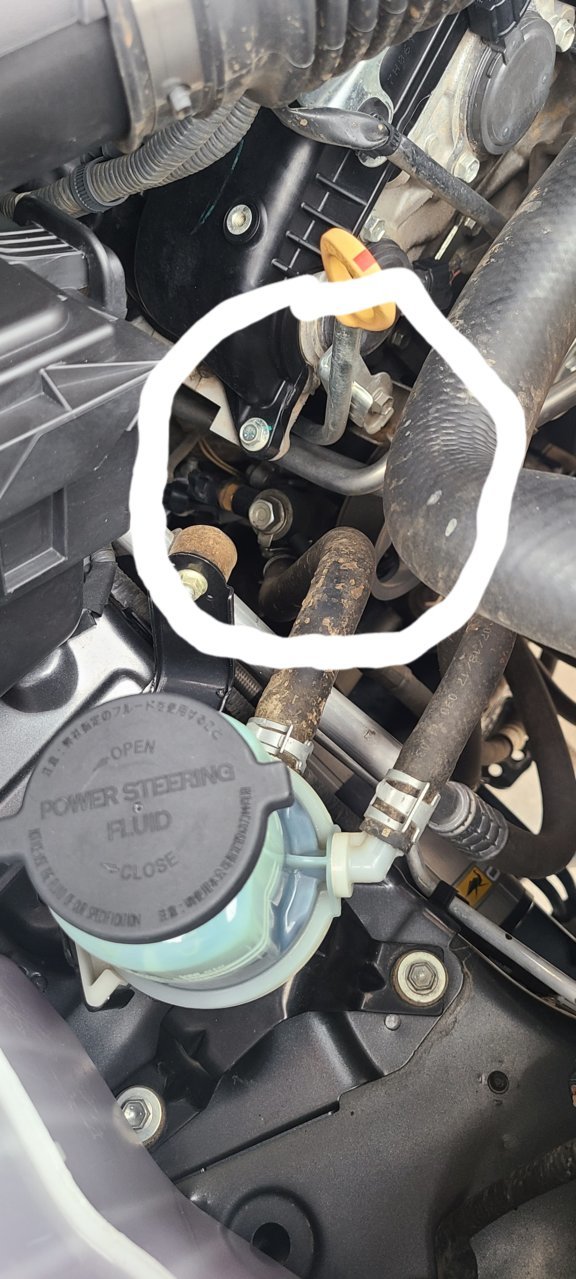

    Dammit, took off my skid plate to put on an RCI and it was covered in oil.
    I have 75k miles so no warranty for me but man I wish I would have noticed it before my warranty was up.
    I'm not paying $3500 to have Toyota do it but I'm also not going to spend 3 days to do it myself so I think I'm just going to live with it.

    Where is your leak coming from ?

    By the power steering pump.

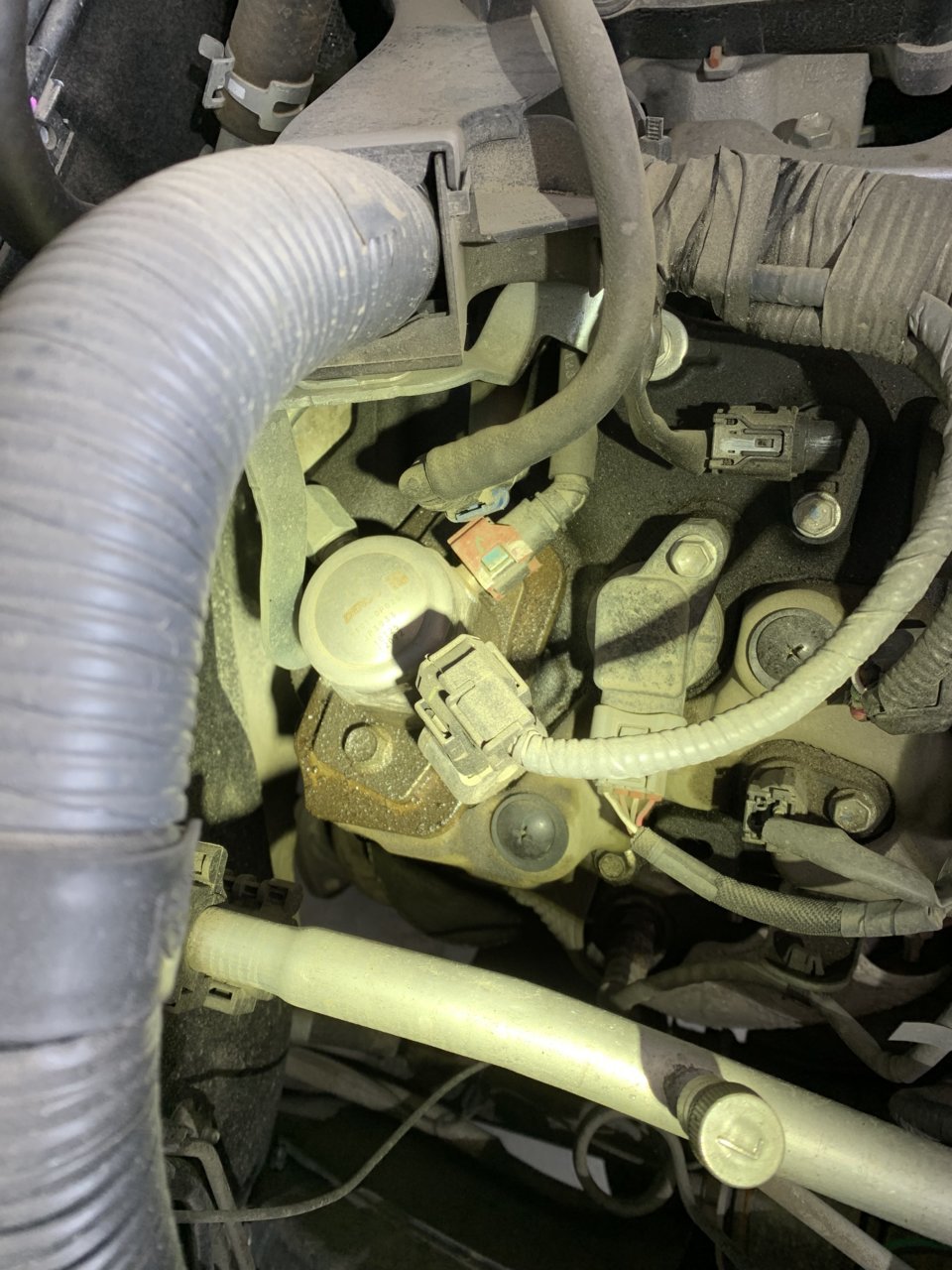

    Well I had another leak.
    This time they say it was the right side valve cover. It was repaired under warranty. Strangely, they also said that this leak is the same as the last one, which we thought was the timing chain cover. It’s a different dealership and I didn’t have a great impression of this service advisor so we will see what the paperwork says when I pick it up tomorrow.

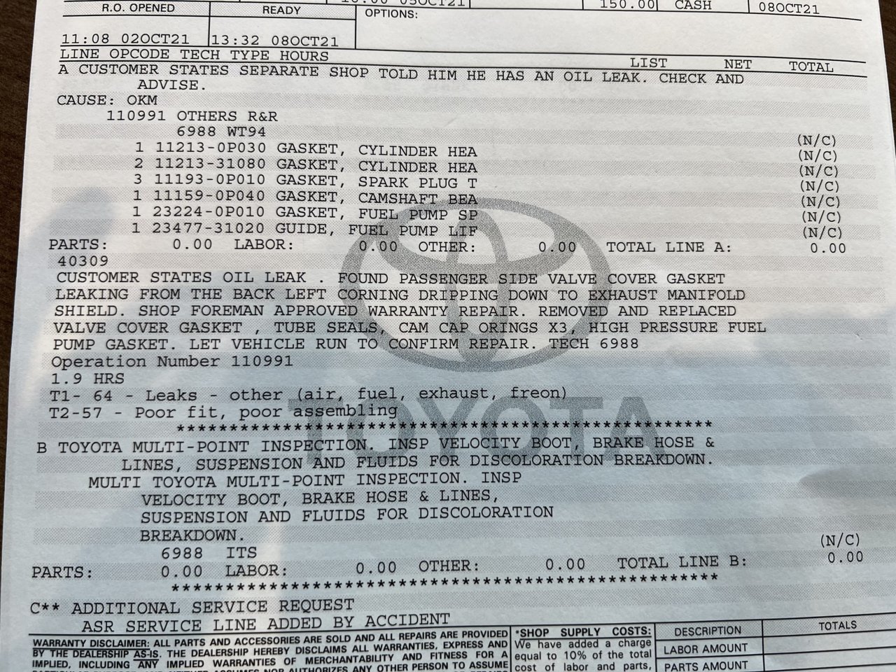

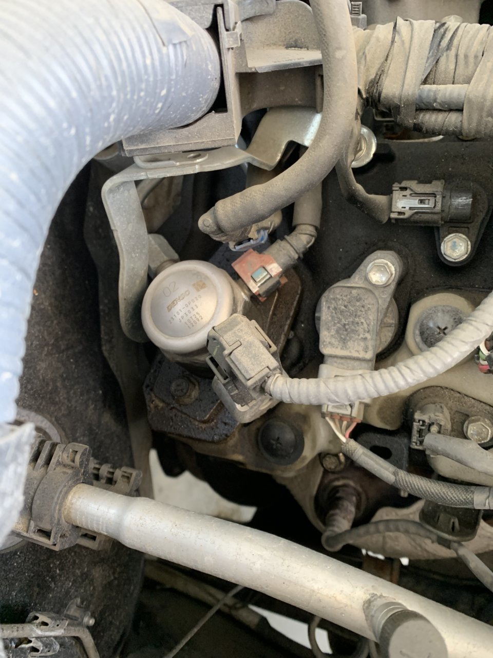

    Looks like it was different this time:
    They fixed it under warranty.
