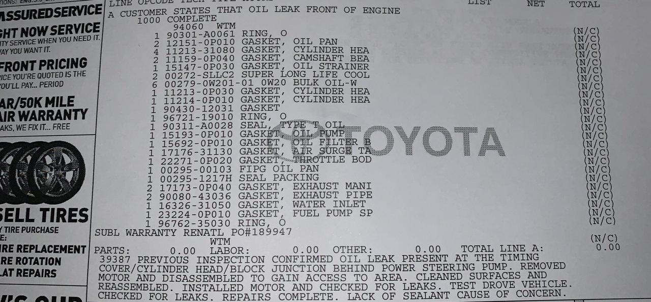

    Got my truck back today, super happy to be back in my own truck.
    Just in case anyone is curious, I now see why they pulled the engine out. They replaced about every gasket I can think of on the engine, even the cylinder head gasket. Hopefully with these brand new seals the life of my engine got extended by another 40k miles:D

    You dont have to pull the engine but its a big job one way or the other. Glad it's resolved!

    Hey Rusty, I'm at 44K and noticed a leak and thought it was oil but turns out it's coming from the pump. Did you find out if it was just a hose or the pump you need to fix?
  10. Oct 8, 2019 at 5:07 PM
    #50
    shakerhood
    shakerhood Well-Known Member
    Aug 9, 2015
    #161370
    37,040
    Southern Ohio
    2017 MGM DCSB Off Road, 6 Speed MT, P&T
    His was the timing cover leak.
