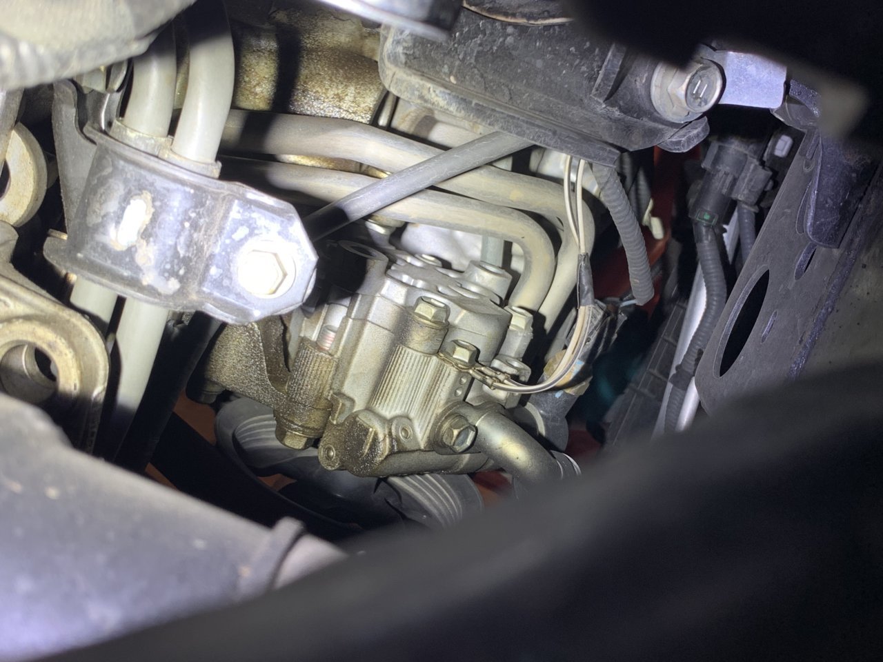

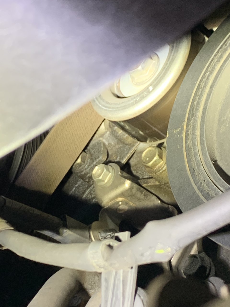

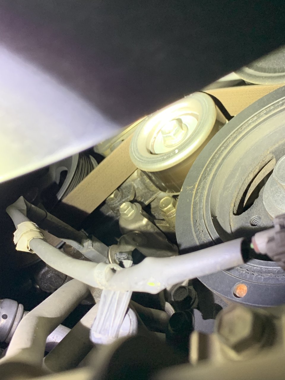

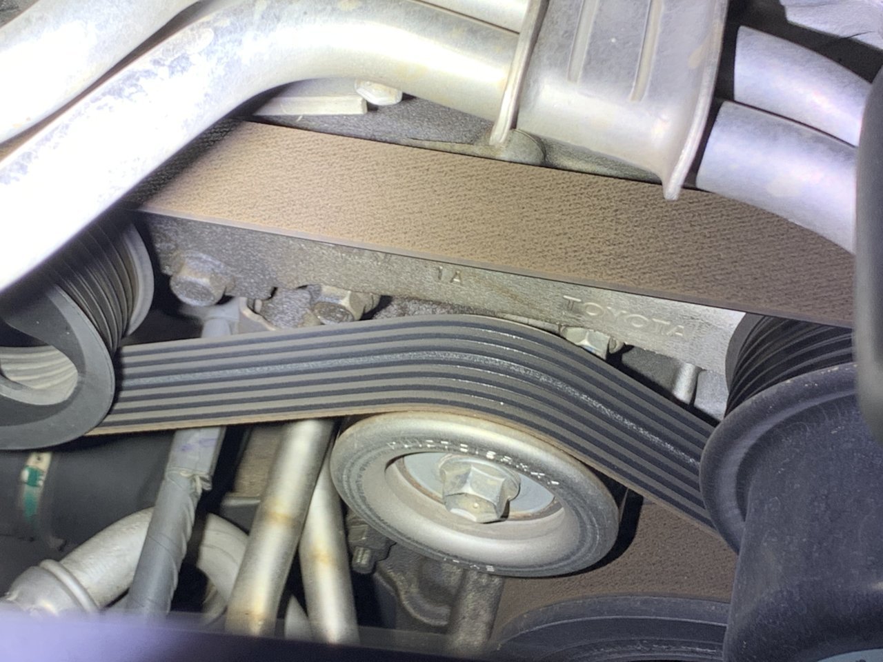

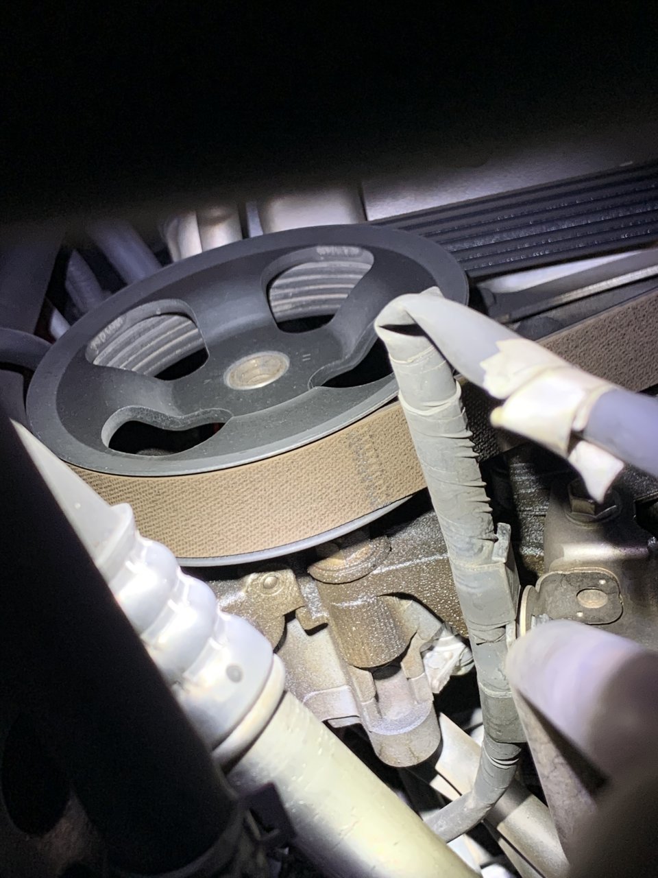

    Hey all,
    I changed my oil today (40k miles)and while I was changing it I made a not so good discovery. Yes, shame on me. I found that I was low on oil by about 3/4 of a quart or slightly more. I do get on the gas, I’m not afraid to rev her up but would it burn that much oil in a 10k oil change span? Started looking around the engine bay and I saw some “seepage” that may be a culprit in my low oil level as well? What do you guys think? It’s pretty dirty around the power steering pump. I plan on taking it in to have it looked at. I did buy the Toyota extended warranty so I’m not worried about it being denied if anything needs fixing, especially if it’s the power steering pump. I’d appreciate any feedback!
    Thanks!

    yup, thats oil all right.. need to clean it off with brake cleaner... take it for a "spirited ride" and narrow down on where its coming from.. lot of that looks old.. most likely a valve cover gasket leak..

    That’s what I figured, but it seems like it’s heavily originating from the pump? I’ll clean up the engine bay with some degreaser and check it after a good joy ride to see. Then I’ll be on my way to Toyota! Seems like it may be the well known oil leaks in the front of these engines.

    Also, I wouldn't clean it up. Take it to the dealership and let them see the leak. That way, it's documented. They will probably clean it up then have you return for a re-inspection in a couple thousand miles. It's covered by the powertrain warranty if it's the timing cover leak.

    I’ve read into the engine cover leaks, I just wanted a second eye as to whether it could more than likely be the power steering pump and not the engine cover. Thanks for the feedback though, I’ll be scheduling an appointment and leave it as is so they can see it and then track it. Thank you!

    It's a timing cover leak.
    Some dealers are pressured to make fewer warranty claims, some are desperate for work, you have to talk to them and be nice.

    PS pump. Front seal. Take it in and don't clean it.
