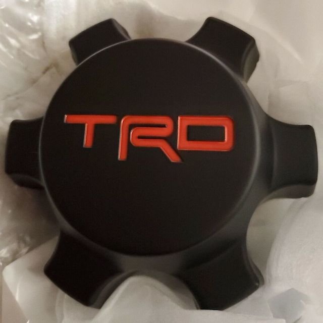

    Hi all. I'm working on a set of wheels for my 3rd gen (20% gloss black powdercoated FJ 8-holes) and trying to sort out center caps. I may just paint the ones that came with the wheels, but I'd prefer a matte black OEM option that fits.
    I can't find the thread now, but I read that these can be made to fit the 8-hole rims with slight modification (p/n PTR20-35111-BK):
    My question is whether that TRD logo is removable? The back side of the cap shows that it's not a clip-in piece, so I'm wondering if these are just a puffy decal? or actually molded into the plastic?
    If anyone knows for certain, or knows of a different matte black center cap I should consider, I'd appreciate the information. Thanks,
    --MW

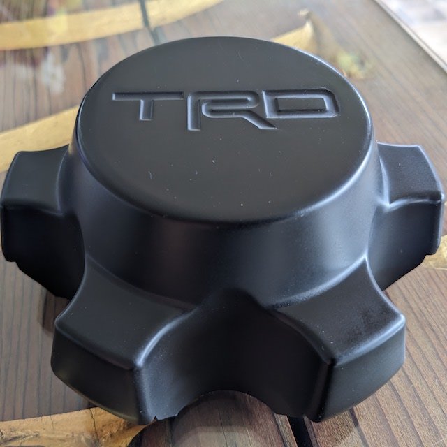

    Updating my own thread in case anyone else falls down this same rabbit hole. After reading this other thread and messaging with
    @Boogyman, I ordered a set of PTR20-35081 caps to try with the FJ 8-hole rims.
    At first, I tried a set of black decals from TVD that I thought were correct for the caps, but the decals didn't completely cover the lettering: I was left with black letters thinly outlined in red. Kind of a cool look, but not what I want. Didn't take a picture.

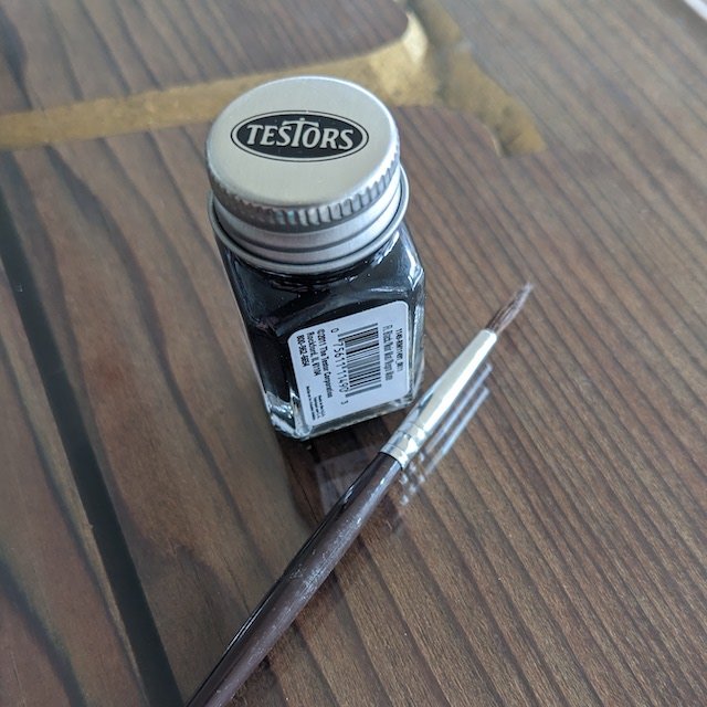

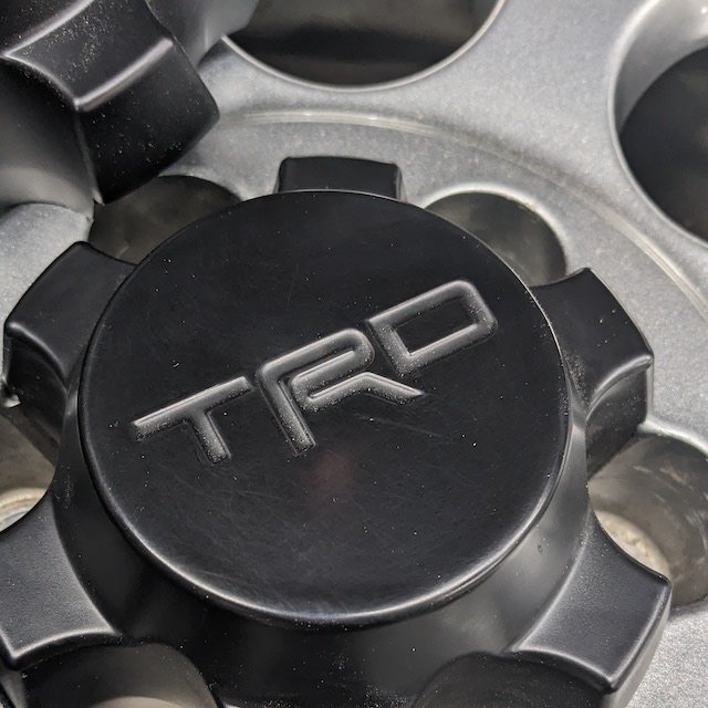

    I ended up using hobby paint and a brush to liberally "fill in" the lettering with black paint. This worked well, and I used some micro mesh to "sand" off the inevitable spots where I painted outside the lines. I don't recall the grit, but it was pretty easy to find one that matched the sheen of the caps.

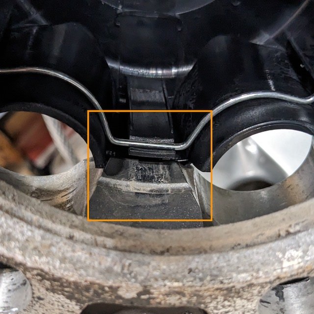

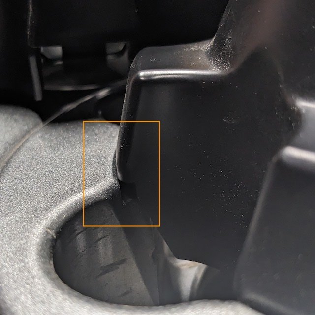

    One big caveat here is that the clips on these caps don't actually engage with the groove on the wheel. The picture doesn't show it well, but it's not even close.
    However, you can carefully and forcefully flex the "points" of the cap down into the rim and achieve a solid friction fit. First two pictures show the cap just sitting on the rim, third picture shows it "seated" down into the rim.
    I'm not super confident that friction fit is enough to keep the caps on the rim, but I'm assuming this is how @Boogyman and others have run theirs, so I'm going to try it and see how it goes. Wheels are at powder right now (ended up going 10% gloss), will update again when I know more.

    I used a rubber mallet to tap all the tabs of the center cap into the wheel. My bronze 8 holes are actually for sale now

    But the clips or whatever they're called don't actually engage the rim, right? It's a friction fit at each of the six points? Want to confirm that I haven't completely missed something here.
  13. Mar 28, 2023 at 1:49 PM
    Boogyman
    Boogyman Well-Known Member
    Aug 17, 2012
    #84975
    13,328
    Phoenix
    Corpus Christi, TX
    2022 Lunar Rock Trail Edition
    Yup just friction fit. One of mine doesn’t even have the metal clip in it
