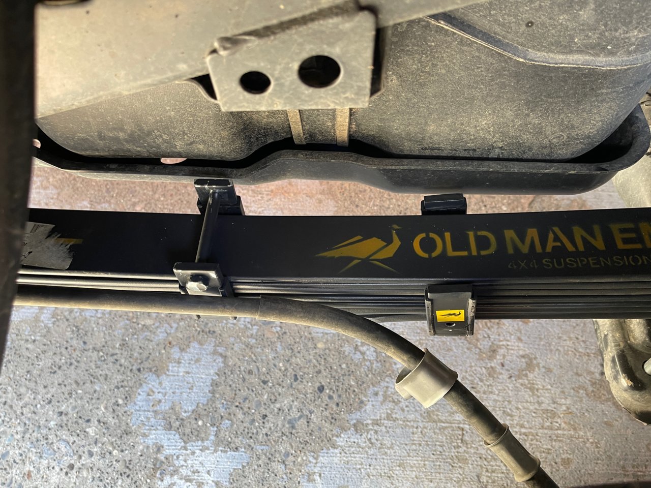

    When buttoning everything back up I was unable to get a hose line mount re attached as it was too tight when the Springs were unloaded. Now that everything has settled there is just enough room to re attach the clip but I fear it will pull too tight during full extension. I can re adjust the nearest mount to pull the line away from the spring packs and just leave this mount off and attempt to remove the bracket from the line. Below is a photo of the line:
    Has anyone else had to deal with this? What are your suggestions?

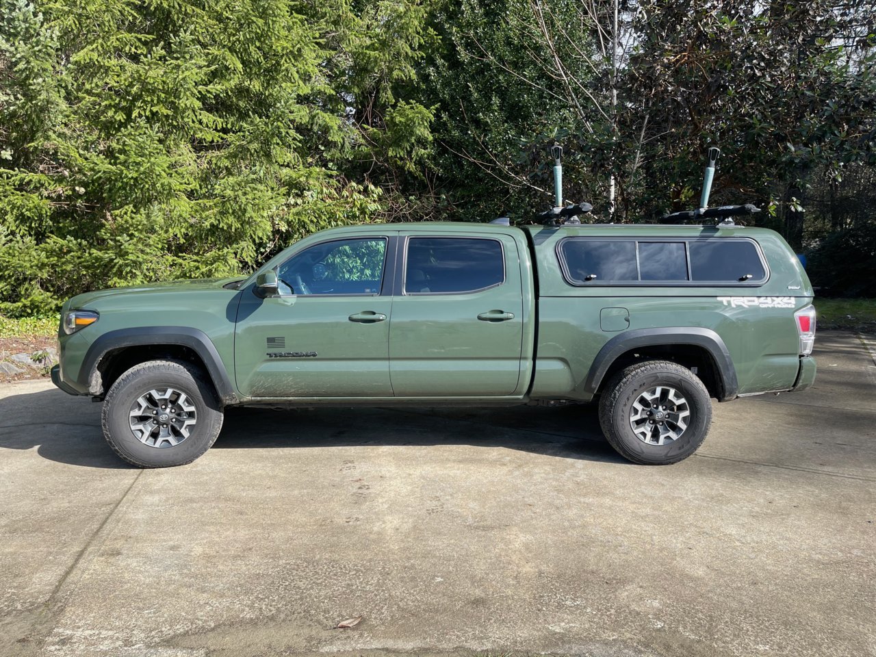

    Here is before:

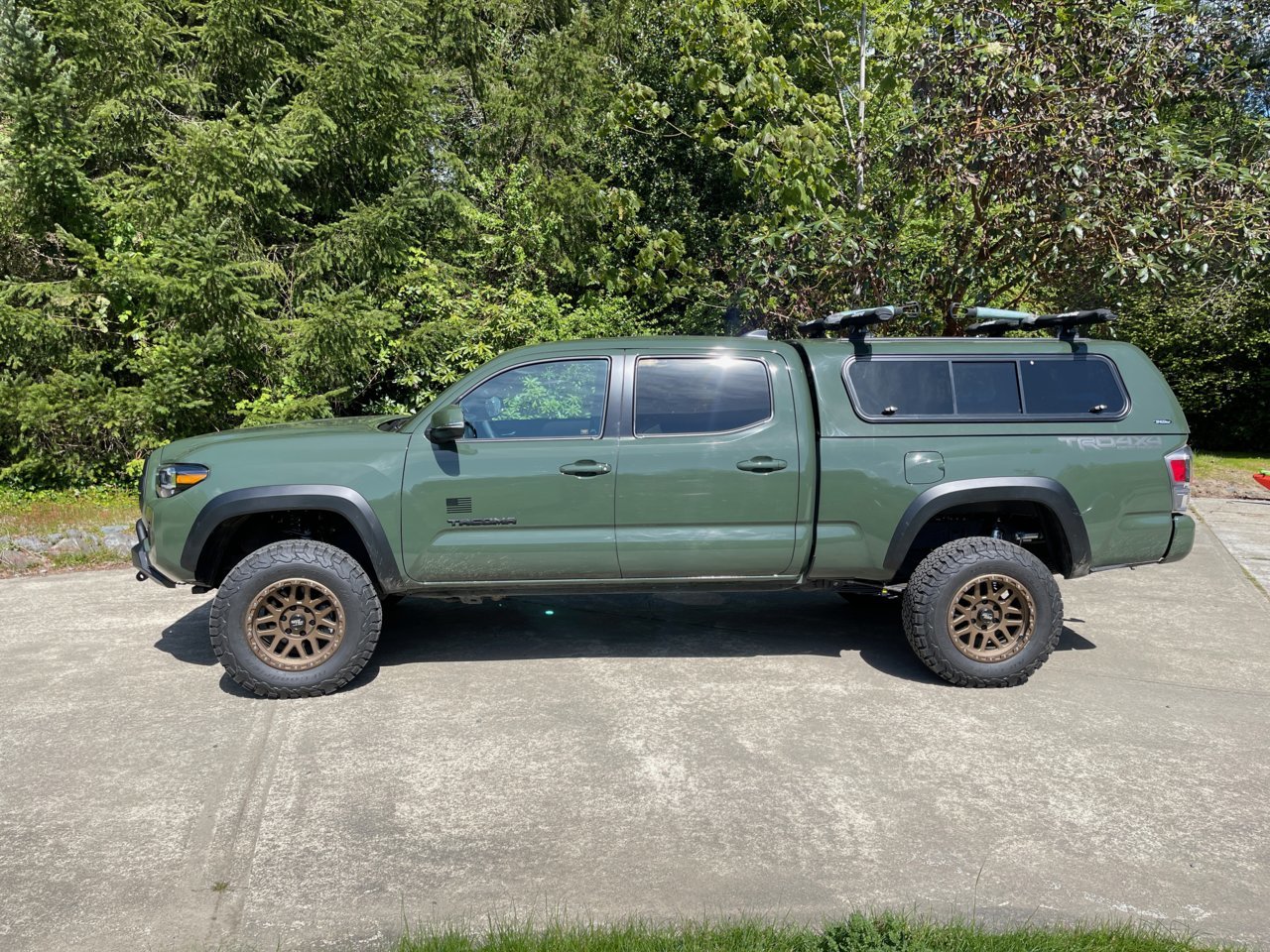

    Here is after:

    Don’t spend $ on that. Just go to Ace and buy a cable clamp and a pair of lawn mower springs. The springs allow the cable to droop when flexed but tuck up tight and I spent less than $20
    But it in the end you need you cable attached to the leafs.
