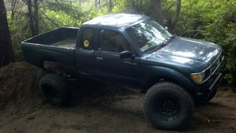

    Let Post some pictures of some SAS TACO's
    2wd Sorry for the lack of Flex :brianr:
    All Shine Up. Chrome Lug Nuts Give You 10hp :D

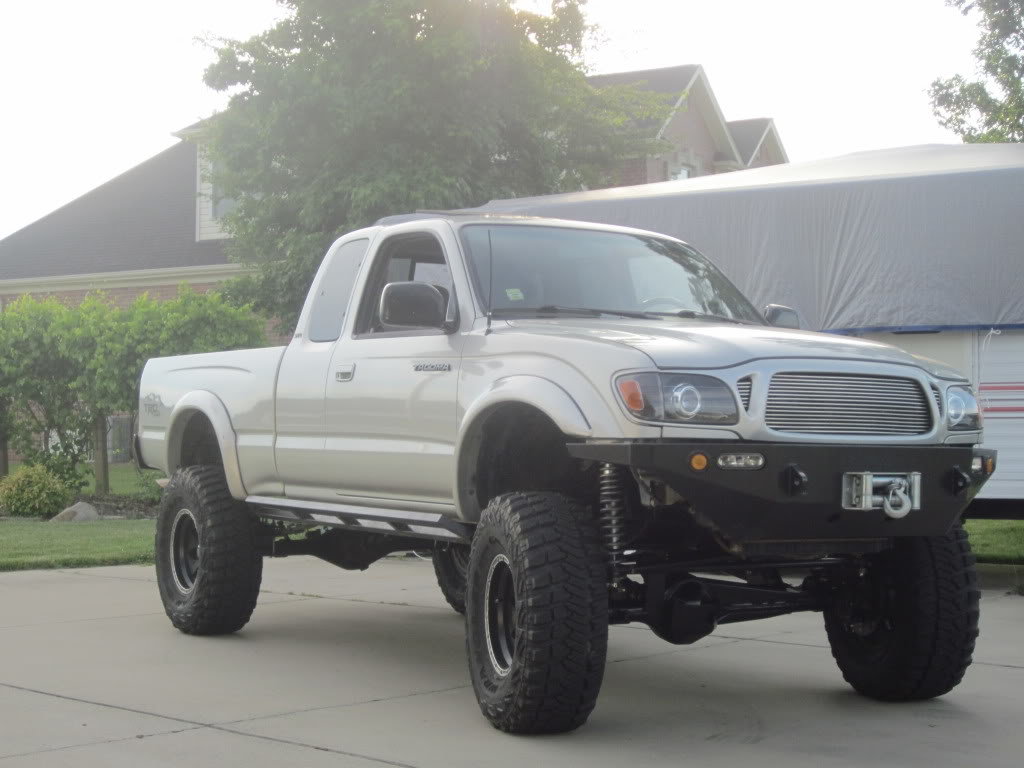

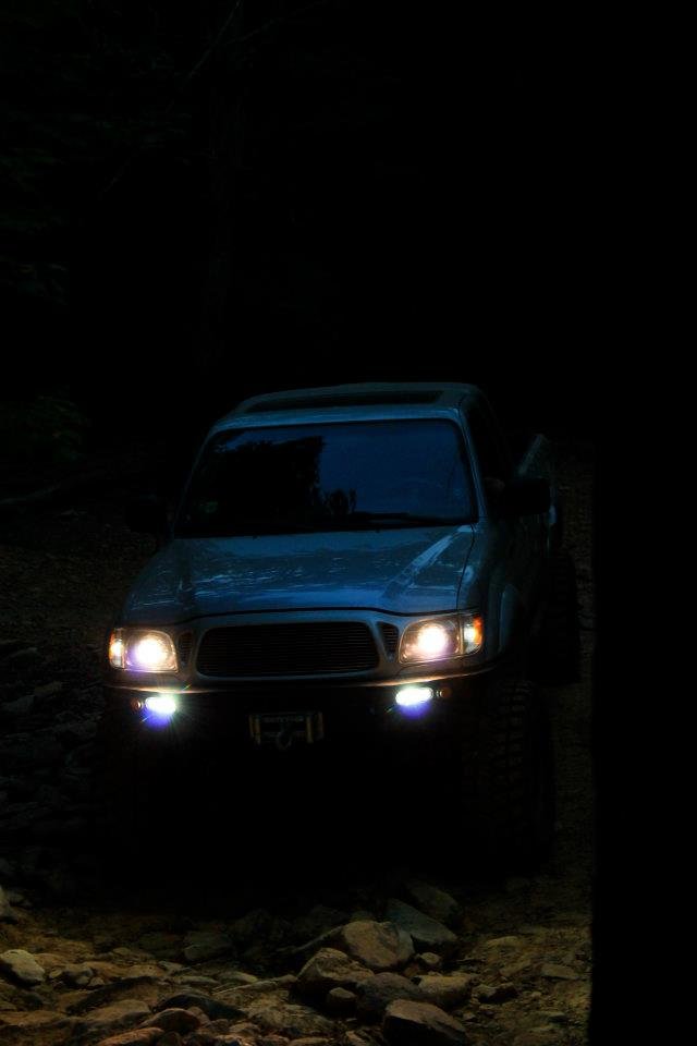

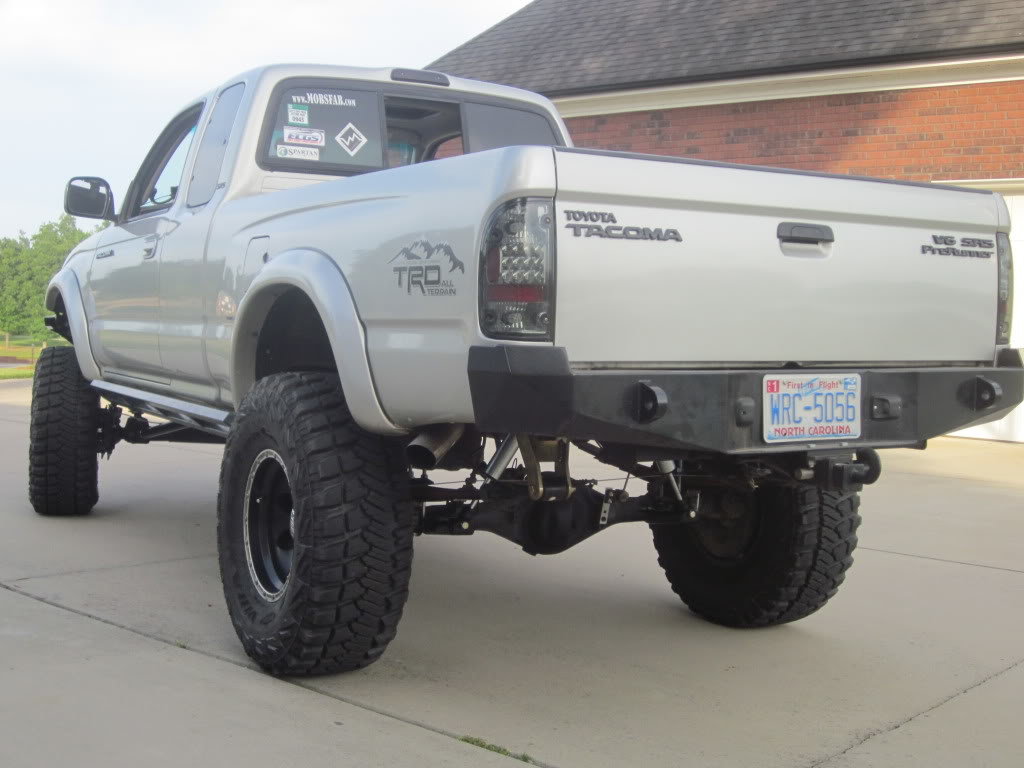

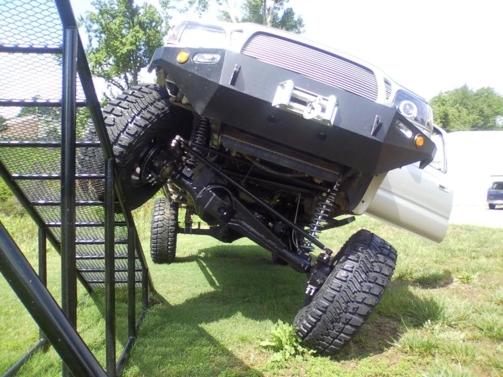

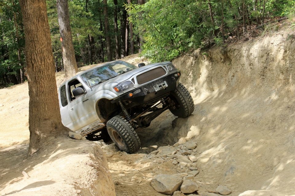

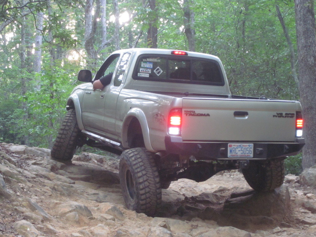

    It's not much, but here is my pile of hell
    2001 Tacoma Prerunner
    Drivetrain
    3.4 V6 with 140,000
    1997 4Runner automatic transmission
    Inchworm adapter with 79 gear driven case with 4.7
    Front Axle
    79 Toyota Pickup
    4.56 gears and bearings
    Spartan locker
    79 FJ40 vented rotors
    95 4Runner Calipers
    Trail-Gear 2in wheel spacers
    Trail-Gear chromolly hubs
    Trail-Gear HD drive shaft
    Trail-Gear diff guard and bracing
    Rear Axle
    Factory E-locker
    Front Suspension
    Custom 3 link --> done by M.O.B.S. Fab
    Wheel base stretched 1.5 inches
    2 in, .25 wall DOM on the links
    Trail-Gear 6 Shooter knuckles and high steer
    Fox 12in Coilovers
    Eibach 10in, 250lb top coil
    Eibach 14in, 350lb bottom coil
    Rear Suspension
    Stock springs with three leafs out of another Toyota leaf pack, cut to length
    2 inch Toytec Shackles with new bushings
    12in Fox 2.0
    Tires
    33x12.50r15 Goodyear MTR Kevlars
    15x8 Eagle Alloy's
    Armor
    All work also done by M.O.B.S. Fab
    Bumpers, front and rear
    Sliders
    Full under belly skid
    Lighting/Electronics
    Custom retrofit HID swap (done by me) with 5K bulbs
    Swap the Hella 75FF in the front bumper to 5K HID's
    Dash and panel swap to blue LED's
    White LED's in the map and dome lights
    LED's in the front corners
    LED tail, reverse and turn signals
    7in LCD in dash screen
    8,000lb Smittybilt winch
    12 Volt Guy winch control

    Very Clean build.

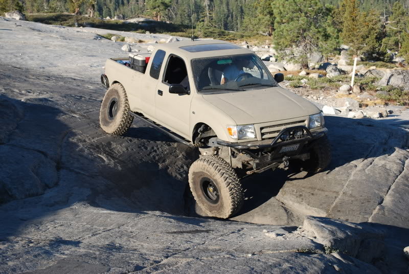

    My previous truck

    Very clean, what were the specs?

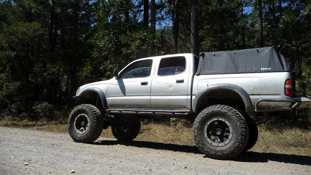

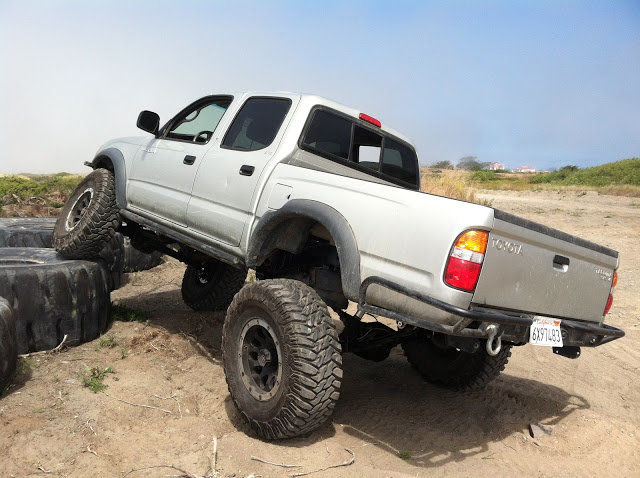

    Most recent:
    Love my SAS as it makes the truck so much more capable. But I have to admit, Has made off-roading locally a lot less fun :-( Nothing around here is challenging unless I specifically want to roll it over on its side for yucks!
    Plus I have so FEEWWWW flex shots, poser or otherwise. Usually end up wheeling in small groups or — GASP! — with just me and my girl and dogs! have yet to get the dogs to understand proper exposure settings & framing. They keep giving me back overexposed garbage shots with half the truck out of frame ;-)

    Looks great man. Do your tires rub at all on your fenders?

    Front no rub, rear rubs a touch under full compression. I trimmed away the metal snaggies at the front of the rear wheel well, then hammered what was left -- just enough for the fender flares to bolt up to -- and have pretty much let the tires to gently push out the tight spots over time. Small rub marks on the flares is all I get now.

    Note that the rear setup I have moves the centering pin forward so that the tire comes up centered when compressed instead of way to the rear like stock
