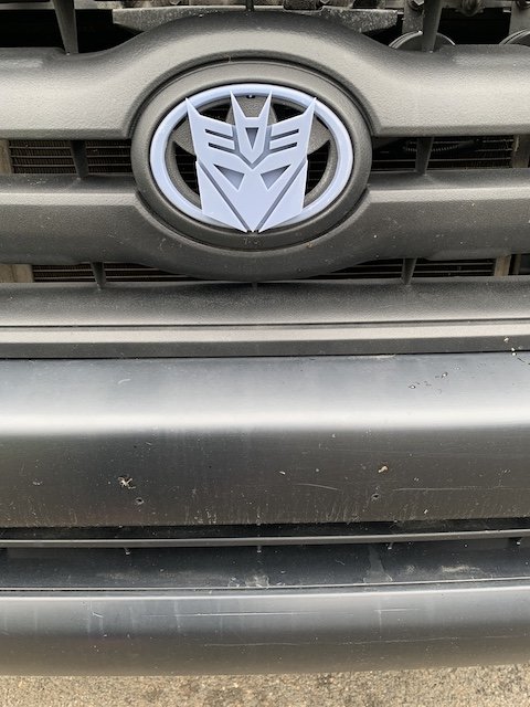

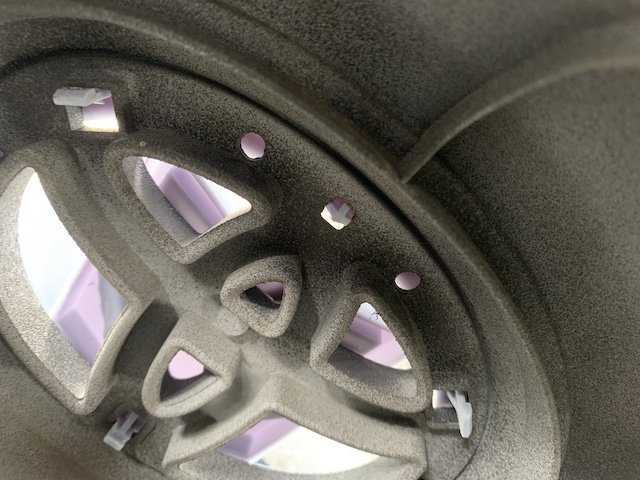

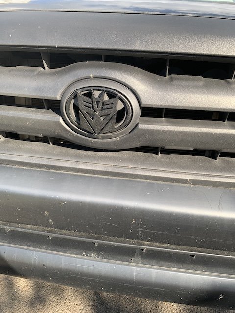

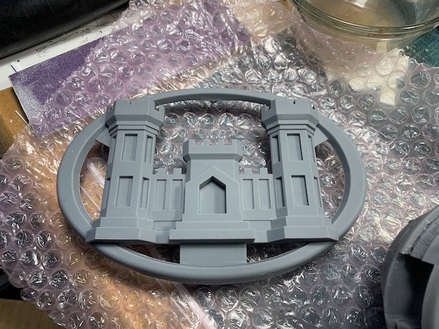

    Created the Decepticons for myself. The engineers insignia is for a good buddy who is an Army Engineer. He owns a 2.5 Gen., so the emblem is significantly larger. I will finish the Engineers when I get finished with the contract I am currently working. Stuck away from home until contract is ended.

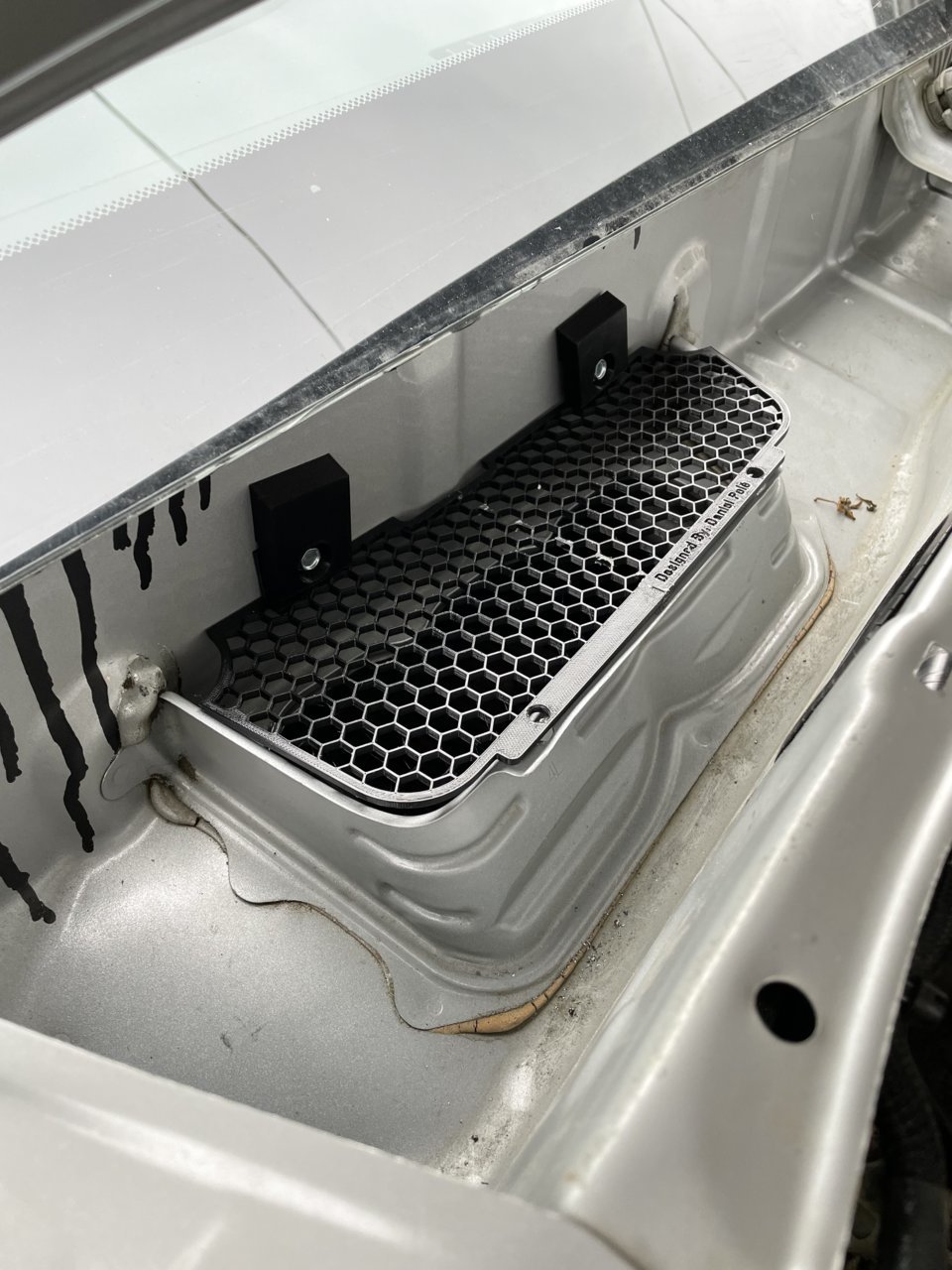

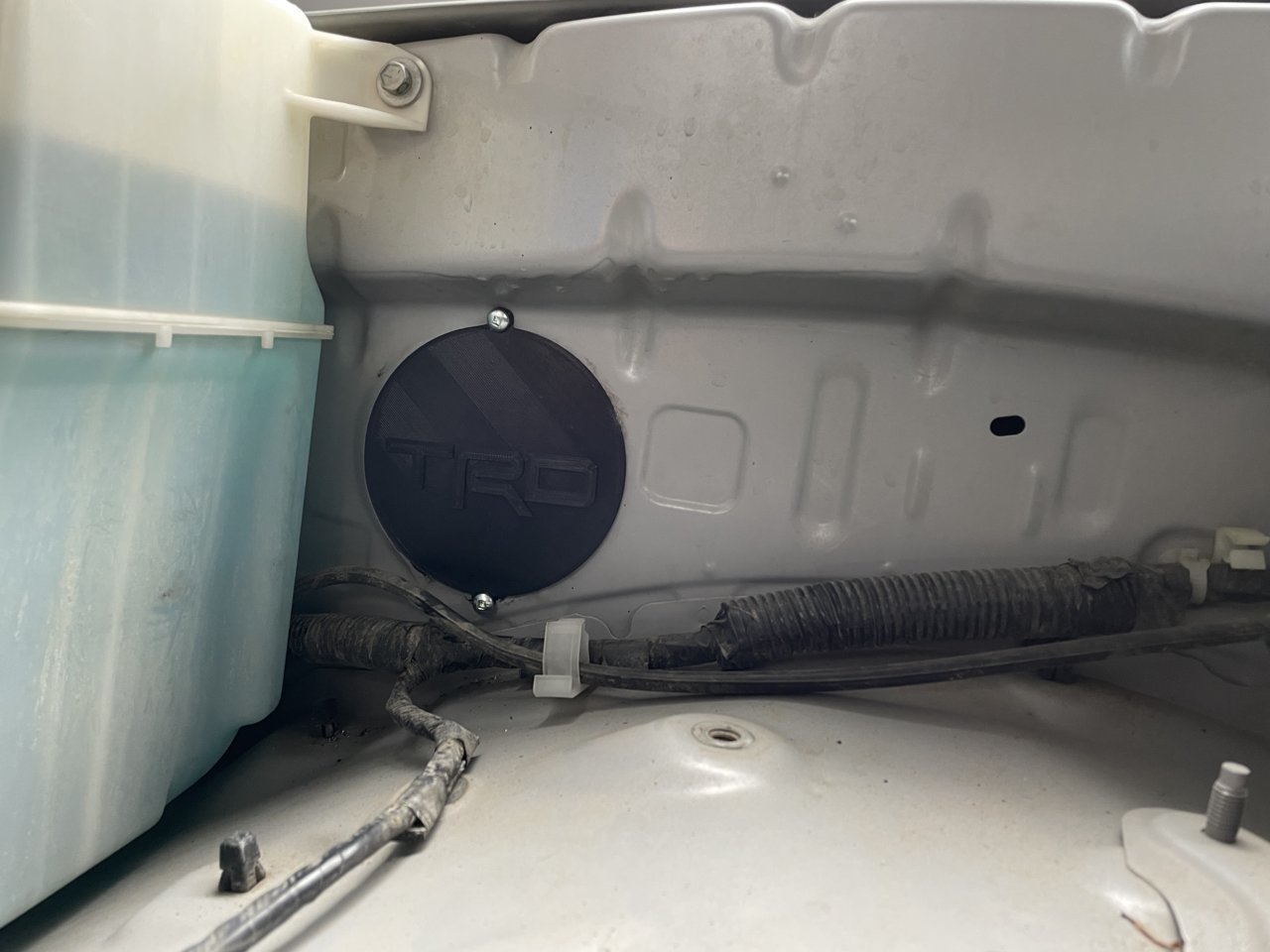

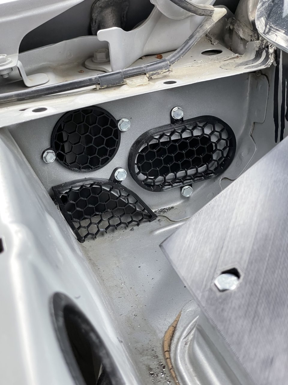

    I printed some parts for the Cowl Snorkel Intake!
    More details about it here! (or on my build thread)
    https://www.tacomaworld.com/threads/cowl-induction-snorkel.525314/page-14#post-27471806
    3D printed parts:
    • HVAC mesh cover
    • HVAC Solid cover with supports
    • 3" pipe mesh insert
    • Oval mesh cover
    • Triangle corner mesh cover
    • 2" hole mesh cover
    • TRD hole cover
    I am not sure if i want to post the 3D printed parts online as the design is far from perfect.

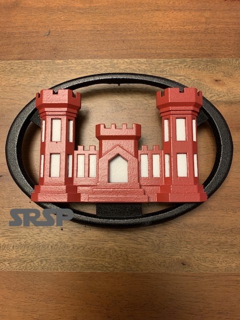

    Latest Grill emblem for an Army buddy, Army Engineers. Painted as requested to match Army colors. Fits 2.5 Gen.

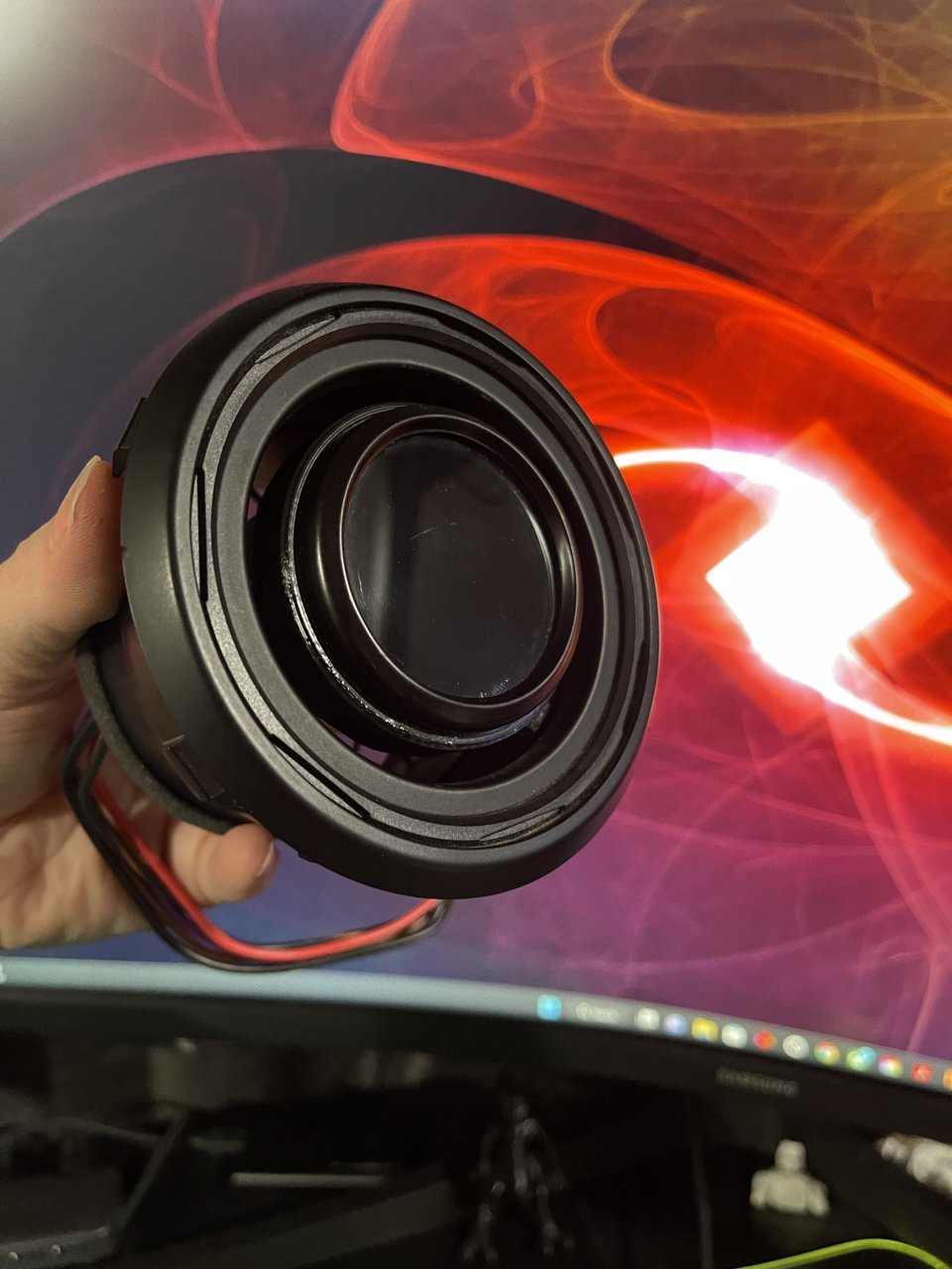

    2B1D4F9B-9F24-42D6-A01C-8E230CCC5444.jpg Recently did a 52mm boost gauge in vent mount for the left driver side vent

    What material did you use? I drafted a PLA option but it melted just sitting in the sun before I even mounted it. Should've expected that.

    Yeah, pla could do that. Sorry to hear it. It is a urethane printed part. My Decepticons grill emblem is the same material, also painted and holding up perfectly.
