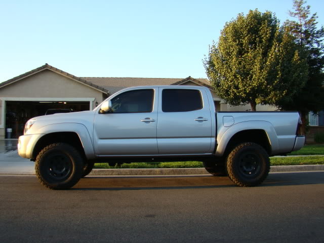

    I thought it would be informative to have a thread of heights everybody has gotten from their lifted components on their '05+ Tacoma's.
    If your stock post up your measurments too!
    Front Suspension: Bilstein 5100 shocks set to 0"/OME 885 Coils (3yrs old) & 1/4" Top Plate Spacer.
    Rear Suspension: 2" Alcan Add-a-Leaf/No TSB/No Block
    Tires: 265/75-16 BF Goodrich Mud Terrains T/A KM
    * Measurements taken from the center of the hub to the bottom of the fender
    Front:
    Right = 23" / Left = 23"
    Rear:
    Right = 25" / Left = 25"
    *Measurments taken from the ground to the bottom of fender thru axle line.
    Front:
    Right = 38" / Left = 38"
    Rear:
    Right = 39" / Left = 39"

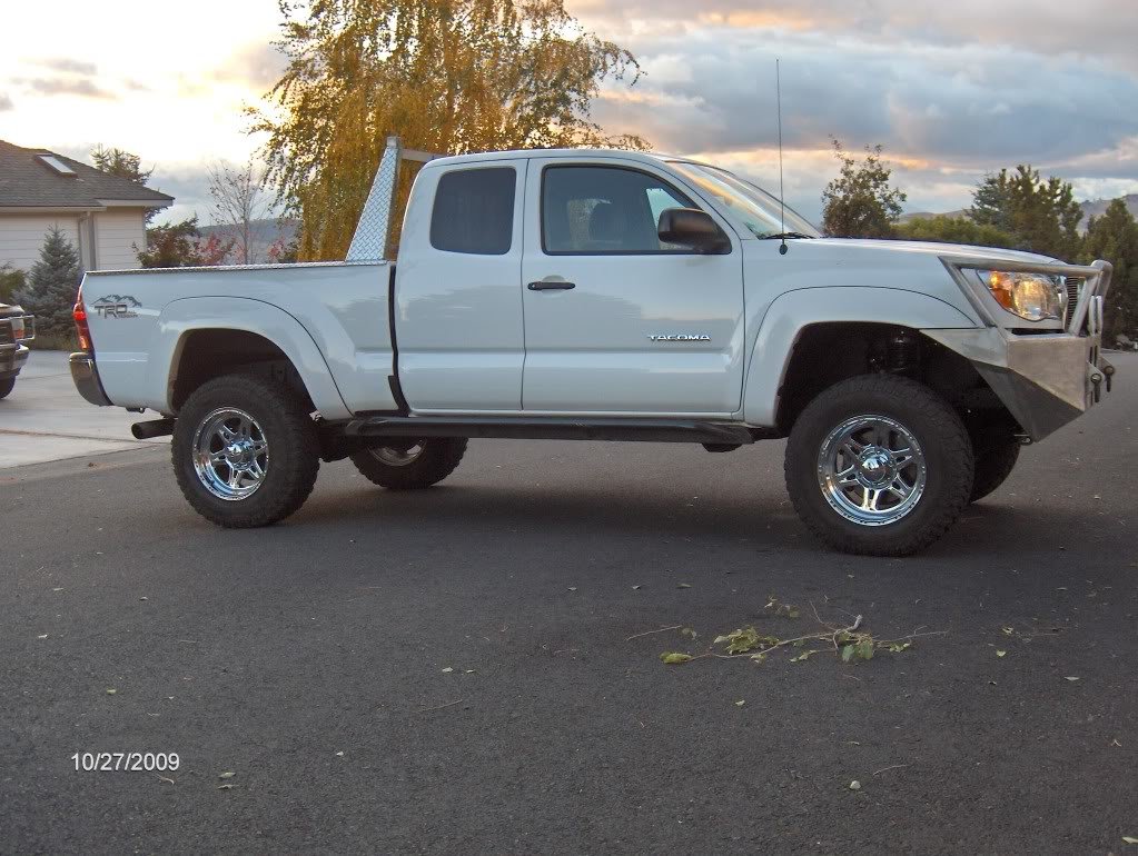

    I'm in.... I'll edit this post when I take the fender to hub measurements. :)
    right now I know that the front of my truck from fender to ground is at 39" w/ 255/75R17's at about 1/2 tread.
    Front suspension:
    OME shocks w/ 885 coils and a custom machined top plate spacer and Light Racing UCAs. Sits at about 3.25" lift.
    Rear suspension:
    TSB leaves w/ Alcan Tundra AAL(~1.75" lift) and a 1" block. Bilstein 5100s w/ Toytec extenders for more droop.
