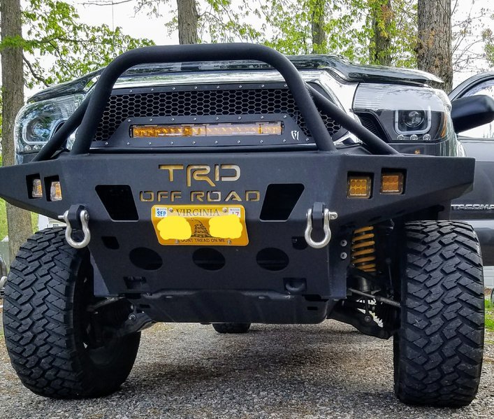

    Alright guys hopefully yall can put my mine at ease. Had the original Toytec ultimate lift with 600 springs. Due to age and have gone through a fire in my 2010 Tacoma. I just purchased the 650 springs and had them powder coated and 20170425_103306.jpg installed and now I'm sitting at 24 1/2 " in my front. I've heard and was told by Toytec to not go more than 23 1/2". Unfortunately I've already had it aligned. Should I drop it down an inch and get it realigned. Or can I run it like this with no major consequences.

    Your CV joints will eat themselves and you'll be buying axles regularly if you don't lower it.

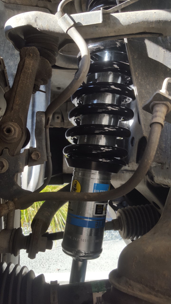

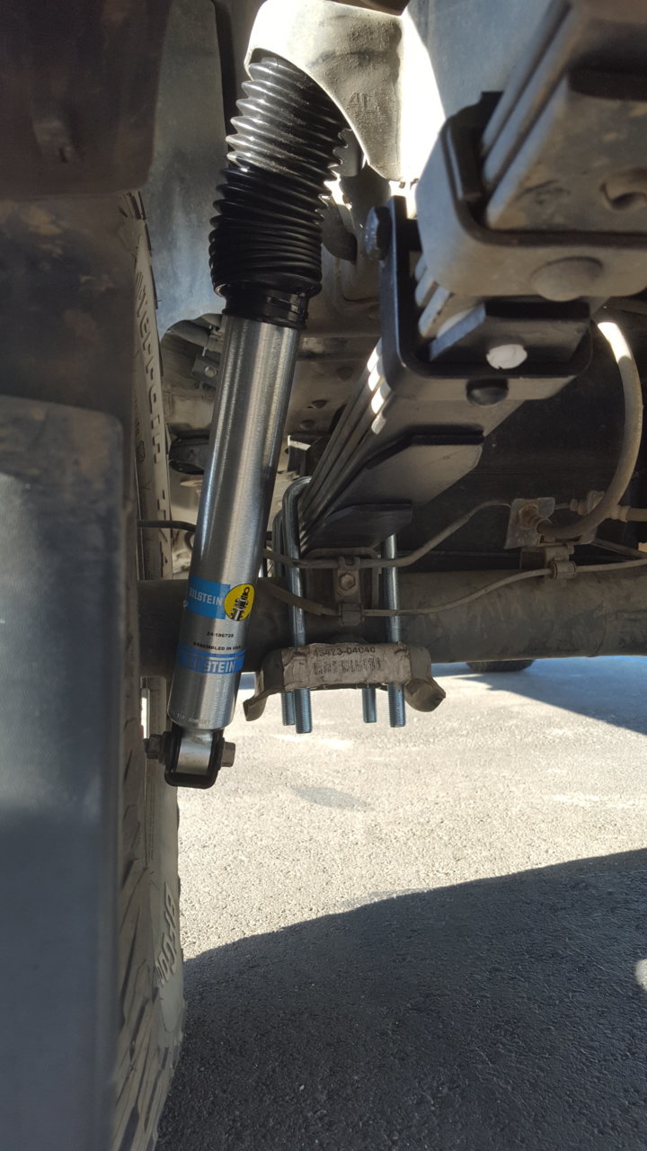

    2014 Magnetic Grey Tacoma TRD Sport
    265/70/17 BF Goodrich AT KO2 ARE Z Series Truck Cap
    Front Suspension: Bilstein 5100 shocks set to 0"/2' HeadStrong Springs/1" Spacer
    Rear Suspension: OME Dakar Heavy Duty Leaf Pack
    Tires: 285/70-17 Falken Wildpeak AT3
    * Measurements taken from the center of the hub to the bottom of the fender
    Front:
    Right = 22.5" / Left = 22.5"
    Rear:
    Right = 24.25" / Left = 24.5"

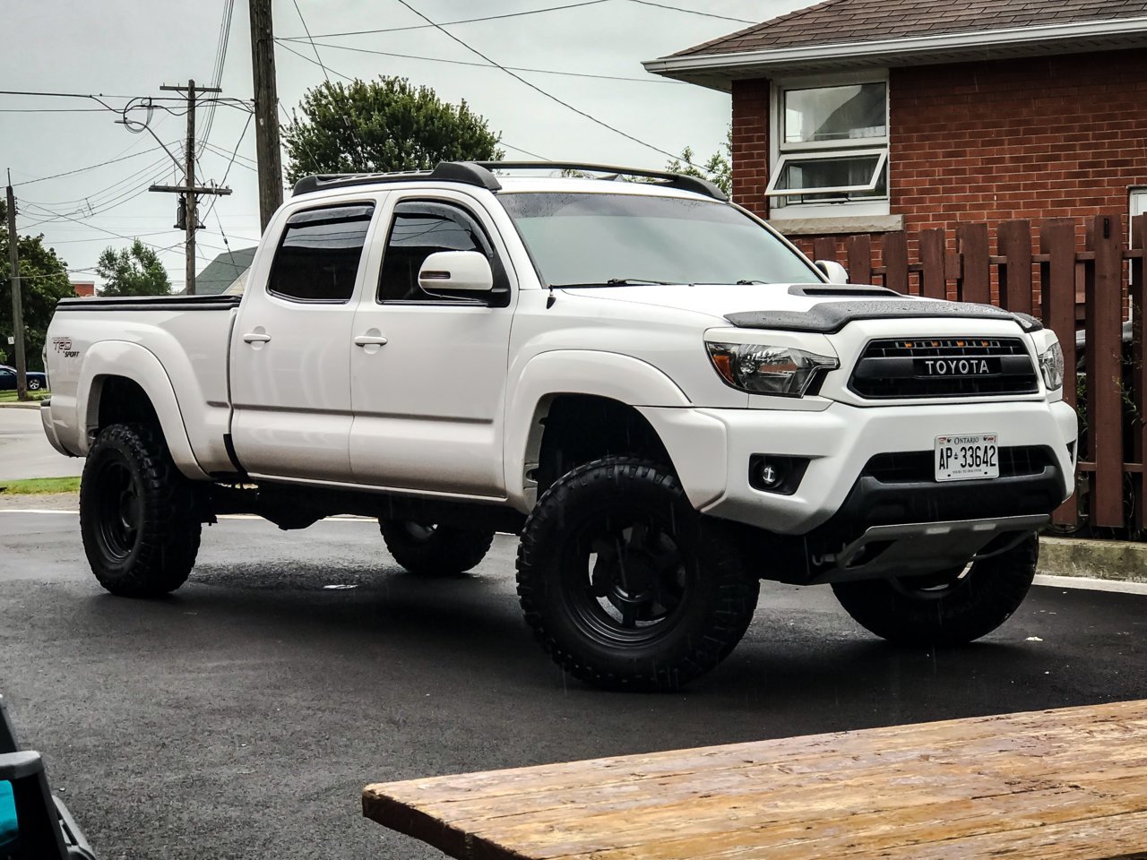

    ‘13 Super White S/C’d DCLB TRD SPORT
    Bilstein 5100 all around
    - Fronts set at 2.5” on stock springs
    - 1/4” spacer on driver side
    - Rear 1.5” AAL and 1” Block
    - SPC UCA
    - 285-70R17 Goodyear DURATRAC
    - 1” TOYTEC Body lift
    Ground up:
    Front Driver - 39”
    Front Passenger - 39.5”
    Rear Driver - 40.25”
    Rear Passenger - 40.75”
