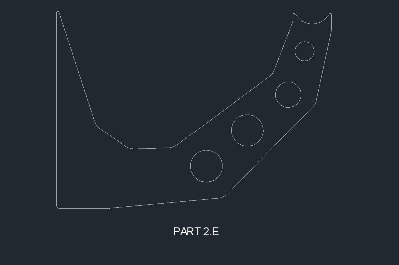

    Got a chance to do some CADD work tonight!
    Here is a picture of the uprights that go from the frame to the top tube. These will replace the tube that I used in the prototype, and will be made from 1/4" plate. There will be two, 2" apart with some more 1/4" plate in-between. Should look a lot like the pre-runner style bumper uprights. I think these will be very cool and the icing on the cake for sure. There is more to them, 6 parts that will be laser cut actually, this is just so you can get an idea of what they will look like. Enjoy!!!

    I'd be interested in a wrap-around. Is there anyway to use plate steel for the bar-to-bumper attachment piece (wait, I saw your CADD update, got it!) and to make the side supports stronger, perhaps out of plate steel as well?
    I'm looking for something that could take a 7-10mph impact from the front without crumpling/folding (like bullbars are known for doing), and a mild impact from the side, 2-5mph. I understand this isn't your original intention, body protection, but I think your current design is so close and your willingness to take suggestions is so encouraging, that I just had to ask. :)
    I also really like your doubled-up bar approach on the top/front. (un-finished prototype on front page, original post).
    How thick is the plate steel that you're going to use?

    MrsPib, I believe 100% we can work something out to your liking. With the new plate I have above there will be 4 peices of 1/4" plate going from the frame to the bumper, so I know that will be very strong. For the sides, I think it will already be strong, but I am sure we can come up with a slightly modified version for you. I can do the sides out of 1 1/2" tubing instead of 1". Might make it a little bulkier, but it will be much stronger... If you want to, PM me, and I will figure out how to make it suit your needs!! I have a few ideas we can discuse.

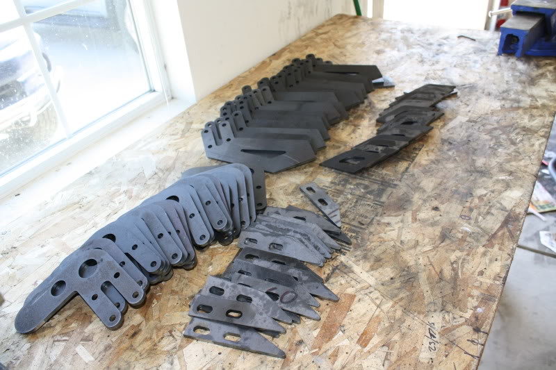

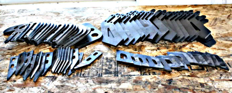

    Should be up tomorrow! Got the laser parts today, everything is top notch!!!

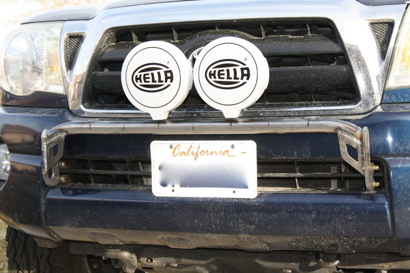

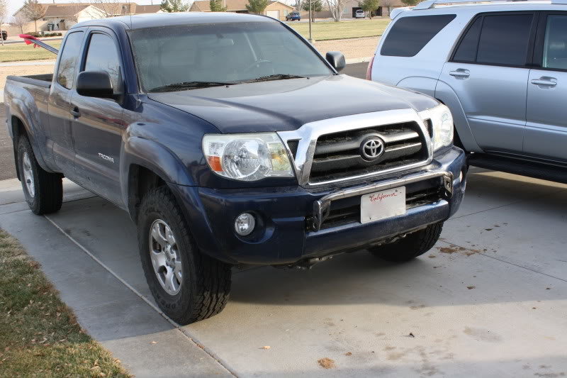

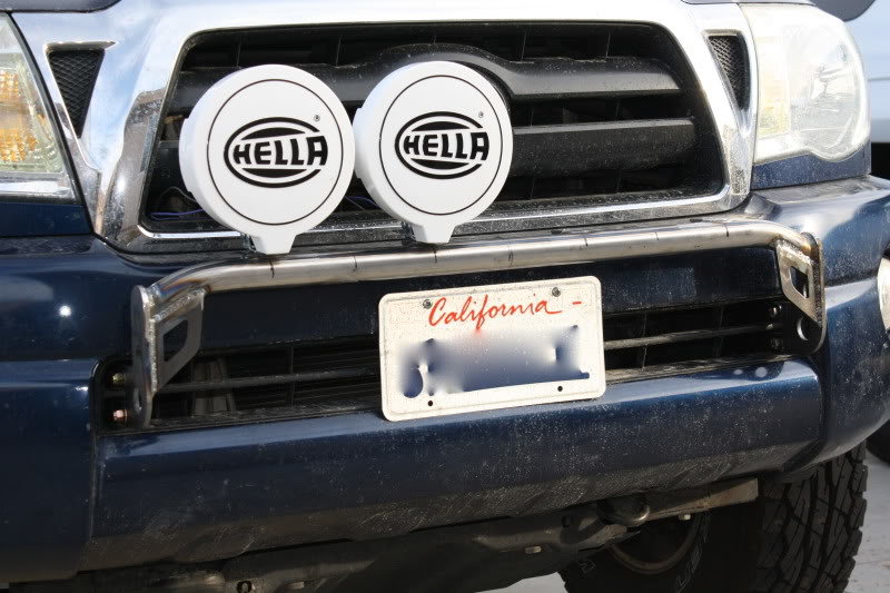

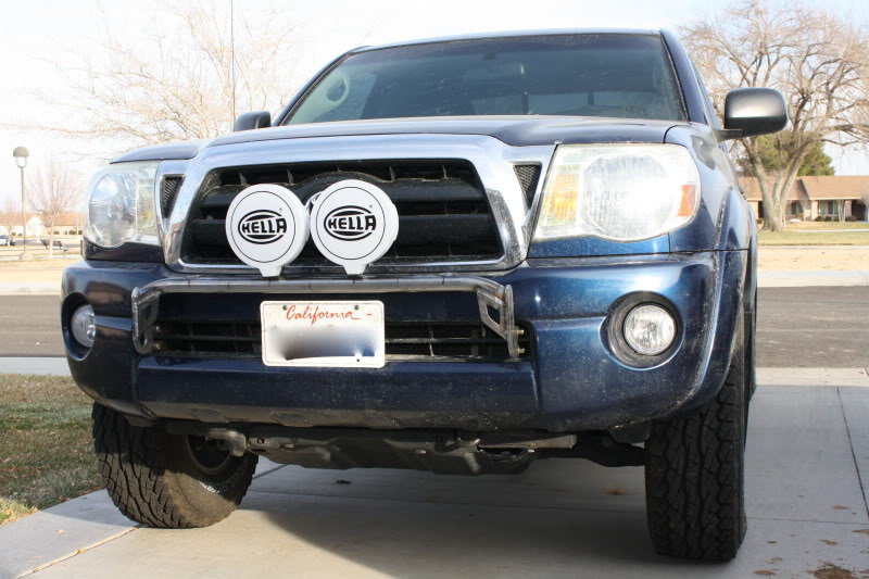

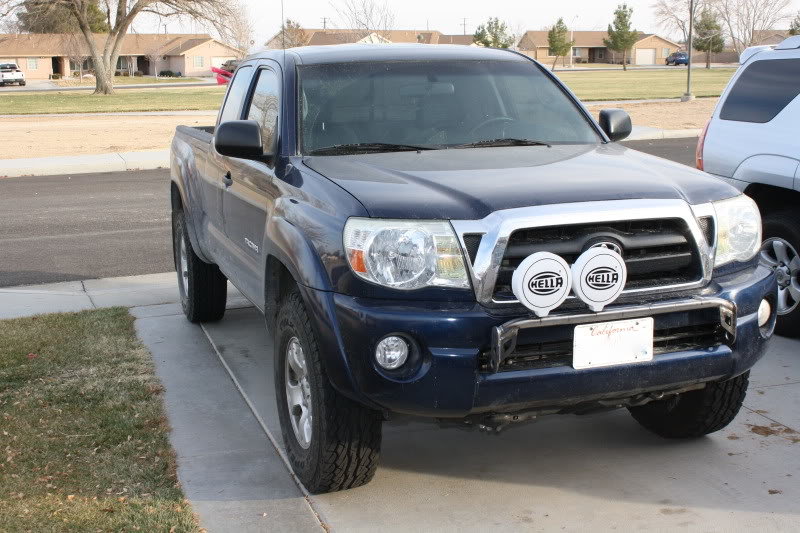

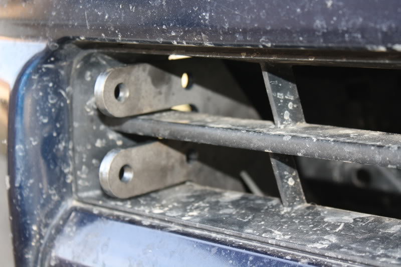

    The long awaited pictures of the standard style light bars!!!!!!
    Few different light configurations. I only have two so you will have to use your imagination...
