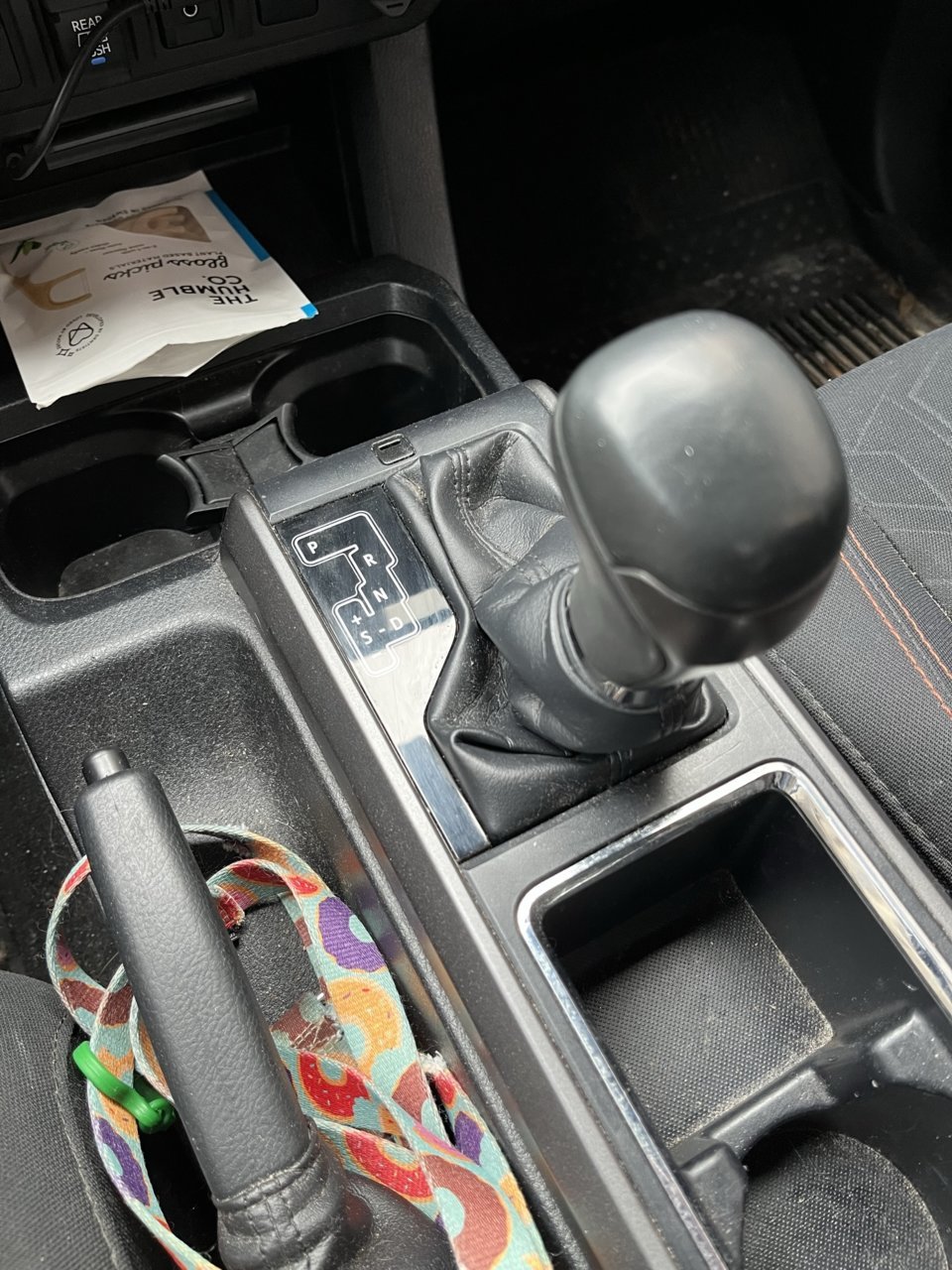

    Late last week my shifter started getting kind of sticky. Like I really had to drag it from park to drive. Today when I put it in drive the D light didn't come on. Wondering if this is something electrical or what?IMG_1263.jpg IMG_1262.jpg

    Try changing transmission fluids? Maybe dirty sensor? Loose wire?

    Something Electrical is wrong...any codes?

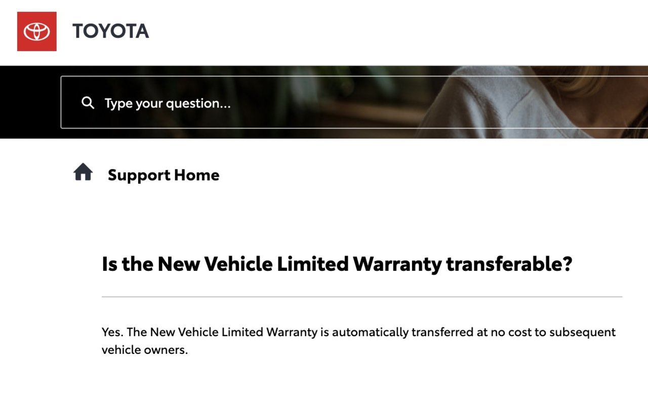

    Josh
    2019 White Tacoma TRD Sport
    second owner unfortunately. factory 60k miles powertrain warranty still apply or no?
  6. Jan 30, 2023 at 12:02 PM
    GilbertOz
    GilbertOz Driver
    Oct 18, 2018
    #269844
    1,138
    CA
    2014 AC 4L 6spd 4WD TRD OR
  7. Jan 30, 2023 at 12:03 PM
    cryptolime
    cryptolime Here to Help
    Dec 2, 2021
    #383651
    2,468
    Wilmington, NC
    2021 SR 4x4 2.7L
    it should. unless it's a salvage title or something.

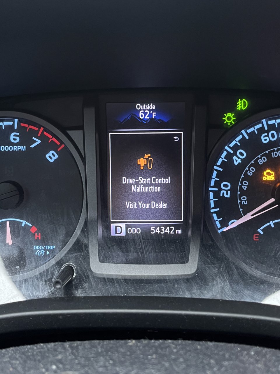

    Just got home and scanned. P0705.
    This came on on the drive home too lol. 8978858A-8921-4B9C-BAB3-03E147F345DD.jpg

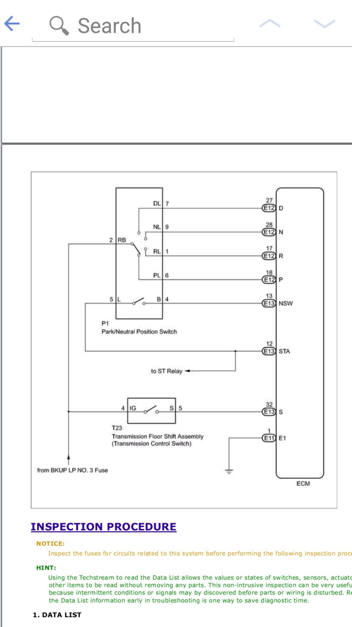

  11. Jan 31, 2023 at 12:13 PM
    jbronnier
    jbronnier [OP] Active Member
    Jan 9, 2020
    #315550
    44
    Josh
  12. Jan 31, 2023 at 12:54 PM
    splitbolt
    splitbolt Voodoo Witch Doctor
    Mar 7, 2010
    #32761
    7,874
    NW Arkansas
    2016 TRD OFFROAD DCSB MGM
    It can be anything in the diagram...
    You need a Toyota specific scanner or Techstream to get a refined code.
    P0705 is a generic code.Toyota specific will be P0705xx and help narrow it down somewhat.

  13. Jan 31, 2023 at 1:06 PM
    jbronnier
    Jan 9, 2020
    #315550
    44
    Josh
    10-4 yeah I've just got a standard OBD II, will snag one of those
