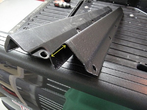

    As we all know, the tailgate cap on the 2nd gen Tacoma is weak at best.
    Almost all of the clips on mine have broken off in the year and a half that I've owned my truck, just from putting bikes and ladders on it.
    Aside from the broken clips, it just doesn't feel "sturdy" when you put your hands on it to close the gate.
    So this is my solution:
    It is a 1/8" thick aluminum powder coated tailgate cap SYSTEM.
    What makes it a system??
    It utilizes 1/4" thick gasket material that serves two purposes:
    1. It creates a gap between the cap and the tailgate, eliminating any metal to metal contact.
    2. It raises the height of the new cap to match the height of the stock cap.
    Here is the tape

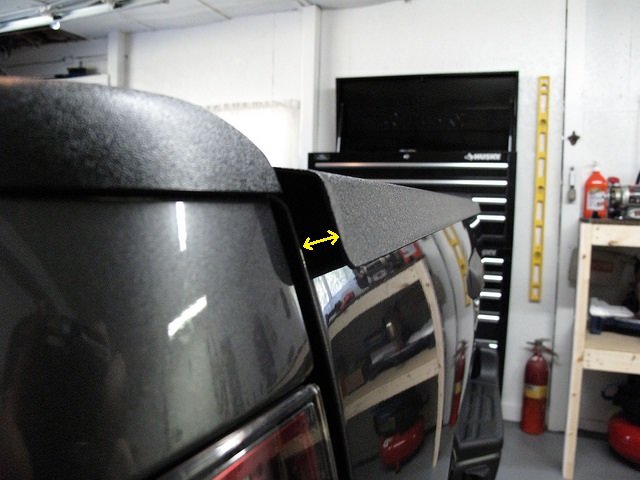

    Here is the gap
    The end result is a tailgate cap that is incredible sturdy, offers better protection of the tailgate from the outside of the bed, and has a finish that closely matches that of the stock cap.
    Price is $98 plus shipping. Includes torx bit and gasket material, pre-cut to size. System uses factory bolts

    This is a great idea and looks like a quality product. Props!
    Just a little constructive criticism here... I'm sorta anal about how things line up and sit together and it kinda bothers me that the new cap doesn't sit tight against the face of the tail gate sheet metal. It looks like it's just floating in front of it. Maybe there is a way to do a thinner gasket type, like a strip of rubber so it will fit more snug against the tail gate face? Just thought I'd share as a consumer who uses a Snugtop cap (it may also effect how the cap closes).

    I don't like the gap at all. Looks like a quality product, but that gap would be a deal-breaker, for me.

    I like the "up" but not the "out" :)

    Looks pretty good. Is there a way you can make it more flush with the tailgate?

    I agree,....don't like the "out" gap. Otherwise I think it's a great idea/product.

    This is correct. The tailgate is curved, so a gap of some degree is necessary.
    The gap could be reduced by tweaking the design and using thinner gasket on the back of the tailgate, but I actually like the gap. It gives your thumbs something solid to grip when shutting the gate, and even with the gap, it looks beyond fantastic in person.
    It also allows the use of a bungee at the back of the cap.

    So you CAN'T close this gap up at all ?
    I'm with the rest of the guys who say this gap is the deal-breaker...
    I'd want it 1/16" - 1/8" away from the exterior of the tailgate, almost flush.
    Awesome work though !

    Yeah I agree with most of these guys too. That large of a gap would bug me everytime I look at the truck.

    I could easily redesign it and make the gap smaller, but having one on my truck in it's current configuration makes me really like it the way it is.
    It feels "right" in your hands when you close the gate.
    After the first batch is in the hands of the public, feedback from the people who buy it will dictate which direction the gap will go.
    RearViewMirror is getting the first one off the production line. We'll see what his opinion is as well.
    It's one of those things that you have to see in person to appreciate.

    I can also make two versions: One small gap, one big gap.
    That being said, everyone will get the version that they want.
