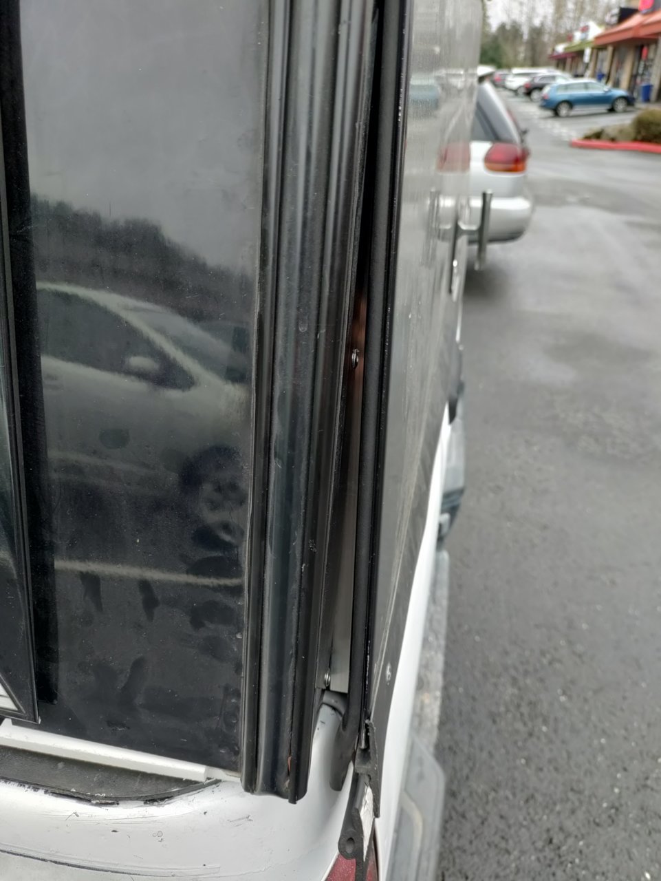

    Completely unhappy with product. With this large gap it's impossible to properly close ARE DCU Utility Canopy.

    I texted and called multiple times to try resolve my problem how it's fit. No respond how I can fix issues. By your return policy you not accepted used item. Before placed order I mentioned that I order this set to make waterproof seal for canopy. But there's was zero advice that it's maybe don't work with canopy. After installation it's don't provide proper fit for canopy. Multiple people in topic asked to eliminate gap. How understand this topic not only about how accurate description of product as well how it's good or bad in use. And because you don't provide any help me in private message I decided to give advice to other people in case they want order this. That it might be not working in all applications.

    Continue to my previous post. If you install complete bed rails covers and tailgate cap. You need mount your tailgate cap al lower as possible for possibility properly close canopy. I removed both gasket from Tailgate Cap, unscrew 2 bolts from top of tailgate, drilled 2 holes for them and mounted cap with out any gap between tailgate and cap. I asked KB Voodoo about possibility to make tailgate cover with out gap, but they unfortunately don't wanted.
