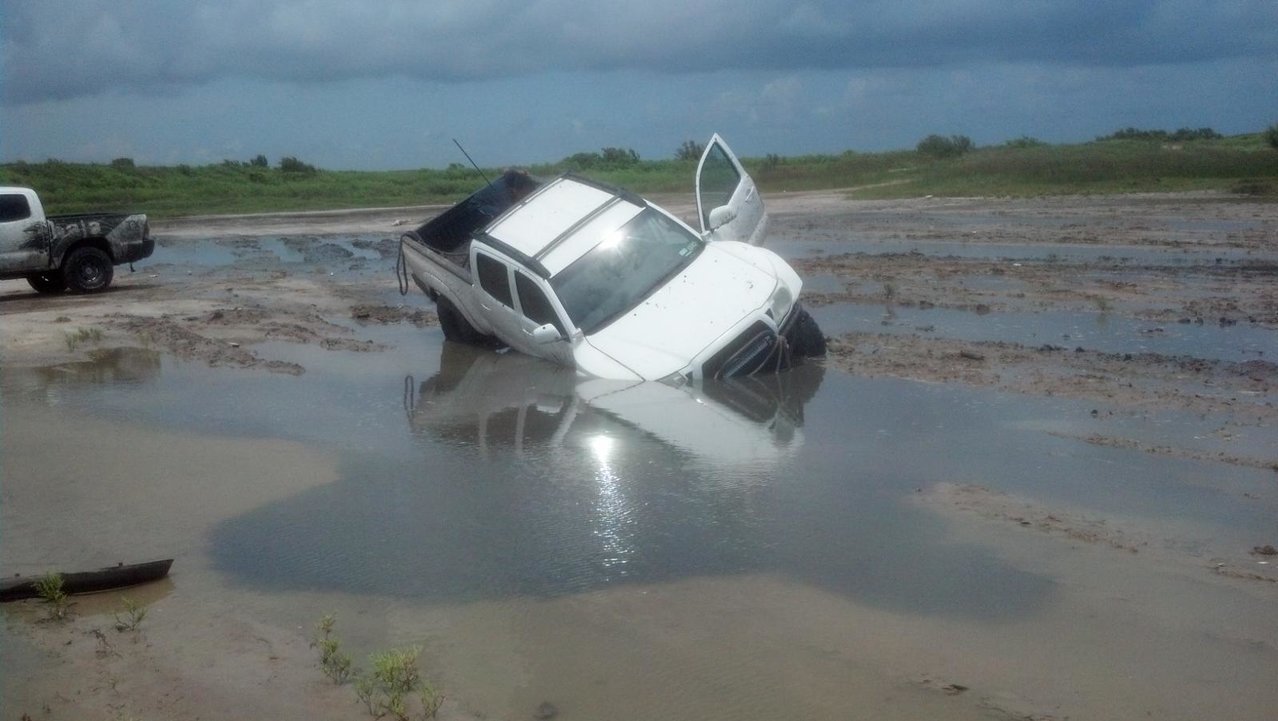

    Sunk mine that deep on the passenger side. I was lucky, only things I f'ed up were my air bag sensor and passenger seat occupancy sensor. Mine stayed running the whole time I was in the water. Got pulled right out, like 5 min in the water is all. No running problems, but my truck never stalled out in the water.

    I did, but after looking at the assemby, it is clear that water was not nearly high enough to interfere with the throttle position sensor. I also watch the Tps on my OBD adapter and it shows good functionality.

    water got into my interior, just on the front passenger side. Up past the door speakers. Which means up under the dash. Truck started back up, drove home. And it didn't want to start the next morning. Water shorted something and drained the battery. I also unplugged every sensor on the passenger side and sprayed ut with corrosive spray to get the water out. But still had a short, that drained the battery. Truck drove fine, but I had to disconnect the battery everytime it was going to be parked more than 6 hours. Any was 3 weeks of driving and not being able to pin point the issue. The truck finally caught fire cause of the short. Now it's in the dealer getting fixed.
