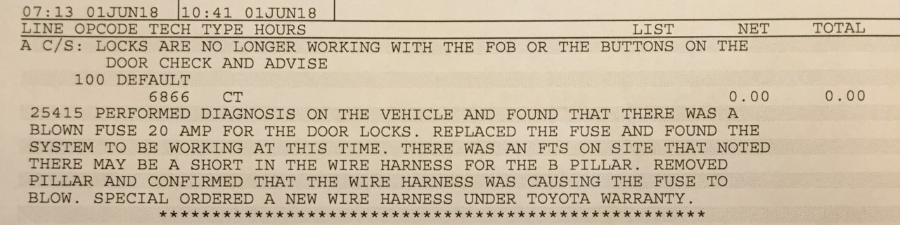

    Got it back from dealer yesterday. Blown 20 amp door lock fuse caused by short in wire harness for B pillar. Warranty covered it and they added foam to both harness per Toyota.

    Here’s all the detail the dealership gave me:
    DDA1EF6A-4594-4B5D-A6B8-C64985D7415E.jpg 17B7599B-C05E-4D2E-9C04-F497B2BE8F36.jpg

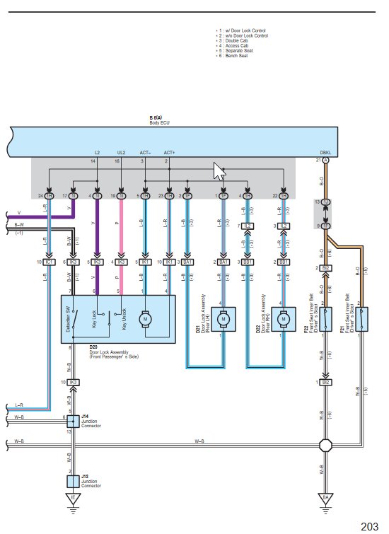

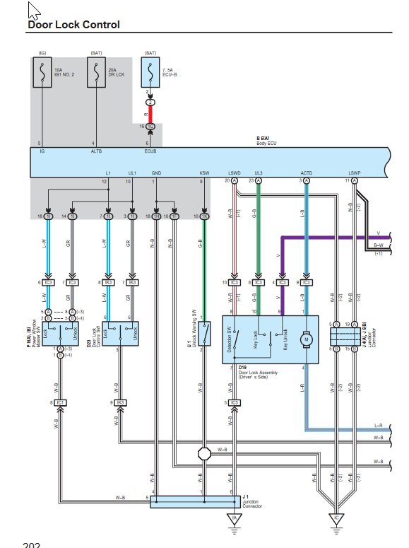

    As you can see from the schematic the power to operate the doors comes from the Body ECU which is in the fuse panel behind the dash on the left side of the steering wheel.
    Three fuses feed the Body ECU:
    IG1 No2 Fuse - 10 Amp
    Dr Lck Fuse - 20 Amp
    ECU-B Fuse - 7.5 Amp
    There is not a fuse for each door, there is not a fuse for up and one for down. The problem could be a lot of things. The actuator motor is a known common weak point. If some doors work and some doors do not then the actuators could be the issue.
    If you had no problems then did some wiring during the Pop and Lock installation chances are Very Good that something was wired incorrectly. That is what I would bet and would start my troubleshooting there, as your statement above said:
    These prints may help you sort it out. I wish you the best of luck. If you don't have a Digital MultiMeter (DMM) or know how to use one, now would be a good time to get one and learn. It is an invaluable tool.
