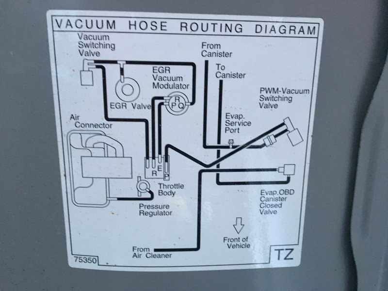

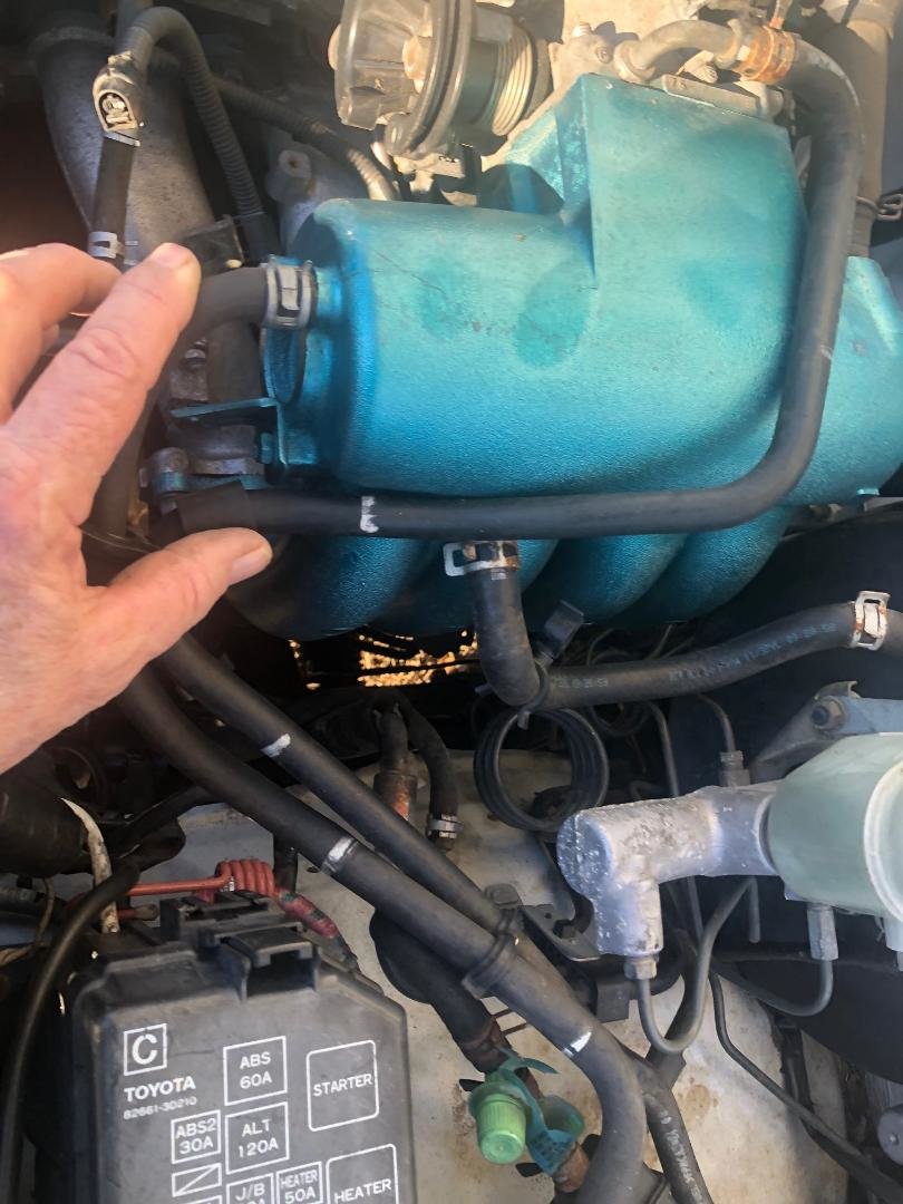

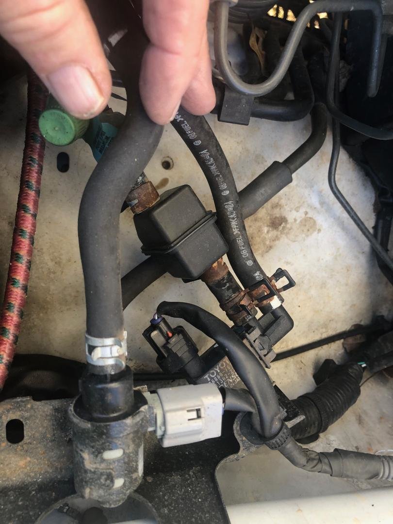

    Here is a couple of pictures of how the Idle air control valve vacuum is routed. Can one of you'll look at this to see if it looks right? It goes back to a box mounted on the left inside fender well. What is that box and what does it do? Could it be bad? Check the 2nd pic, to see this box.
    It is running a bit better now. After sitting up for a year and a half, it is good to run some fresh gas through it. The old gas is, well, old gas.
    At some point I may try swapping the Idle air control valve, or even the entire intake off of the donor truck. It is a luxury to have duplicate spares I can swap to isolate bad component. But I would rather fix it with the "original to that truck" parts.

    Your second photo there is the evap canister closed valve, gray connector. It should be routed to the air cleaner. The other valve is the evap purge valve, which should go to manifold vacuum
