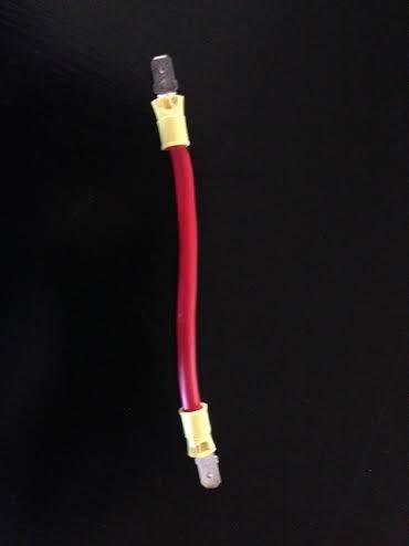

    Could you walk us through the step of making the jumper? I'm curious about the insulation (? I assume that's what the blue stuff is).

    It's just 2 crimped male spade connectors on either side of a piece of wire.

    Where can I get a jumper?

    Wait, I get it now, nvm

    its easier if you make the wire about 1 1/2" long so it has room to bend and then after its plugged in you just push the sticking up loop of wire over to one side to fold it over so its not sticking up and the lid closes on the fuse box.
    when plugging in the brand new connectors it will sometimes be very snug the first time when using new connectors so use a needle nose pliers to grip them to push them on.
    also if you are using female connectors, its best to plug them onto something like the power relay you removed and after plugging it in once or twice it loosens to form the right fit for the terminals, new female connectors are always a very tight fit. if you are using male connectors then this step is not needed.

    Just did this on mine, easy 5 minute job. Thanks!

    Got it sorted. I showed my brother a picture and he says "I have all that stuff in the garage" (He restores antique tractors as a hobby, go figure). Works great!
