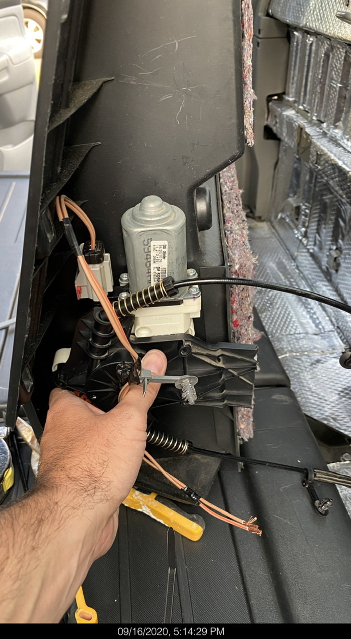

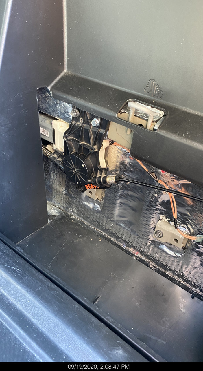

    Has any tried to mount the motor on the plastic bins? It will fit in there just concerned about binding the cables 32CC1F84-2BDB-4FA8-B2FC-813D1994C1C7.jpg

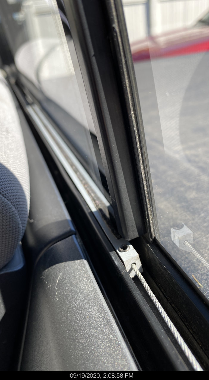

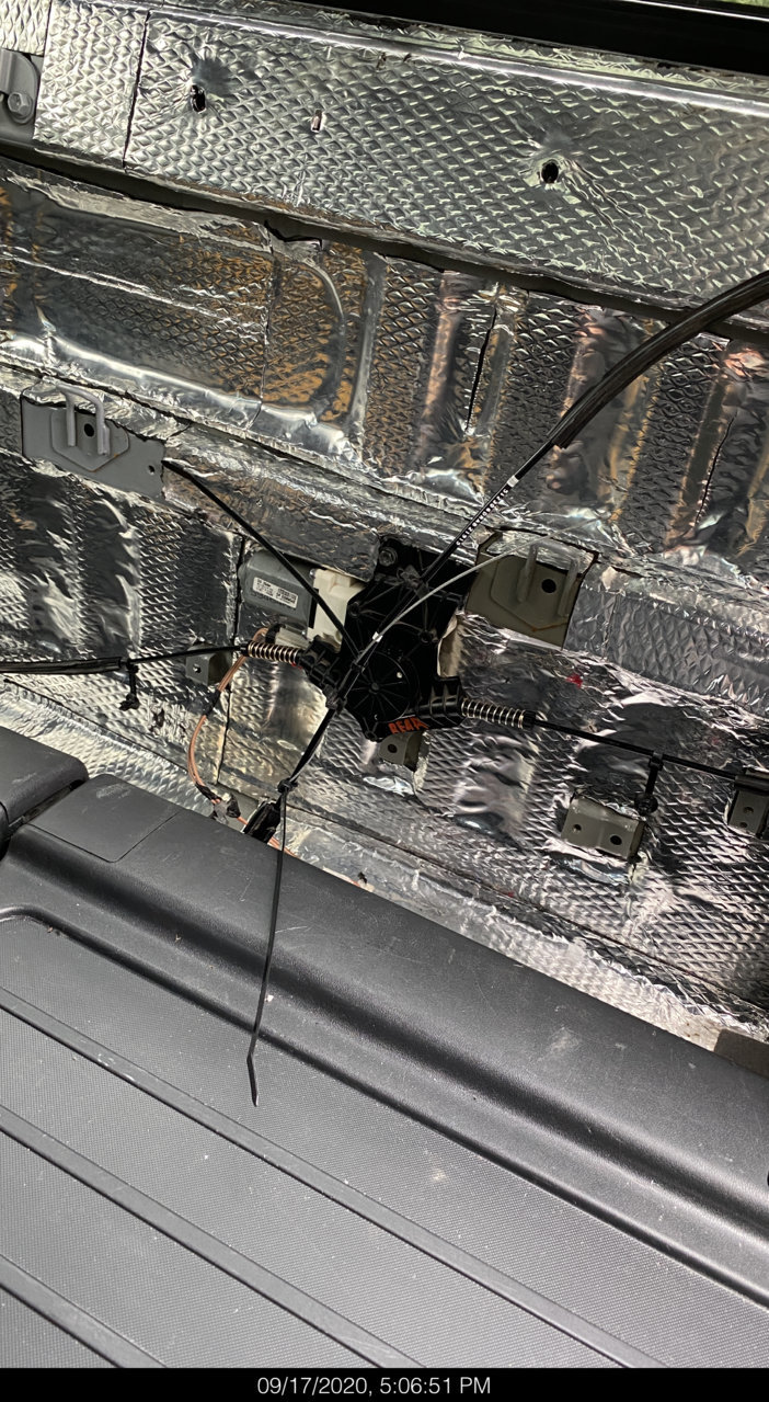

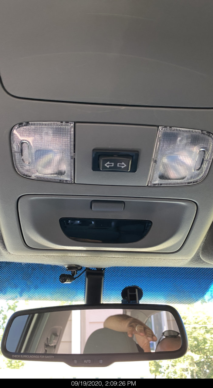

    All installed and it’s working great .I added some felt to the window bracket to take up some of the play and to prevent scratching up the window. I put the switch up in over head console I think it looks stock there. Thanks again kgarrett11

    I like this one by tacoma2ndgen. can you school me on how the window glass is attached to the kgarrett bracket, and how the bracket fits in the window track?

    It doesn’t attach. The bracket fits in the channel alongside the window with very little extra space and the thicker ends provide the purchase to pull the glass each way. There’s an inline hole at each end for the cable and an Allen head set screw to fix the cable ends.
