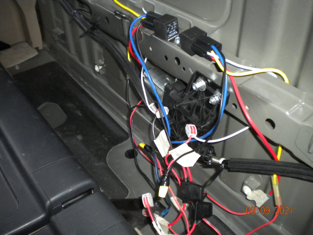

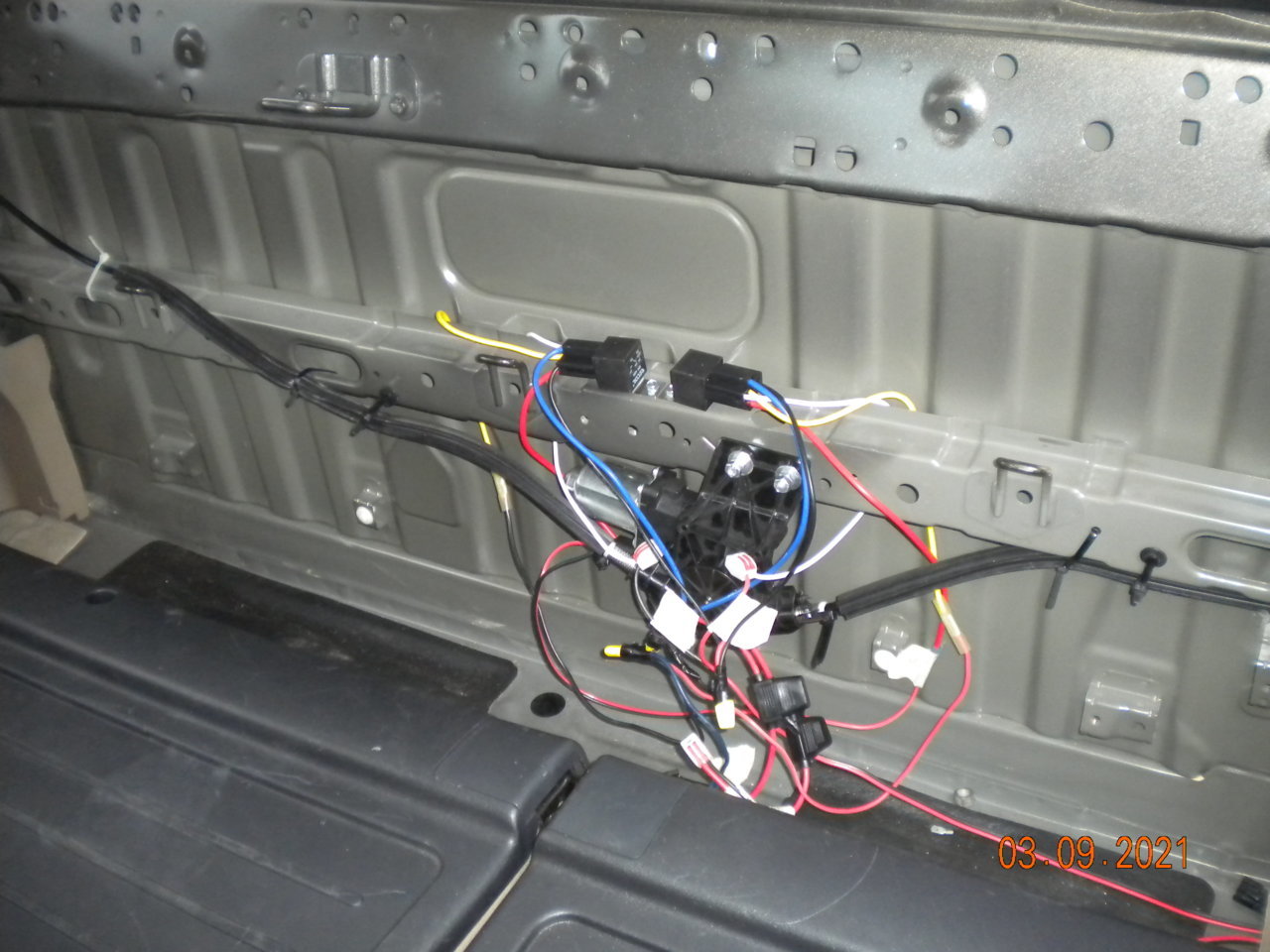

    Looks good!, Pretty smart to add the relays. Were you able to get the plastic covers back on flush without modification? Looks like it should have fit fine where you put it. My impala regulator is still working well (without relays) and this is still one of the best things I've done to my truck. I'd be curious about what relays you used and how you wired, If I ever have to get back in there.

    You’ll need 2 x 5-pin relays.

    Impala motor was 2000-2004 2005 Chevrolet Impala. At the time it cost around 30 bucks.
    Here's the video I put together on the subject: https://www.youtube.com/watch?v=ntx5cshnbrY&t=132s
    It was a bit of a challenging job at the time, but it's probably one of my most favorite modifications. Adding the relays is probably a great idea, but I haven't been blowing fuses and this has been going strong for over two years. I use it almost every day.

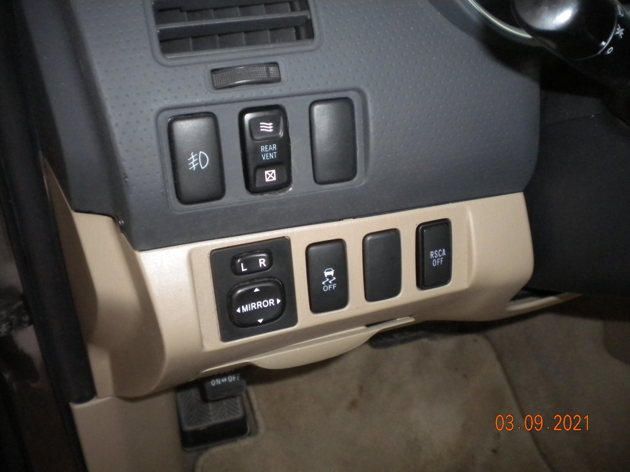

    Wooow that's innovative improvement.... definitely I like the seinna switch you use... what kind switch is that for in seinna ?
    I wish the bracket still available.
    Thank you so much man for the video... it's inspire me to do that.
