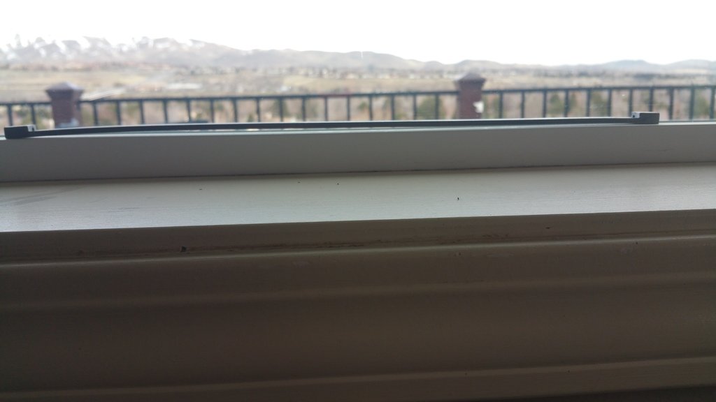

    This is what I am talking about, Kind of hard to get a good pictures but that is it on a window sill, you can clearly see that it is pretty dang warped. Doesn't look right to me.

    Might have happened in transit? I noticed after I painted mine the other day it has a slight bend in the middle, not 100% straight, but not nearly as bent as what you got. Mine still fits nicely when I test fit.
    I primed then shot with black enamel rattle can.

    I dont know it just seems like it would be hard for it to bend like this in transit although it is a possibility, it just seems more like it happened in the machining process, hopefully O.P. will chime in.

    Idk what yours got shipped in but I'd imagine it was the same large padded envelope, which if the perfect scenario lined up where say it was sticking out maybe wedged between some packages and a heavy one came down on it, I could see there being enough leverage to bend it. I mean it's not "that" thick of a piece.

    There were a few in the manufacturing process that were warped and discarded. That one doesn't look to bad. I don't think it should cause any issues but u can try finessing it back in line. These are so thin that it doesn't take much to bend em which is nice if u want to straighten it a little. If it doesn't work out we can always send you another so no worries my man

    Mine had a slight bend as well. I just gently persuaded it back to being straight.
