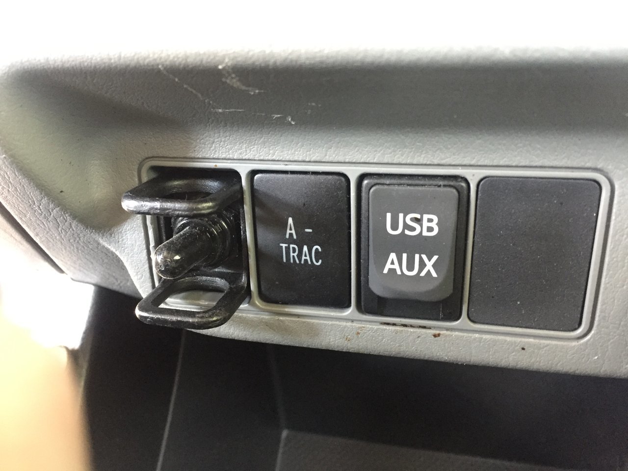

    I finally "finished" up mounting my switch in its final resting place. Since my rear slider is run off a relay system I actually have a relayed toggle switch for shits and giggles. I found some replica NASA type toggle guards and it just so happens they fit pretty damn well in the small switch blank slot under the HVAC knobs. So that's where my switch is. Switching right moves window right/open and left closes the window.
    I wasn't a fan of how the sienna and 3rd gen mini rear window switch looks. I wanted the unique one from a 2008 Tundra but the switch alone costs $200+ brand new and is still like $150 off eBay IF you can find one, and then I'd have to have the wiring diagram so I was like fuck it I'll go toggle switch.
