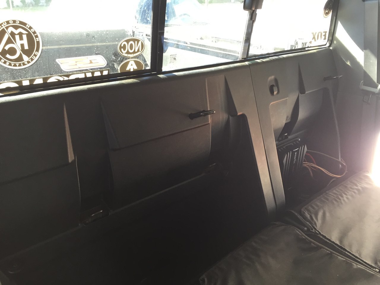

    Side note, I know @adio brought this up in another thread. If you want to retain the rear storage bins but your motor/cable setup isn’t allowing it to fit like stock, the 2016+ humped bins fit perfectly. They are made to house the 3rd gen rear slider setup.
    A few clips are added/subtracted but it fits perfectly and bolts up like 2nd gen box.
    So now my rear seat area is buttoned up and looks factory.
    Ignore my rats nest of an amp setup.
