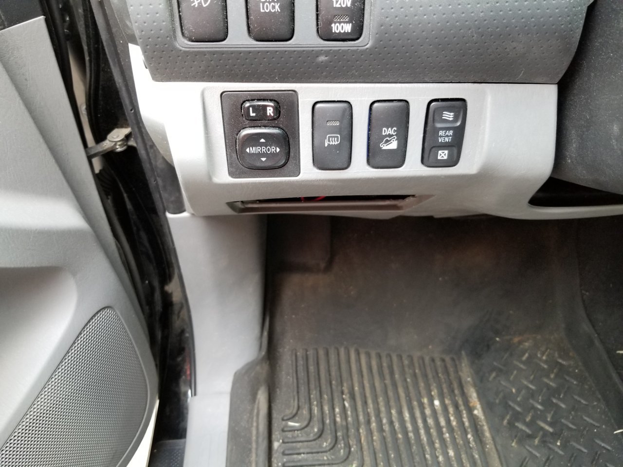

    JBL/Entune Touchscreen Navigation with speed sensor override mod, JBL Speaker refit, debadged, chime removed, overhead led mod, switch LED mod, rear cupholder LED mod, ImMrYo Rear-View Mirror Lift Bracket #339, Custom Cobra CB install, Iggy Switch panel, OEM Katzkin leather seats, Seat heaters, Illuminated 4runner 4WD switch, 4runner side mirrors (heated, turnsignals, puddle lamps), husky x-act fit floor mats, climate control knob upgrade, air injection pump filter mod, underhood LED light mod, KB Voodoo bike bar

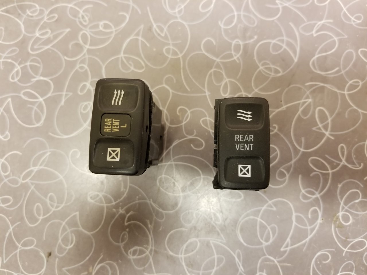

    I tried the sienna switch BUT it does not go into the switch panel like other oem switches... My solution was to get a left vent switch from a land cruiser and combine the two... Looks great and works 100%

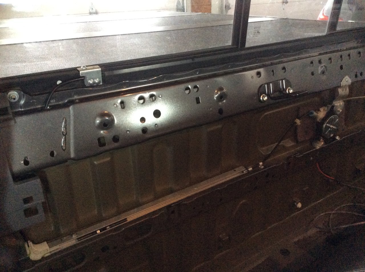

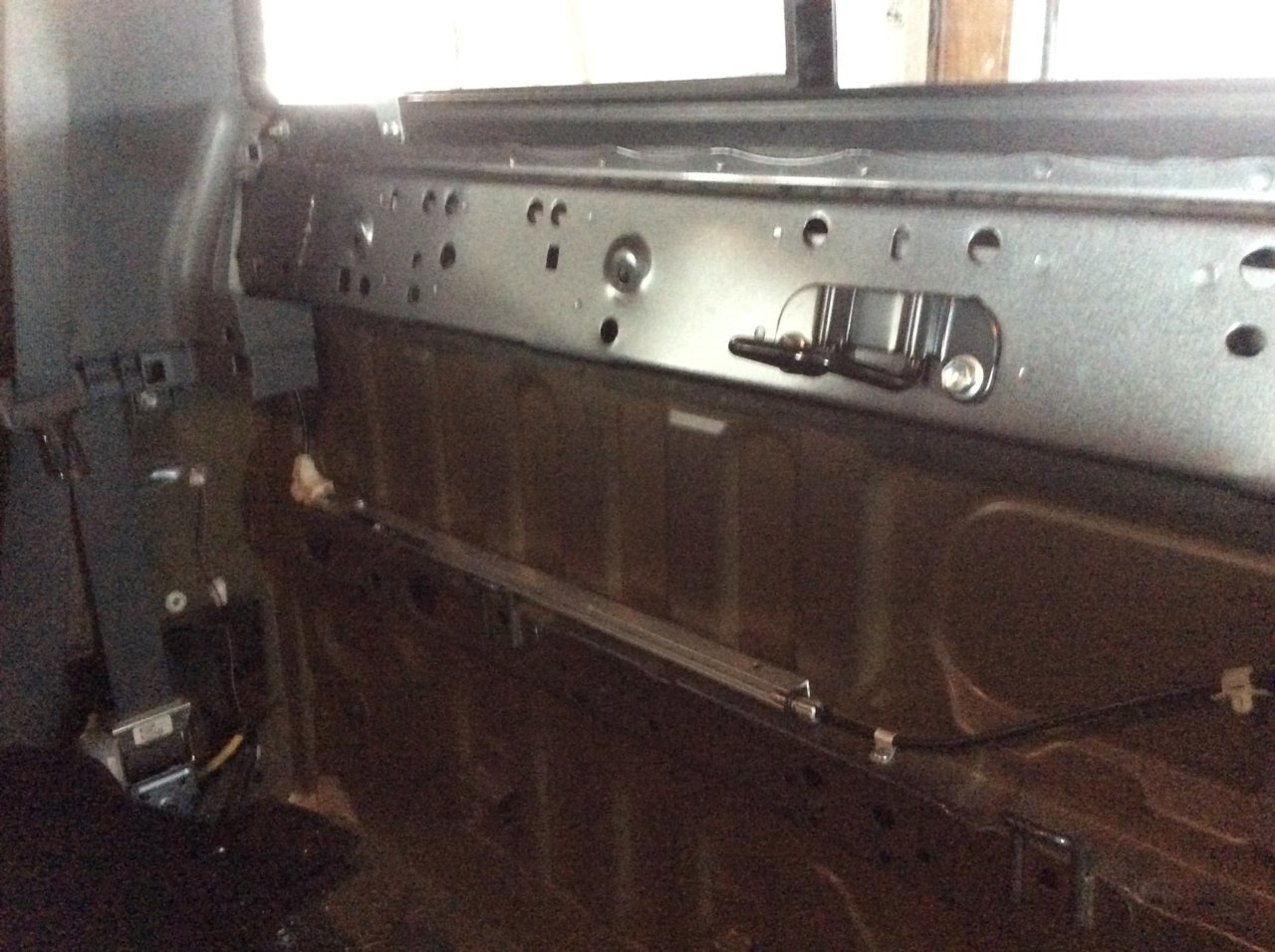

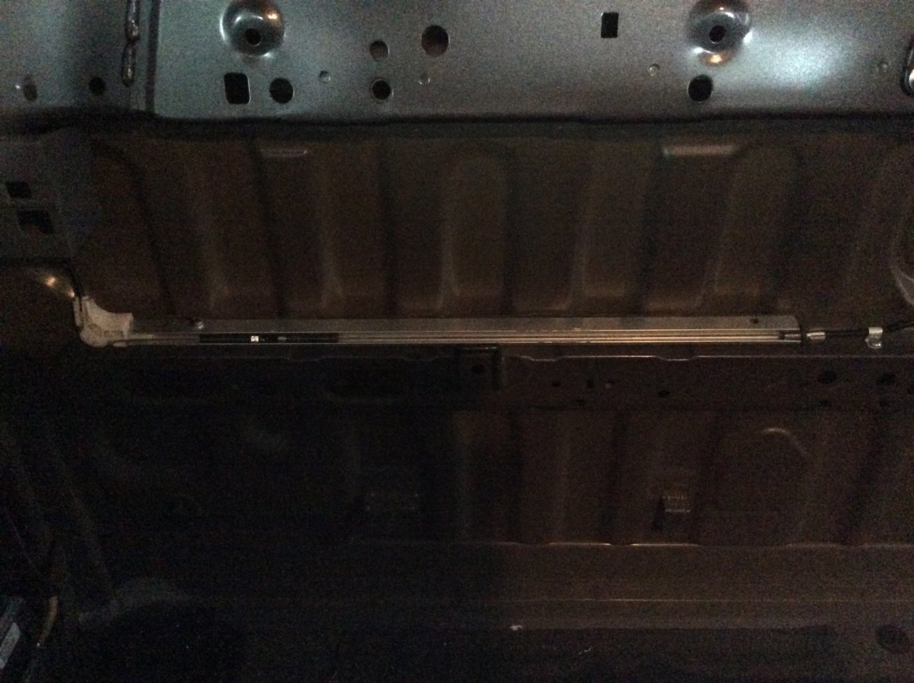

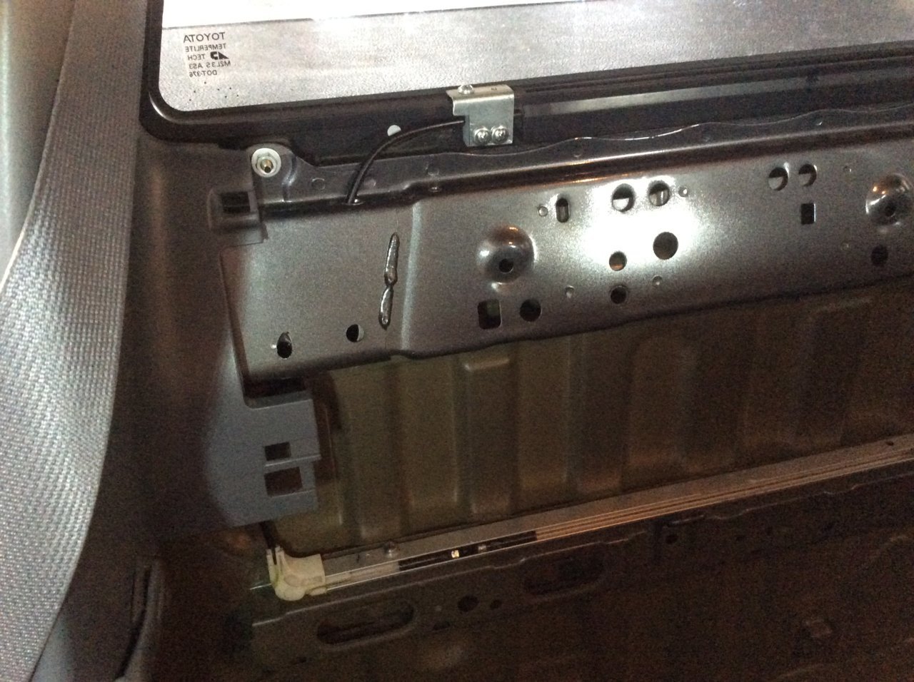

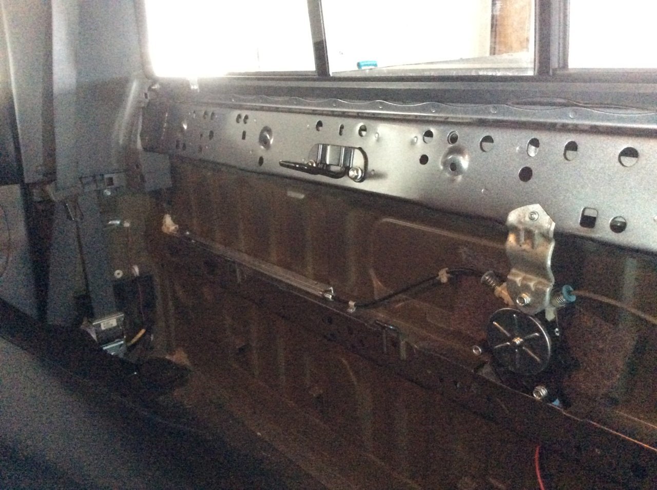

    If anyone would like some pointers/details of how I did this using the ridgeline track I will be happy to do so
  10. Dec 10, 2018 at 4:17 PM
    #150
    Poitrasbh
    Poitrasbh Well-Known Member
    Oct 7, 2018
    #268628
    77
    2015 Charcoal grey Tacoma TRD

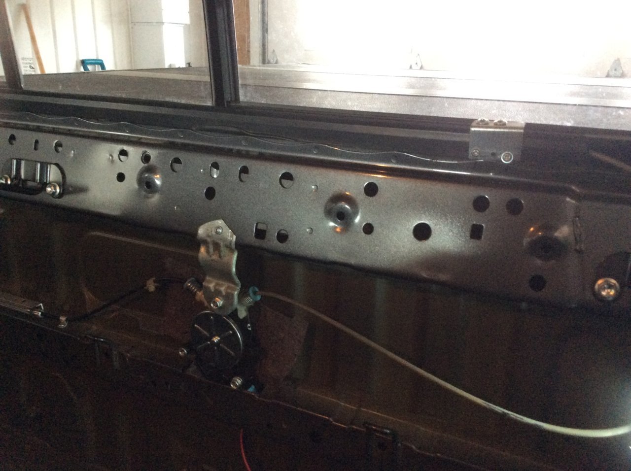

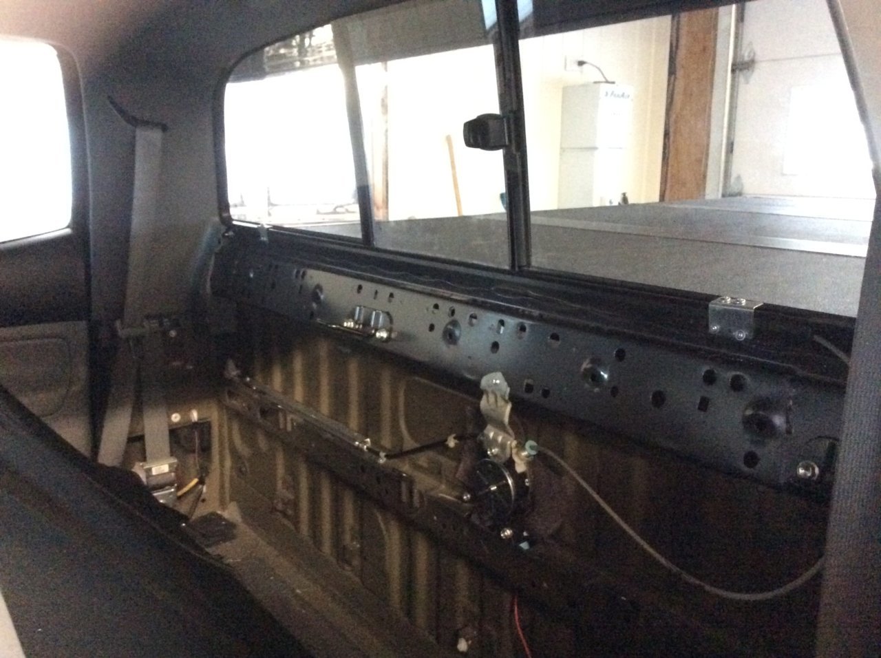

    With the current setup, I only cut about half an inch of the motor regulator cable on the right (drivers side) with good cutters. I did a quick snap and it doesnt fray the cable. The cable on this side is long enough if you place the motor inside the cross member of the back cab. I looked on Ben wa's posts page 61 of 89 post #1216 for the exact location to cut the hole in the cross member for the motor. Then I cut 5 inches of the caddy alluminum track (where to 2 cables join each other). I also used a grinder to take off the 2 ridges on the back side of the track so that it would sit closer the the back cab wall on top of the cross member. I had a machine shop make some threads inside the right side of the alluminum track so that I could screw in a bicycle thightner to receive the motor regulator housing. Then I cut off ( using a dremill) the top metal part of the round plastic that slides inside the track(the metal piece with the 2 holes). I also cut the longer side of the round black plastic tubing ( where the 2 cables connect) so that they were equal lenght on each side. i used some gorilla epoxy glue to glue the left side cable into the black plastic tubing. I threaded that cable inside the housing, then through the back wall and into the bracket that secures the cable to the window chanel on the passenger side. Then I secured that cable into the window bracket and thighten the allen key screw very firmly. Then I secured the right side cable (driver) into the window braket the I slid that cable bracket so that the cable would be tensionned enough. PLEASE look closely at Ben wa's videos for the install of the cables into the bracket and so on....post # 1283.
    Good luck with this install
