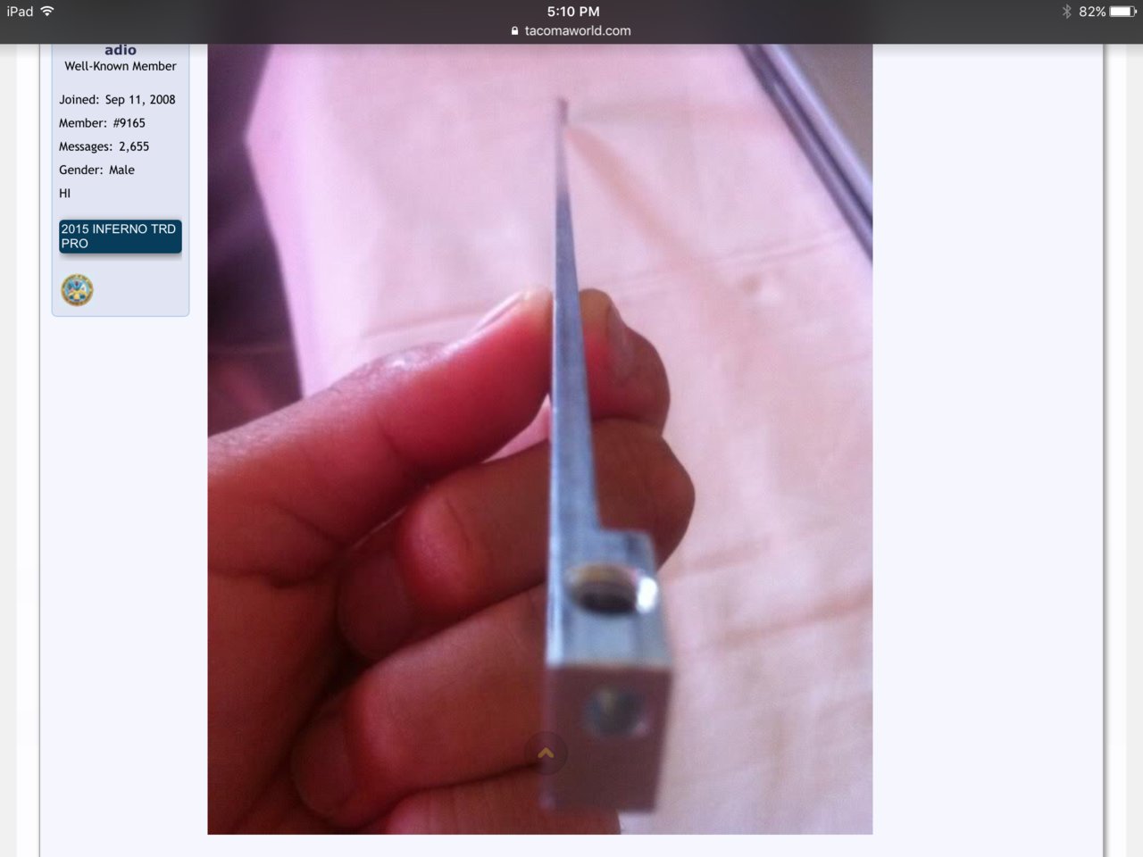

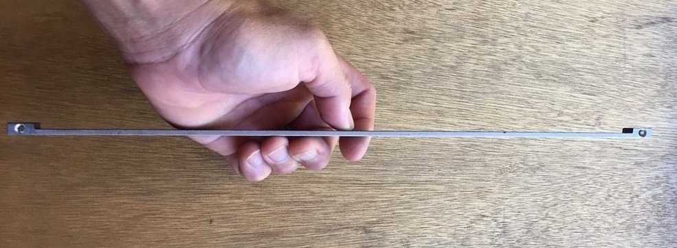

    The bracket from Kgarrett already has 1/2" pieces on each sides of the window which has a hole that you insert a clipped cable end that is secured in place by a set screw. No need to reinvent anything here its all there. Did you guys take a look at the pdf from the deseign of the window pull pull bracket. It is 1/8" thick where it sits on the window and then become 1/4" thick at both ends of the window
  9. Feb 2, 2019 at 3:58 AM
    #49
    Poitrasbh
    Poitrasbh [OP] Well-Known Member
    Oct 7, 2018
    #268628
    77
    2015 Charcoal grey Tacoma TRD
  10. Feb 2, 2019 at 4:24 AM
    #50
    Poitrasbh
    Oct 7, 2018
    #268628
    77

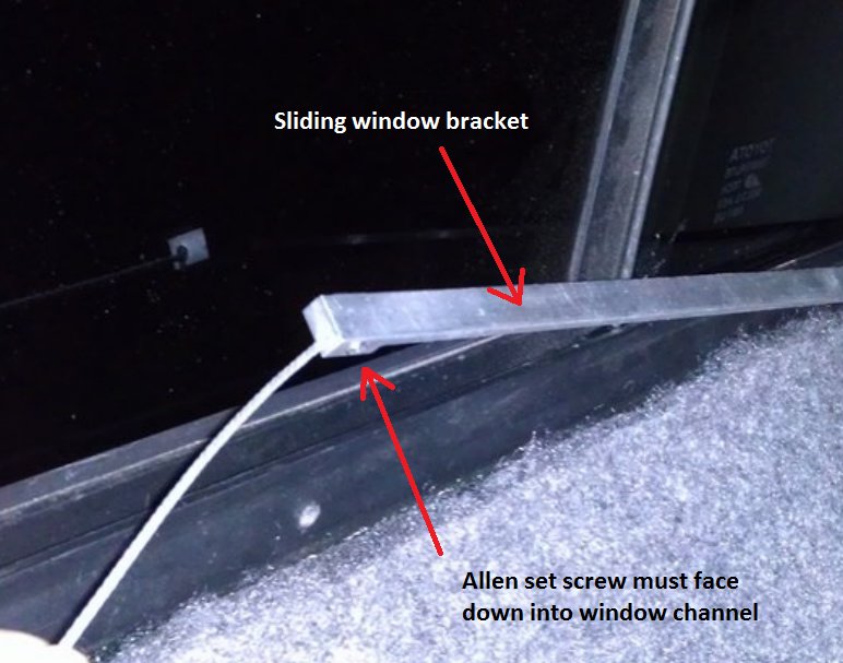

    here are some more psliding_Window_Bracket inside window frame 1602P81.jpg sliding_Window_Bracket 1602P81.jpg icsbracket.jpg

    And YES you still need anchor brackets to secure the cable housings to the window frame otherwise you won't be able to get any tension in the system

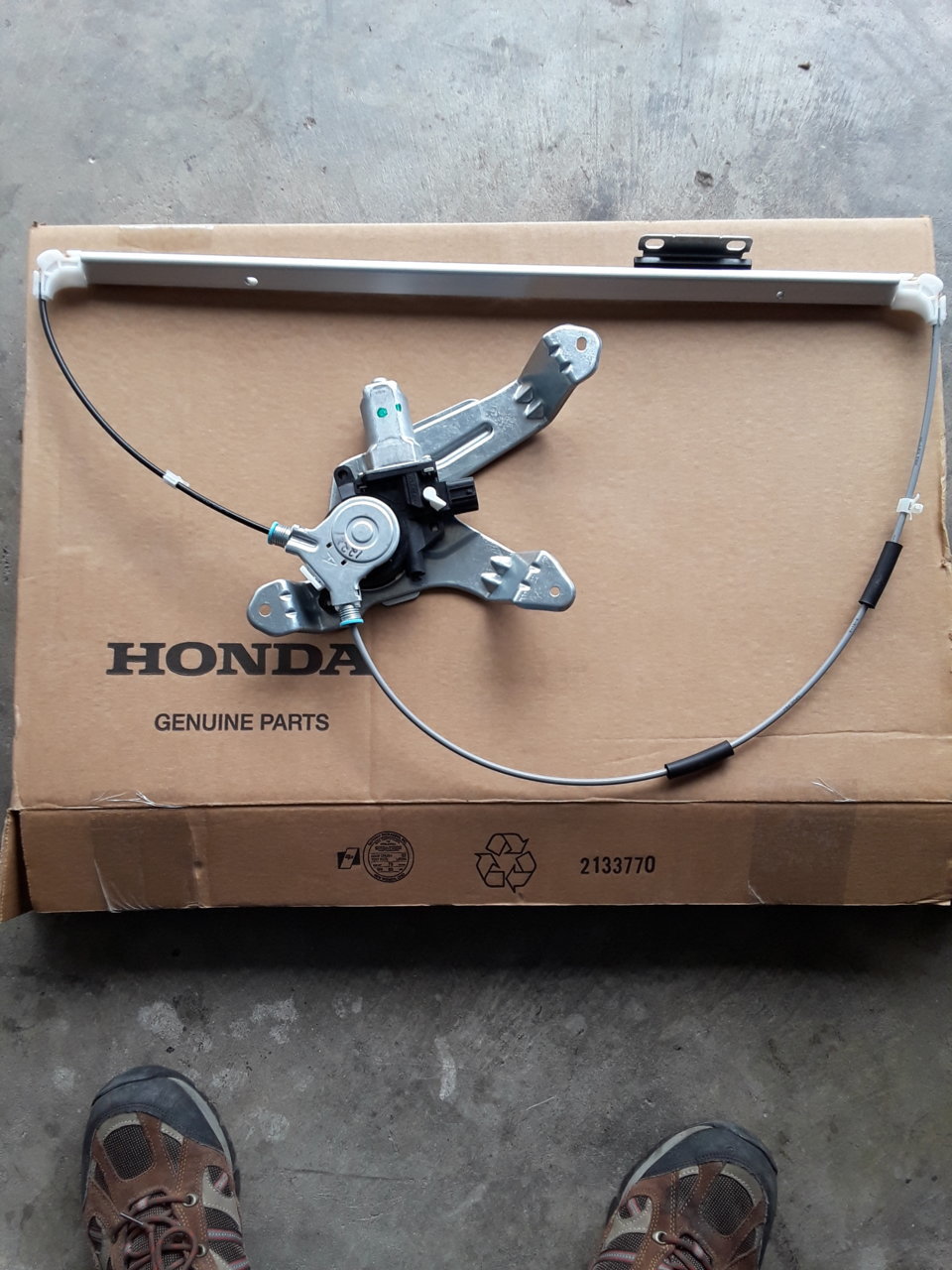

    now I need the other end of the plug, ugh, always somthing
  19. Feb 2, 2019 at 12:07 PM
    #59
    Poitrasbh
    Oct 7, 2018
    #268628
    77
    You can alway just add 2 female connectors on each prong
