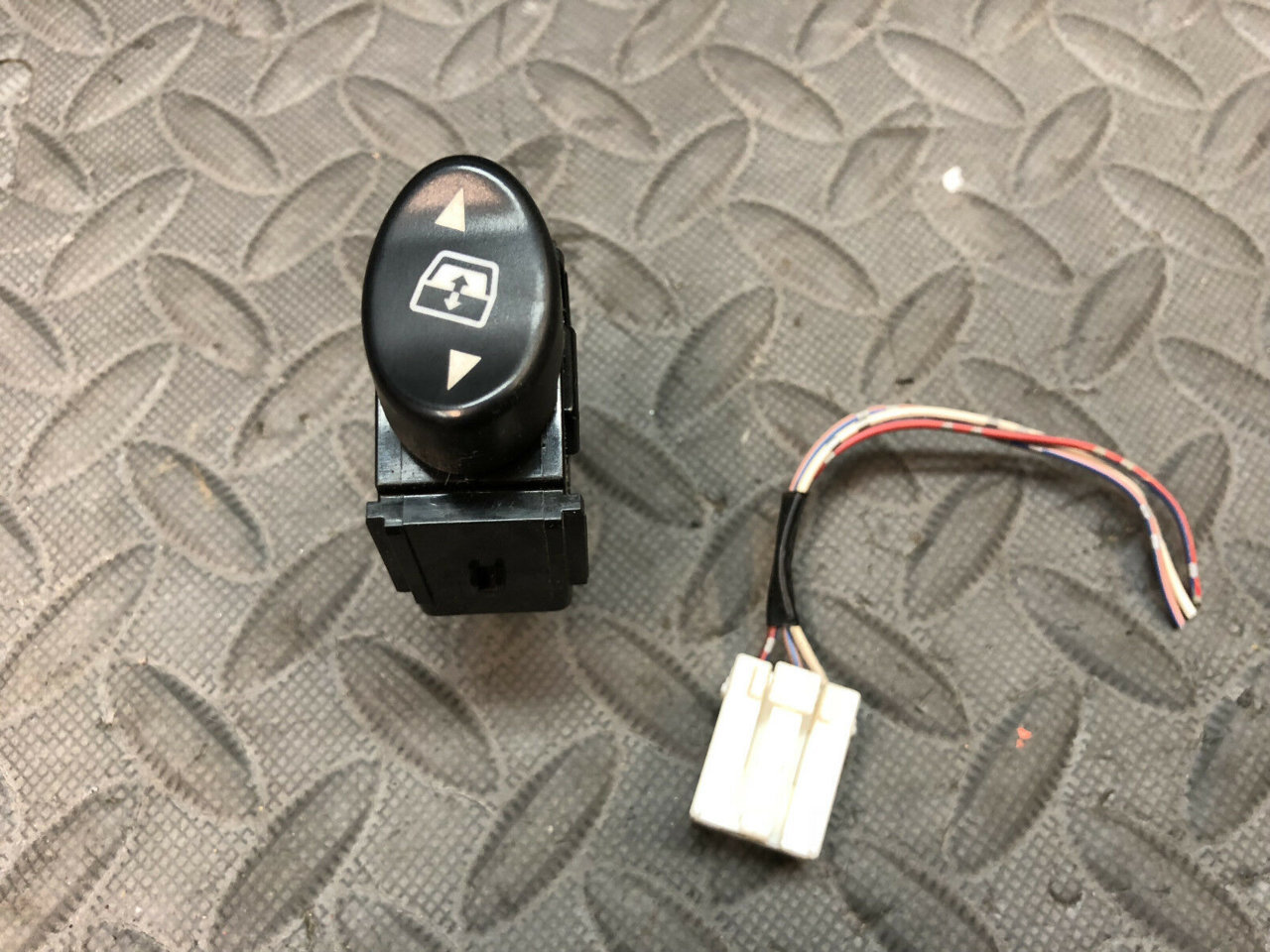

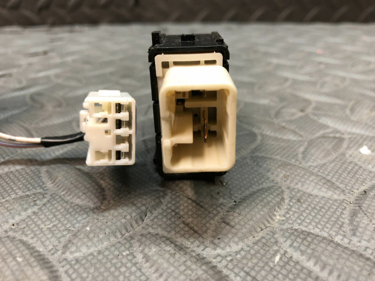

    can you post a pic of switch both front and back. doing this mod also,,,I am using a switch from a 2003 sequoia , tundra #192586, $24.00 on ebay..I also went with a rear window regulator from a 2013 dodge ram #68157026AD, $38.00 on ebay. After i trim plastic bracket on window regulator, it will fit and mount in left side rear corner of my DBL cab tacoma also the cable's are long enough so they only need to be cut to length. Using kgarrett11 bracket $49.00 from kgarrett11, for the window slide and some bike tensioner's. $16.00 on Amazon...then wiring it up , wire and add a fuse and 2 relays 5 pin and your good. After talking to a few who did the mod, seems best place to start is with any window regulator that has long enough cable's that you don't have to extend only cut or maybe not even have too and small enough to mount somewhere where you don"t have trim or cut both truck sheet metal and rear panels.....Which is not that hard to do just a extra step....

    A spdt switch is all you need.
    Is that 3rd gen tundra switch the one that's posted earlier?
    Got a meter? 5 pins should be easy to figure out with an ohm meter. 3 for the switch, 2 for the light inside.
    If the plug end of the switch looks the same as in the pictures, you're probably good to go. I'd still ring out the switch to make sure though.

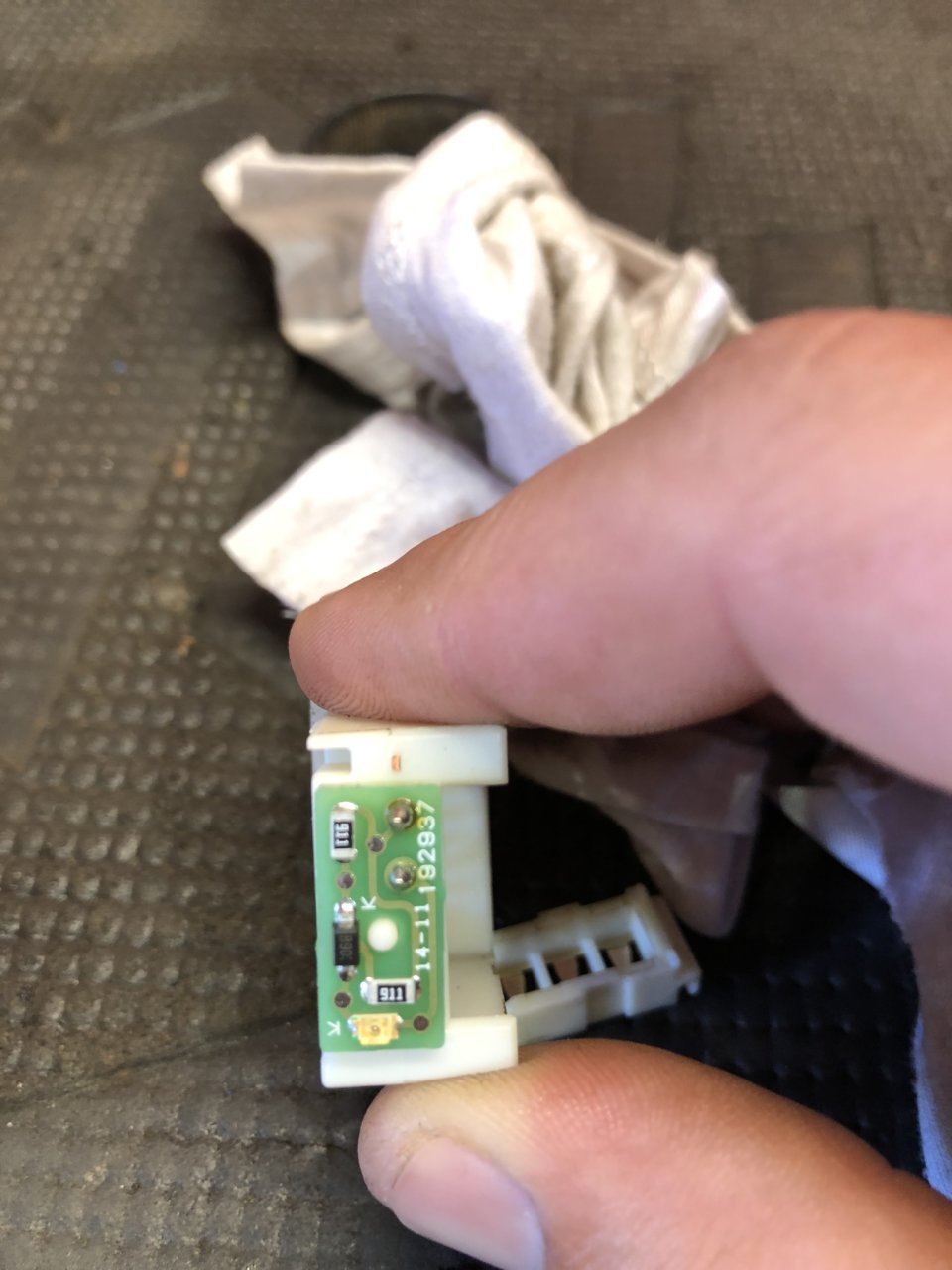

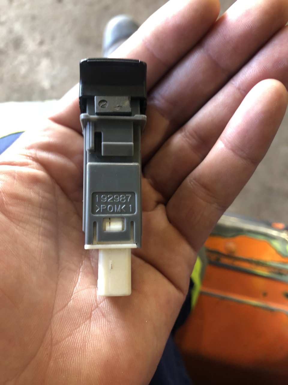

    Sorry, Can’t post pics atm. I just opened up a sienna switch (6-pins, dpdt) and it does the crossover mechanically inside the switch so there are two in, two out, and two led. The led is in a brown plug on the side. Usually the two pins closest to the middle of the switch are the two inputs (power/ground). Can you post pics of your switch?

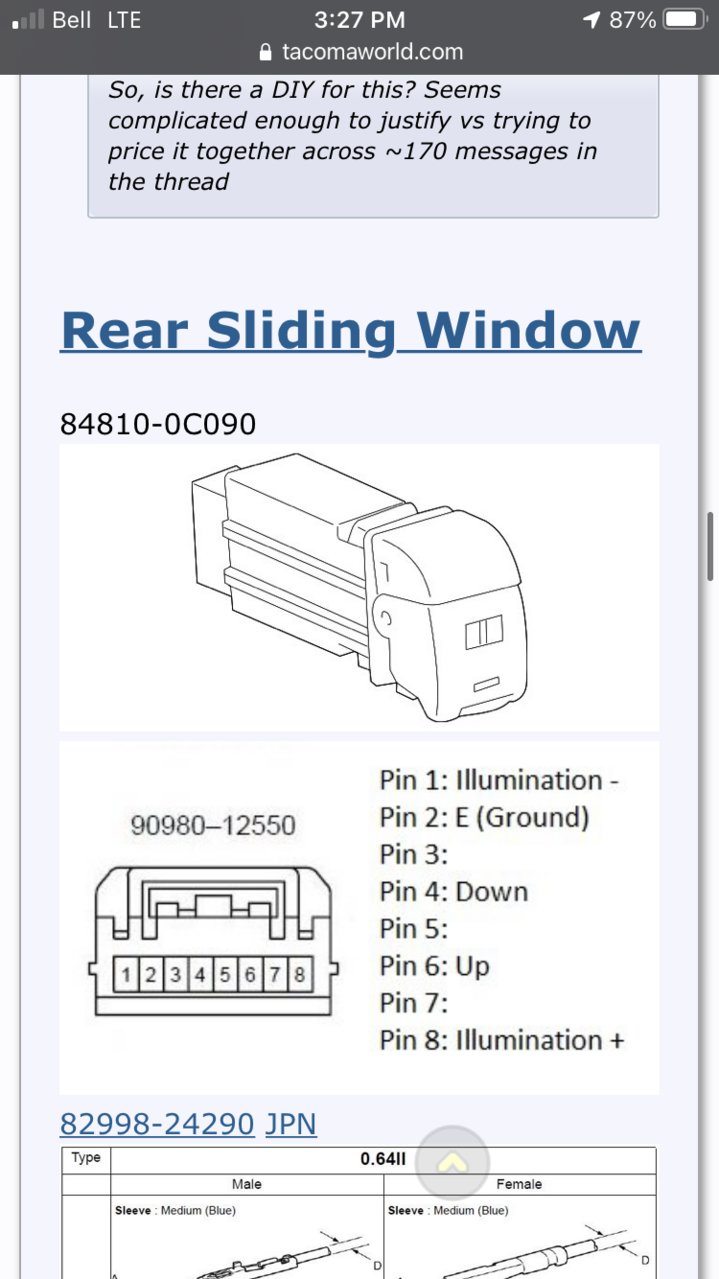

    Here’s a link to post 169 of one of this thread. It’s a pic/schematic of the 3rd gen switch with pin outs. Power sliding window mod info thread
    Looks like the switch grounds one of two wires so it’s probably an spdt switch. It should still work on the positive side supplying 12v to those wires. If not then run 12v to the coil side of each relay and connect to the switch to complete the circuit.

    Only 3 pins so it pretty much has to be an spdt. Offhand I’d say the middle pin is the center contact and the two outer are up/down. That or the single pin is center and the two together are up down. You can verify with a meter or take it apart and look at the mechanics inside. They just snap together. In lieu of a meter use a flashlight battery and bulb to figure it out. The center pin will connect with each of the other two but they won’t connect with each other.

    earlier post #222 said it was from a 2003 sequoia/tundra switch....

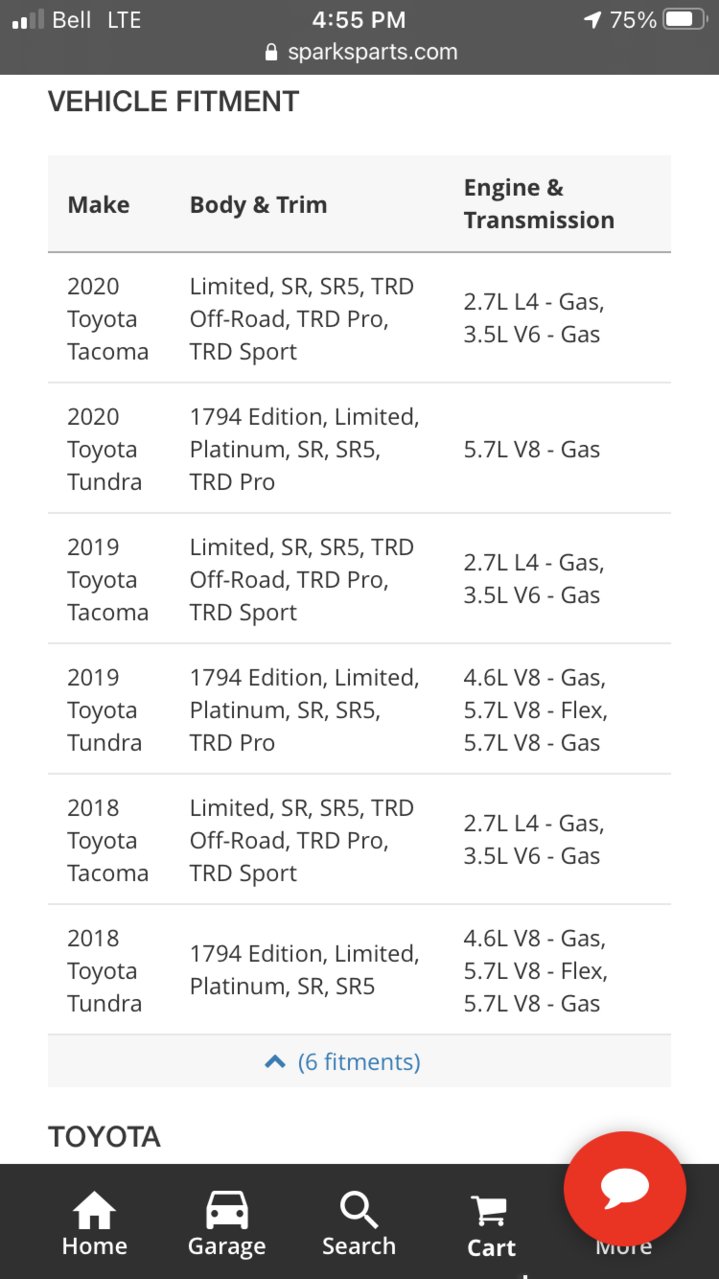

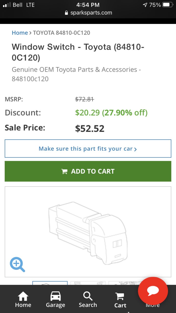

    Does anyone know the part number of a backlit Tacoma or Tundra sliding rear window switch?
    I used this number to order one off of eBay but ended up with this guy, which doesn’t have that part number anywhere on it and although they look identical it doesn’t have a led to illuminate the switch itself. Just one for the activation window.

    I found the part # for the updated switch with a blue backlit for all the OCD mofo’s out there. The first one posted in this thread doesn’t have it and from my reading neither do early model Tacoma’s, but I’ve been in a 2020 and it does so I knew it existed. Now it makes me wonder if there’s an updated inverter switch.
