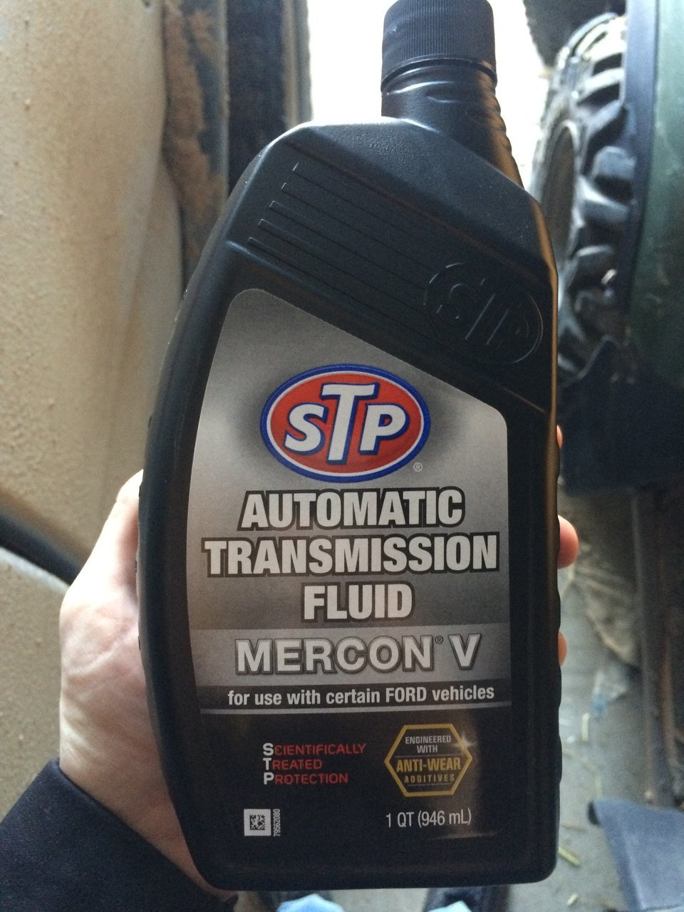

    Will this stuff work? Pretty sure the answers yes, just want to make sure though.

    Mercon V is compatible with Dextron 3. That will work.
    JKO1998 likes this.
