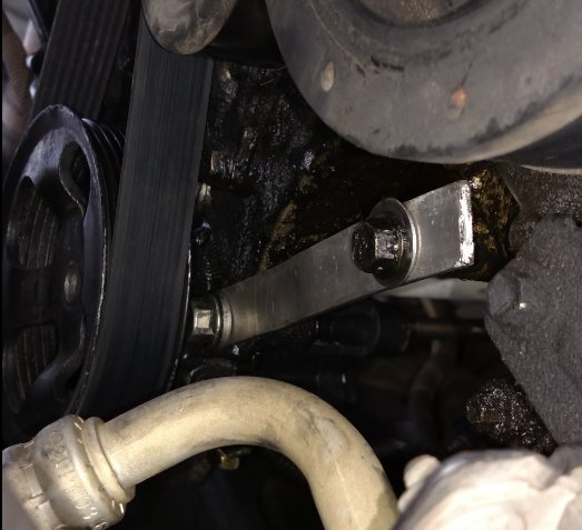

  4. Jan 2, 2016 at 2:41 PM
    #24
    Waldo1dk
    Waldo1dk [OP] Active Member
    Aug 25, 2014
    #136918
    25
    William
    NE Florida (Baja Georgia)
    2006 DC TRD Sport
    K&N and 33's
