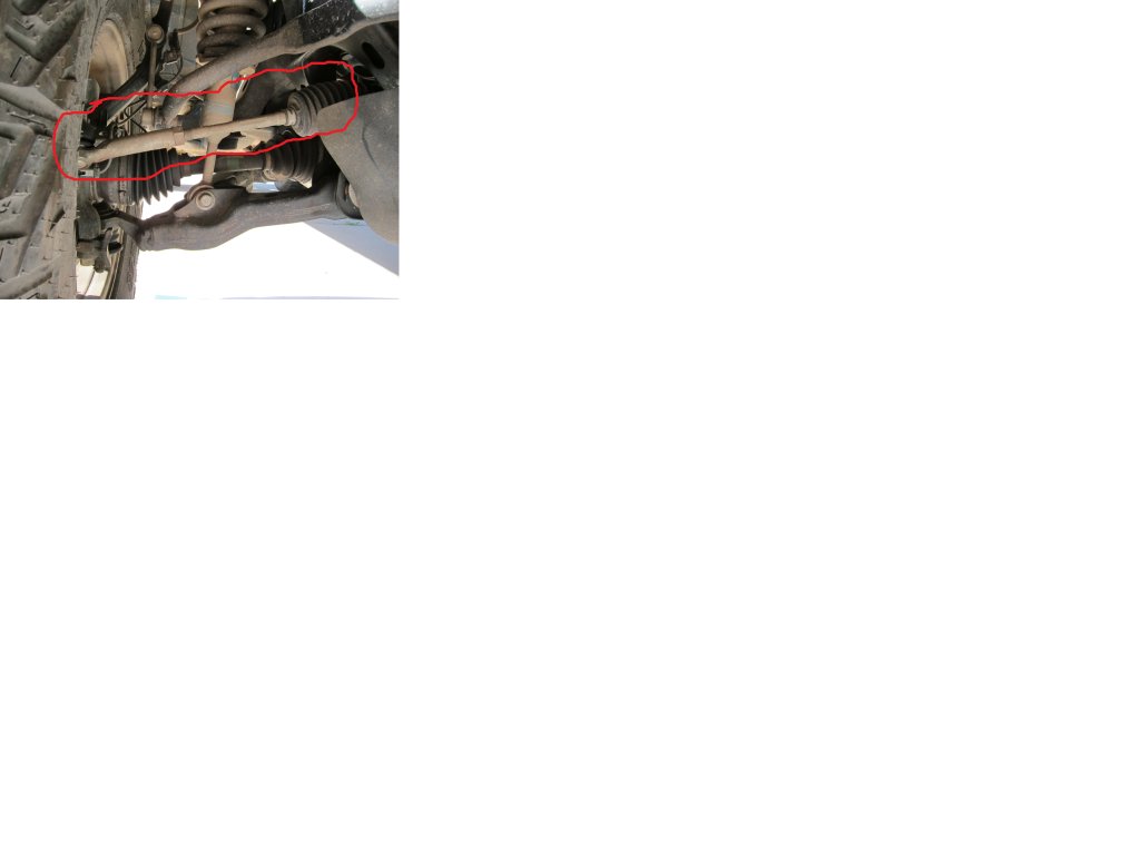

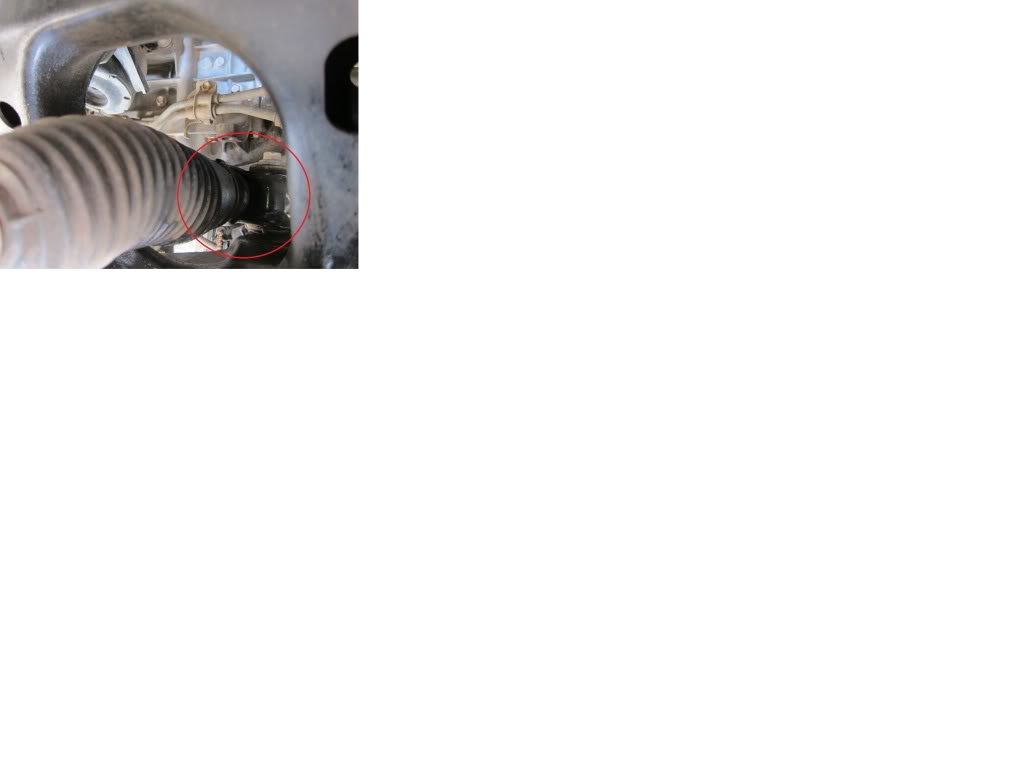

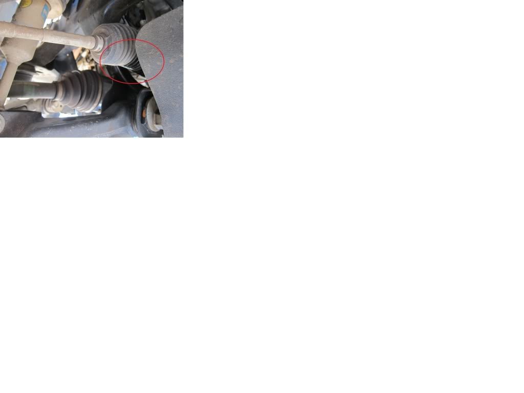

    So I noticed a bunch of buildup on my PS pump a few weeks ago and took my truck into the dealer to have it warrantied..... Now that I'm in the "extended warranty" I have a $100 deductible each time I take it in for warranty work.
    Anyhow, I saw my driveway when I came home from work today and saw some oil on the ground and when I went under to inspect It appears this is leaking. ( im not sure what the part is called, but I believe it has to do with the steering. At any rate, I just think its kind of ironic that I have not had any problems at all, then when I have the PS pump replaced, This part starts leaking.... Im trying to avoid having to pay another $100 deductible If i can.
    Do you guys think it could be related at all to the replacement of the PS pump a couple weeks ago? Do they even mess with this when that is done? Or is it just bad timing?
    thanks! Here are the photos. (sorry for the crap "paint" photos... I resized and this is what happened)

    It's possible they didn't properly bleed the system when they changed the pump, fired up the truck, and ran the rack dry for a few seconds (or longer). That could possibly fry seals in the rack. It could also be that your leaking pump wasn't getting enough fluid to the rack and that burned up the seals.
    Finally, your sig looks like you have bigger tires/wheels. Not unheard of for the extra mass to contribute to rack and pump failures (overheating the fluid in some cases). I had the same problem on my '04 Tacoma. First I burned up a pump, then a few months later the rack started to weep fluid from the guide retainer. That's why I'll never put big meats on my truck again.
    Actually, one other possibility is that it's residual from when they swapped the pump and they did not clean up when they were done. Give it a good scrubbing and degreasing and then keep an eye on it. Maybe you'll get lucky.
