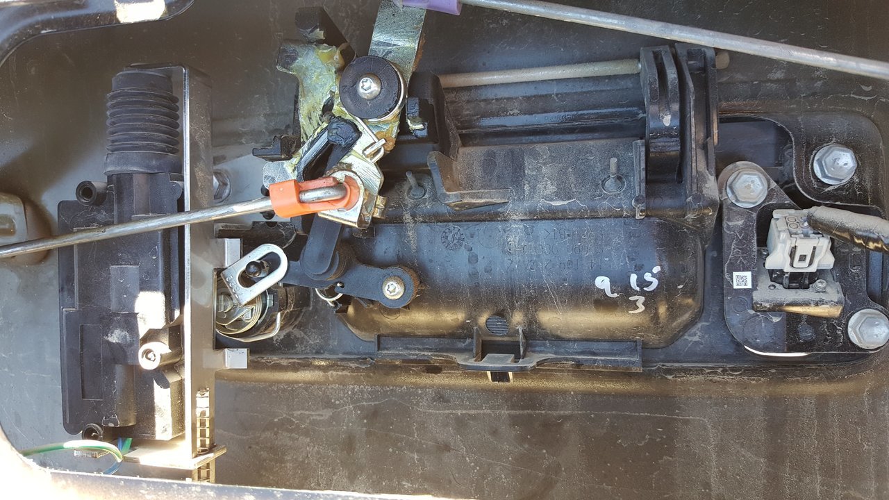

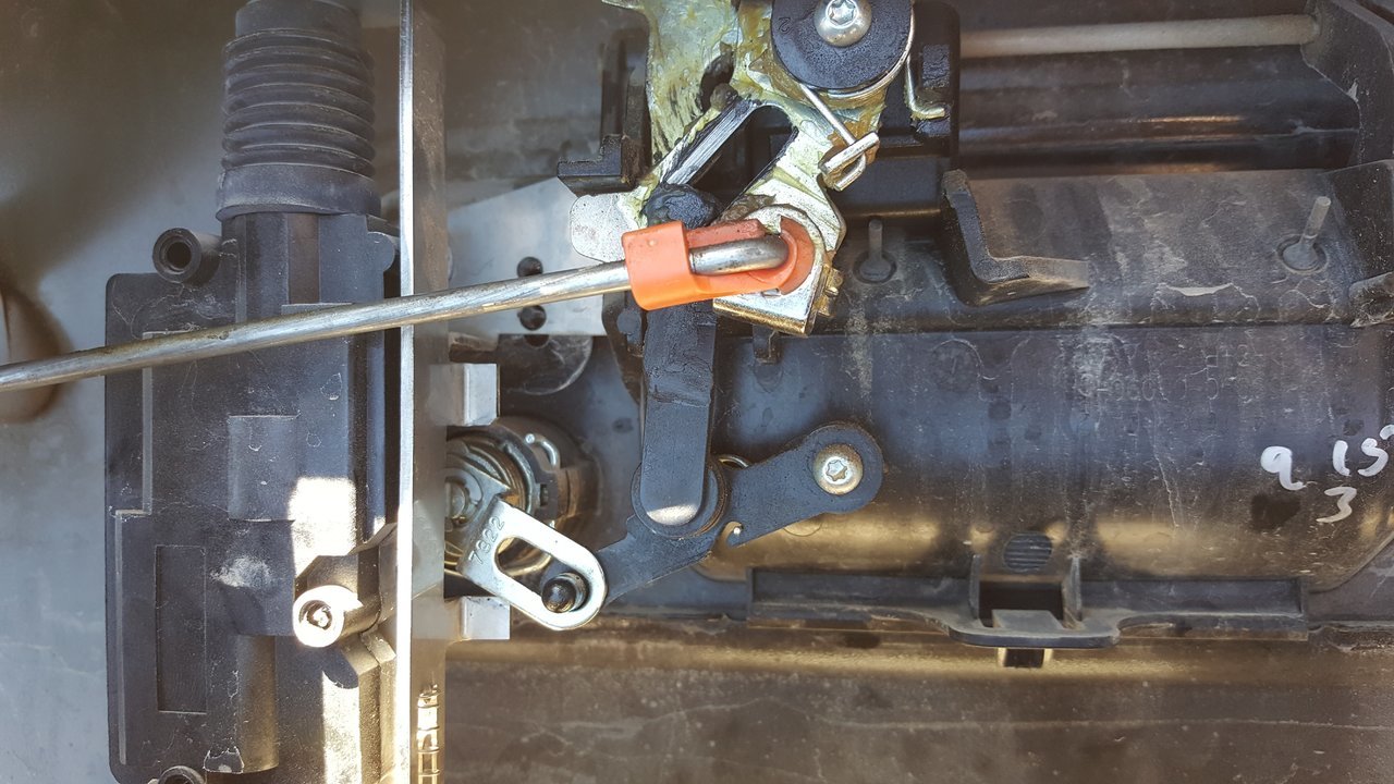

    my problem is that it lock smoothly but does not unlock! i tried rotating it a bit by loosening the nut but was unsuccessful! it is the bad design where it grabs the lock mechanism very close to the base it does not have enough leverage. i thik to fix i need to attach 2 L brackets somehow to extend the contact point.

    I wonder if the solenoid gets weak and loses power pushing or pulling? But that's assuming it's mounted solidly.

    Mine developed the opposite problem - the lock tab doesn't always push the factory lock far enough to lock. My solution (maybe temporary) was to slip a short piece of rubber tubing over the tab so it contacts the factory lock sooner and pushes it farther.

    I did grease the contct areas on the tail gate latch lever. Looked like the edges of the mating surfaces were pretty sharp, and might not slide smoothly against each other.

    I used a 7mm 10x40" Sound Deadening mat.
    Had to remove the tailgate handle, left and right links. Than i cut sound deadening mat into peaces to make it fit around the handle and metal supporting legs.
    I also add lubricating grease to shell lock lever where it connected with the plastic part.
    Now it sounds pretty much as doors actuators.
