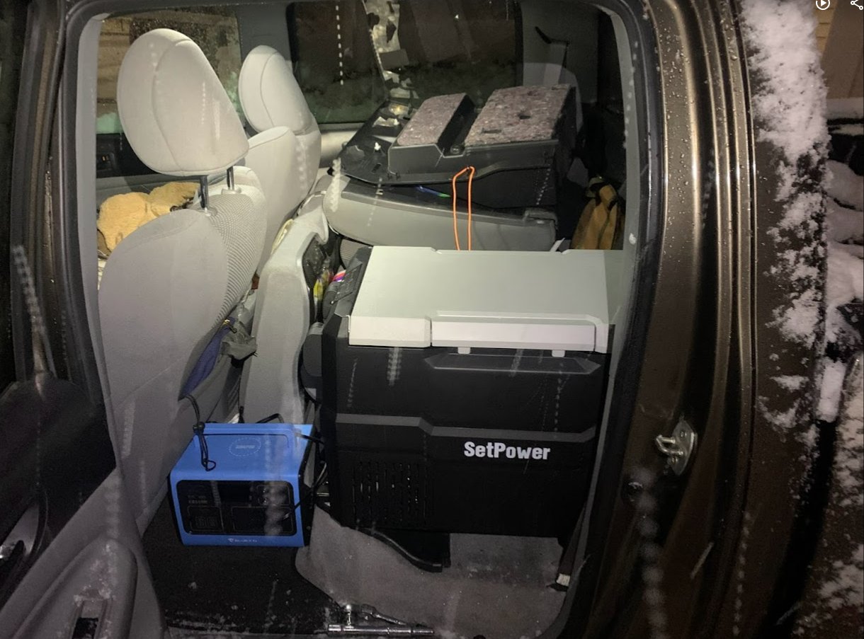

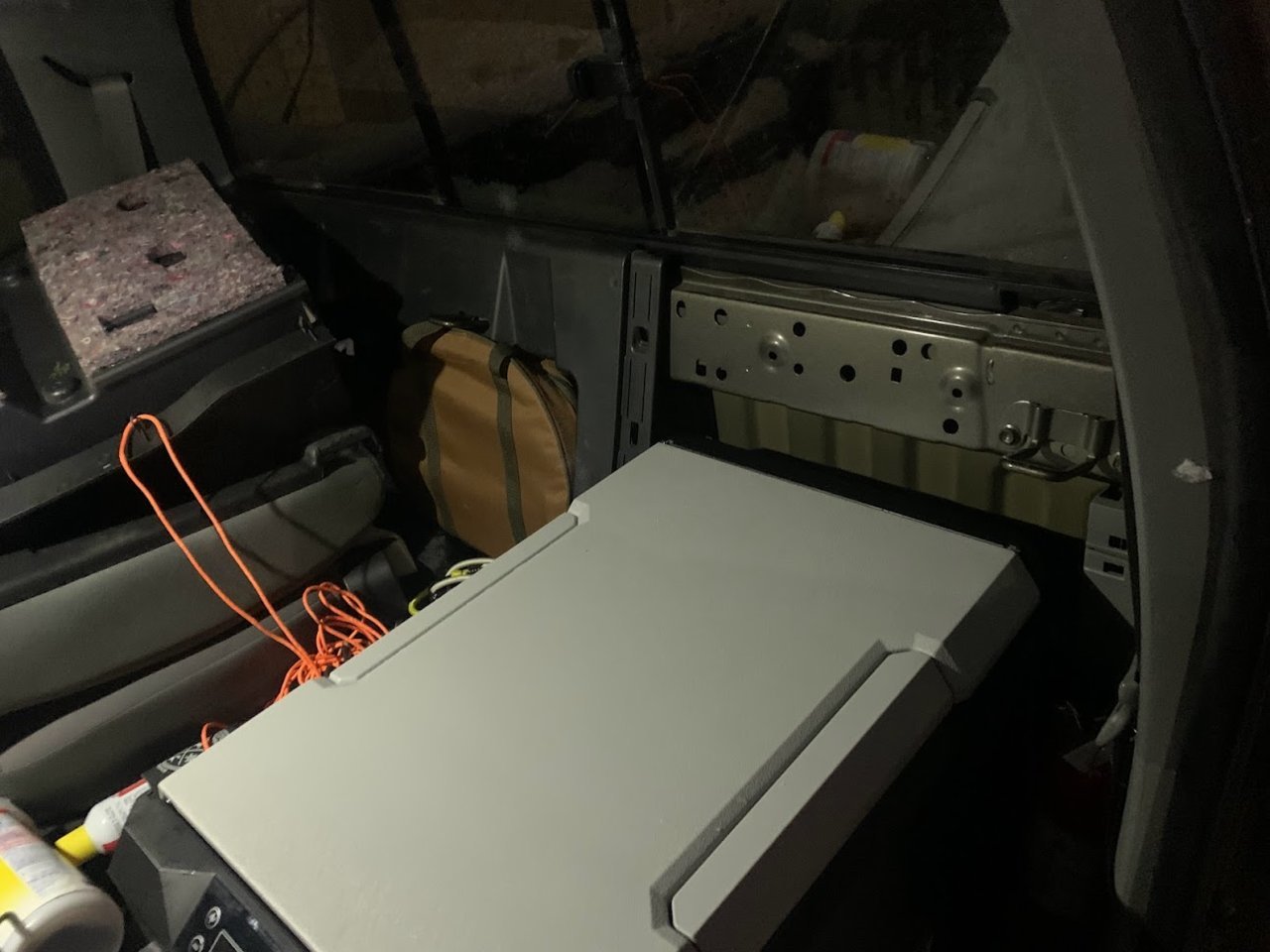

    Just got this together yesterday, planning on putting 2 12v outlets (on ignition only) somewhere in the back seat area, one to plug in the bluetti, another to charge batteries for drones and cameras. Fridge plugs into the bluetti
    Still need to put sound deadening on that back wall but that is a job for warmer weather. Total setup I think will be under $900. I got the bluetti for christmas so I went this route. For the money a single agm would be better so that will likly be my next setup.

    Why would you want your fridge on an ignition power supply?

    Because I'm bad at writing stuff, thanks for pointing that out, fixed now.
