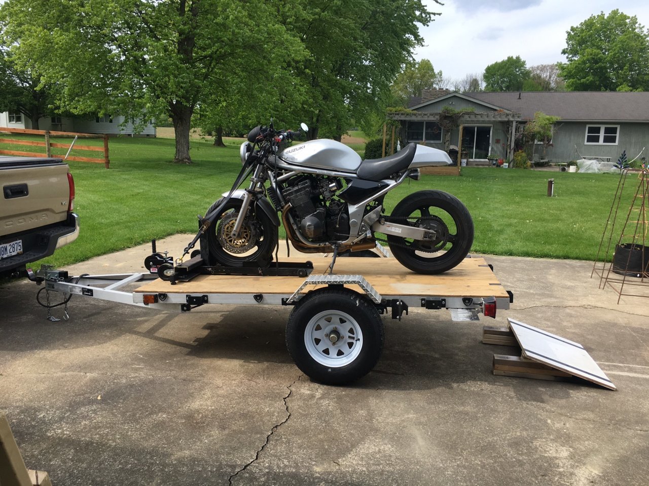

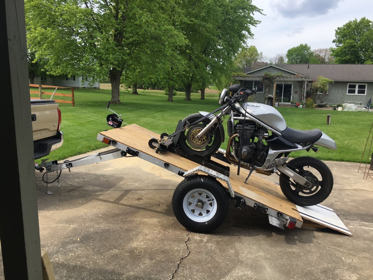

    Finally found the time to get my single-handed bike recovery project completed. I opted to go with a hand winch rather than a powered winch, but after testing it out and having to turn the crank handle about 800 times, I'm rethinking the 12v option. The bike in the pics, a Bandit 1200, weighs about 460lbs. The real test will be pulling the 700lb cruiser onto the trailer.

    Winner!! I did use a cordless drill to spool out the cable, but in the other direction (pulling the bike onto the trailer), it just unscrewed the nut holding the handle. Before I buy a different winch, I'm doing to weld up an adapter to replace the handle and allow using a cordless drill in the pull direction.
