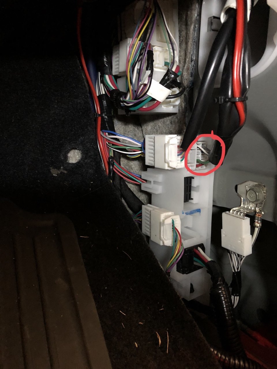

    Justin - thanks for you feedback. I wish you were closer as I'd have no problem paying you to do the install. I went to a local car audio shop and frankly they didn't seem to want to make a sale - "nothing we have will fit". So I'm likely going to try and do the install myself. I did manage to install a generic pop and lock off of Amazon so I hopefully can do this as well. Do you know which plug and wire in the passenger kick panel have the front right speaker wires? And which is positive and which is negative?
    Thanks again.

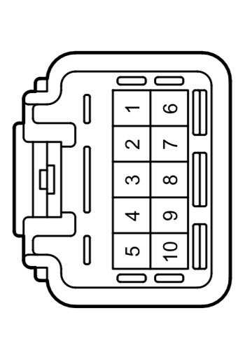

    In the passenger kick panel, you’re looking for this connector. This bundle of wires going up into the white opening you can see on the top right, which leads into the door. A58F5E02-A22A-46AF-BBD2-3DF1A12CA20C.jpg
    I believe the wire colors are
    + grey (pin 6)
    - purple (pin 7)
