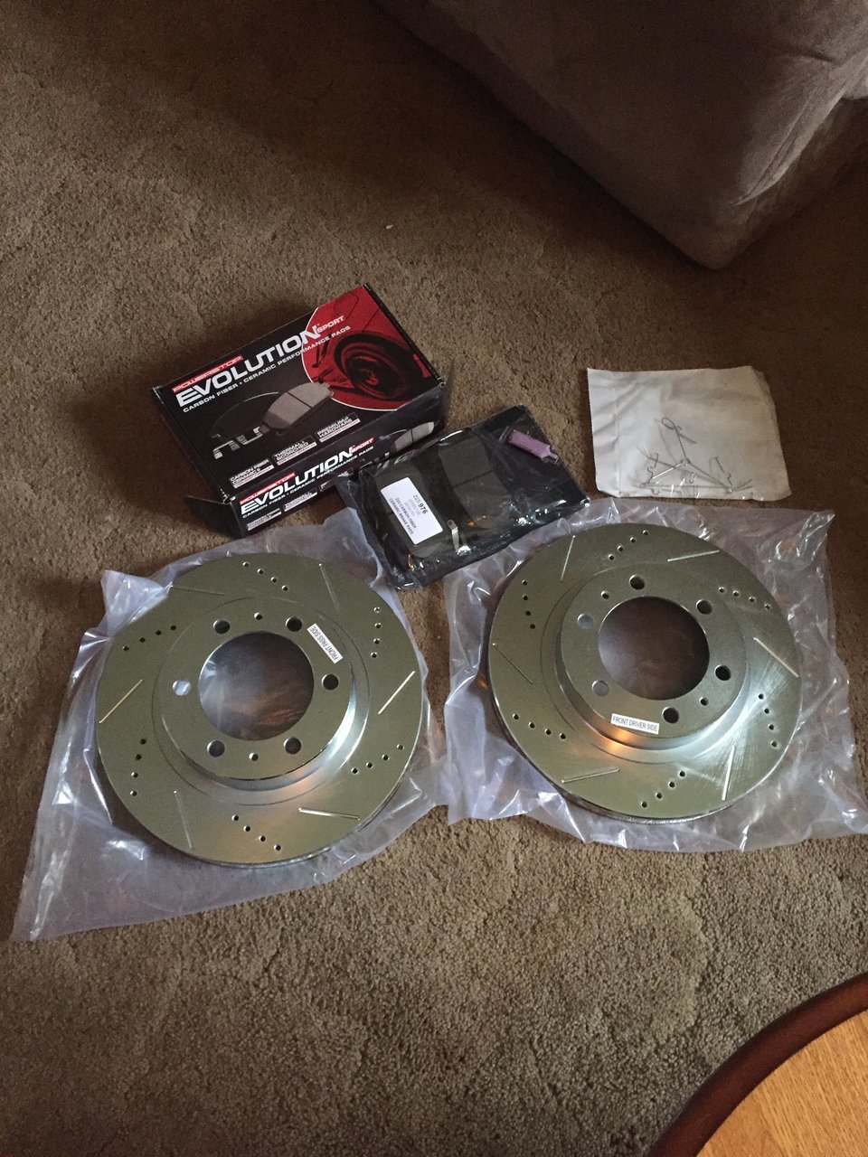

    Sitting in my garage waiting for install, slotted cryo rotors.
    I would not use cross drilled. Cross drilling introduces failure stress points in the rotor that can lead to cracking of the rotor body. Your brake rotor is a heat sink, by removing material you are removing thermal capacity thus reducing the brakes ability to absorb heat. Often times the rotor cooling veins must be de-optimized to allow for drilling to not hit a vein (as drilling a vein would further compromise the rotor).
    In short you are paying more for the mechanical cooling system of the rotor to be degraded, thermal mass to be degraded, and are introducing stress failure points in the rotor. But hey it looks cool.
