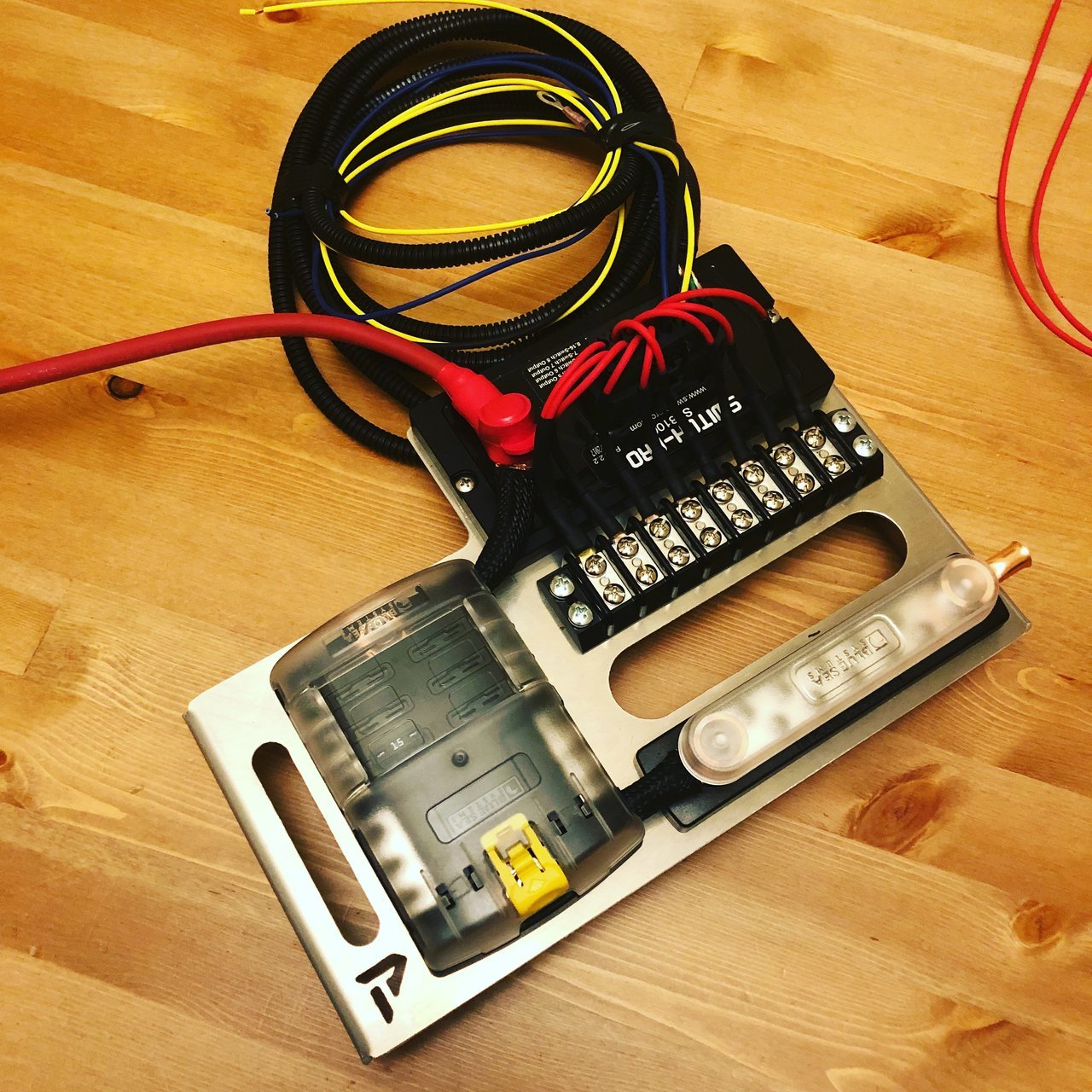

    Got around to wiring some of my Switch Pro this weekend. Long overdue for the taco. It’s a mess as far as wiring goes. The addition of the switch pro and one of these trays will really clean up under the hood. Once the weather clears I’ll be running new wiring harnesses in my truck and throwing this in there.
    Another fine product that answered the needs of the Tacoma market. Thanks to @Mr.PowerTrays for coming up with a solution everyone could use. Everything is laid out for you. All you gotta do is throw some bolts in. Really streamlines the process!

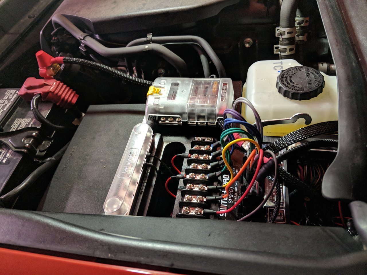

    I installed my powertray for the switch pro (9100) today. Everything fit exactly as intended.IMG_20180211_142208.jpg

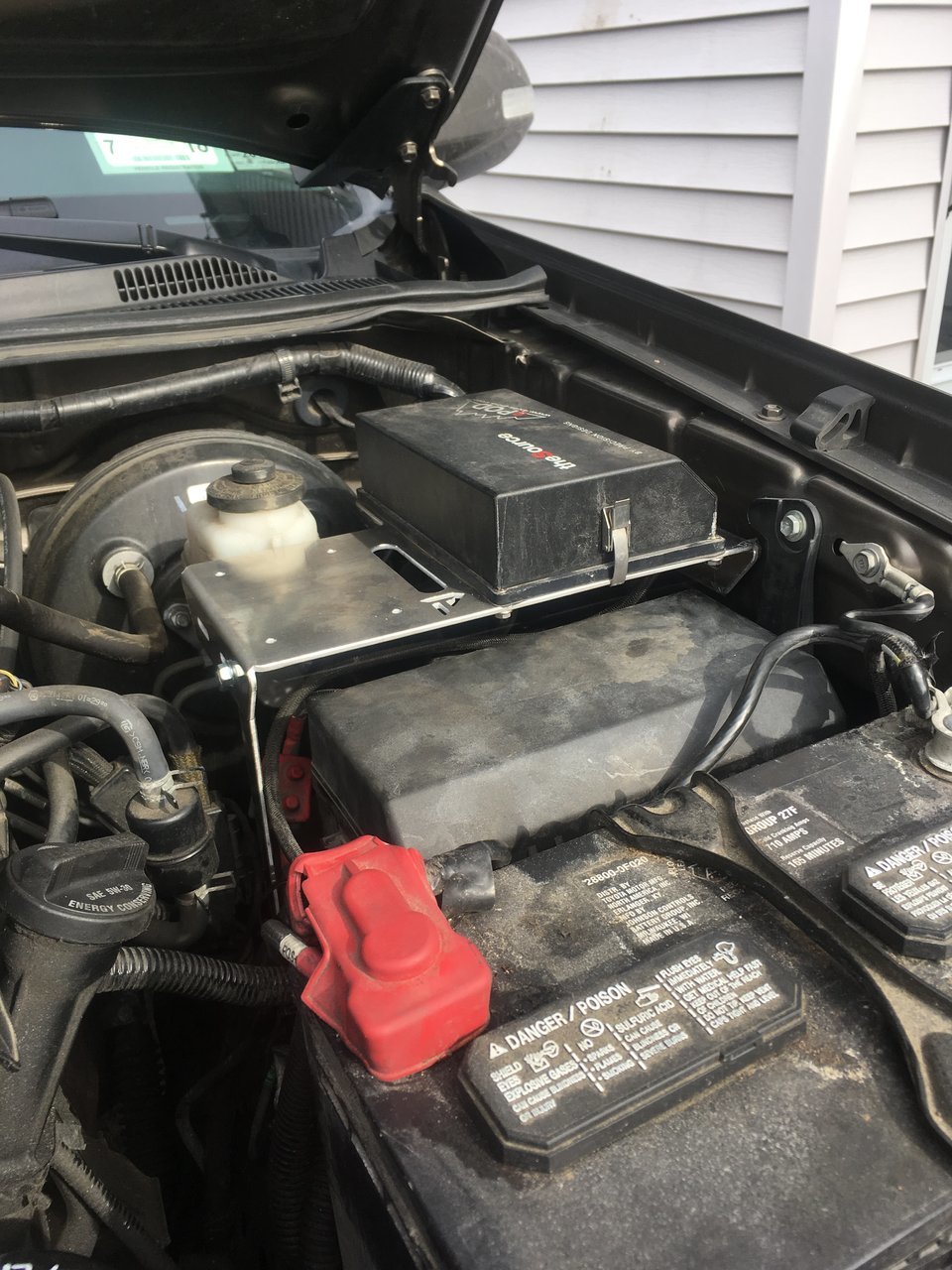

    5217391C-CA2D-40B8-94C1-3E1A863416FE.jpg 89F726E5-A0B4-4A71-AEE2-C12A2BA679BC.jpg
    Got mine installed today. Only few busted knuckles but not to to bad. Def a sturdy set up. If I ever need to take the fuse cover off it def would be a little tricky. Just need to wire up the rest of the Spod stuff and should be golden

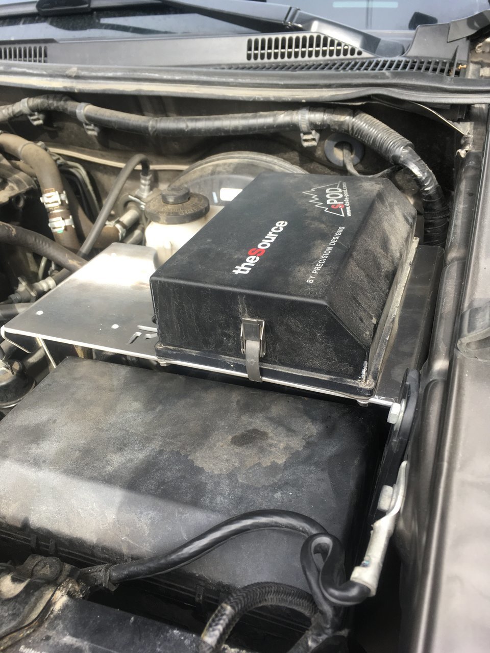

    Just wanted to post up, and first off say that Maverick is an awesome dude with great customer service. He got back to me about my tray, and even offered a full refund, but what we decided was I would keep the tray and modify it to work the way I wanted it to.
    After some indecision about where to cut it I went ahead and made the smallest cut I had thought up. After a little bit of cleaning up on my less-than-awesome initial cuts it is looking great, and fits really well too!
    I'm happy with the margins all around, and even with the leg area now looking pretty thin, it is rock solid. You can see I left my 1/4 socket in there to show how much clearance I had, and even with that pushed in there I could easily unclip and remove my fuse box lid.
    I'm gonna clean it up a bit more and then see about paint or powdercoat!:thumbsup:
