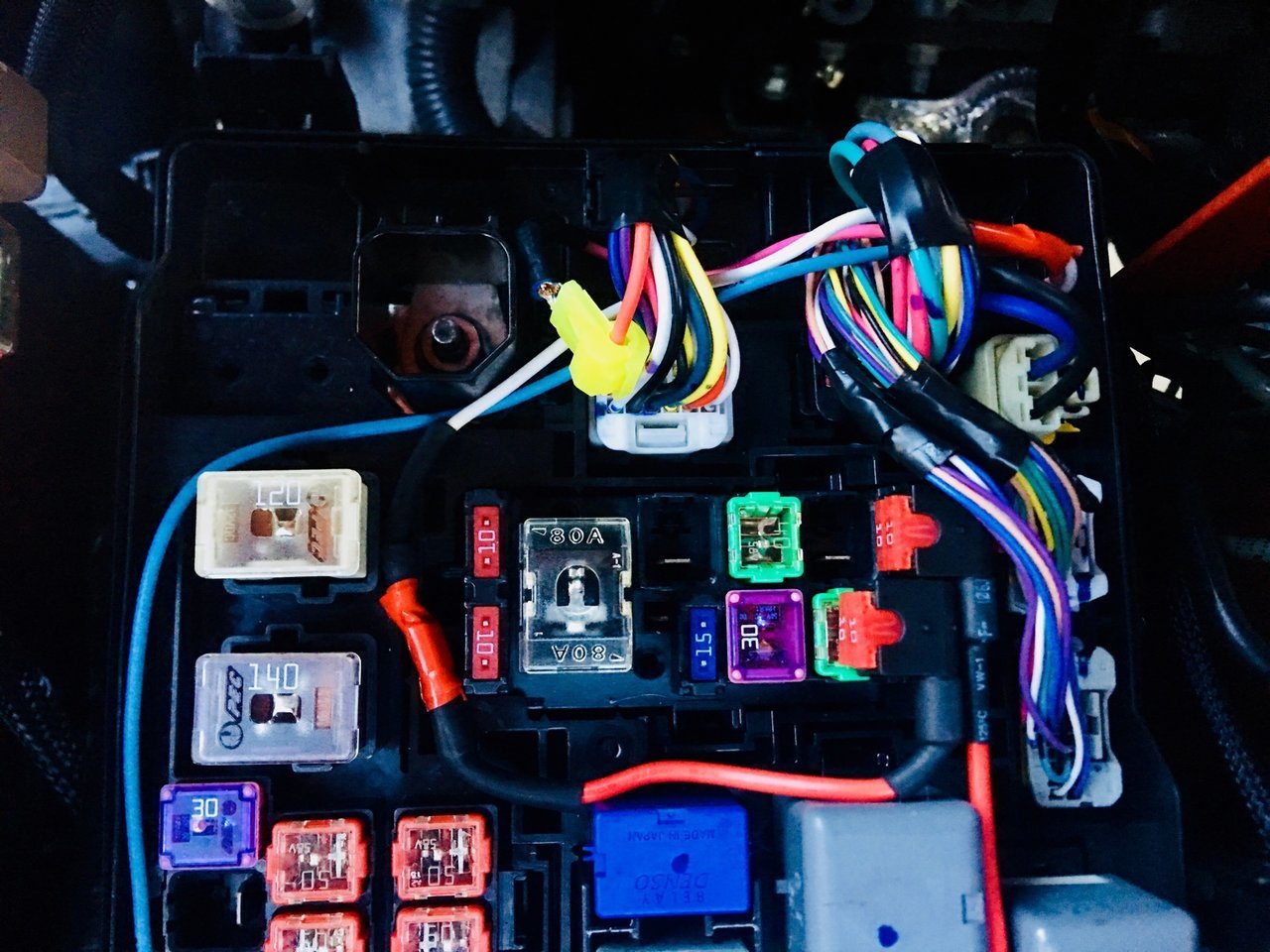

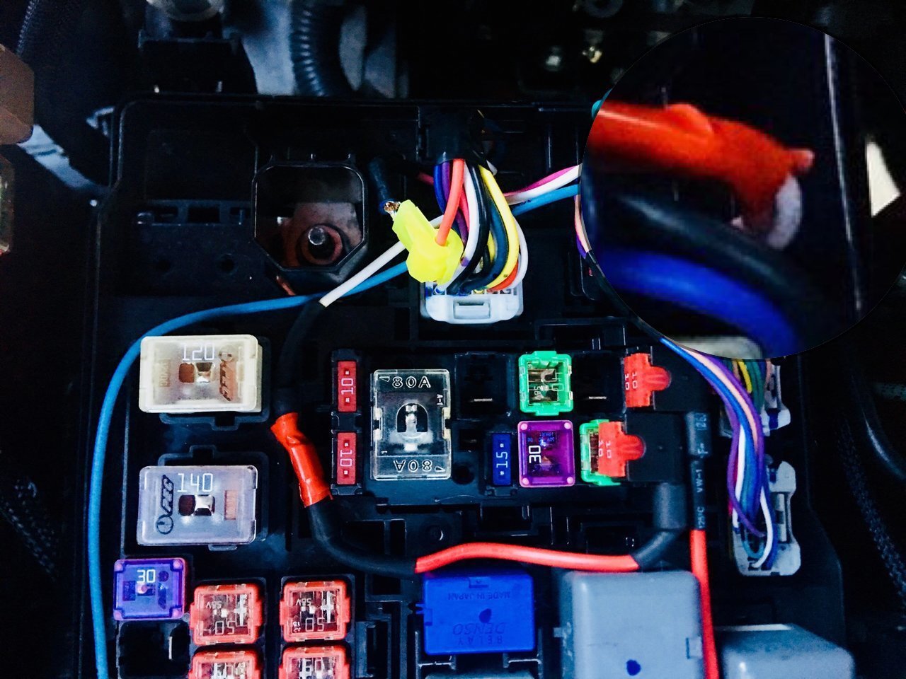

    I drilled a 1/4” hole in the upper right corner for a Factory Look. I shrink wrapped my wires together after covering all my wires with flex black loom and the 1/4” hole wedged them in there nicely so there’s not much of an opening if at all. The hole actually would allow for the wire loom to go through, that’s how nice it fit in there. You could certainly use a grommet like @BEAR_KNIFE_FIGHT mentions. I didn’t bother because if there is a slight opening, it’s not much at all. Worked perfect. Here’s a pic for you

    I did the same as @KTJO 4x4. No grommet, but wireloomed the wires all the way into the fuse box, then shrink wrapped the end of the loom to keep it from expanding.

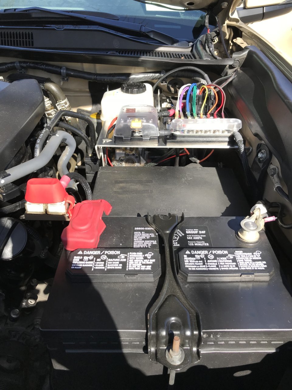

    On the Switch Pro / Blue Sea version, what is the consensus on grounds?
    The Switch Pro grounds to the grounding bar, the battery or the fender?
    The grounding bar grounds to the battery or the fender?
    Thanks again!
  9. Apr 24, 2018 at 4:11 PM
    #309
    ROCdermody
    ROCdermody Well-Known Member
    Oct 15, 2015
    #166740
    1,037
    Steve
    '16 Quicksand DCSB TRD OR
    I grounded the SwitchPro direct to the battery, the bus bar is also to the battery.

    Thanks. Did you just use the stock battery terminal or something different to leave the two grounds?
  12. Apr 24, 2018 at 4:50 PM
    #312
    ROCdermody
    Oct 15, 2015
    #166740
    1,037
    Steve
    They fit nicely on the fender side of of the negative stock terminal. I have new terminals I'll install someday, but these fit well enough that intalling the new terminals fell way down on the list of things to do.

    Does the ground wire come with the Switch Pro, and is it long enough or do you have to extend?
    I'm just trying to figure out what the negative wire that Power Trays sells is for? The negative bus bar maybe?
  14. Apr 25, 2018 at 8:47 AM
    #314
    ROCdermody
    Oct 15, 2015
    #166740
    1,037
    Steve
    The SwitchPro ground is plenty long and comes with a ring terminal already crimped on. I have 2 PowerTray ground wires, a shortie that connects my 6 circuit Blue Sea fuse block to the bus bar and another than runs from the bus bar to the battery.
