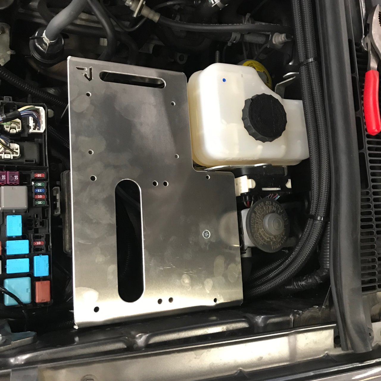

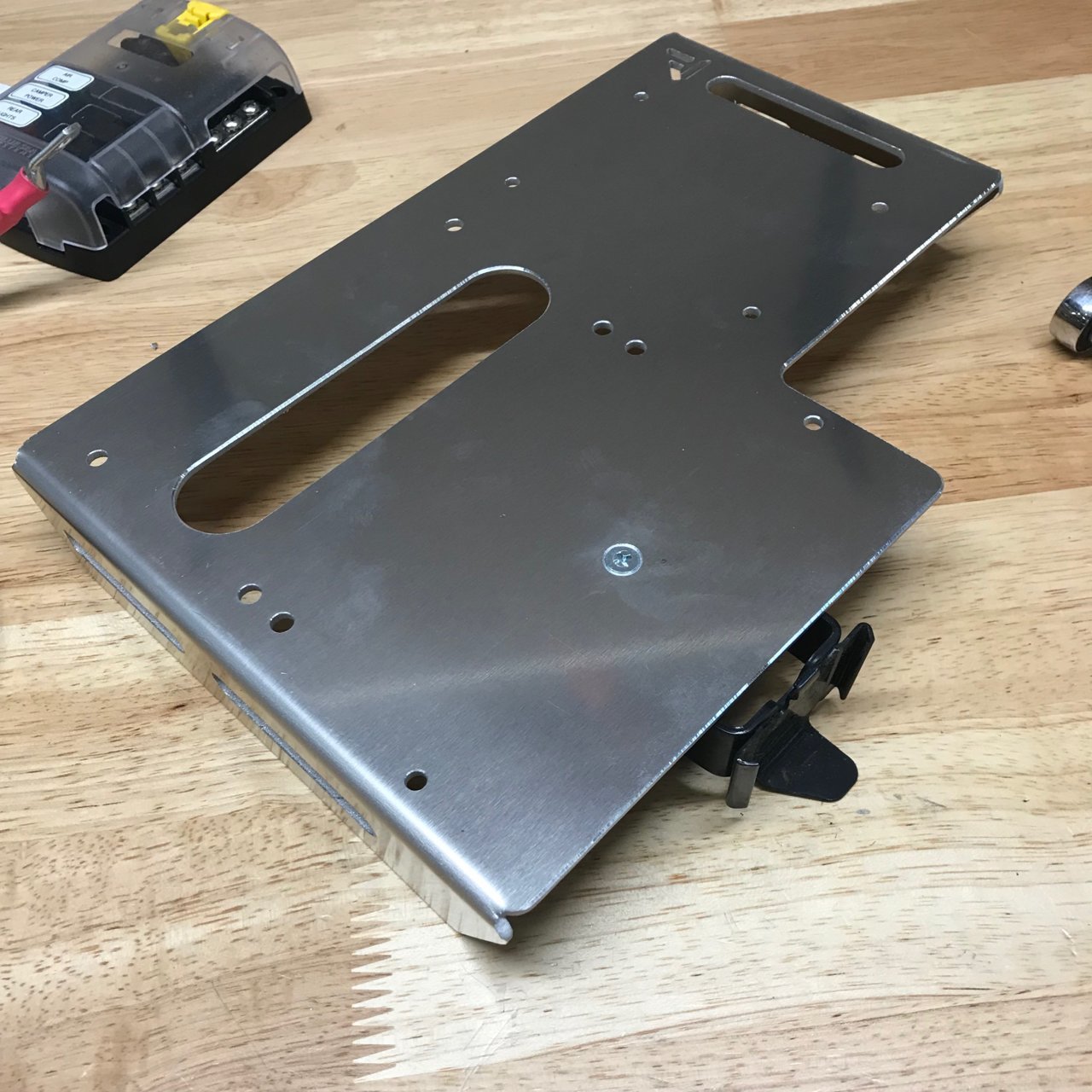

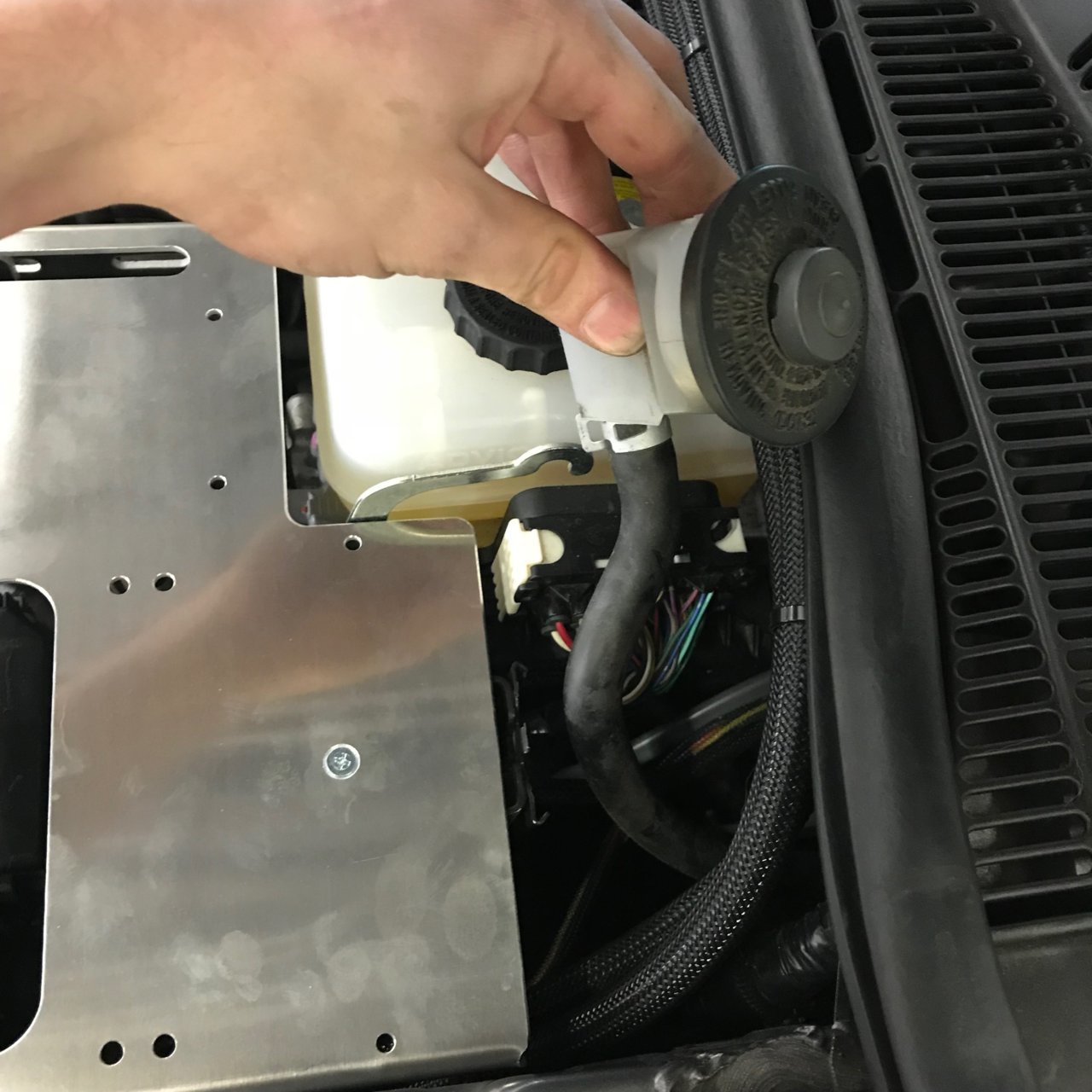

    So I know the manuals need to have the clutch reservoir moved. I'm curious as to how that setup looks and where exactly it goes. Anybody done it?
  2. May 5, 2018 at 12:45 AM
    #342
    Mr.PowerTrays
    Mr.PowerTrays [OP] Well-Known Member Vendor
    Dec 19, 2015
    #172624
    1,755
    Maverick
    Colorado
    2011 dcsb trd or

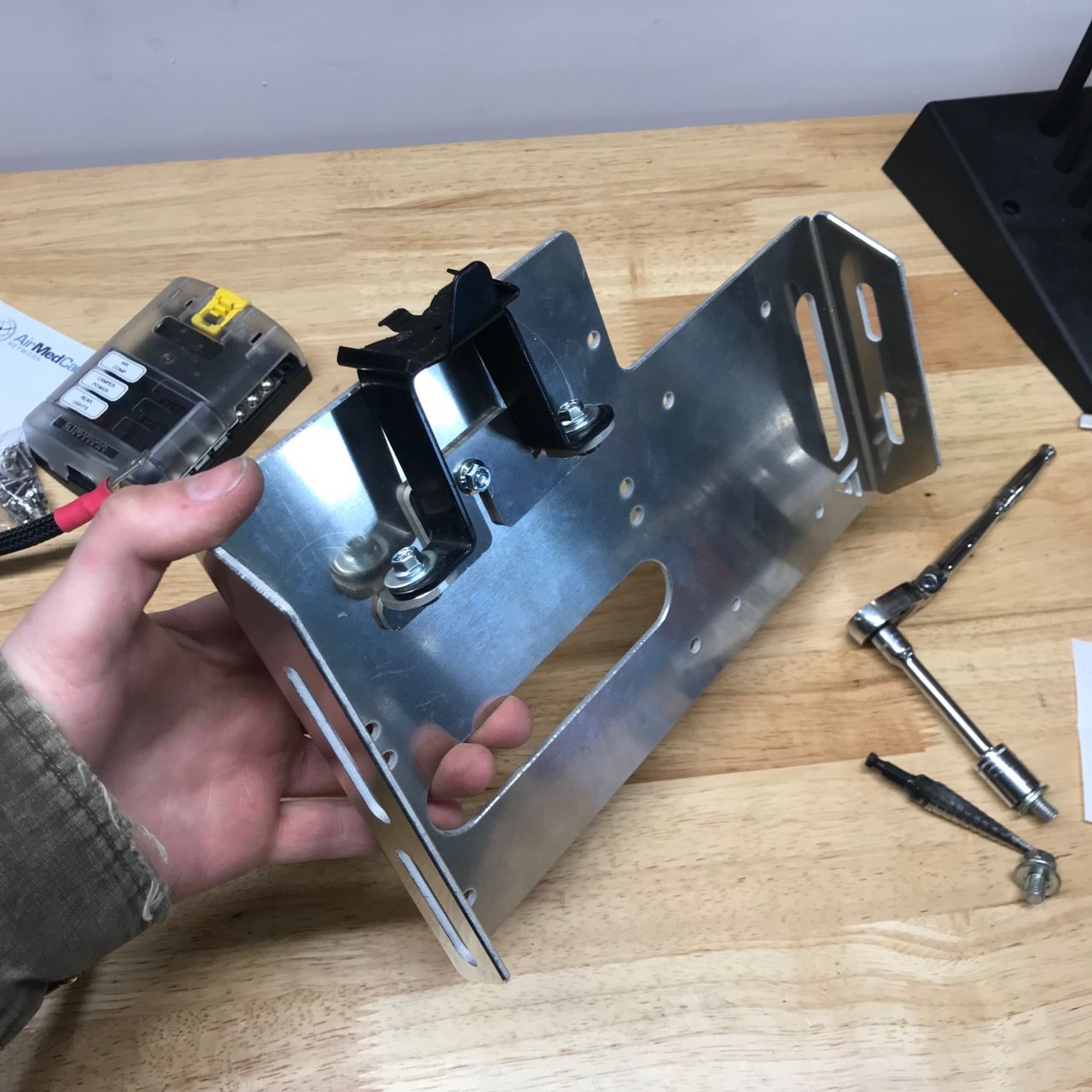

    I really need to update the website show this process, but here some photos I took of an instal.
    Just pop the reservoir out of its bracket.
    Unbolt the factory bracket and attach it to the underside of the PowerTray by using the “clutch fluid reservoir relocation bracket”.
    Install the PowerTray like normal with the reservoir just pushed out of the way.
    Once everything is in place, just take the clutch fluid reservoir and clip it back into its original bracket.

    Awesome! Keeps everything clean and out of the way. Looks like i gotta make an order
